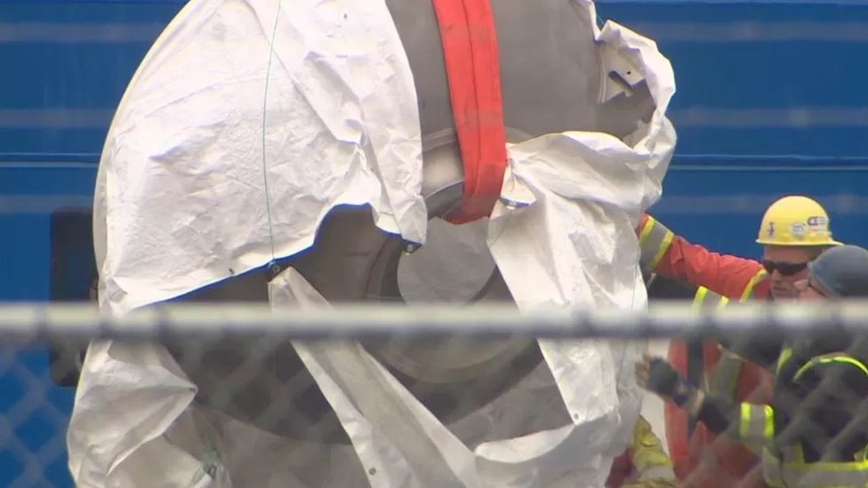

The porthole is missing from the end cap
Rush had said that you'd get a ton of advance notice if it was failing due to crazing long before collapse
I'm trying to decide, if the cylinder (carbon fiber) collapsed, would that induce the destruction of the window? Would the sudden increase of pressure inside the sub pop the window "off" (though it was bolted on)?
Perhaps if the window collapsed first, the blast of water coming in from it may have damaged the inside of the cylinder, leading to its collapse as well?
   / Would you book a trip to outer space or under sea? #124
My guess, and it is only a guess, is that pressure collapsed the cylinder and caused the porthole assembly to blow off like a cap popping off a soda bottle that got squished. The Titan personnel chamber appears to have been unique in having a cylinder for 5 people compared to other submersibles like the Deepsea Challenger that only has a small sphere for one person. Comparatively speaking, there was a lot more surface area for pressure to build against the Titan pressure chamber. My logic would therefore be that if you have a larger pressure area, you'd want to build the thing even stronger.
