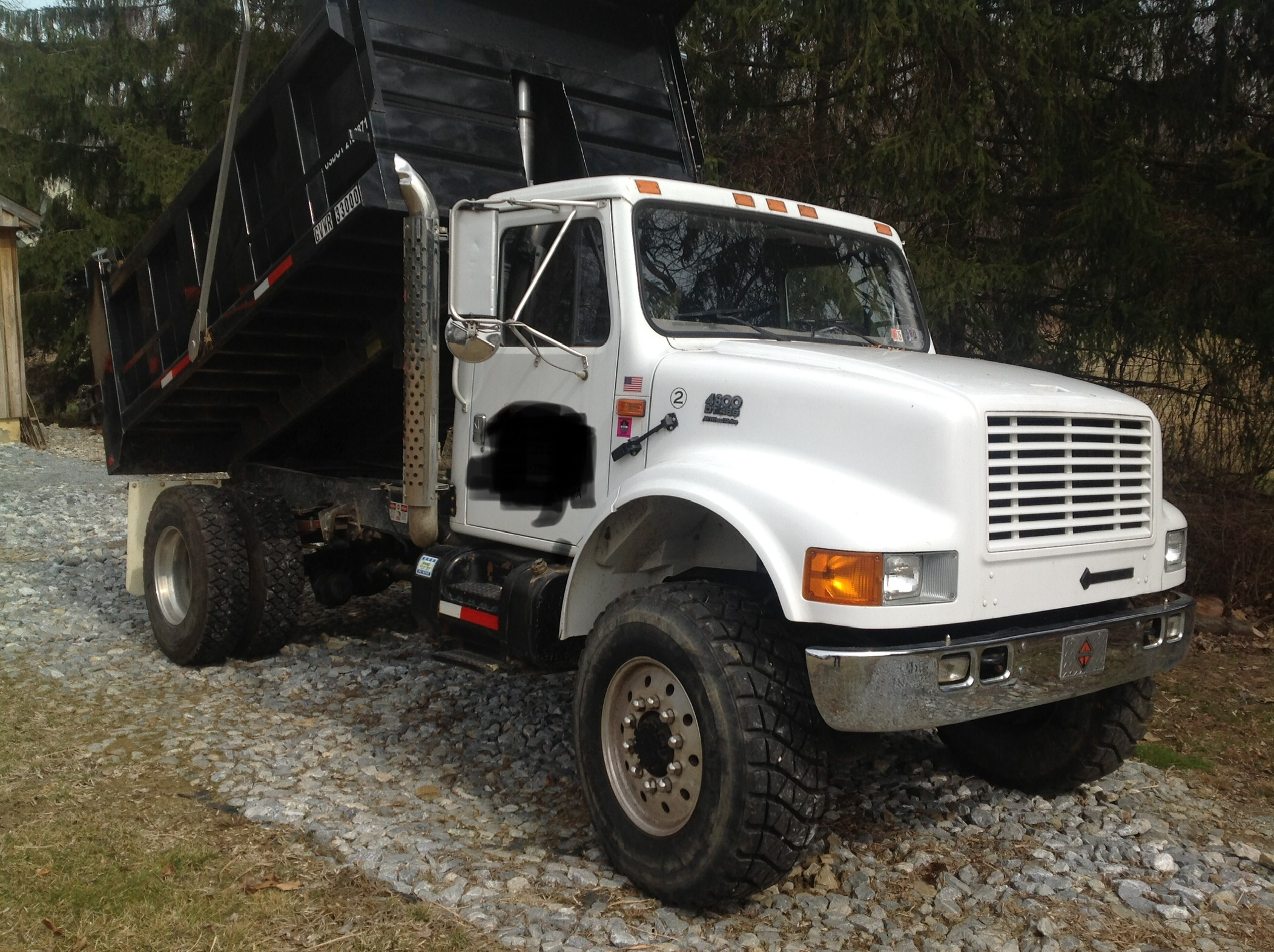

I had this one @250HP
Its not a tandem, but with 10 tons on it, you knew it.
”gutless” doesnt bother me much anymore. I have my Ram if I need guts OTR.
