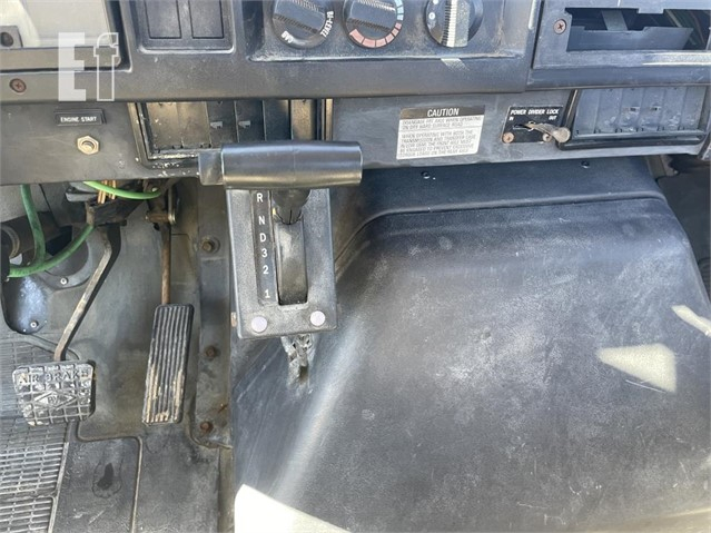

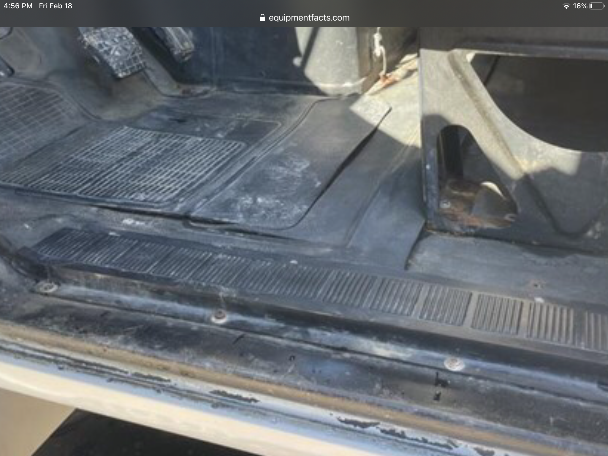

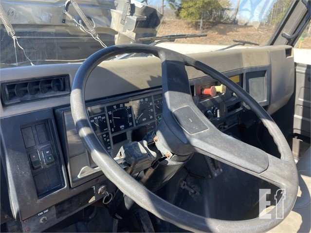

An old trick, roll the odometer... One way to help tell is look at clutch/brake/gas pads. They should look brand new...
Here is the original floor mats and pedals they look unworn.
My local dealer said it was originally speced as a government or military truck. You can see it was painted white over the olive drab original paint in the lower door jamb area.
transmission hump and shifter look unscratched
Steering wheel still “rough”, not smoothed out.
