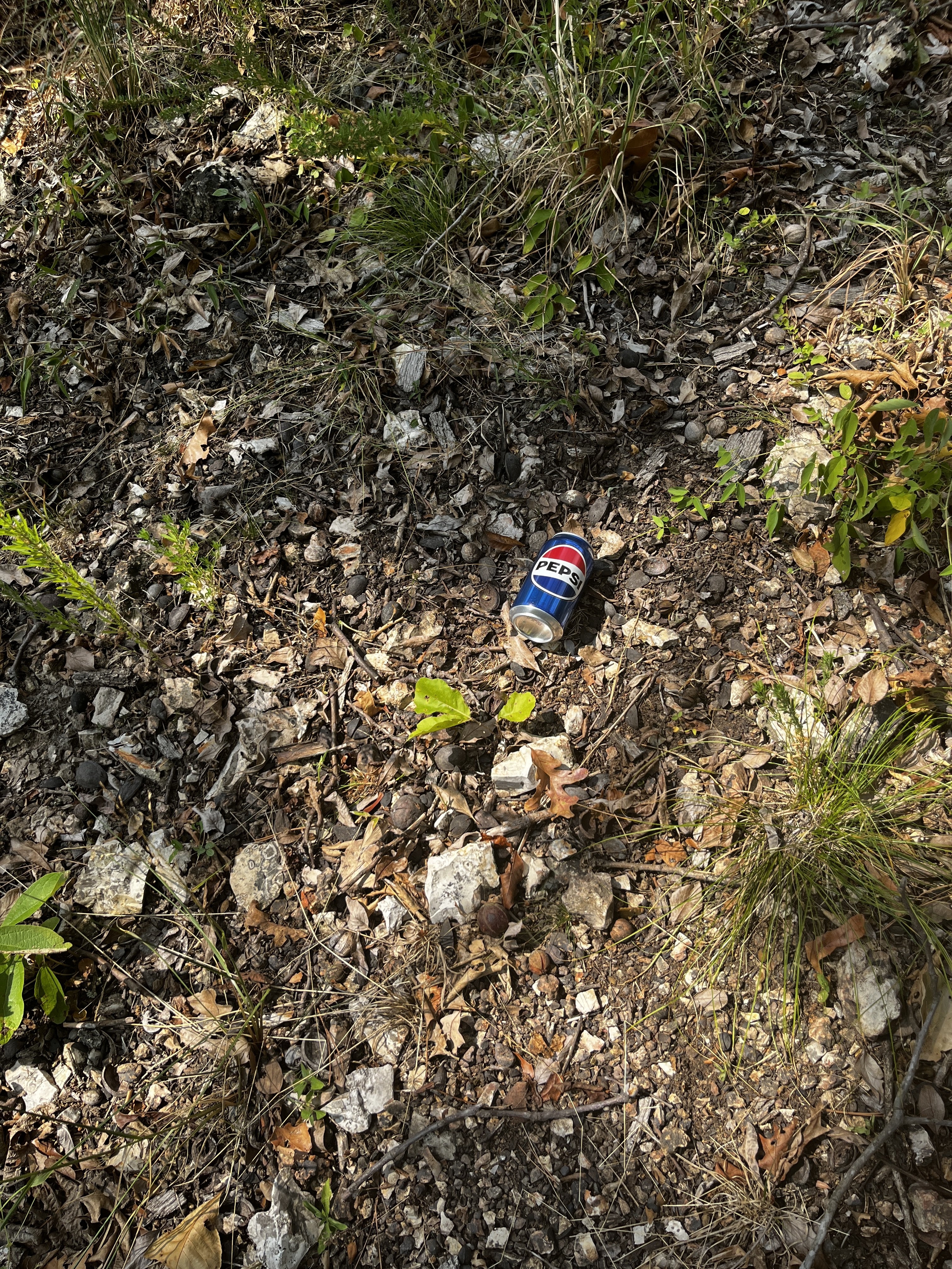

Great point… we’re right around 1,310 ft. MSL, so I think we’re good.
I am dealing with a lot of broken up shale rock embedded in soil to carve out access roads/trails in hilly (max 10-15%) sloped terrain, but mostly 5-10% slopes. So, considerable box blade and rock bucket work. I can take my time here.
Also have woods to clear and stumps to grind/backhoe out. For me, really just trying to make sure with a loaded bucket that I don’t get too underpowered to manage those slopes.
