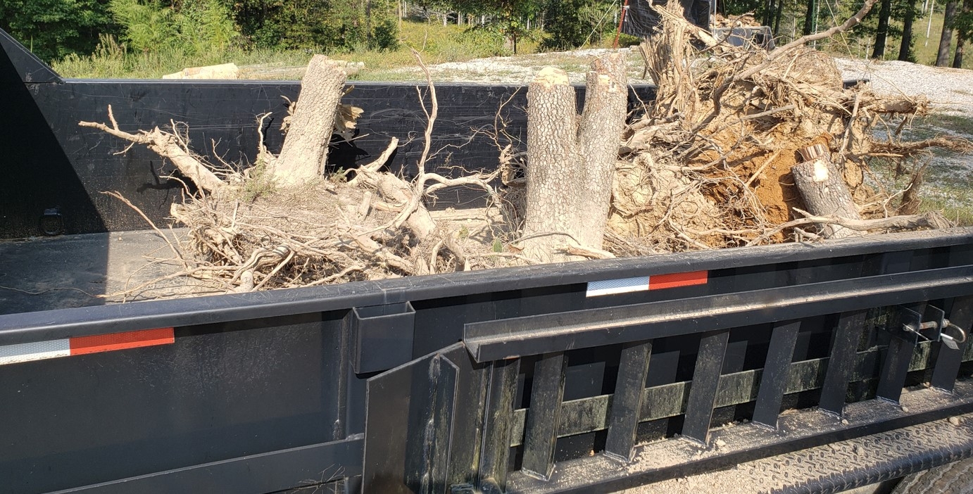

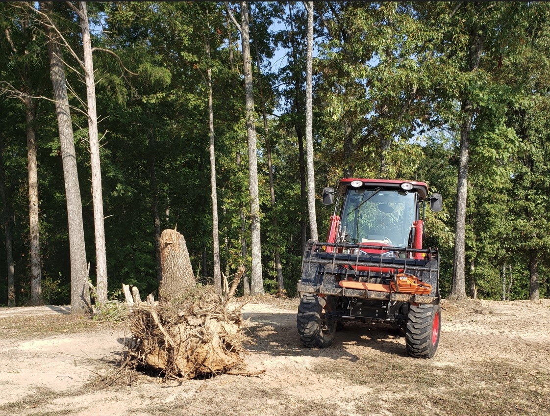

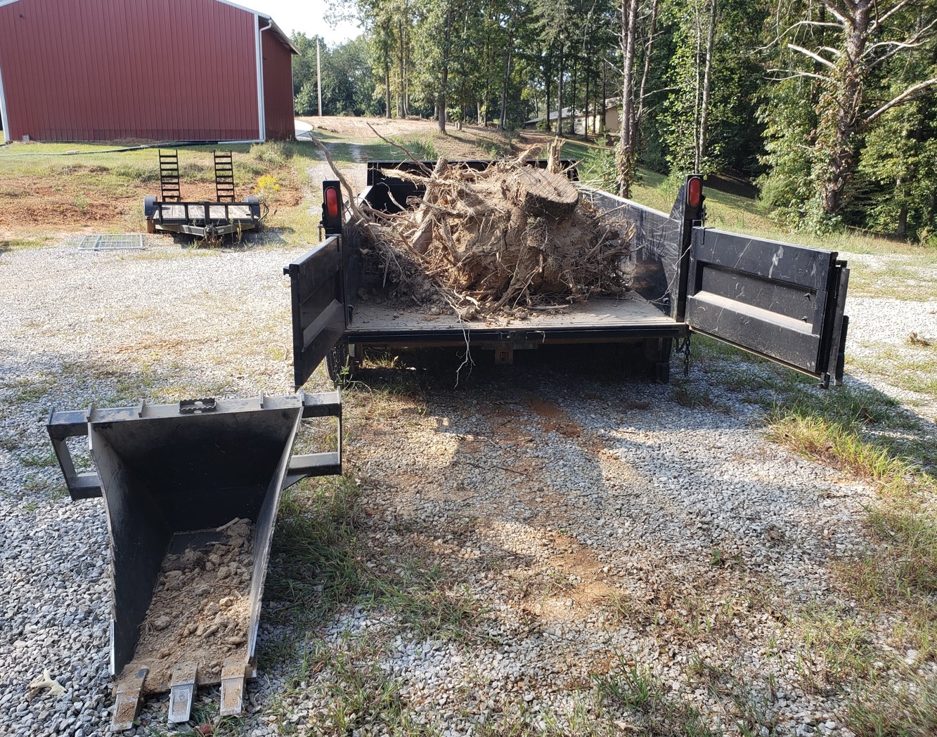

I had this same option and I decided on the T494. I have hilly property, some fairly steep stuff that I mow. I also stump grind and just recently got a stump bucket which works great! The TYM replaced my Kioti NX50 which I used for the same stuff but it had too many issues so I traded in for the TYM without all the BS electronics that causes many problems.
You can possibly save some money if you buy the TYM RK55 version of the T574. I probably would have done this if I didn't need to trade-in.
View attachment 1288614View attachment 1288615View attachment 1288616
I was curious how well these stump buckets worked. Great pics! I’m curious if you have sloped areas if you ballasted the tires? I’m really concerned about rollover where I am.

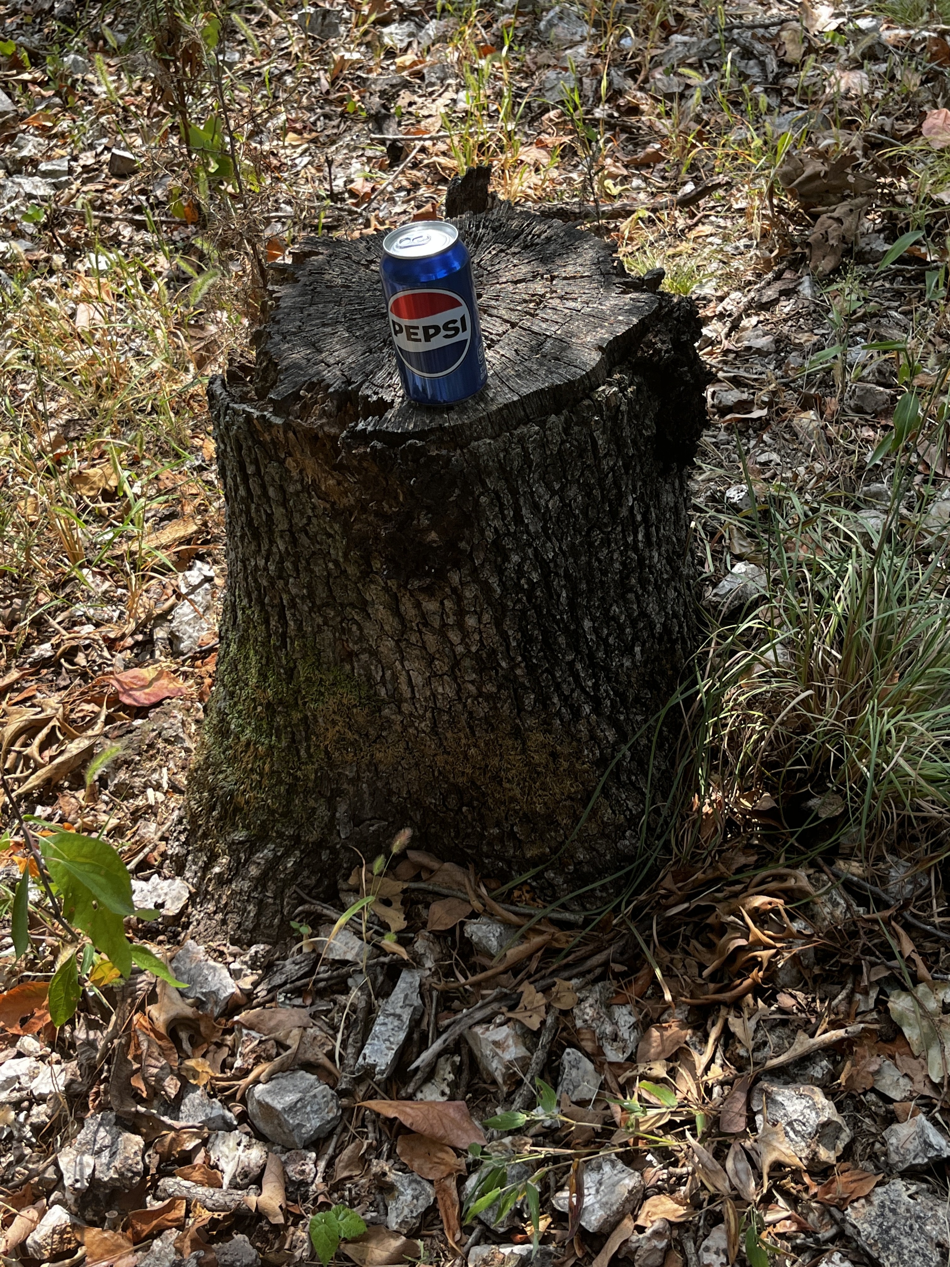

Here is typical of what I’m dealing with. Refreshment added for scale. 😉
Yes, the rear tires have liquid ballast. My slopes are such that I could roll if I'm not careful. I mow straight up and back down the hills. I also got a Inclinometer to help keep an eye on it.
