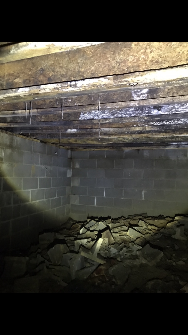

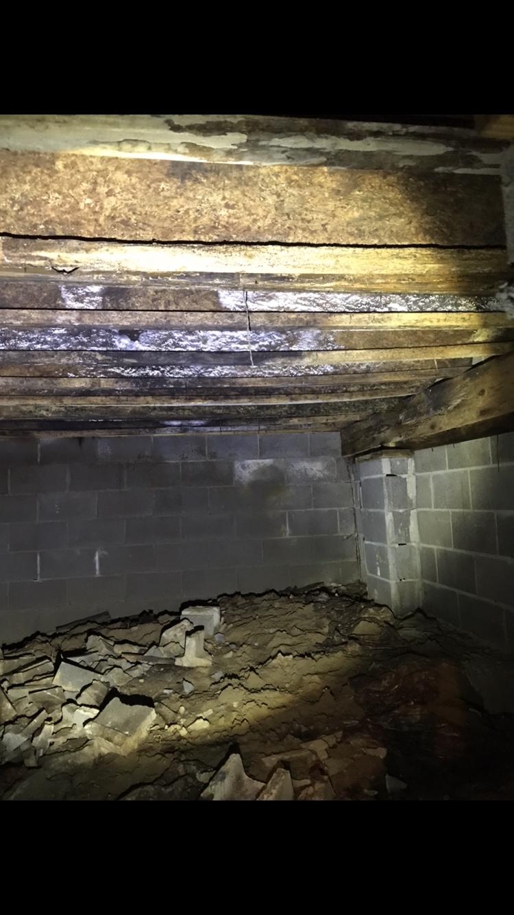

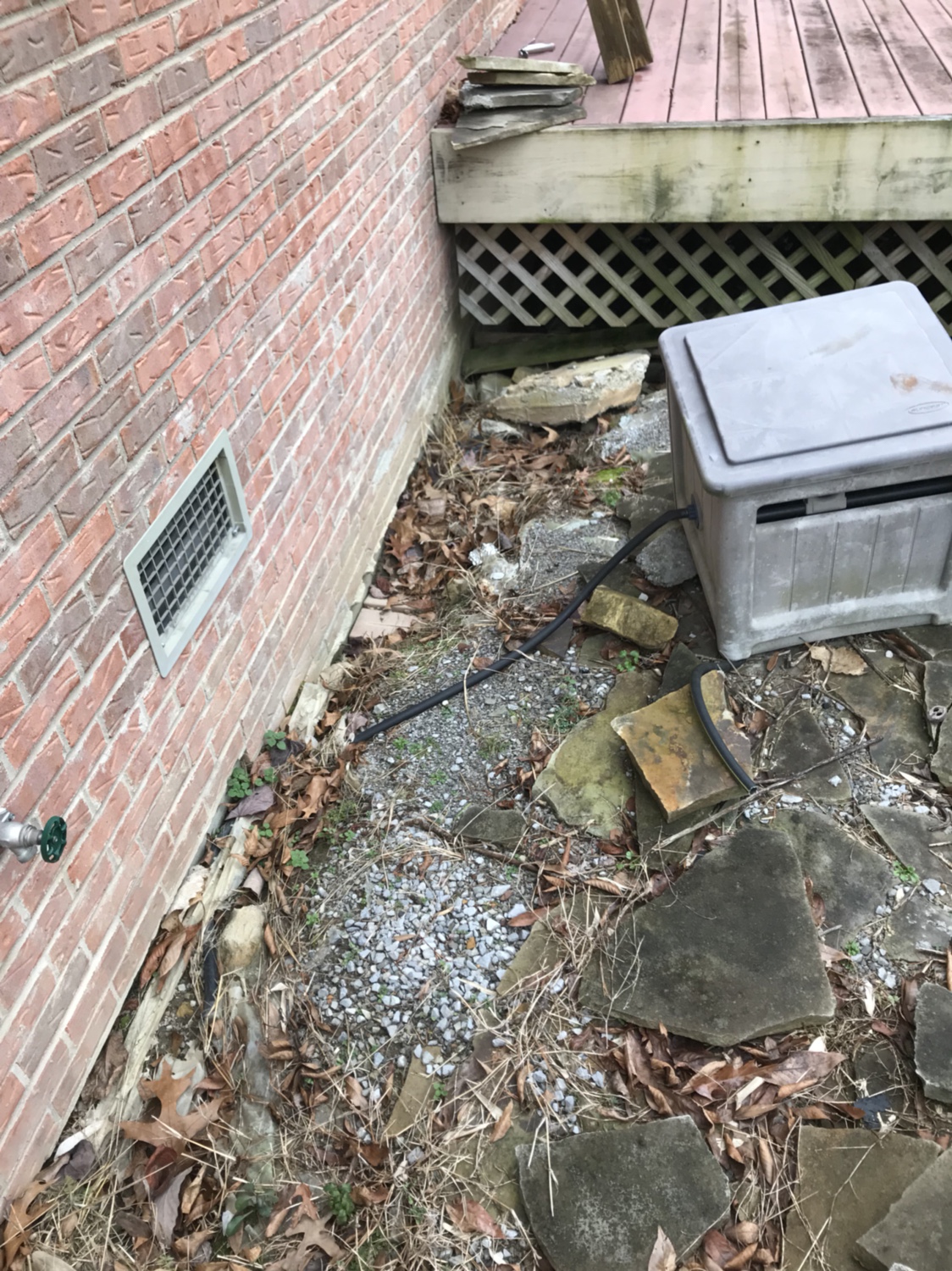

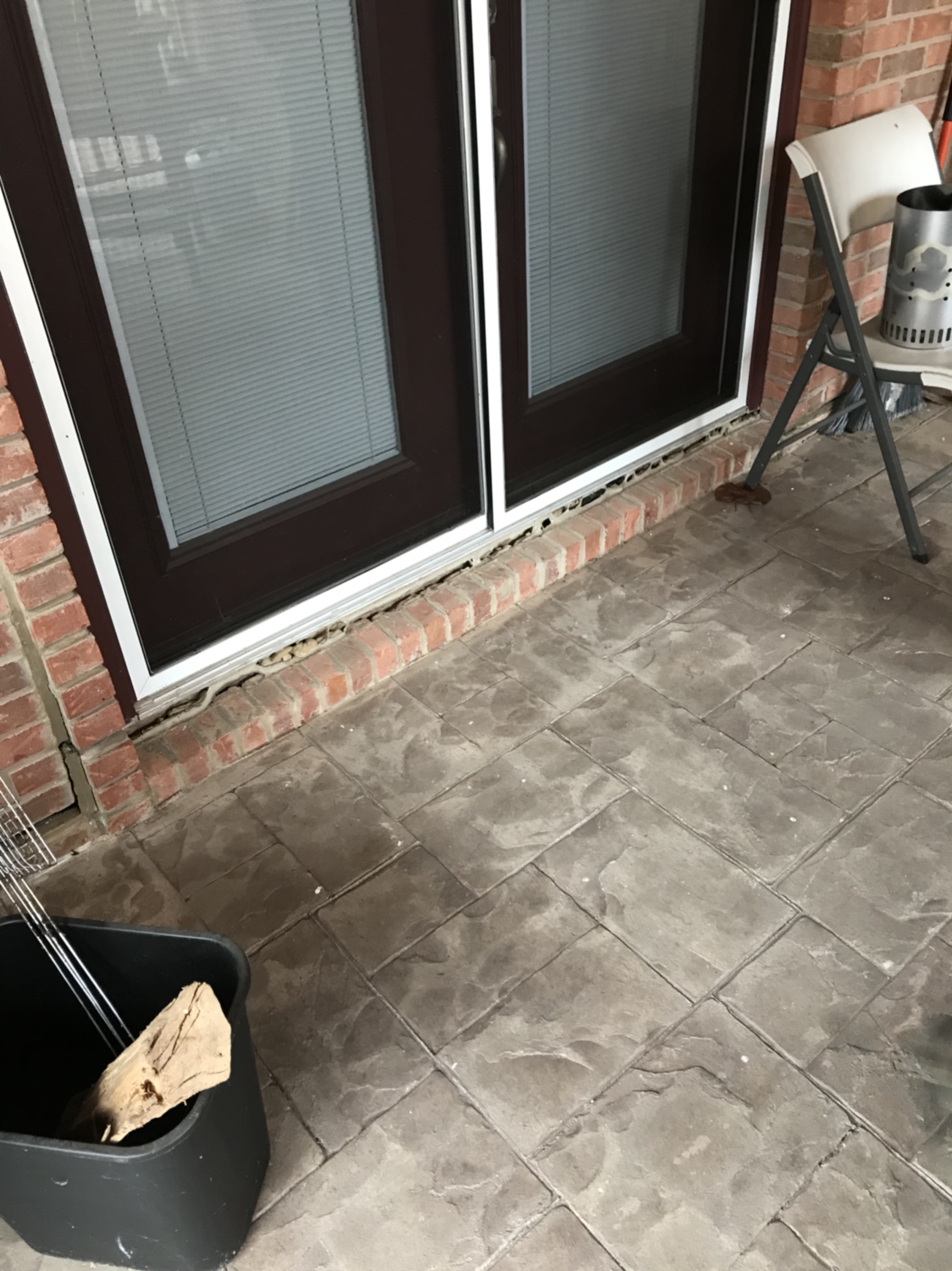

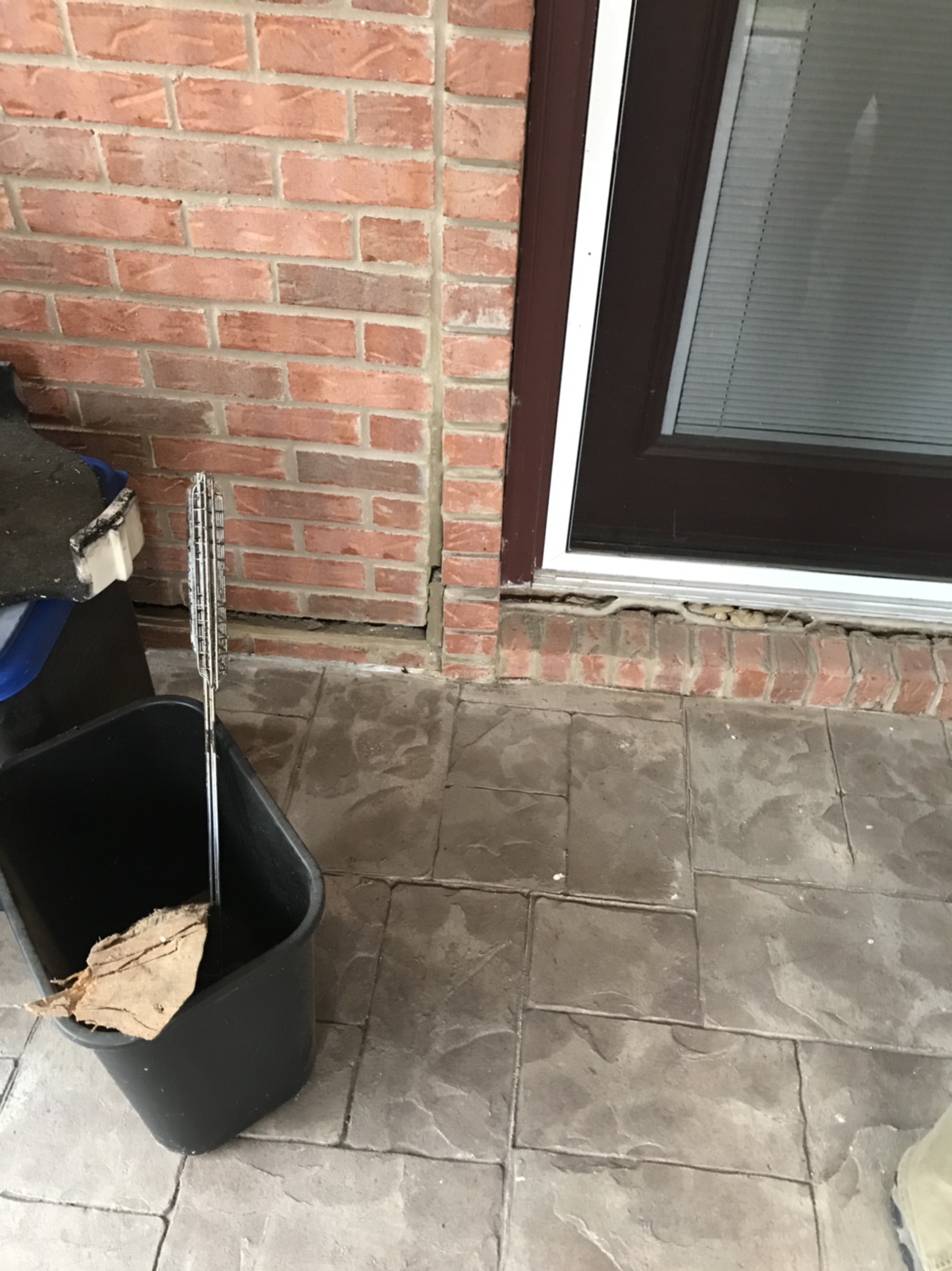

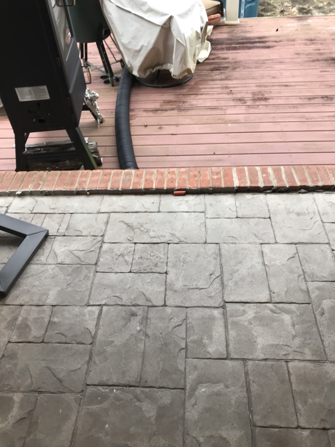

Under normal conditions no I wouldn’t unless done my way, but it’s my buddy’s and he wants me to help him. Some idiot poured his back pouch using manufactured joist and plywood to support the slab. To make matters worse he’s got water issues that need addressed. The joist that shouldn’t have ever been used like this have rotted and the concrete has settled about 2”. It’s not flush with the brick and even worse has broke the brick off. I don’t think the remaining brick has any support so it’s in danger of falling off. It would be possible to jack the slab back up but it would be dangerous so I’m not big on the idea. And he doesn’t want a concrete slab for some reason anyway. My suggestion was saw the existing slab out ( with the thought process that sawing would be less likely to make the brick fall off ). Then backfill the hole which will take about 40 yards of material then repour the slab. I’d feel pretty good about this being a lasting solution and assuming it doesn’t fall off during construction you’d have support for the existing brick back. For some reason he doesn’t want a concrete floor and wants wood. I’m afraid that even if the water issues was fixed and adequate ventilation was added it would still rot.

I haven’t calculated the load rating of the joist. Considering the concrete didn’t break and the joist didn’t sag during the pour maybe they didn’t do awful in that aspect. The biggest flaw was they didn’t have any other support for the concrete and they used a product not meant for wet location in a wet location. If the concrete had any means of support that didn’t rot away it probably wouldn’t have fallen in. IMG_1191.JPGIMG_1192.JPG

It’s actually stamped concrete not stone. If they had of supported the concrete better and only used the wood as temporary support they would have been alright. But the concrete is only poured inside a wall and once the wood rotted away its slipping down.
