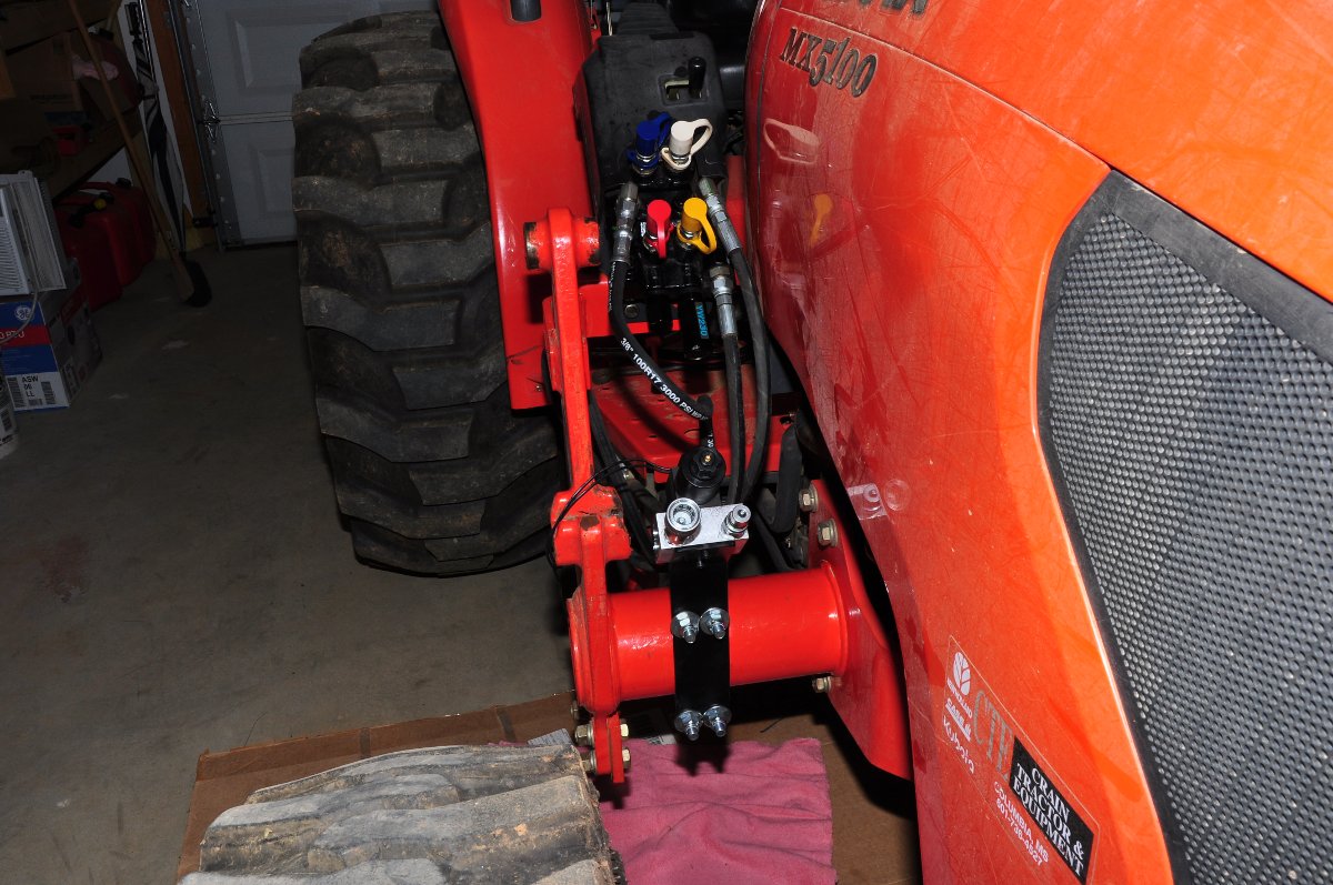

The P and T ports are correctly connected. In the picture below you can see your hose (with lettering) connected to my loader PB port. The other end of that hose connects to your P port.
In the picture I can also see one end of the brass rod in the center of the black end-cap nut (just above the two quick disconnects). I'll try and manually operate it as you describe. Should be "fun" trying to work in that space with the loader mounted and all the hoses connected. :(

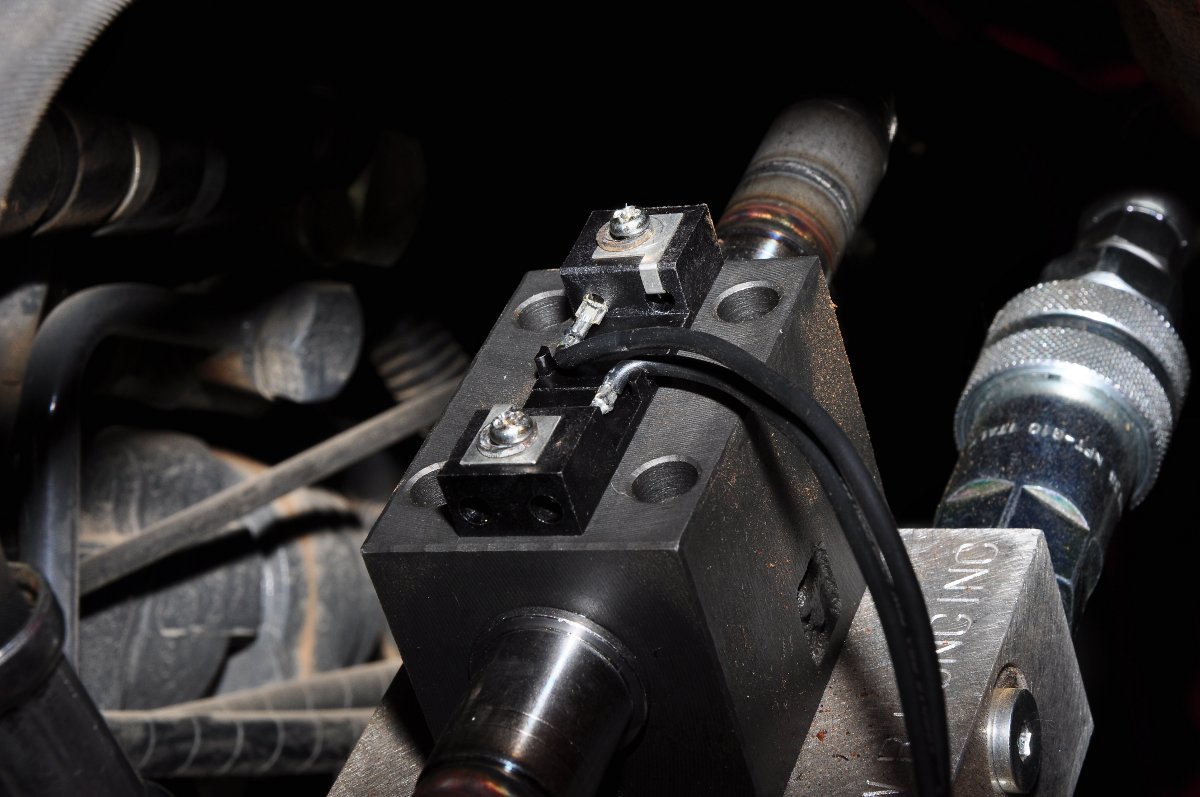

Nelson, I found the problem: The screws that mount the connector block to the valve body are a little too long, and they bottom out before making solid contact with the ground tabs (the square silver pieces under the screw heads in the photo below). I inserted a washer under each screw and everything now works. Unfortunately, the connector block plastic cap won't fit over the washers.
I called and asked Don to send a new connector block, hoping that the screws are shorter or the ground tabs are thicker.
Another option, I suppose, is to cut a couple of millimeters off the screws, but I'm loathe to do that because the threads are so fine.
Thoughts?

I fixed the problem by tightening the lower screw to about 7,000 ft-lbs. :) Although the screw was already quite "tight" right out of the box, it didn't make contact with the ground tab underneath it, and I was able to wiggle the tab with my finger. So I tightened and wiggled, tightened and wiggled, and tightened some more until I finally couldn't wiggle the tab. No washers needed. No screws cut.
Both solenoids now work correctly and the grapple is in operation.
