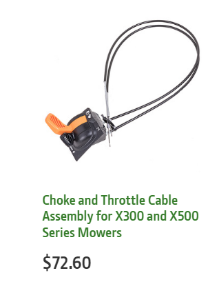

It is meant to be tossed and replaced unfortunately. I have had them apart and am unsure what you could do. They have a little detent and a tiny piece of spring steel that won't stay in place if I remember correctly. They are a bit of a bugger to unsnap from the dash. A look at the new one tells the story. The rest is pretty straight forward. Off with the hood, probably zip off the little exhaust shield for better access.

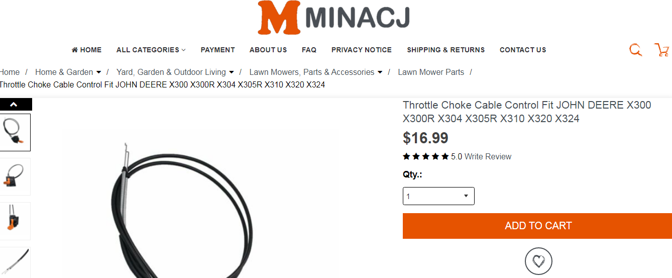

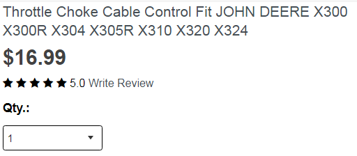

What ever you do, don't buy the assy from JD, here is the reason;
From another source:

As I stated, it's John Deere, therefore high priced. What is your other source?
