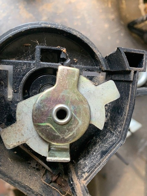

The throttle on my X324 will not stay where I set it, it creeps down until I notice that I am crawling along.
I took a quick look under the dash, the chock and throttle cables both go into a black plastic box without any apparent adjustments.
Has anybody else encountered this issue? If so how did you fix it?
I really don't want to replace it if it can be adjusted, replacing it will be painful as it is John Deere!

It is meant to be tossed and replaced unfortunately. I have had them apart and am unsure what you could do. They have a little detent and a tiny piece of spring steel that won't stay in place if I remember correctly. They are a bit of a bugger to unsnap from the dash. A look at the new one tells the story. The rest is pretty straight forward. Off with the hood, probably zip off the little exhaust shield for better access.

Check the speed control bellcrank on the front of the engine that the choke and throttle cable fastens to, it could be worn out. I have a 2015 S240 that the bellcrank is worn and won't hold full throttle.

Mapper - another thing you could try is to take the throttle/choke assy out of the dash and take it apart and see if there is some way to add friction to the throttle lever.
   / X324 throttle adjustment #11
This is the friction piece inside. It is riveted together. The one I described before was for a D series.
