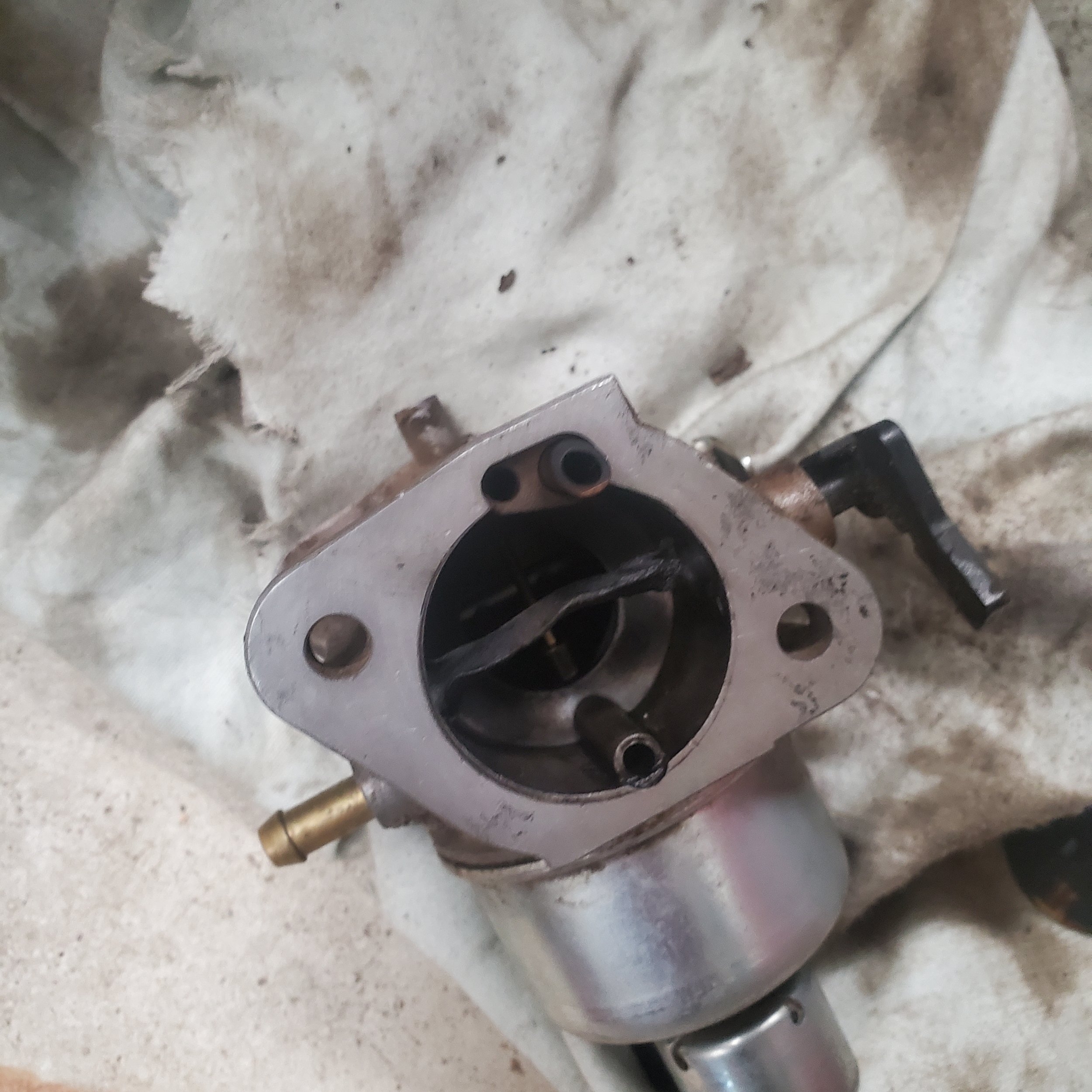

I have an X530 I've had for about 2 years. Late last season it started having an issue where it will stutter when I engage the blades at full throttle. Usually this happens when I've had to stop the blades to move something or back up without pulling up on the engagement lever, then go to restart the blades.
It almost sounds like its backfiring. It will go on for about 5 seconds and then resume normal operation. I figured it was a fuel flow issue, but then I noticed that it doesn't happen when I do it at half or less throttle, then go to full throttle after they're engaged.
I've had some other issues I've fixed and things I've tried so far that I thought could be contributing, but the issue remains. So far I've
had an ignition coil go out and replaced
found my choke lever wasn't returning to the open position, but fixed that too
gapped and replaced plugs
Any thoughts on other causes?

Can you slowly apply the choke to see if it runs any better When it is running rough? Might help point towards fuel vs spark issue.
A stutter may happen when starting a mower deck and is caused by a lean fuel condition. Agree^^, test this by having the choke partly pulled when turning the deck on. If it takes care of the stutter, there may be a little debris in the main jet circuit that is causing the problem.
   / X530 Issue Troubleshooting Help
I'll try the choke idea as the problem started about the time I found out I had a sticky choke. I fixed the sticky choke and the stuttering started.
If that's the case I'll have to pull the carb and clean it up.
Thanks all. I'll update next time I cut the grass.

The little node light testers aren't worth much. The light with about anything. Two barrel or single carb?
