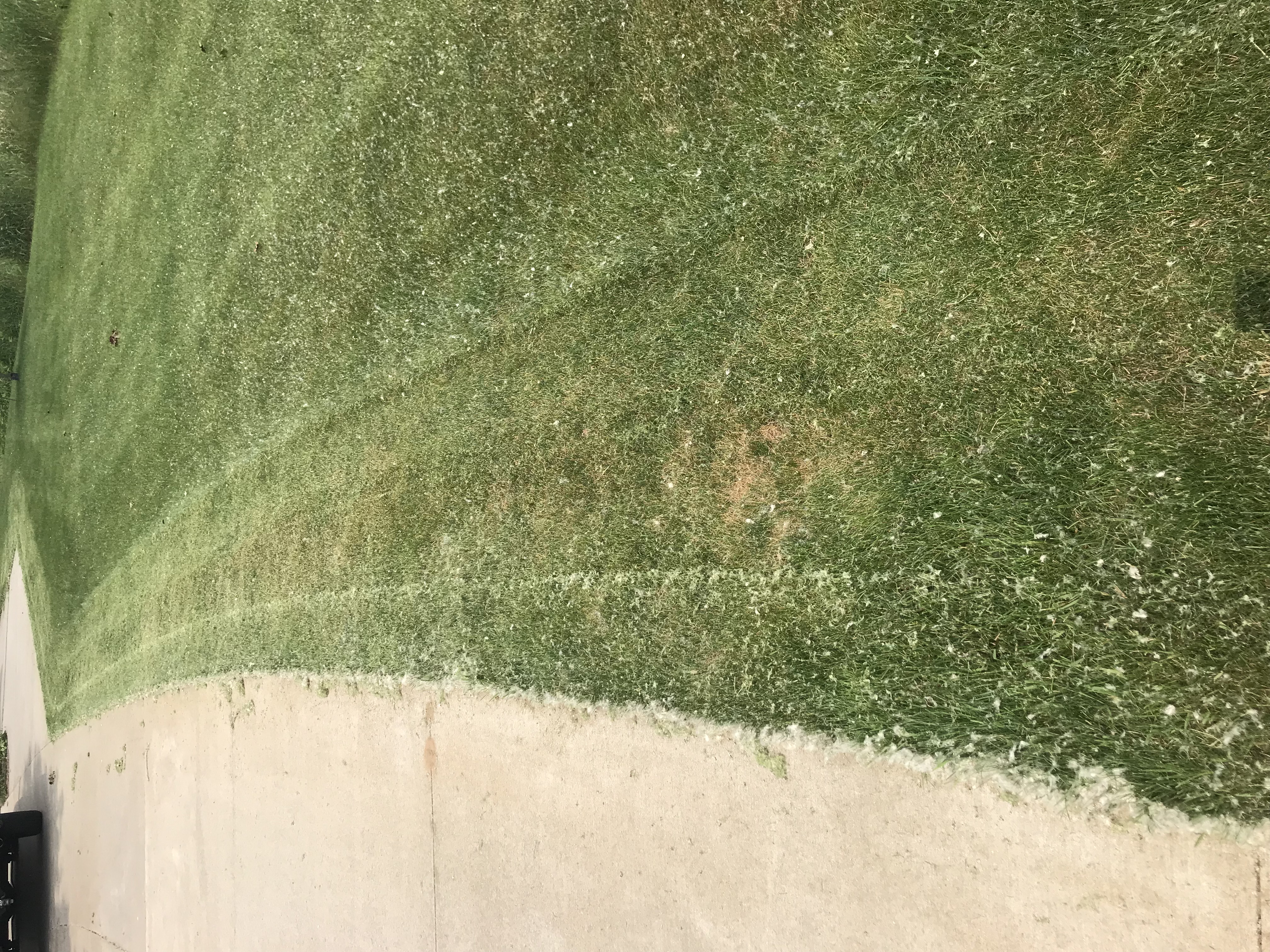

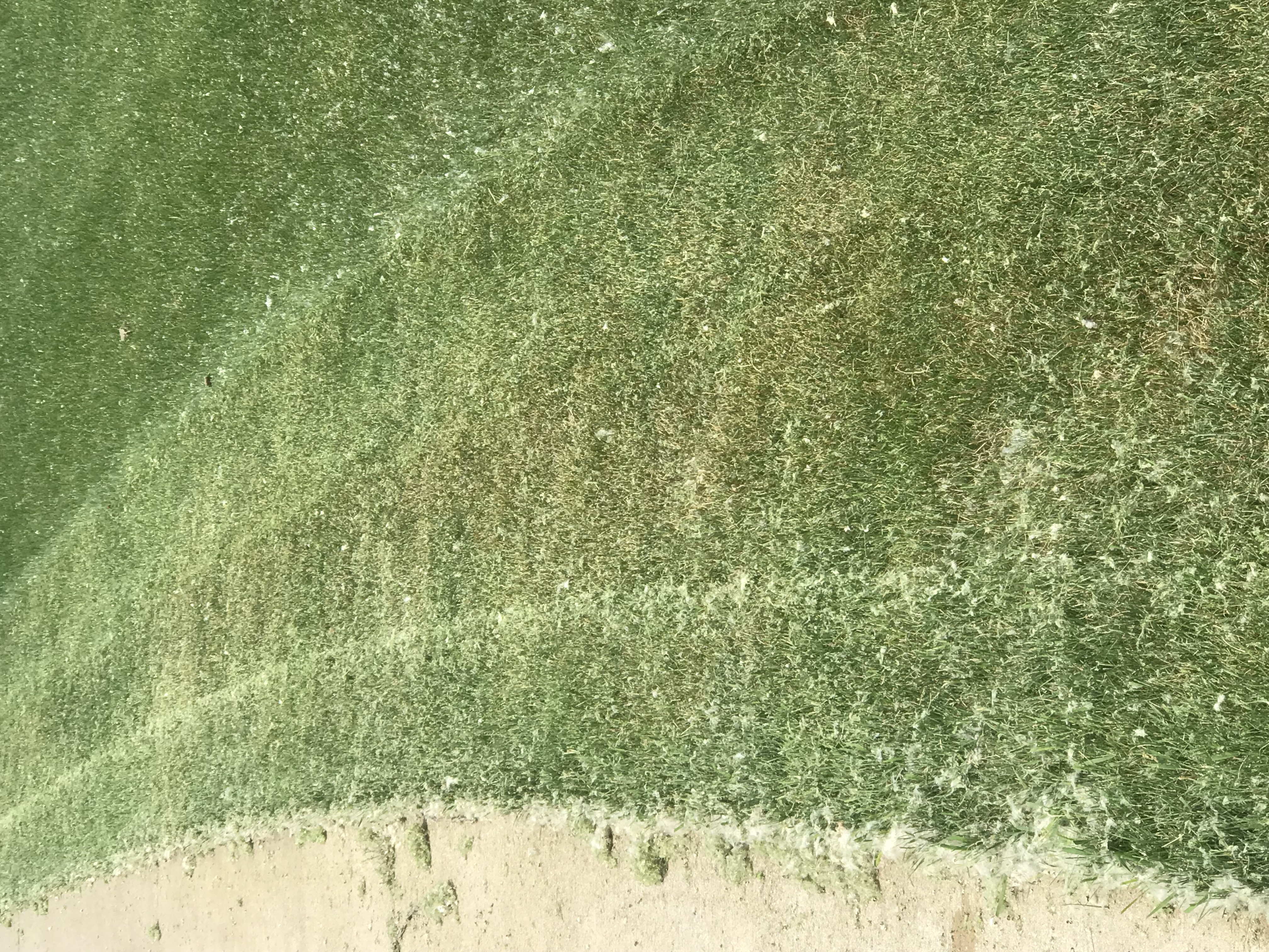

I've been having some issues with the cut quality on my X570 with 48" Deck. I have the mulching kit on and it seems like I'm always getting strips of uncut grass. to me it looks like its coming form the center of the deck but i'm not positive.
I checked to make sure the deck is level and the tire pressure is correct and everything looks good. I've tried overlapping cuts, changing the height of the anti-scalp wheels, changing the cutting height and so far nothing seems to make a difference. I talked to the dealer I got the unit from and he's saying I need to keep experimenting.
Does anyone have any idea's to help me fix the issue?

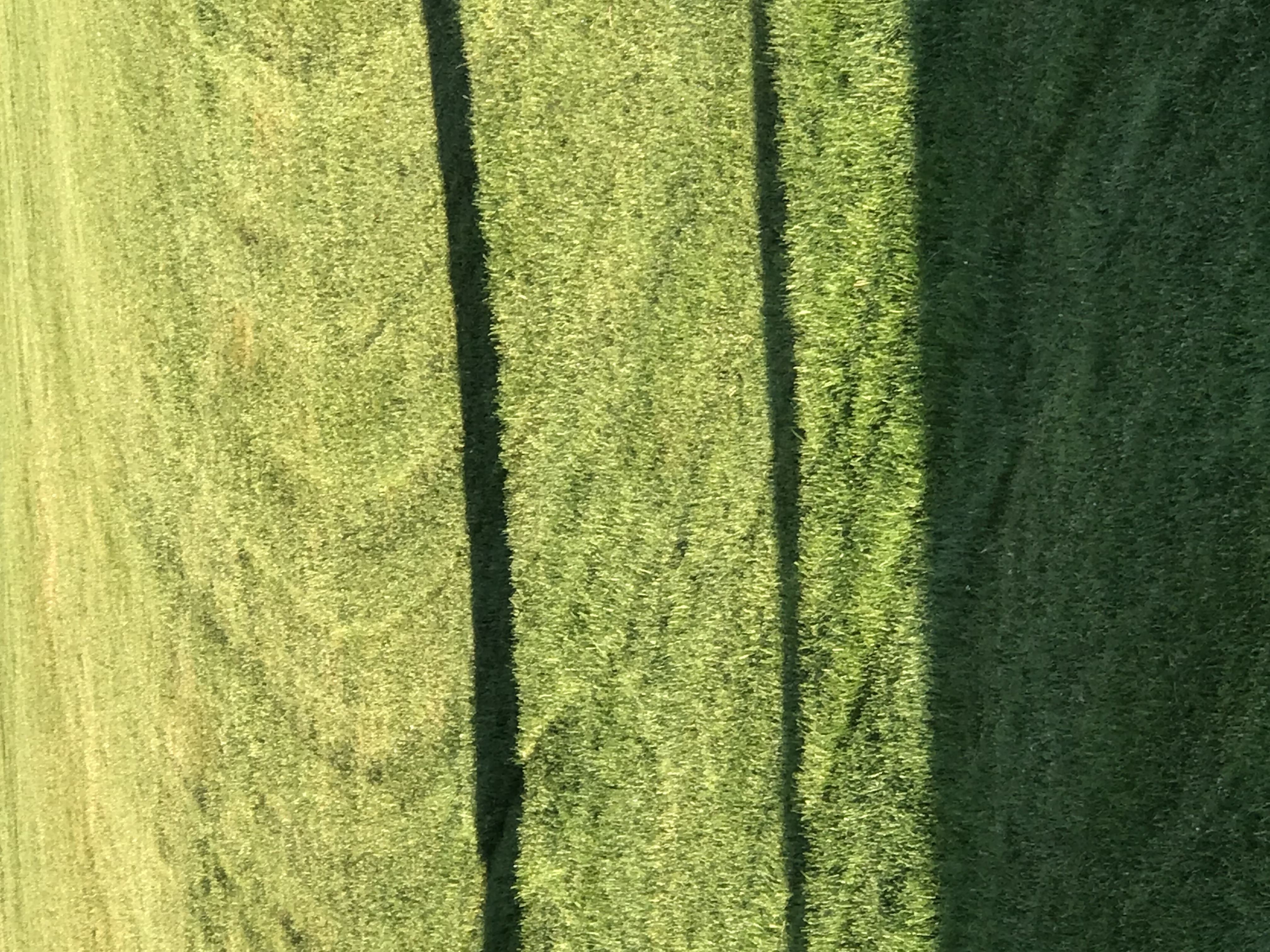

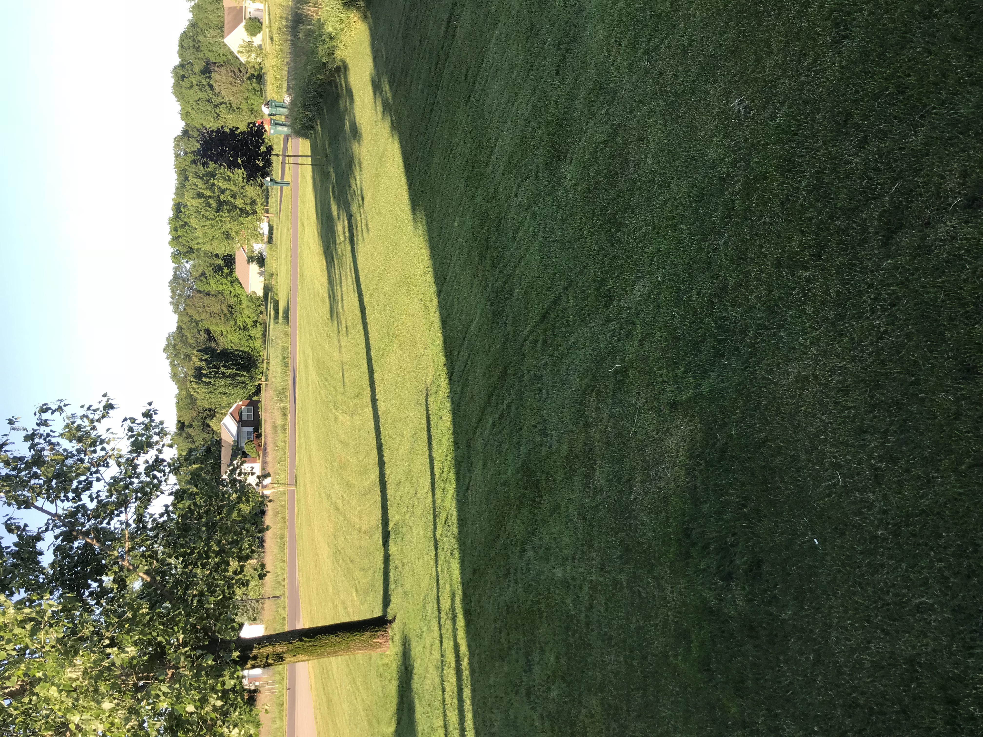

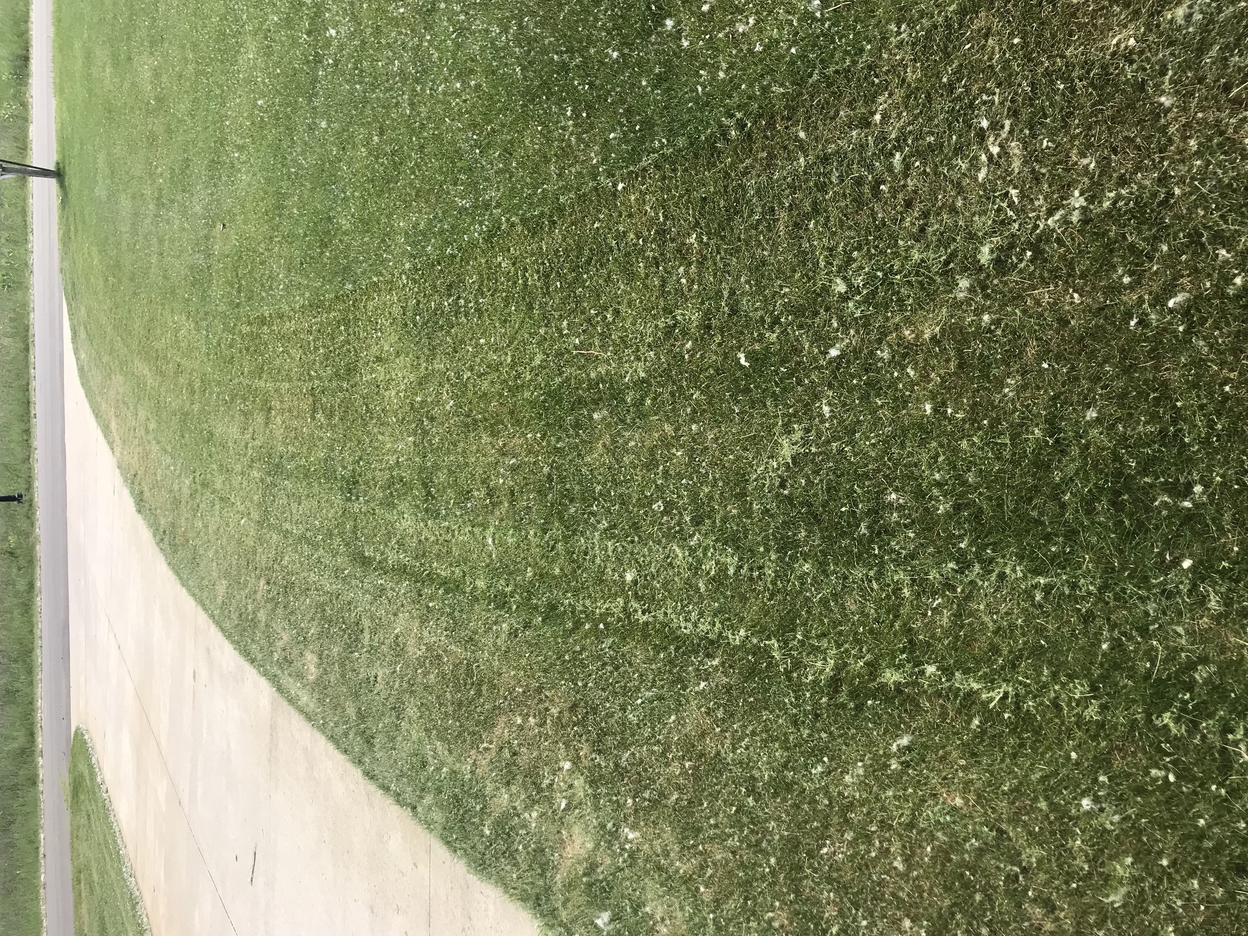

Thanks everyone for all the replies. I apologize for not getting back sooner. I was traveling last week for work.
I have been running the throttle at full speed to ensure that the tip speed is up. I will plan on getting the gauge and checking the blade heights. I'm also going to look into the blowout kit to see if that helps.
I see a lot of people are running different blades than what comes in the John Deere Kit. Is there a recommendation for a better blade to be using?
I mowed yesterday and this time set the deck up a little higher. I was wondering if I was mowing too low and causing the deck to get bogged down. I didn't see much of a change.
I've attached pictures of my first pass as well as my second pass. The second pass is in the opposite direction of the first. I'm also battling the poplar tree fuzz right now too so that is making a huge mess.
