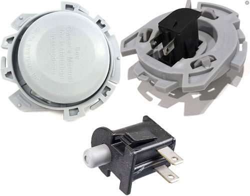

We just bought a JD X570. Love the way it handles, but the seat switch is far to sensitive: if I shift my weight slightly to one side, it shuts down. Sometimes if I lean forward to duck under a tree branch (with my butt still planted in the seat), it shuts down.
I don't want to simply bypass it entirely. Is there any way to make it less sensitive?

The seat and switch will get less sensitive as the seat begins to wear in a bit. Right out of the box the seat cushions are quite stiff. So if you can put up with it for a while it should get better. Many times I will lean over on my X500 and the engine will start to stumble and I can sit up and stop it from shutting off.

With a little persistence you can reduce the sensitivity and keep switch function by either padding above the switch assy or shimming between the little switch and its cover inside.

Not sure about your model, but often the switch assembly unscrews from the bottom of the seat. Then you will see it’s just a switch that gets pressed when weight is applied to the seat above it.
What is happening is the switch isn’t being pressed enough when you shift your weight. Perhaps inspection will reveal an easy way to shim the switch so that it gets pressed sooner or easier; or a way to extend the seat area that triggers the switch.

This is what the seat switch looks like. It's like a hockey puck with a plunger switch inside. JD only sells it as a complete assembly with puck and plunger. Third parties like Stens sells the plunger switch separately. As you can see it can be easily disassembled by releasing the tabs. As a previous poster mentioned, you can increase the sensitivity by placing something soft above the puck or by inserting a shim between the top half of the puck and the plunger switch.

BTW, not that this will solve your problem John, if you set the parking brake the engine will stay running when you get off the seat. As for sensitivity, you can try the ideas above or just have your dealer adjust it. Most likely they would replace the switch and if that didn't work replace the seat.

Thanks, Crazyal. It's not an issue of it shutting down when I get off the machine (that was Beenthere's comment). I knew about the parking brake, so can set it to keep the engine running if I step off (you do need to shut down the mower deck, which is no problem).
Thanks for the shimming suggestions, folks. I'll take a look at that, at least until the seat breaks in a bit.
