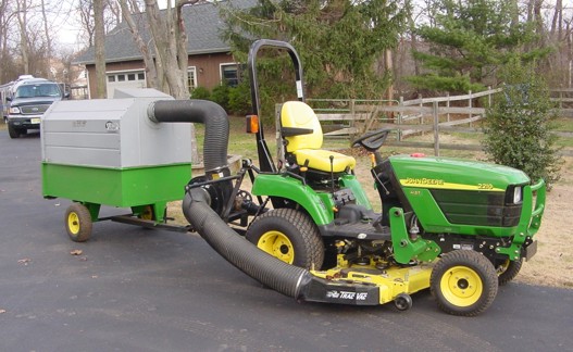

One of the posters here has a Deere MC519 collection system on his 2210. If you do a search, you should be able to find it. BTW, go with the 62C MMM. /forums/images/graemlins/tongue.gif

Was at the dealer this afternoon, and he told me that JD will have a collection system available for 2210/2305 by spring. JDFAN you’re talking about the post between jdepetri2210 and me about the collection system on he's 2210. He installed a power flow unit on he's 2210 with a bagger for an x-series tractor on he’s 3pt. I was going to do the same thing on my 2210. I ended up getting a model 854 rear pto drive trac vac cheap. Glad I did it‘s a great unit. My father -in-law took the power flow unit I bought and is building a system like the one jdepetri2210 has on he's 2210. Collection system 2210
