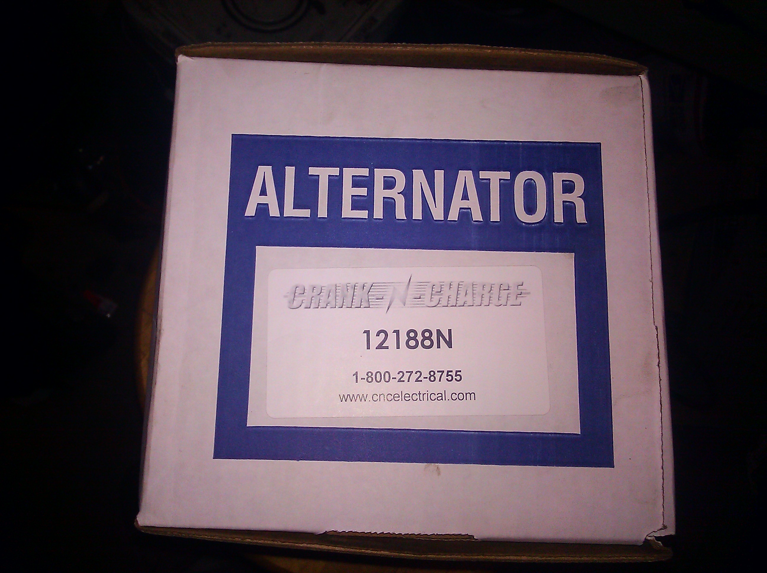

dave if you can please supply the part number you bought we can figure out from that what you got.

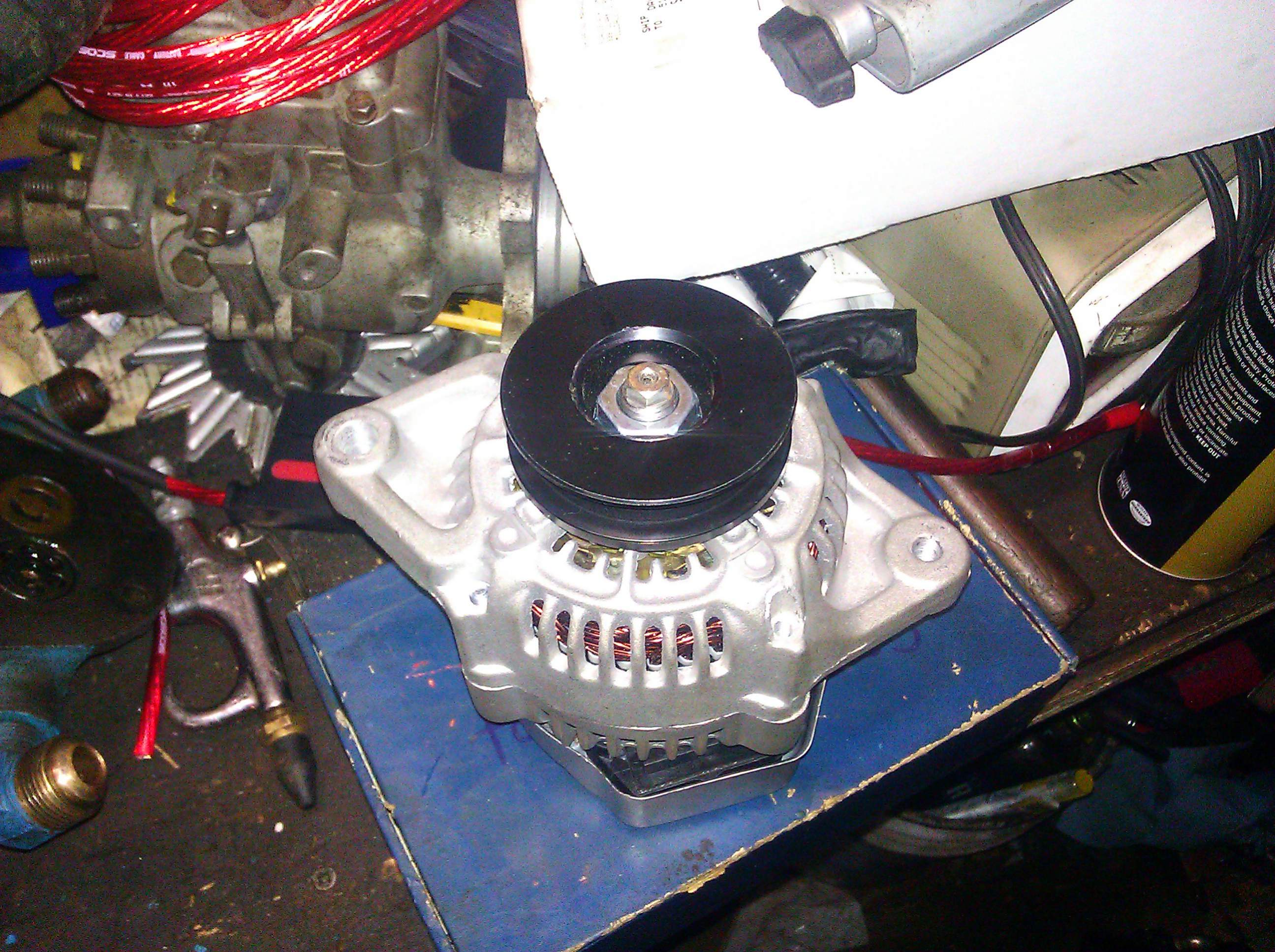

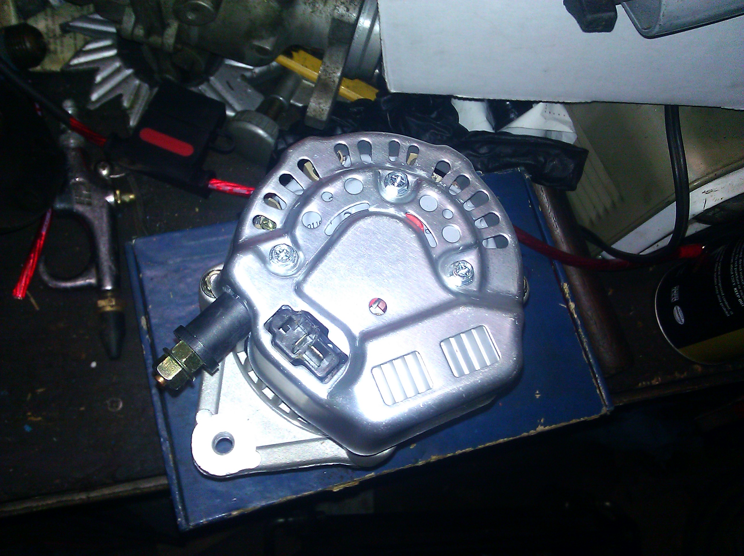

The alternator i have has the same plug as the little 20 amp alternator. One horizontal and one vertical spade in a "T" arrangement.
Part number is 12188N.

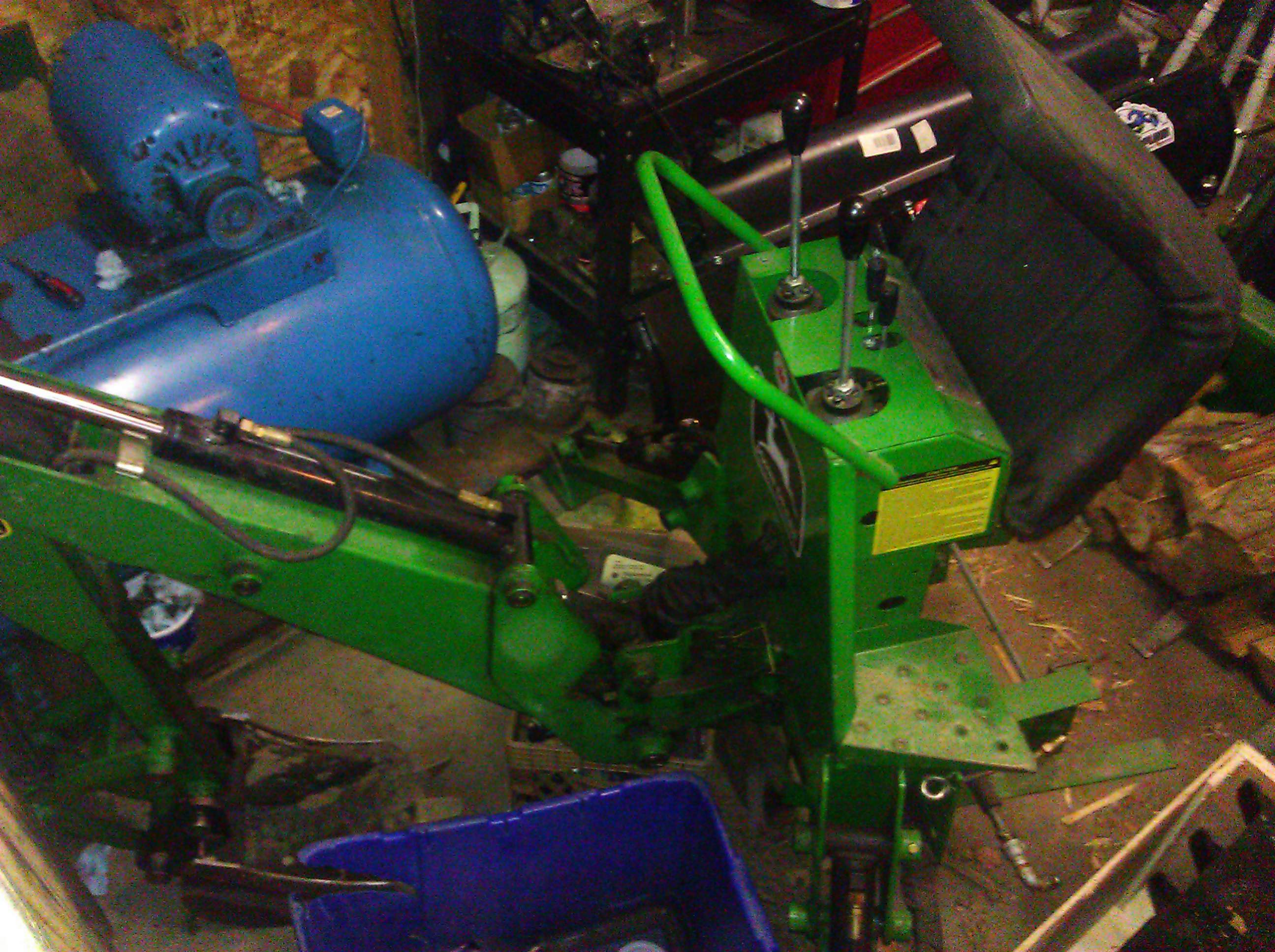

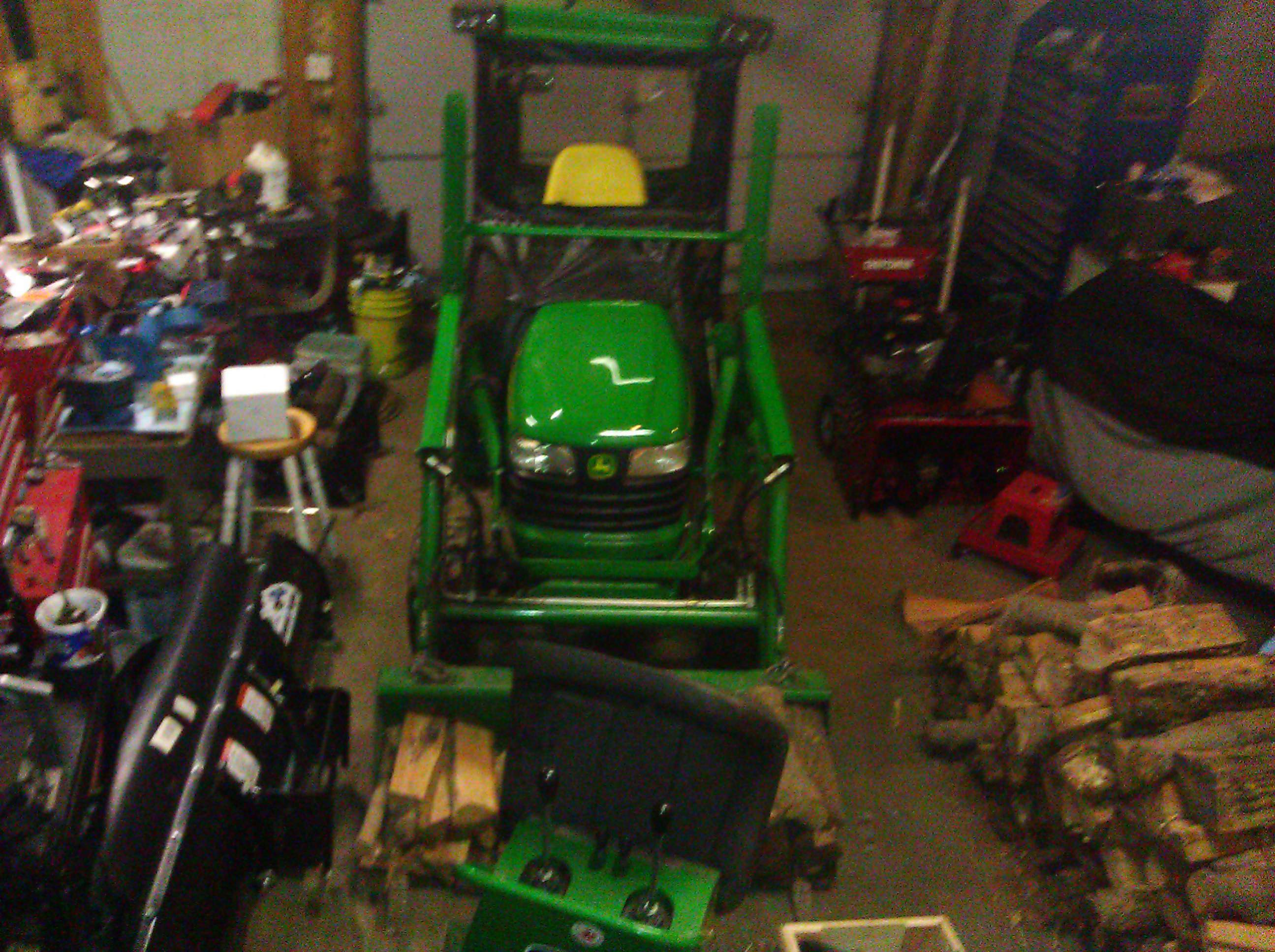

Here's a few pictures of both the alternator and the X595 itself, with a few attachment goodies too.
I'm guessing the forum really compresses the files, as they were much higher quality before being uploaded.

now that we have picture and thanks for buying this from a georgia company have dealt with these guys for over 25 years you probably did it all by the internet. the 't' plug is set up like this if the plug looking at it in the shape of a 't' the top spade is the igniton wire the other spade is the the light if so equipped if you would rather not do this call your local rebuilder ask him to get you a transpo self exciting regulator number in254se by installing this all you have to do is hook up the battery post and off you go no wire need to be hooked up to the 't' plug. also the denso number for your alternator is 100211-4530 or 100211-4531 which by the number change only means denso did a cosmnetic change to the alternator and any rebuilder can rebuild this unit has a very good life expectancy. if you want to do this and cant find the regulator just repost i will put you in touch with someone who will sell it to you soory the 'l' terminal drive a choke for vehicle with electric choke does not run the light

the most common brand of this regulator is transpo in254se if will replace inside your alternator the regulator you now have he may have it under another number but he will know what you are looking for . as far installing it you will need to remove the back cover of alternator if you dont feel safe doing this he has probably done hunderds of these over the years should take him about 30 minutes or less you can now eliminate the external regulator if you have any more question just repost
