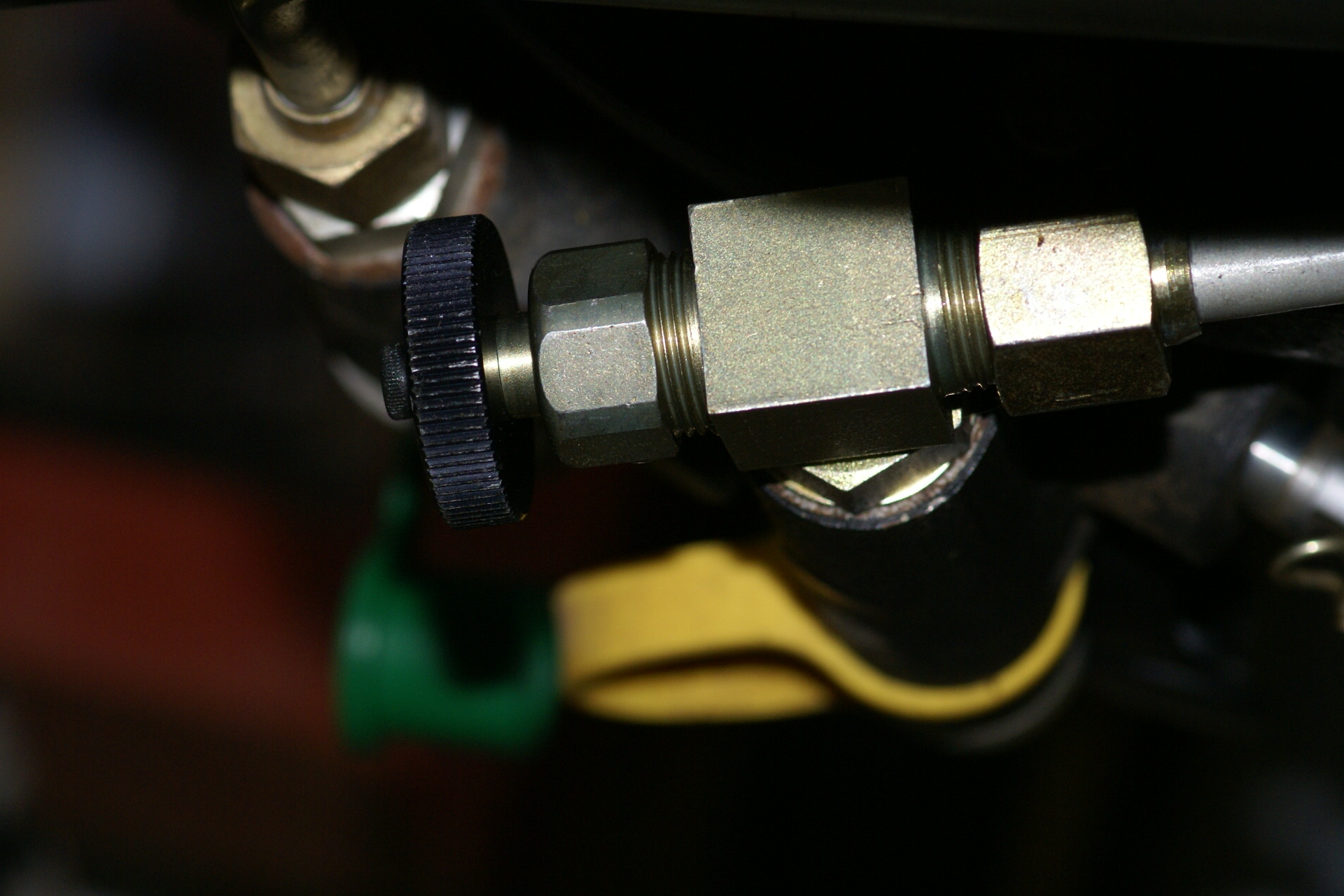

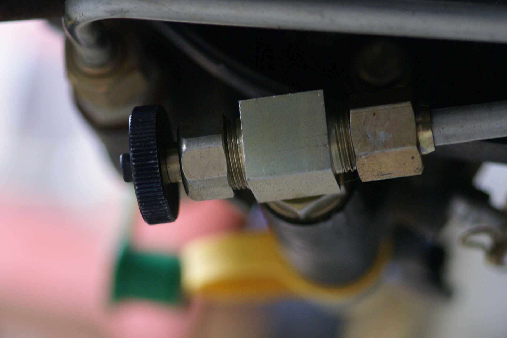

There was a post on another website about the lockout valve rubbing on a hydraulic line to either the hydraulic motors on the full time 4 wheel drive tractors or the power steering lines. I don't remember which line it was but the poster said the lockout valve eventually rubbed a hole in the line. He recommends that we all check and install something to isolate the valve from the hose. I am going to check my X748 today.
   / X700 Series Hydraulic Lock Out Valve AM134625 Installation #22
Thanks guy's I'll leave the tape in the tool box.
   / X700 Series Hydraulic Lock Out Valve AM134625 Installation #23
A small scrap of the black foam pipe insulation should solve the chafing issue and is dirt cheap. Any plumber you see should be able to give you a 6" length of it for nothing.
