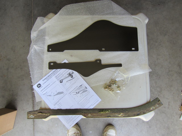

Those 62" decks can be configured a few different ways with different inserts and plates on the bottom side. Is the OP's deck set up to mulch or side chute? I installed the anti blow out kit on my deck because clippings were blowing out from the left front corner. It helped quite a bit.
