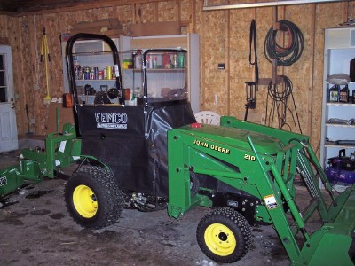

We had about 9 inches and wind. There is a 6 foot drift across my patio and back shed, care to lend me that blower? Well at least I have a windbreaker on mine and I stayed warm even in the 30 mph wind we had that day.(added a piece of plexiglass in back tied to the ROPS to keep the wind off my back) It took over an hour to push a 3 foot drift out into the field where it came from.
