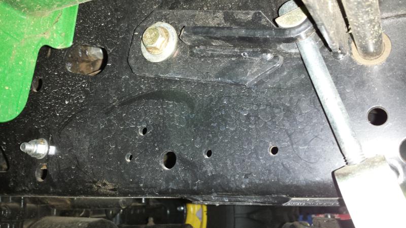

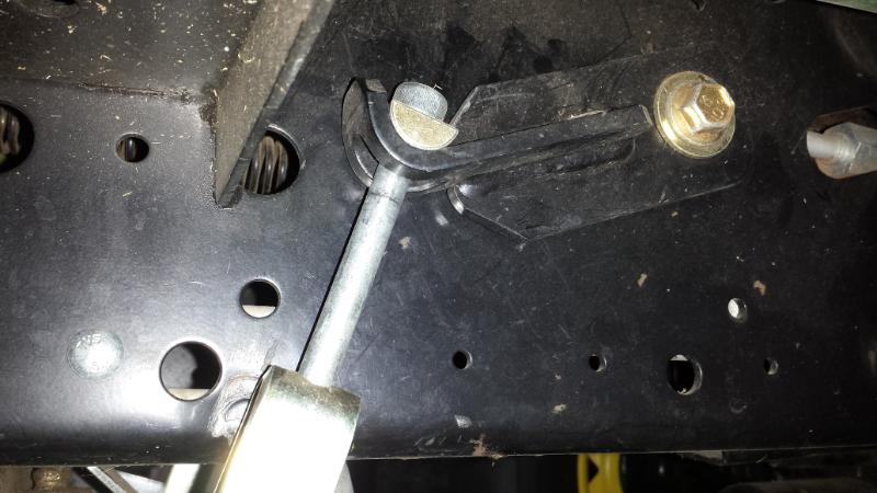

I bought a X758 mower in October of last year. Excellent tractor but the 54" deck would not level properly. When I wanted a 2.5" height I had to put the dial on 3.5" and then the adjustments were way off. One side was adjusted all the way down and the other all the way up. I notified the dealer and he immediately came and saw what I was talking about. They took the machine back and "fixed" it and returned it but it still wasn't right. Instead of boring you I will say that it was back and forth 5 times for the same problem. Finally, with the help from this forum, I found the answer. I wish I could find the post that lead me in the right direction to thank the poster. It seems that the hangers underneath were not even. One was 1" lower than the other. They should be relatively even. I took two pictures, one of each side and attached the post that I had found herre. The dealer replaced the whole assembly which includes the rockshaft. It has since been returned and much to my satisfaction it is all right in the world. I am reposting this because if two of us had this problem there may be more of you out there. Right side lift arm.jpgLeft side lift arm.jpg0001951551____________B1.gif

Any one else have this problem. I just measured the arms on my x750 and the above pics could just as well be taken of my tractor.

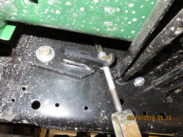

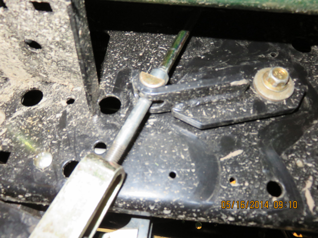

Yes, my deck is not level, well it won't stay level, usually have to adjust it before I mow and I can only adjust the right side downward. The pics above are representative of my tractor, the left bracket hangs lower than the right. Right now as it sits, the left bracket has no remaining threads to adjust the deck, meaning if the left bracket was the same height as the right bracket there would be another 1/2 to 3/4 thread remaining. Here are pics of the hangers on my tractor, the first pic is the left side, the second pic is the right side. As you can see the right side still has adjustment left, the left side has none.

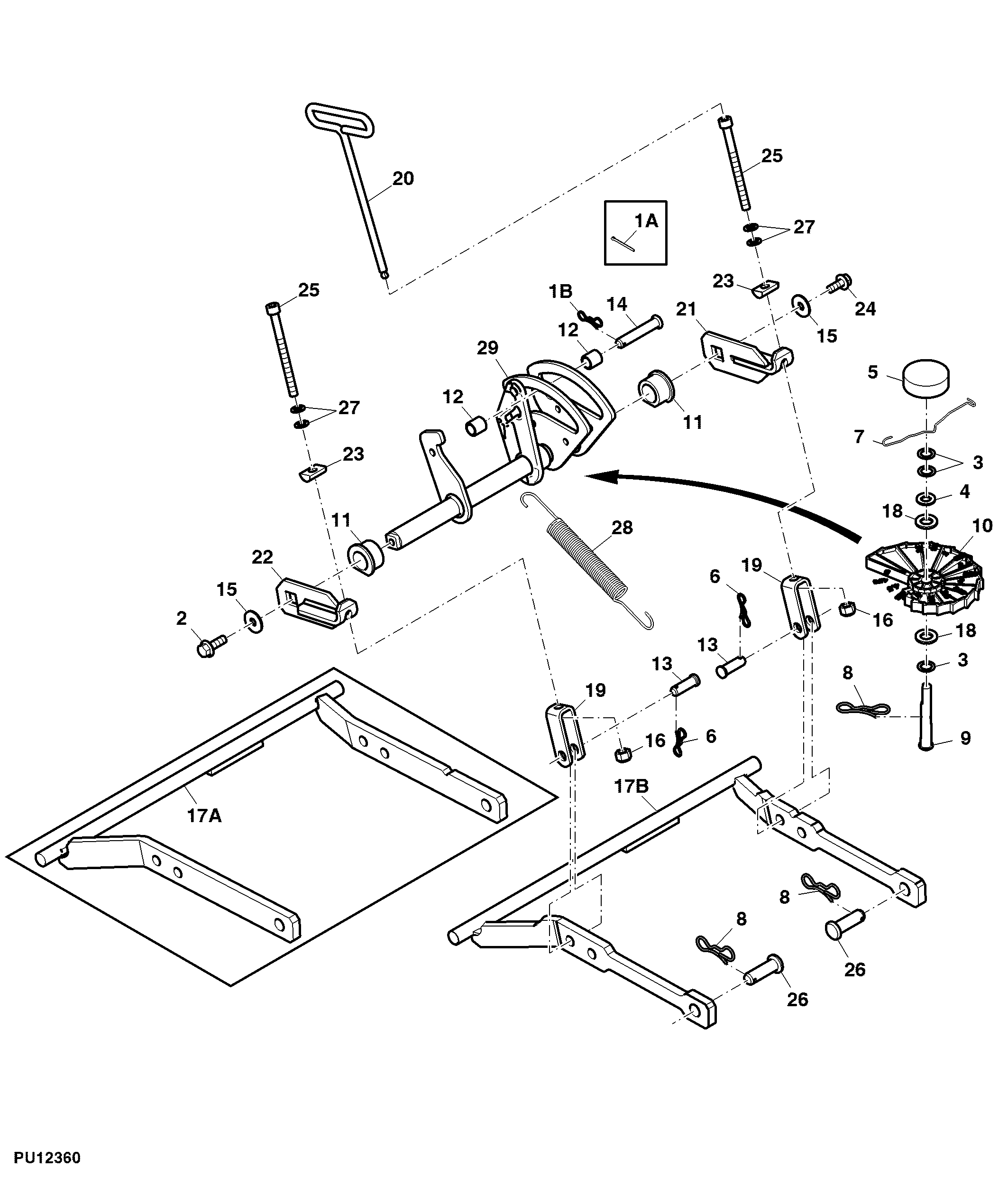

From the sounds of it, and looking at this schematic from jdparts.com, looks like a mis-manufactured rockshaft.
Note that the lift brackets can only go on in 90 deg positions, and yours look to be off by maybe 10-15 deg. But clearly time to get back to dealer and discuss the problem..

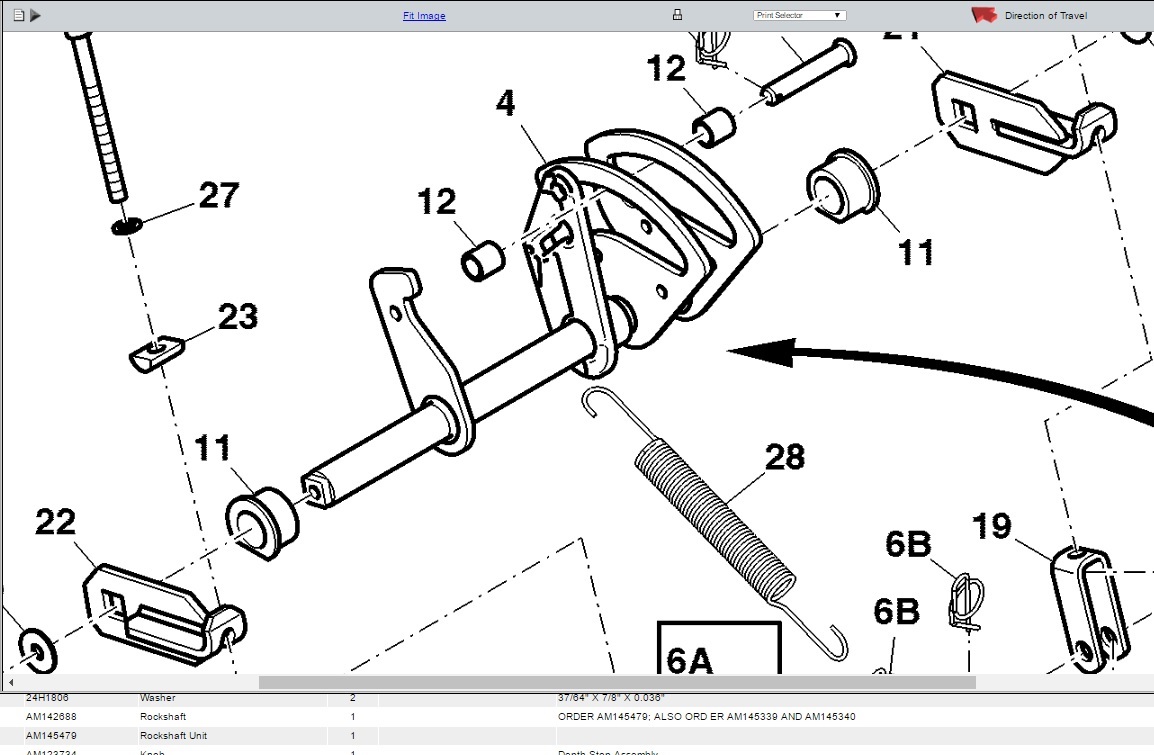

Deere had a design flaw and issued a Product Improvement Program to fix this issue. Ask your dealer service manager to look up PIP 14MX241. This fixed my dads and my neighbors X730s. There is another guy down the road with an X739 that looks like it needs the same update. His yard looks terrible every time he mows.

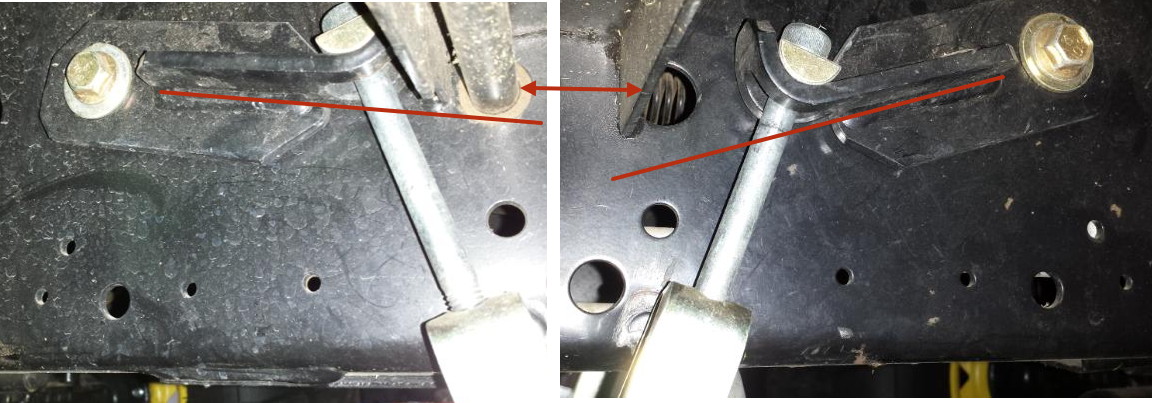

Those black things with the hooks that holds the leveling bolt heads aren't in alignment.
The two-pointed arrow shows two holes that I bet are the same from one side of the frame to the other. The red lines show how one hook-shaped-thing is about aligned with the bottom of the hole, while the other appears to be aligned 1/2-3/4 inch lower.
I would say the shaft they fit on has been twisted, or the hooks aren't clamped on parallel.

bcp
I think you nailed it !! ;)

thanks for the number. My 2014 x758 has the same issue. Mine went in for warranty work this spring and dealer said it was fixed but it wasn't. I will have to stop by the dealer with the number.
definitely sounds like a manufacturing defect.
my seat rails were seized so I couldn't check the transmission oil. I bought mine used, one year old with 250 hrs. I assumed the guy who drove it before was huge and hammered the crap out of the seat rails and used the mower as a step and twisted the rockshaft.
glad to hear others are having the issue and there is hope that I will get mine fixed under warranty.
Bruce
I took pictures and used a ruler for reference. Showed that to the tech.

from the limited info I could find, the PIP seems to be about bushings but the problem we are having is the actual rockshaft is twisted. Or manufactured incorrectly. the brackets have square holes that engage square ends machined into the rockshaft. my guess is deere has a few parts that made it out with the square on the ends of the shaft not aligned properly but that issue should have been caught at assembly not in the field.

Bruce
Saw that myself & thought it was strange & not really knowledgeable enough to comment, thanks for taking the time to show that.
