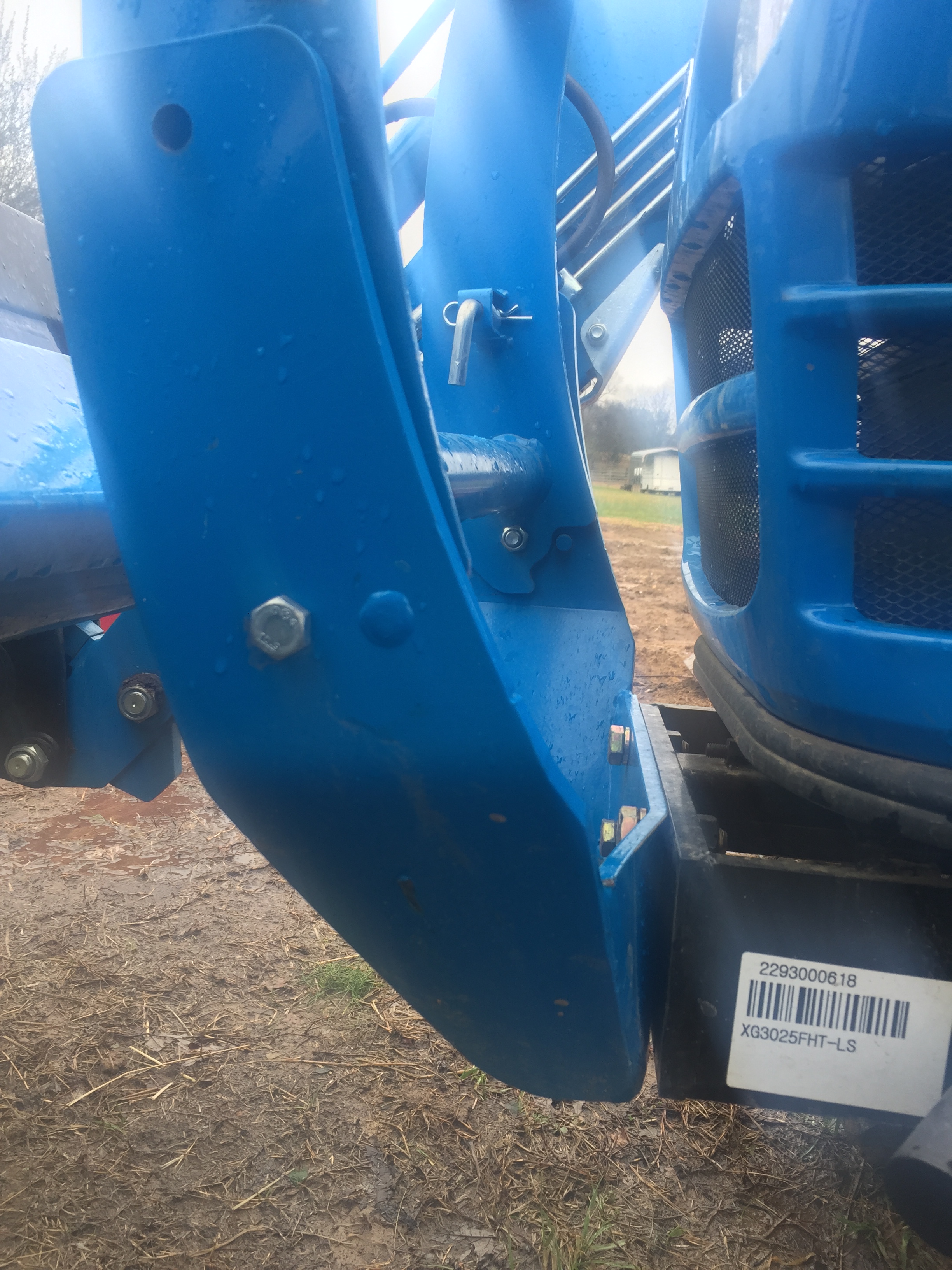

My dealer picked up mine yesterday.
It involves installing some shims between the engine and frame and the will also install some kind of reinforcement plate.
Apparently the engine to frame alignment is off by a couple thousandths of an inch which can cause an oil leak at the crank seal.
Due to the install of the shims they install a reinforcement place because the FEL brackets are moved out a bit.

Got the tractor back, I can see the shim they put in on the right side between the loader and frame.
Odd thing is I noticed my steering is allot stiffer.
It's been raining for days so I haven't had a chance to really check out what else they did.

Interesting. What would they have done to increase steering effort? Steering links don't look like the winch cable found them too I hope. Can you post a pic on the shim?

Here's the shim they put in.
I couldn't find any reinforcement plate that was mentioned in the letter.
