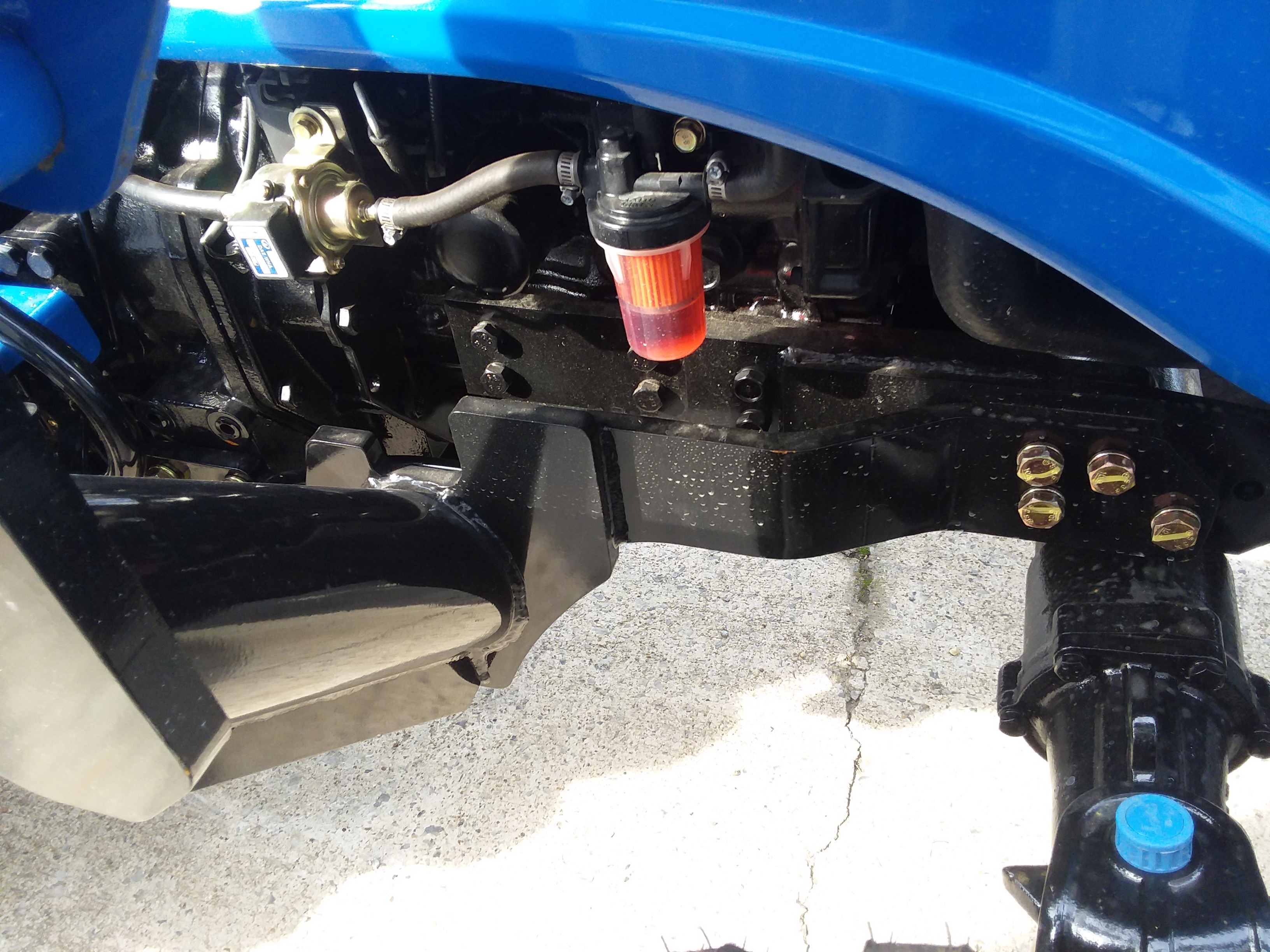

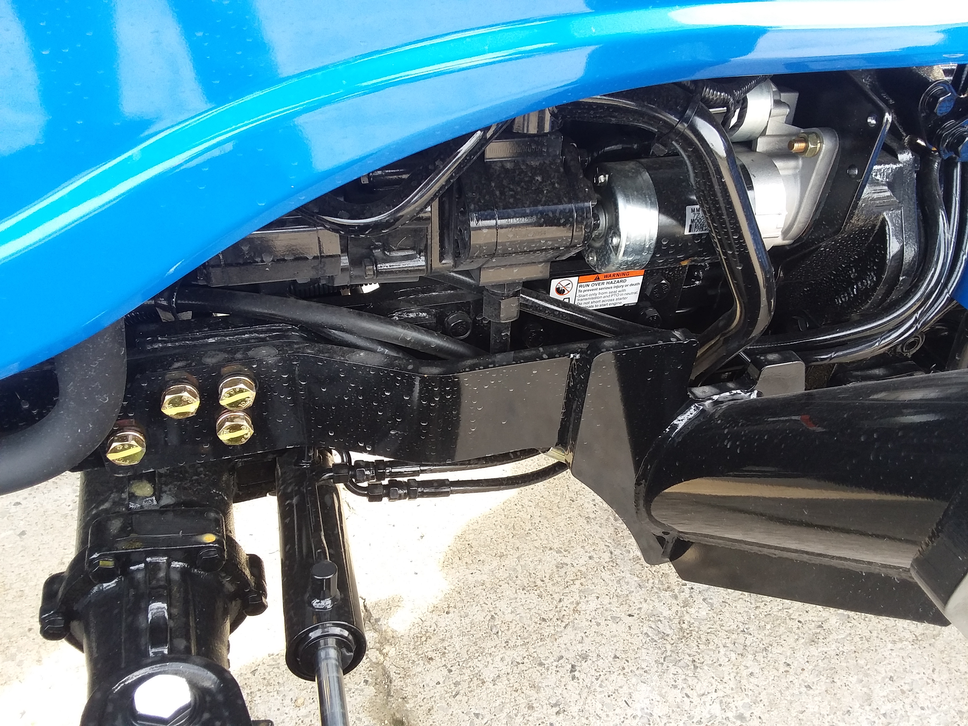

So I was driving by the New Holland dealer and noticed they had some new ones on the lot. New Holland now has an identical tractor to the XG3025. Workmaster 25. Only difference are the sub frame and the loader frame. Subframe is like what Big Blue Florida posted. 3 plates welded together. The FEL frame is way more substantial and mounts way forward of the engine and back on the transmission. Does not mount to the engine at all. Other than that 100% LS.

I am most glad to learn about New Holland's entering into the compact tractor nitch. We may be able to get parts from another source now.
Trikejay
You must have a hunter's eye to have spotted that ''Workmaster 25'' amount all that blue.
By chance did you get a cost on that new blue 25 ? Just curious .
Well it all sounds pretty good for us. We now know for sure the fix is in & it's for sale at a New Holland dealer near you.
