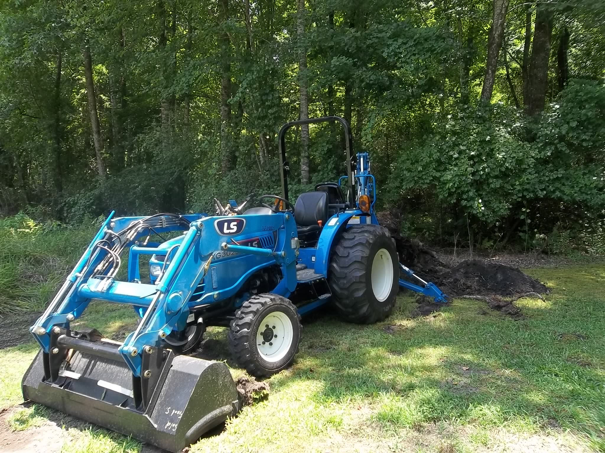

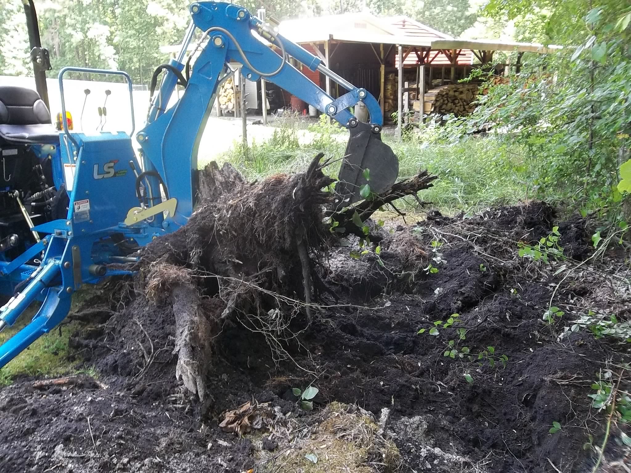

I just hit 14.8 hours on mine. Today was the first time I got to use the backhoe and as you can see in the attachment it works pretty good. You are correct "life is good".
