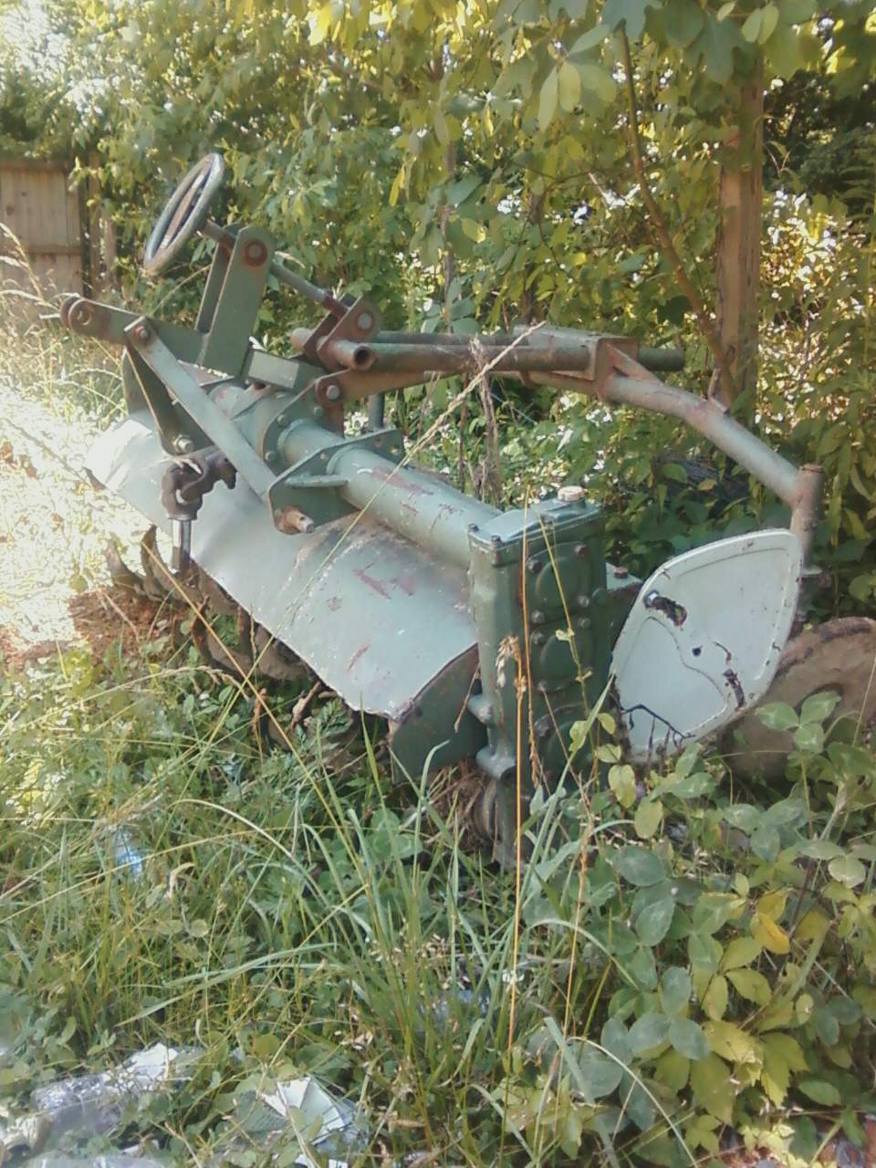

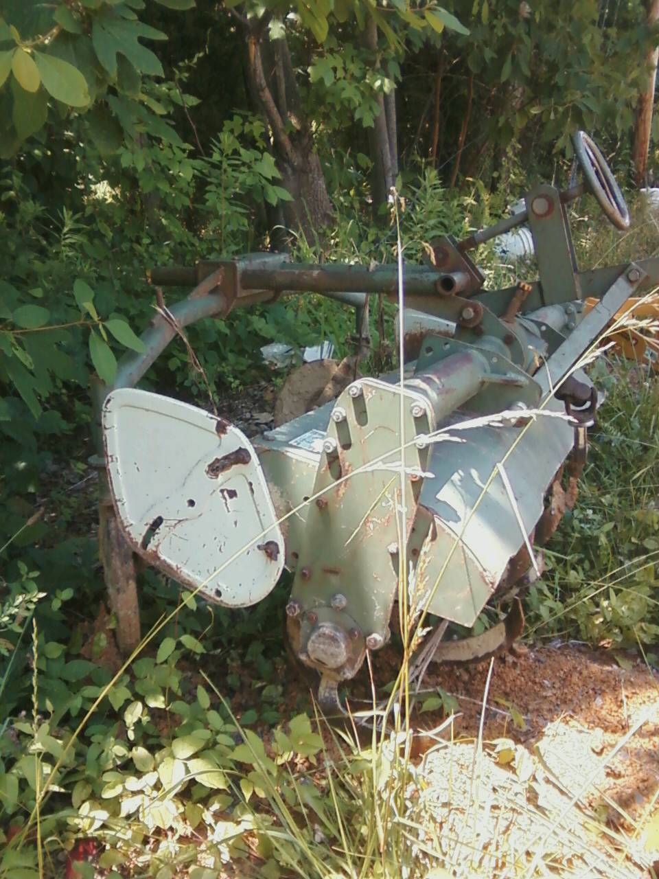

Here are a few pictures of the beast.

R Mully look at the pic. at the first of this thread and see if it will let you zoom in, it would for me, And you can see how mine is set up. Those are were the Poles for the wheels use to be just cut off. A bar across and then they run poles down to the back cover with holes,Springs and Clips for tension on it. I can't get a closer pic. prob won't get home till next week if everything goes well. Just pm me and be glad to help and try to get it worked out.Anything to keep the soil from flying is about all you need but won't be much to put it back right. They Work it will be well worth it for a couple of bucks.
