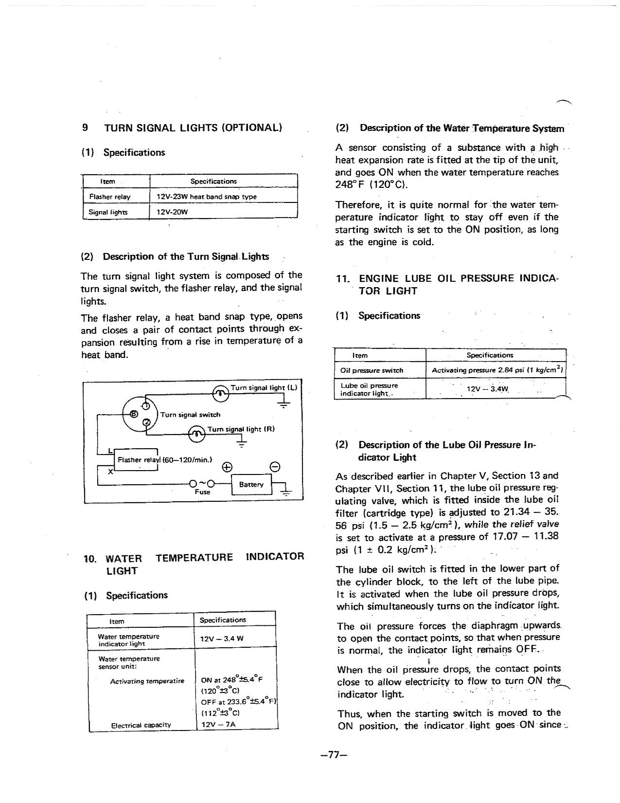

Out of the 135/155 repair manual:
/ Yanmar 135D operating temperature?
OK, excellent. That gives me a number. I just downloaded that book. I do have the operation manual but all the Operation Manual says is the indicator light goes on when the engine is overheating, stop the engine immediately and determine the cause. So, on my gauge, if I keep it around 240 or below, I should be OK. I have been up near 250F (end of the gauge) and backed off on the speed. I guess I will start my mowing in the lower gear until the engine is fully warmed up and then see where it goes. FYI, everything else is working great including the vintage Mott flail. It looked beat up but lubed everything up and replaced all the blades and sounds like a sewing machine. Thanks for the help.

I think I have this right - without a water pump (from my understanding of the system) the water needs to be at high temperature near boiling in order to move (someone correct me if that is not true). At sea level (14.7psi) or 0 gauge pressure, the boiling point is 212F. However if you pressurize the system to 14psi gauge pressure meaning 14psi above ambient (via radiator relief cap), the boiling point raises to 248F (roughly). Turns out that 248F is the set point (per the book) of the temp warning light from the factory. So, my thinking is that with a pressurized system, you need to be up there in temp to make the water move. If the water does not move, then it heats up and moves. So, it is a self compensating system of sorts. Keep in mind that the water temp I am talking about is taken just as the water leaves the block for the radiator. The temp I have measured via IR gun on the radiator outlet is around 180 returning to the block from the radiator. So, I know the radiator is working perfectly. I am I on the right track here? Thanks
