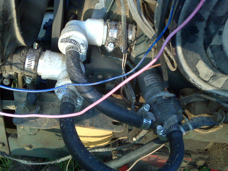

I was getting tired of watching my temp gauge crawl into the overheat zone while bushhogging so I came up the following fix for my pumpless 1500D. Using an auxiliary heater pump out of a high end Mercedes, I spliced it into the lower radiator hose on the tractor. It is tight with the connectors used, but I do have enough clearance from the fan belt. Surprisingly it has worked very well. Temp will range from 155 to 170 at constant 2,000 rpm in 90 degree weather while cutting. Ran it yesterday for 4 hours straight with no problems. Right now the pump is controlled manually through a simple switch. I just let the tractor get up to temp and turn it on. On the deluxe model I will have to incorp a thermal switch...have to remember to turn it off right now when I am done.
Here is the parts list:
Original Yanmar lower hose
1 1/8 to 1 in hose bib - (2X)
1 in elbows - 2X
1 to 1/2 in reducers - 2X
1/2 hose bibs - 2x
1/2 in hose ~ 3 feet
Aux heater pump. Got mine off ebay for $60 pretested.
14 gauge wire, connectors and a switch that can handle a couple of amps.
Comments: The pump has 18mm bibs, a little big for 1/2in hose but too small for 3/4 in. I shaved a little off the end of 1 1/8 hose bibs to get clearance from the fan belt. No leaks, no major electrical drain, don't know exactly how many amps are being pulled, just know that it works!!!

Why not have bought the waterpum conversion kit from Hoye. Proably more but less of a "rigged" look. but great job if it works long term.

John I like your solution for a water pump, very clever . Burt
