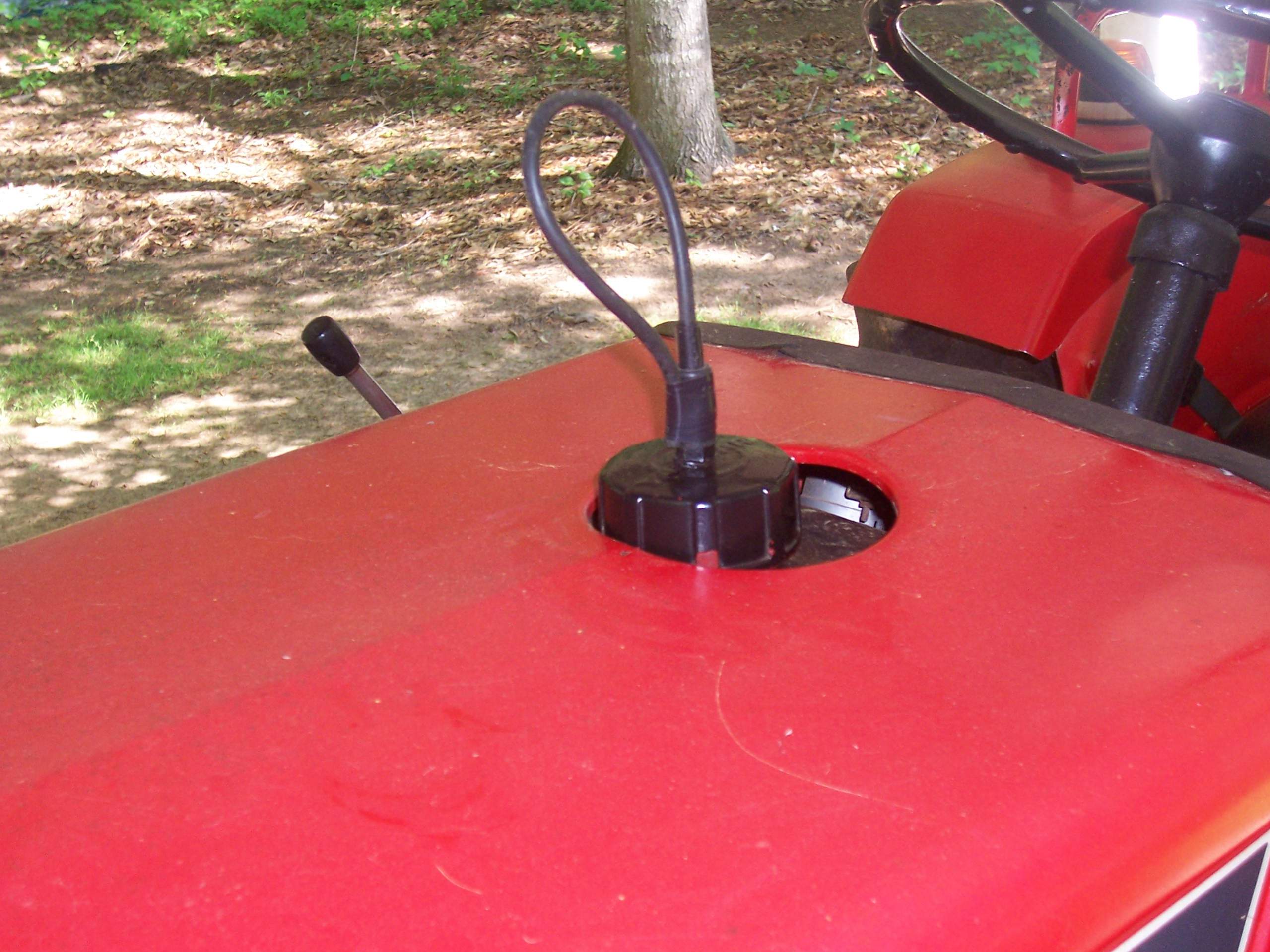

Oh. Mine is metal. It is a big problem with old tractors and motorcycles that have not had their tanks full. The condensation is the problem. My friend has an old IH tractor that the fuel line keeps getting clogged with rust from the tank.
Had bikes all my life since I was 12 except for now. First was a good ole XR75. I went down Phys. while on one. It wasn't good!! Here's what I did to prevent condensation and actually back pressure. I seen air bubbles coming out around the Injector return on the tank and new that wasn't a good thing. Came off a old Kawasaki 220 Bayou. Just drilled a hole in my cap and works great. Took care of that potential problem. ;)
