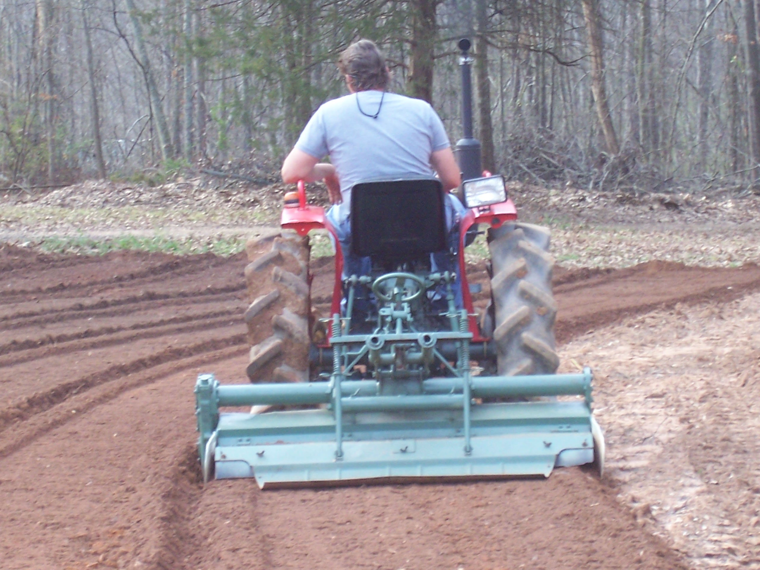

I was just mentioning how Bad my Hyd . fluid and screen was then the Fuel bowl and Filter wasn't much better. Never been big on fuel treatments so after seeing the filter and going through that, My Filter/Bowl gets replaced and cleaned pretty much Yearly. NAPA. has my filter and cheap. Also I never leave much fuel left sitting in the Tank for any period of time. The tractor sits outside under a carport so I have never filled the tank over half way at the most pretty much just a few gallons at a time. And there's opinions on it But I don't use Off road either with a dye. Straight from the pump. So my Tank & fuel bowl stays extremely clean and clear. Tilling which I did also, I never had much Thick BLk smoke. I've bogged it down and had "a lot" of Blk. smoke come out before so you may not have that bad of a problem. And if you go the route as Pumpguy suggests go ahead and run a pressure test and then your know what condition your Cyl. is in also. The RS1400 tiller in the Pic. is as low as it possibly can go on the first turn of Yr.. Notice the exhaust that you can see. No smoke.............

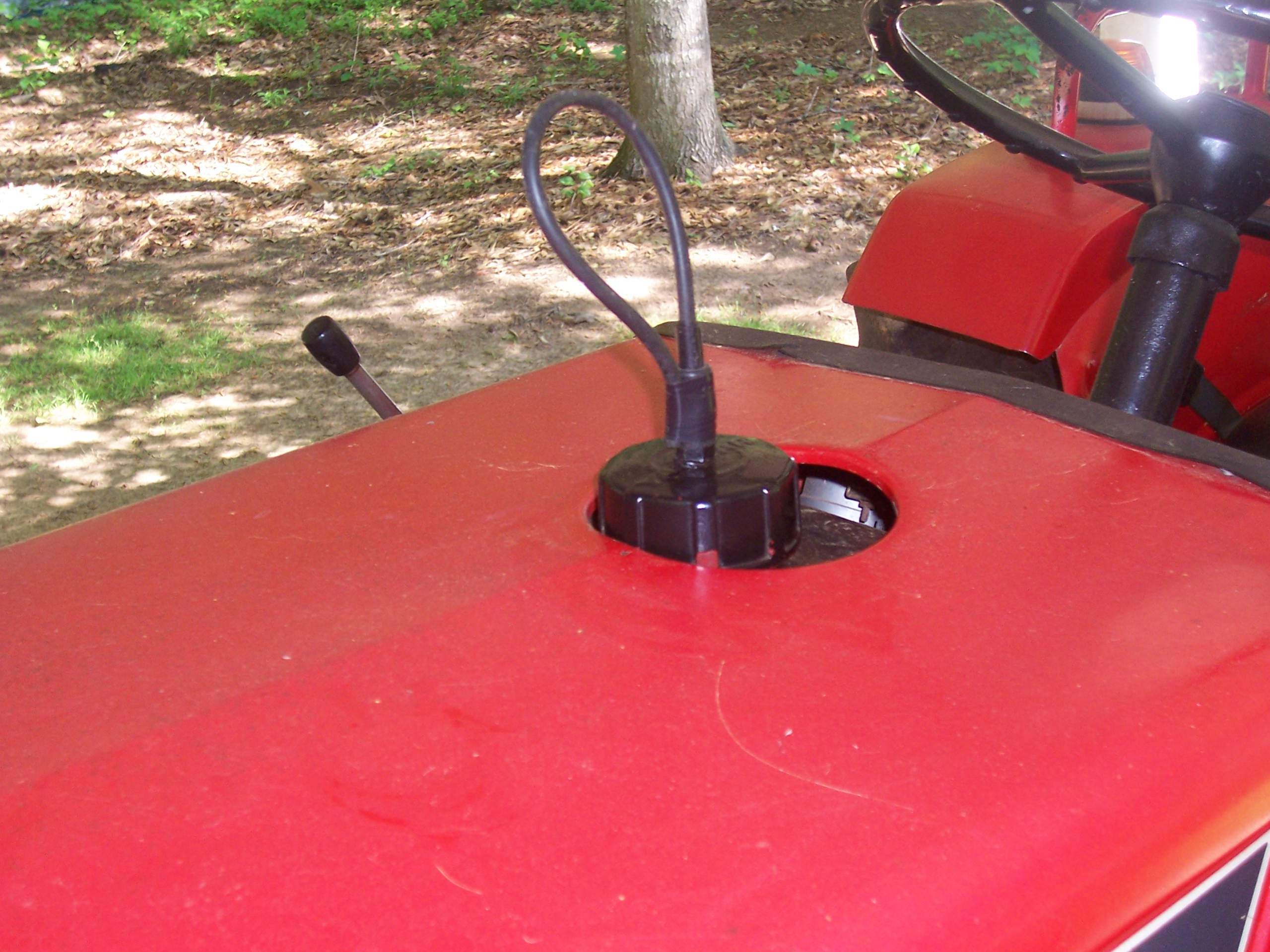

Oh. Mine is metal. It is a big problem with old tractors and motorcycles that have not had their tanks full. The condensation is the problem. My friend has an old IH tractor that the fuel line keeps getting clogged with rust from the tank.
Had bikes all my life since I was 12 except for now. First was a good ole XR75. I went down Phys. while on one. It wasn't good!! Here's what I did to prevent condensation and actually back pressure. I seen air bubbles coming out around the Injector return on the tank and new that wasn't a good thing. Came off a old Kawasaki 220 Bayou. Just drilled a hole in my cap and works great. Took care of that potential problem. ;)

/ Yanmar 155D running like crap #13
Condensation is a big problem for any metal fuel tank. I didn't think any of the Yanmars had metal tanks, but if they did I would keep it as full as possible. Use some sort of fuel treatment too, there are plenty of different kinds out there.
