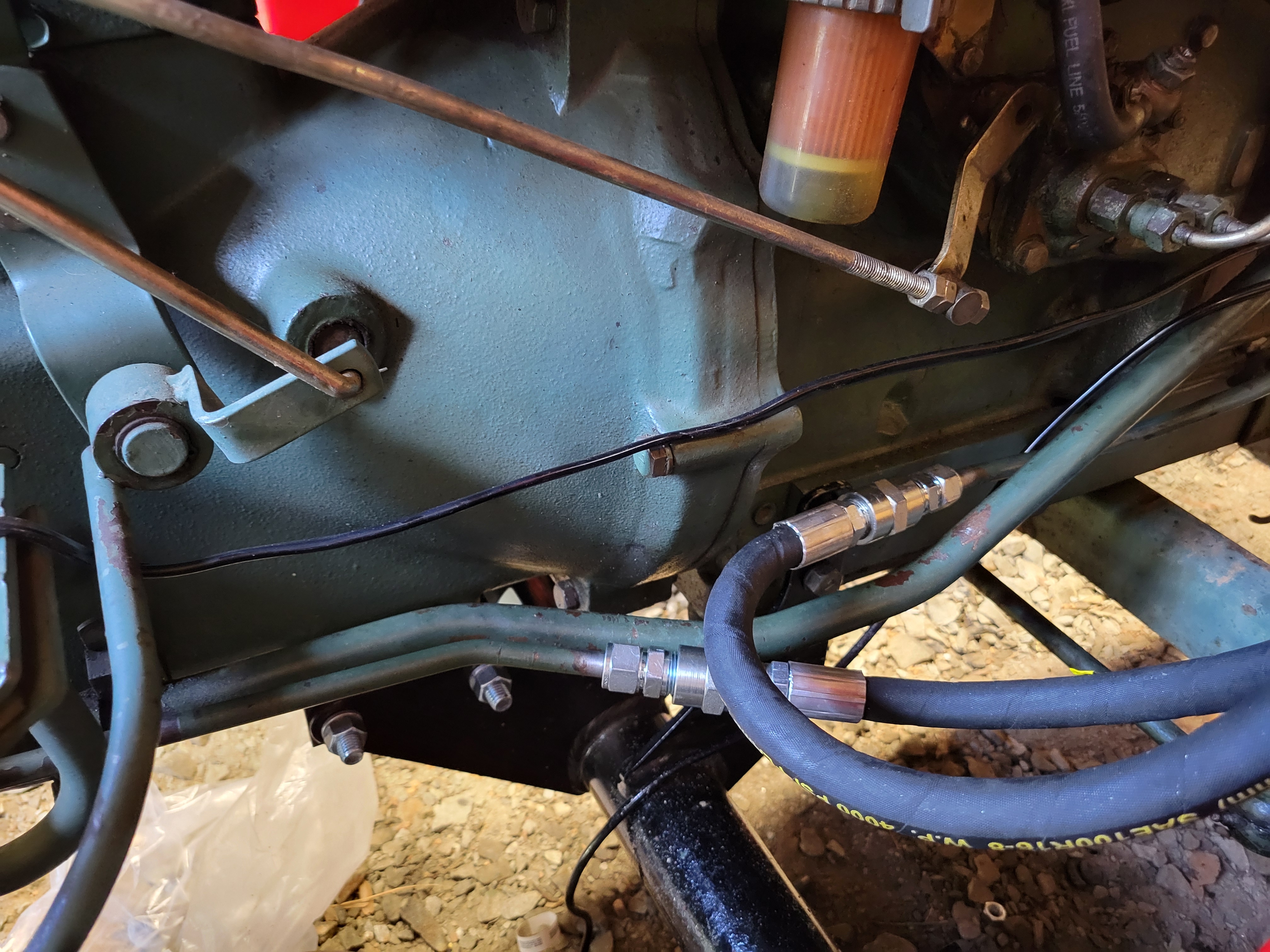

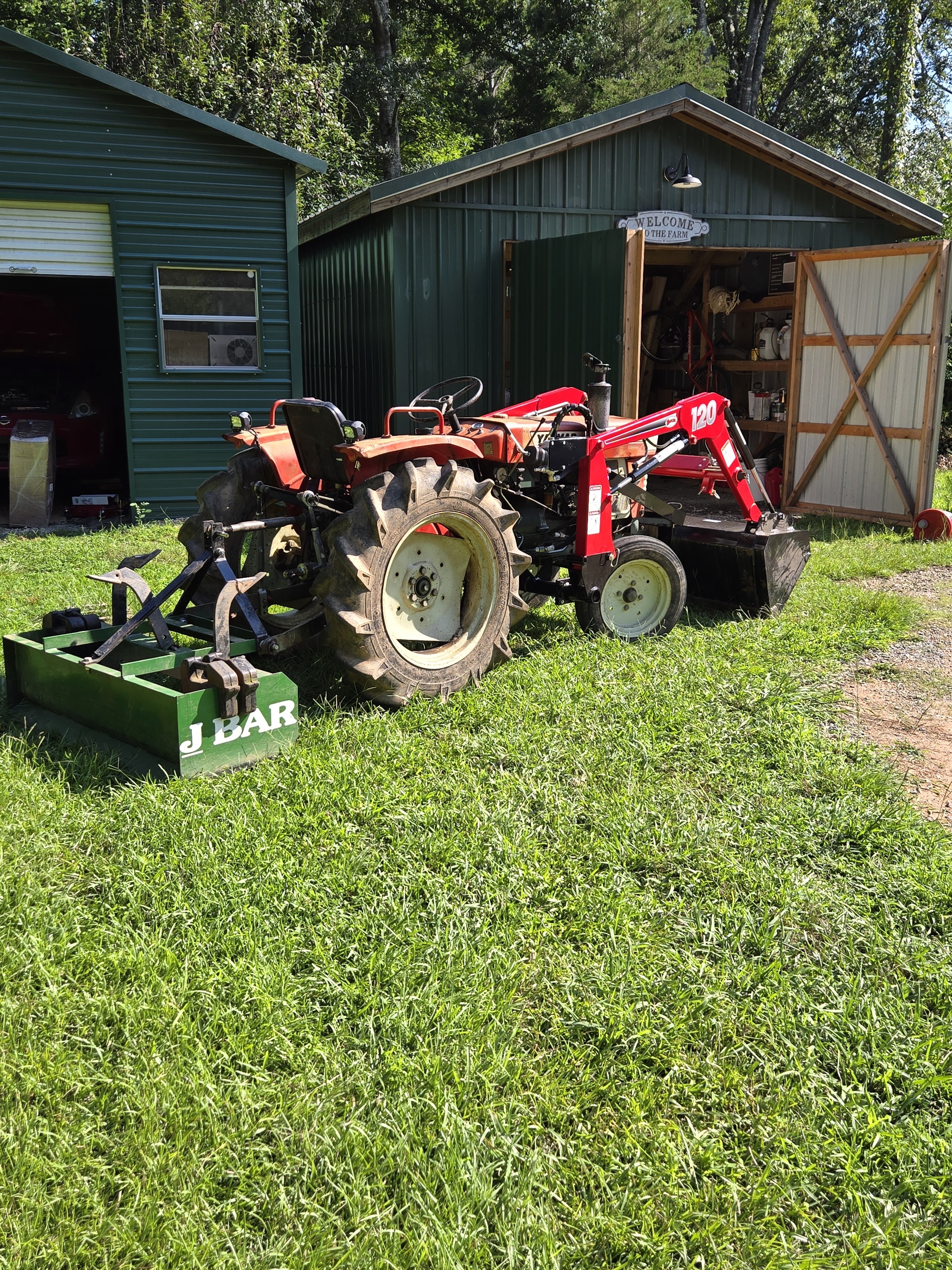

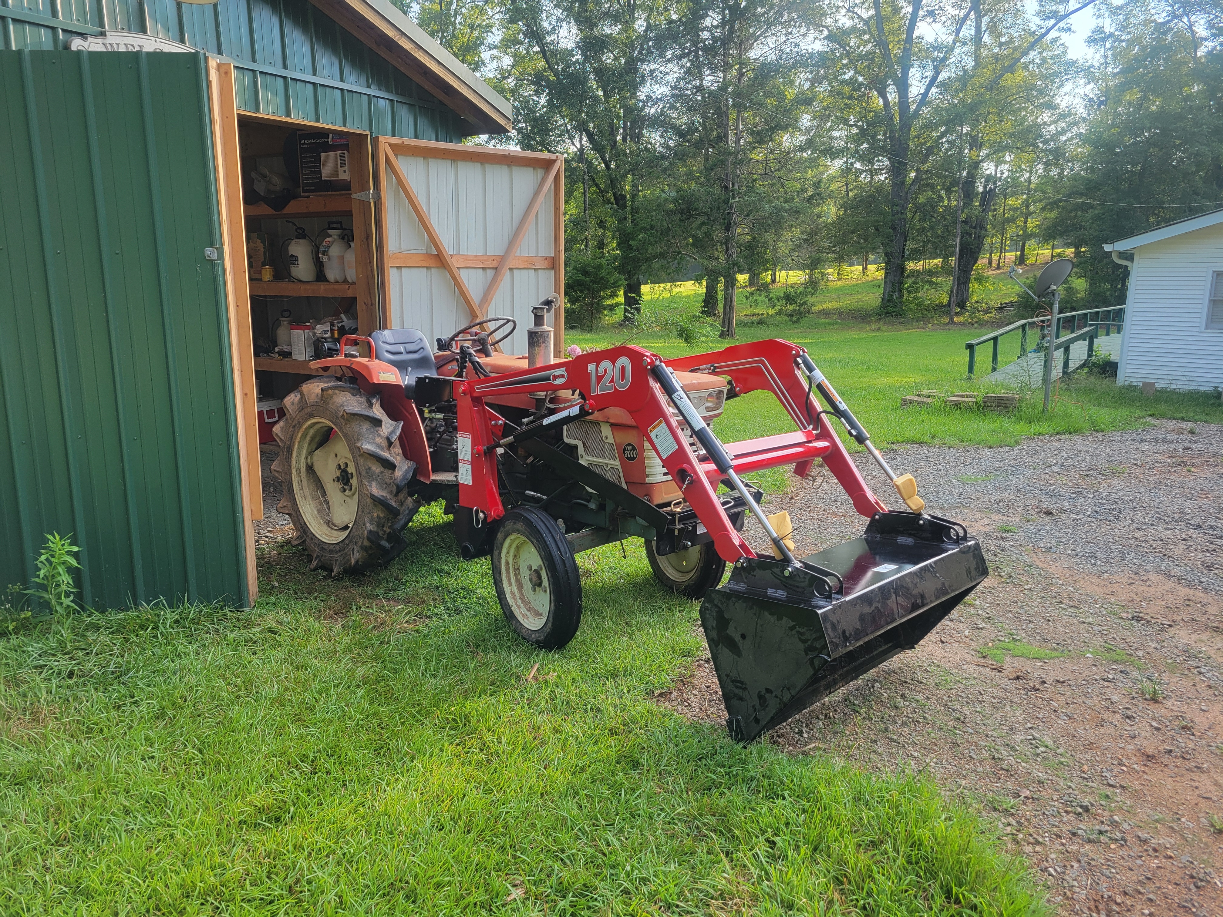

I just got a Yanmar 1700 and so far I love this little tractor. The only problem is that I want to add a loader to it. Do I have to get a yanmar loader or will any compact tractor loader fit with modifications for attachment?
I have both a YM 1700 and a YM2000... The 1700 is my dedicated bush hogger the 2000 is my utility tractor
I bought a Koyker 120 loader for the 2000.... I get a lot of work done with a loader. Im literally in the process of digging out a pond.. almost to a point where i need a backhoe. so no i have a 3 point backhoe on its way from China.. This is double duty for this loader and i constantly check for problems after a day of work.
Things to consider....
If you have a 1700D then you will be in a far better position when using the bucket. If you dont but have your heart set on a loader... consider selling and getting a D version ( 4 wheel drive with fat front tires) the 2wd front tires tend to bog in muddy terrain. You will thank me later...
Weight.. You will want some counter weight in the rear. I use a box blade with suitcase weights.
Bucket... if you have a YM 2000 or better the 120 koyker with the larger bucket is good, but a 1700 you might consider the koyker 80...
Attatching points.. You want to make sure they are torqued to spec.. Over or under will strip out the threads from the engine case.
You definitely want to grease the points with some frequency. especially if you give it a lot of work.,
( one of the pics is where i had to tie in for hydraulics.. There is some modification to the tractor to get it to work but most of it bolts right on)
