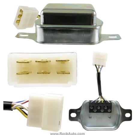

Go to Autozone and get one for a 72 Datsun. Same thing. Under $20. The plug matches, but ignore mismatched wire colors.
Here's more proof of the regulator and connector comparing a Datsun 1200.
Tech Wiki - Voltage regulator : Datsun 1200 Club
Aftermarket
RockAuto Parts Catalog
Datsun 1200 Wiring Diagrams - Datsun Forum (aka the 1972 Nissan Sentra)
* Standard Motor Products VR121 $30 USD
* Airtex/Wells 1V1250 $18 USD
* AC Delco E661 (88925052) $40
* GP Sorensen 265003 $48 USD
   / Yanmar 1700B Voltage Regulator #14
Take the Old Alternator with you and have them check it. Hate for you to cut up the Wiring Harness to find out you just had a bad connection some where. Or the alternator is bad. I found out I have both on mine. And the old style regulator still works fine. My Alt. light would start to flash random and after knowing everything was good I found the Loose connection on the back of the Fuse panel.
   / Yanmar 1700B Voltage Regulator #15
No need to cut any wires. The Wells regulator has the same plug as what you took out. It's a direct replacement just made from solid-state electronics in place of old school mechanical relays. Use one or more of the existing mounting holes. Done.
Yanmar simply went to Hitachi and sourced the same alternator/regulator combo that Hitachi sold to Datsun/Nissan. (Except for Datsun its a 30 amp alternator in the same enclosure; for Yanmar only 5 ? amps). I've run this replacement set since 2003 on the YM240 and it works like new - because it really is the same thing Yanmar specified in the first place.
Pro tip: if you want a 35 amp alternator spec 72 Datsun with Air Conditioning. I think that alternator is fatter and will need a longer belt and adjustment arm, but it used the same regulator. The 30 amp output of the basic model (Datsun without A/C) is plenty unless you have have added massive additional lighting for night snowplowing etc.
I agree with Carey's suggestion to take both the alternator and the regulator to Autozone where they will test them for free, before buying anything.
