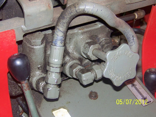

According to the parts mnaual I have for the 1820 it does not have the controls Californial has described. Rather, it has only the round knob under the seat that is called a slow/stop valve. It should be adjusted toward the closed position in order to control descent speed. Open it a little and your drop speed will increase. Yours may or may not have the looped hose shown there.

   / Yanmar 1820D Tire Adjustment & PTO Question from Washington #18
Thanks Winston.
Newfangled fancy tractors! All I know is the old simple ones. But I do look enviously at the modern ones once in a while.....
Actually it makes sense that they combined the drop rate function into that stop valve since the purpose of both valves is to choke the fluid return line.
