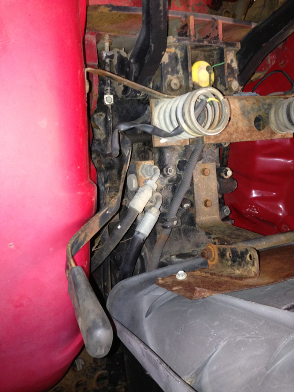

I have a 186D with front end loader it's plumbed into the rear as in the pic when I use the loader it makes a load humming noise like its starving for oil, when I engage the lever for the rear 3pt it squeals.
I'm new to the tractor and don't know anything about tractors as this is my first, the dip stick under the seat is showing oil, where is the hydraulic pump located for the 3pt?
Thanks for the advice

Hi winston thanks for the reply, where can I buy the manuals from? These hoses I have in the pic are they return lines?
/ Yanmar 186D hydraulics problem #4
Not there to see the other end but I believe those two hoses go to your loader. One is the inlet to the loader and the other is the return. That is an axillary outlet block they are coming off of. Hoye sells manuals for it. Assuming you are wanting the operational and/or service manual. Yanmar Tractor Parts: MANUALS

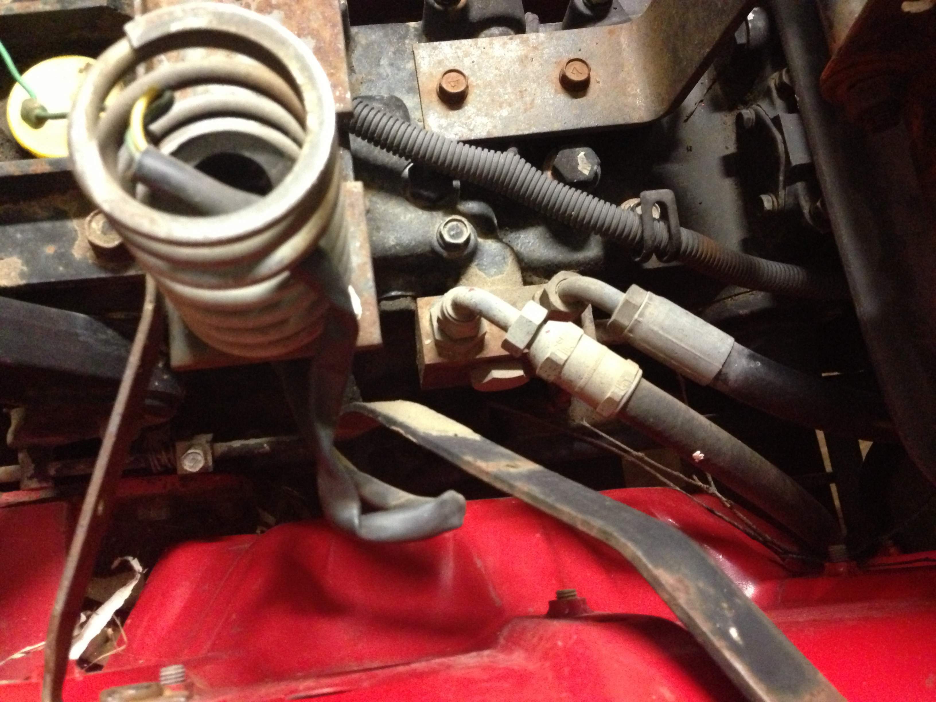

Hi winston I fitted the strainer after cleaning, the hydraulics on the front end loader are working much better and the pump is sounding like its not working no were near as hard as it was so I'm very happy.
I opened the tap under the seat counter clock wise as you said and the squeal has stopped, there's another tap on the side as in the picture
what does this do? There's also a handle there and a foot pedal how do these operate the 3pt? I have the backhoe mounted to the rear of the tractor so I can't play with the 3pt to work it out.

I am not sure about the little T handle but believe it is to adjust the drop speed of the 3 point.
If you are talking about the handle with the black rubber end in the 2nd picture that is the 3 point control handle for up and down.
Not sure what foot pedal you are talking about. Can't find it in the picture. If you are talking about reference 10 on figure 48 of your parts manual that would be the differential lock pedal.
