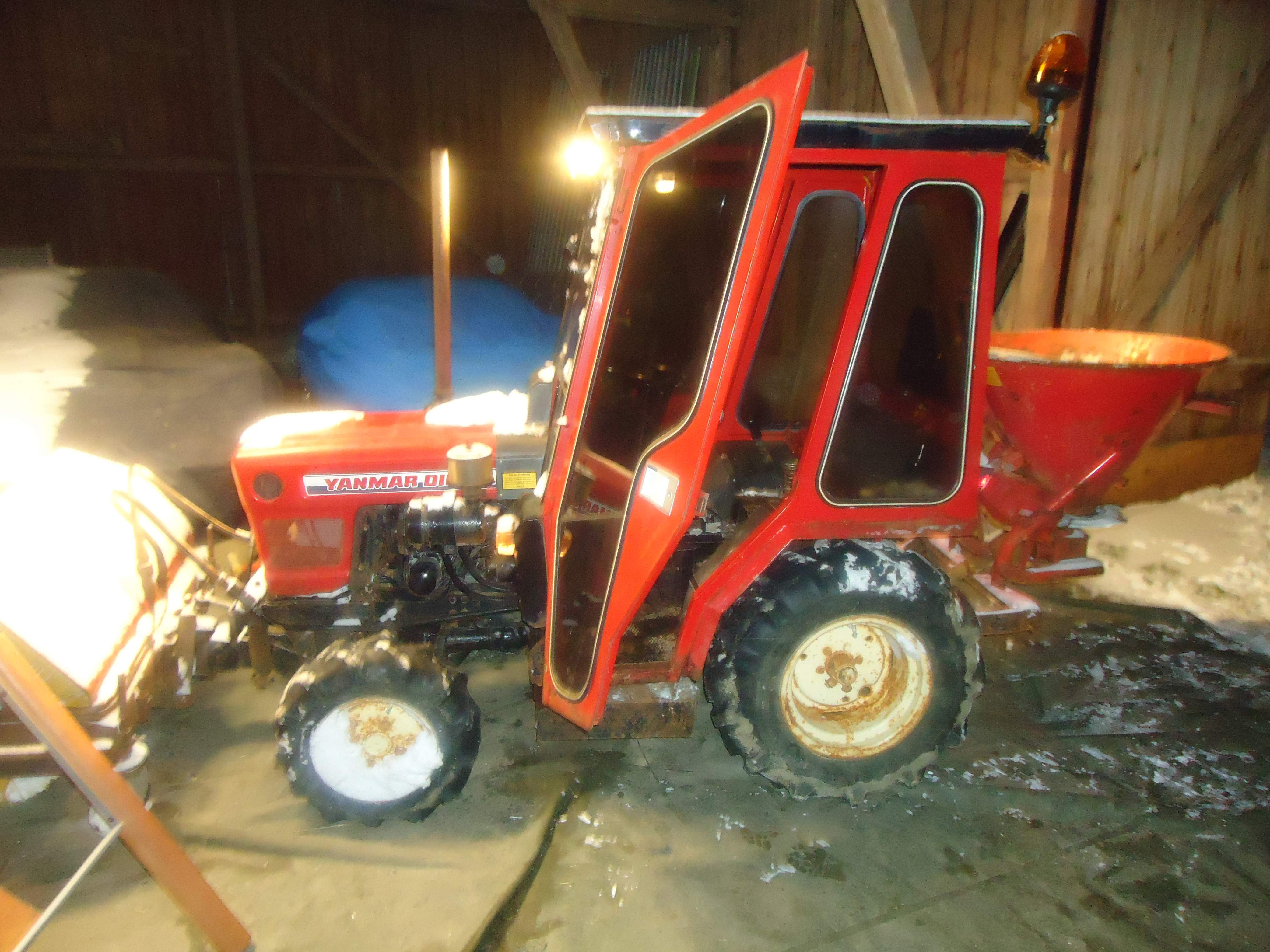

im having problems with mine think it has leaked out a bit, so i have to find out whats what (i have inheritade my yanmar and i have no papaers) =)
its a handy little tractor.. for now its a blizzard outside so ill have to wait a bit before a go out:thumbsup:
thnx again jerrybob!
   / yanmar 186d trans #11

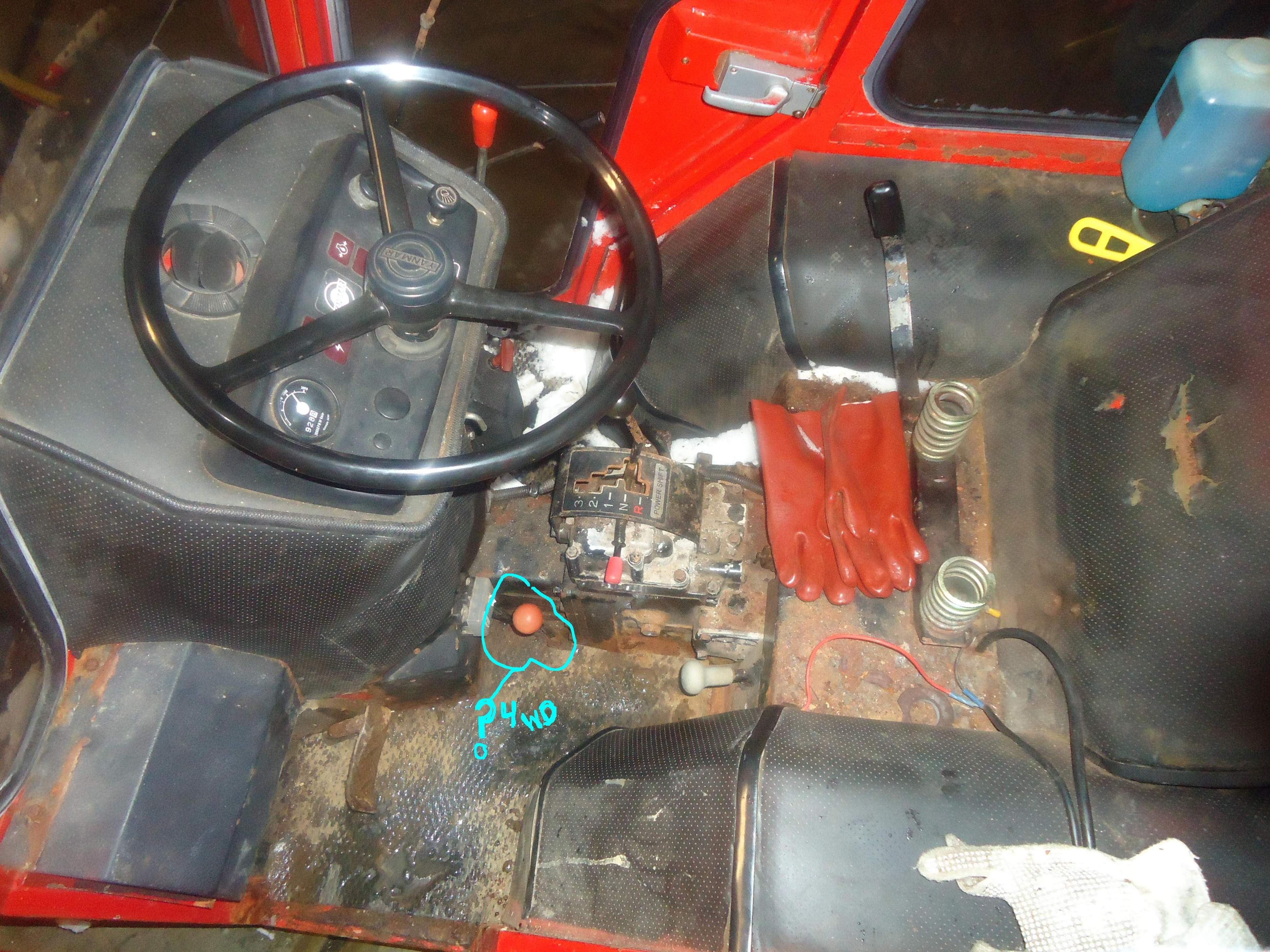

i must be blind cause i still cant find the dipstick or that lit for the screener? :eek:
heres a picture of my ironhorse
thanks in advance!

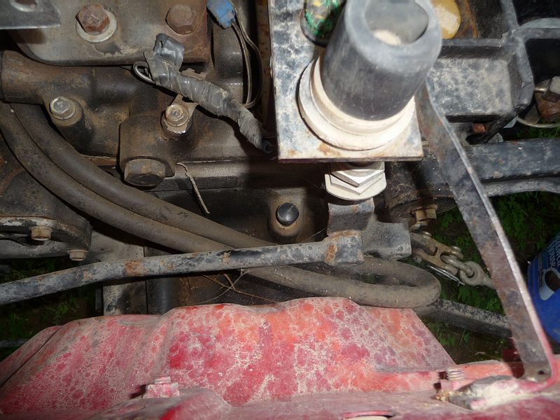

Here you go Triker. I went out and took a photo of my YM186D for you.
The transmission dipstick is the round button in the center of the photo.
The yellow cap (upper right) is the fill hole.
And I think the cover at the lower left edge of the photo is where the filter screen is, but somebody else please verify this. I haven't opened mine yet.

You do have a 186d.....right? If yes.......the screen is behind a plate with 4 bolts.....not 3 like I mentioned in my previous note. As for the dip stick......should be real obvious a little to the left under seat. Good luck.
   / yanmar 186d trans #14
Are you sure that you have a 186d. On mine, the 3 point lift lever is on the left side, the 4 wheel drive lever is way forward from where you are showing it. I have the Power-Shift, and it is on the dash. Even though I don't have the cab, I can't find all these difs in the manual.
ahh thanks once more!!!
now i get!!! it its under my cab! ill go check on it now ............
