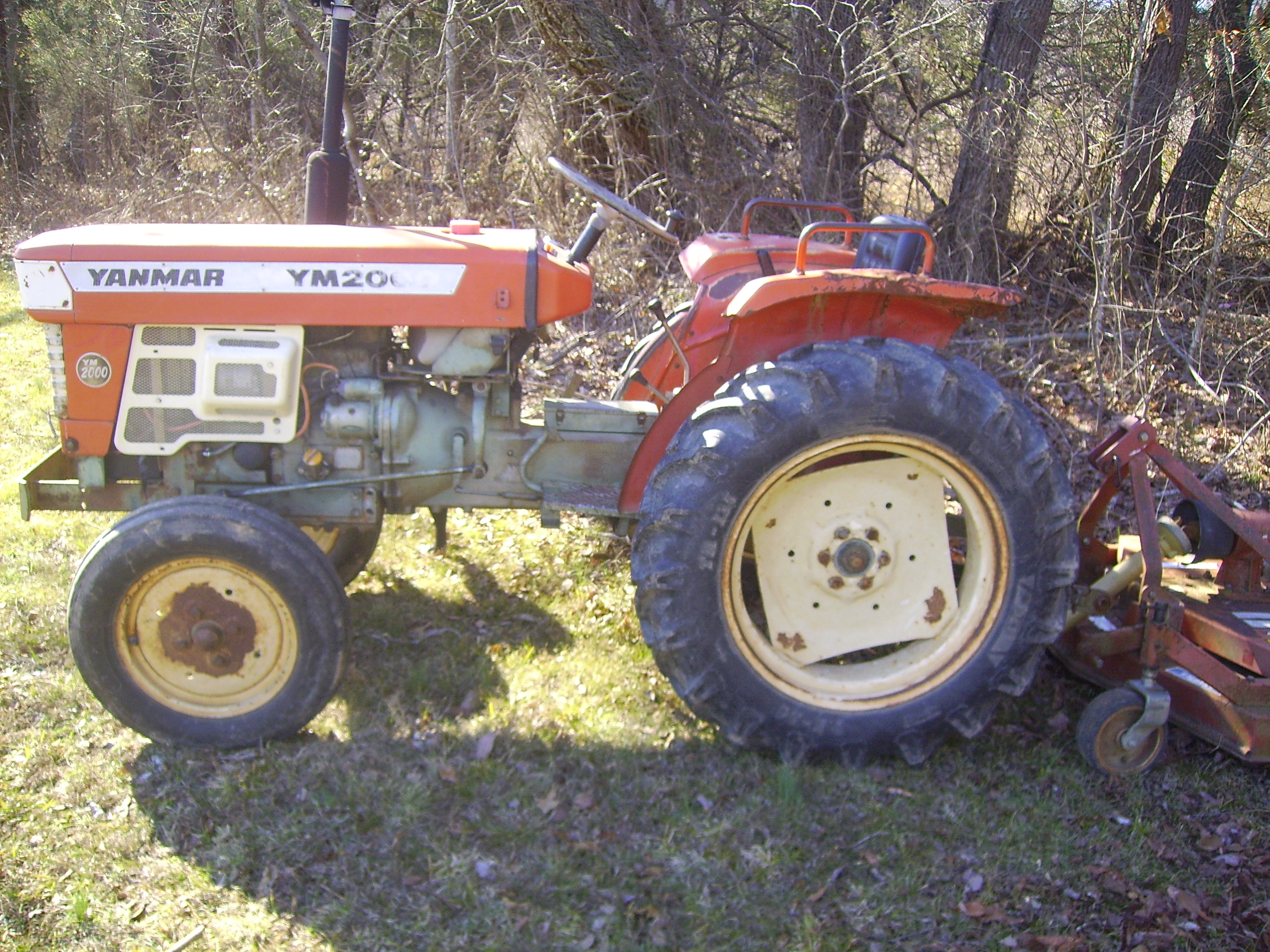

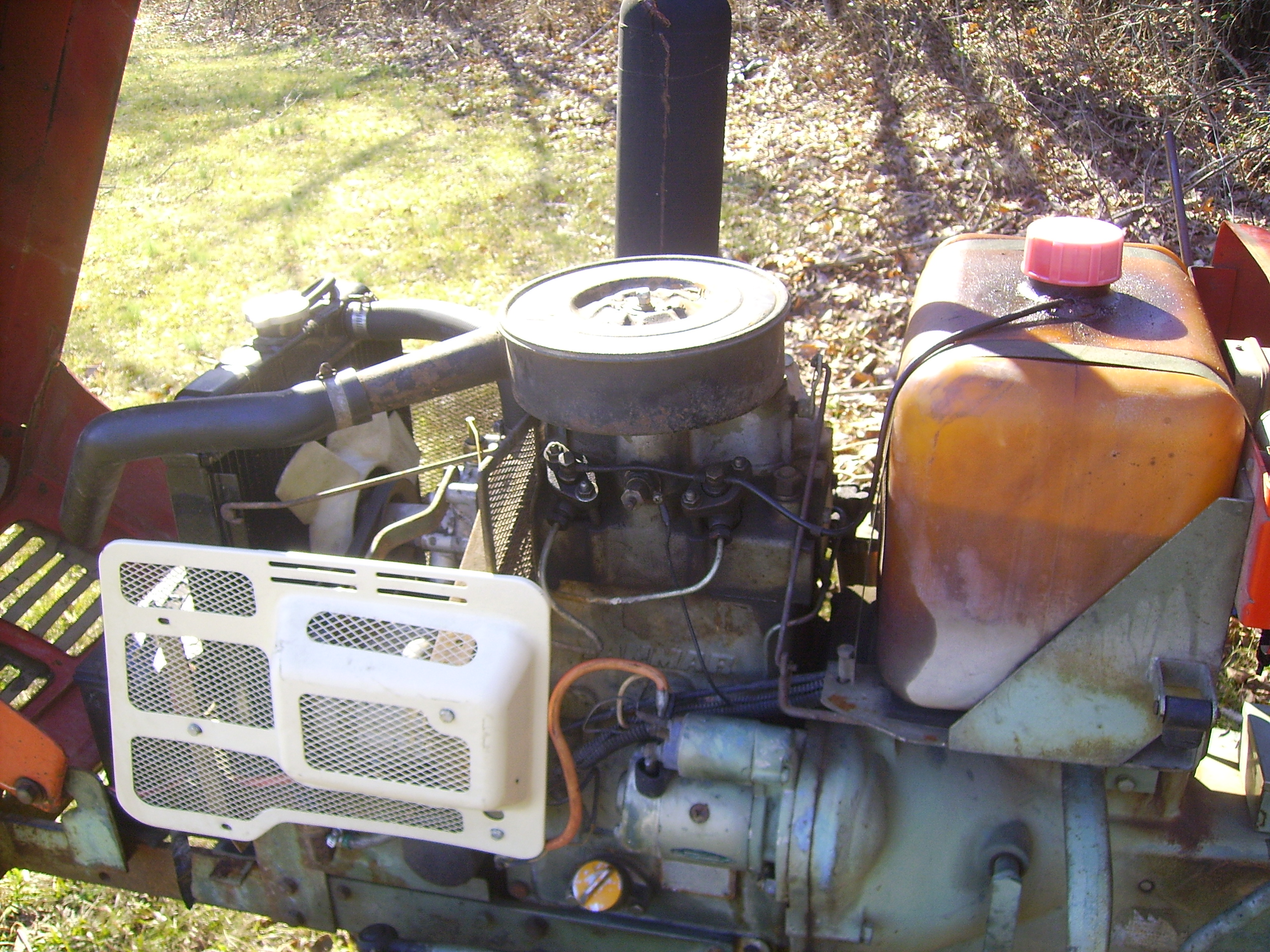

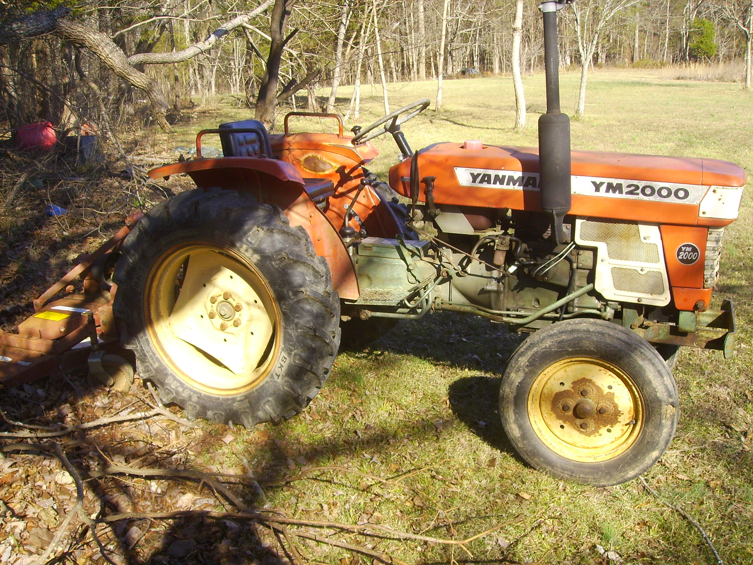

I got the tractor home Saturday. I have attached a few pics.
I haven't used it much. Everything so far seems to be functional. I'm sure a few (or maybe many) gremlins will surface over time, to be expected with 40 yr old machine.
One thing I discovered so far; you don't just turn the ignition switch off to shut it down. I actually had to go to the manual to get an explanation. Basically it said to slow idle for a couple of minutes then go to full slow idle to shut the engine down. Is that the way you guys do it? Yanmar 001.jpgYanmar 002.jpgYanmar 003.jpgYanmar 004.jpgYanmar 005.jpg

From what I see, you made a good buy
/ Yanmar 2000 #24
You did good! The implements make that a -very- reasonable price.
Yes the only engine shutoff is zero throttle. These things are about as simple as a rock. No fuel solenoid, no fuel lift pump (from tank), no glow plugs (just a $15 manifold heater that's simpler to replace than a spark plug), no thermostat, only two cylinders, obviously no computer or exhaust injection system. Same alternator and regulator as early Datsun so these are inexpensive at Autozone. Owner's manual discusses running without battery if you have one battery you carry around and start several rigs with each morning, and it cautions against using dirty ditch water in the radiator. Really, a carpenter's hammer is about the only thing simpler than these early Yanmars. I think its partly because these engines were first developed for tiny Japanese offshore fishing boats where reliability is the only thing that matters.
Condition of your new YM2000 looks about the same as my YM240 when I bought it in 2003. I see washers welded for the front wheel lug nuts (and the paint burned off), somebody ran it too long with the lugs sloppy loose and squeaking and hogged out the holes. My YM240 squeaked as it rolled and I found all the lugs loose, prior owners just didn't care. The good news was a month of tinkering with minor 'deferred maintenance' like replacing the ThermoStart, the unreliable ignition switch, and the clutch safety switch somebody had butchered, got me back to spec and restored flawless reliability. Now I've enjoyed 13 years of troublefree service. I think this is a better record than many tractors bought new.

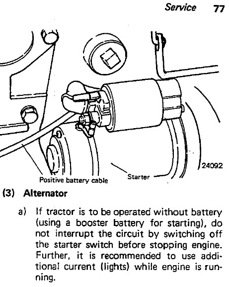

What does the manual say about running without a battery? Any "dos and don'ts"?

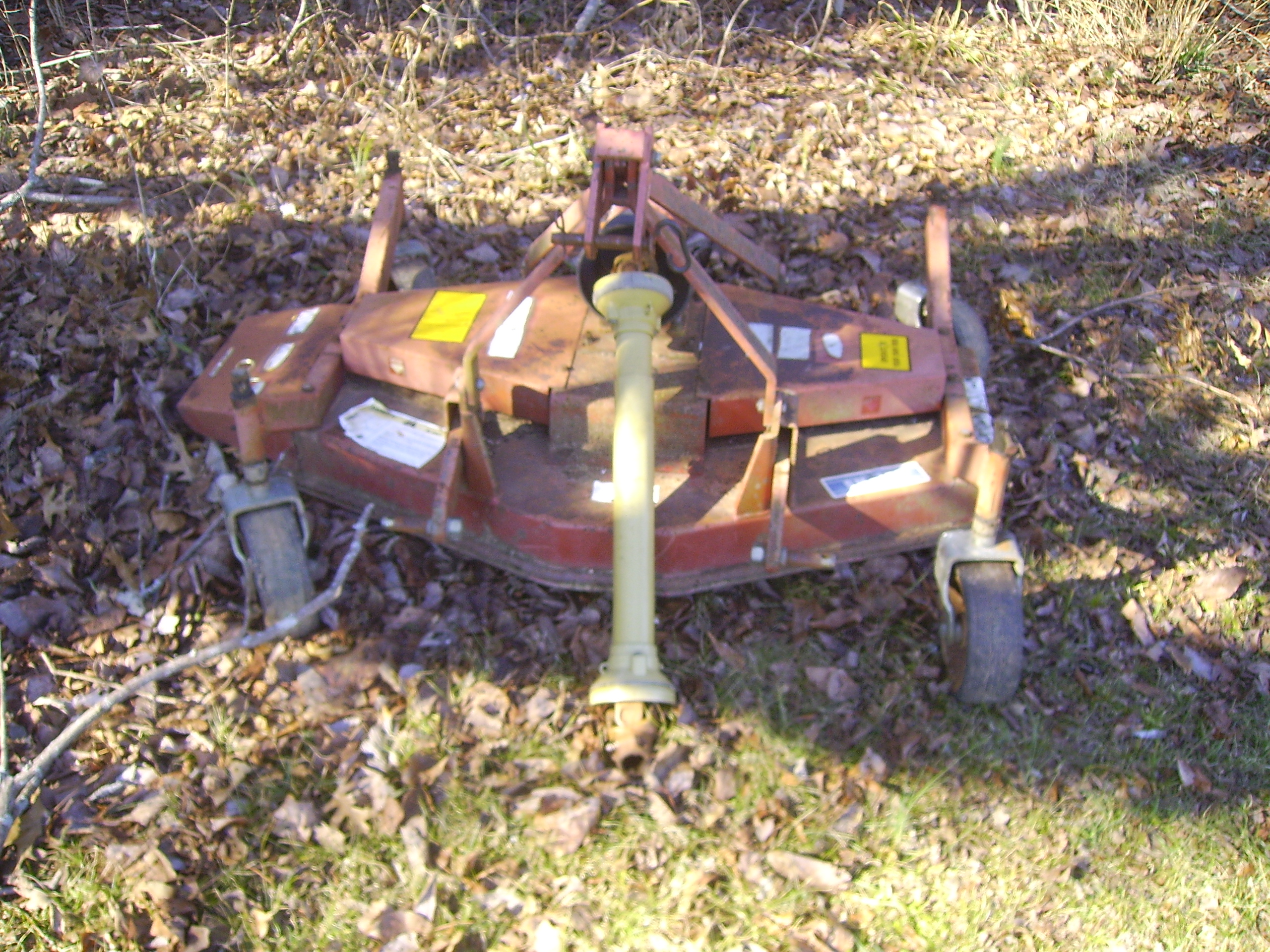

Yeah 231 I think I'm going to enjoy the Yanmar. I didnt know the finish mower was a caroni. There was nothing on it to identify the brand. I'll investigate further to make sure.

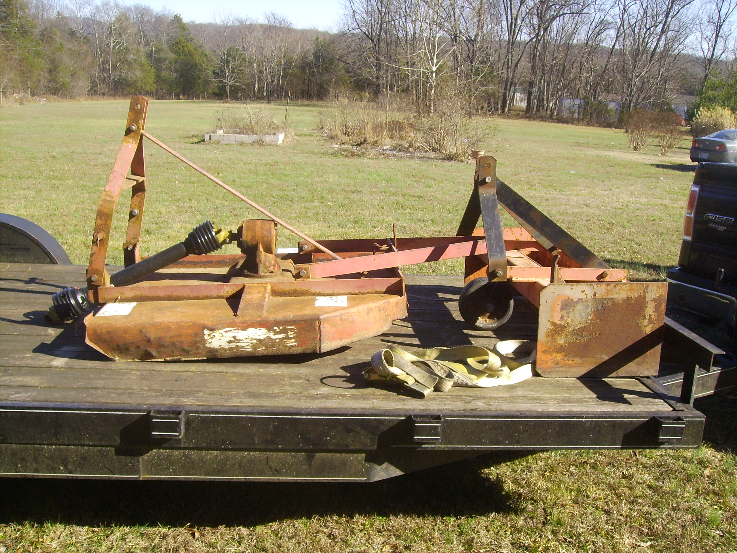

You did amazing, in the right season that Finish mower is $600 easy, that bush hog in the summer will be $300 to 400 easy and that Box is $150 - 200.
Fuel shutoff sounds normal and that looks like a serviceable original yanmar!!! YOU DID amazing!

Nope just start it up and disconnect it and take battery out, I personally would make sure the positive was inside the rubber shield and make sure it cant hit the frame. But these things just have a contained electrical system and once running with a good alternator they can provide their own power. If the alternator is bad you still will run you just wont have any electrical. Which consists of headlights and warning lights is all.

Good deal! I noticed the old owner has the Thermal Start setup like I have mine. This is all you need to add fuel to it. I just put it in the tank to add fuel to it then Turn the key backwards and give it a small squeeze and you should see it get hot and Blk. Smoke if you remove the Air Cleaner cover. Your need it IMO. in TN. Then since I rarely have to use mine I can squirt it back in the tank or disregard it.... Or call Hoye,Fredricks and get the Thermal setup. I Rarely ever use mine so no need for it. It also looks as if a dirt dobber may have yours clogged up.
