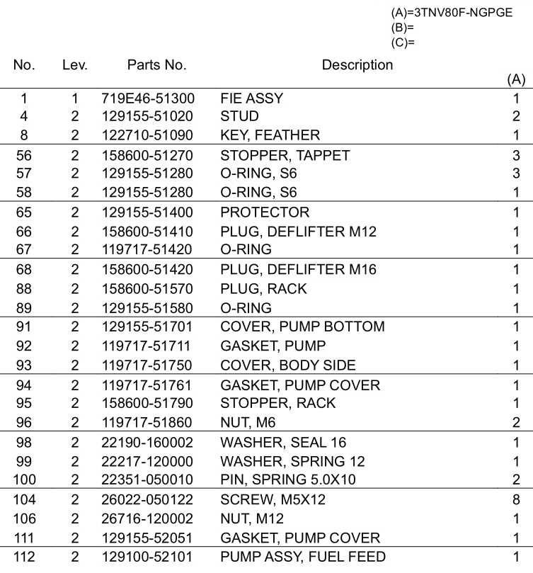

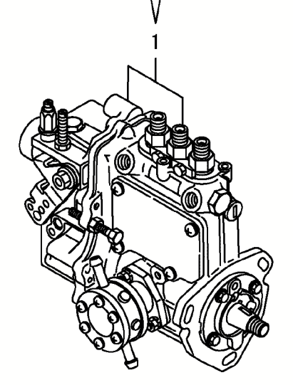

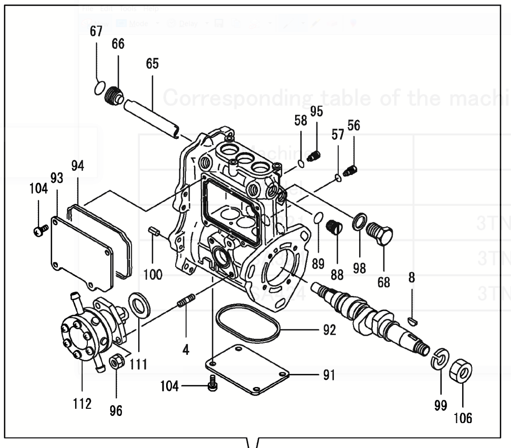

Does anyone have a picture of the plungers and barrels in a yanmar injection pump or 1025r john deere.
   / Yanmar 2210 injection pump plungers and barrels alignment #24

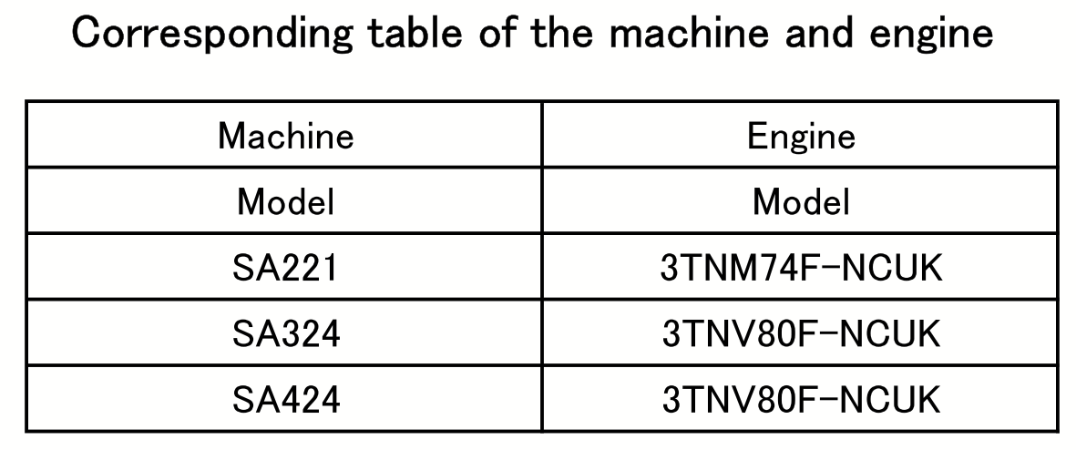

You have the new generation injector pump with all the emissions junk added to it.
The Yanmar SA machines use the same engine too, the 3TNV80.
