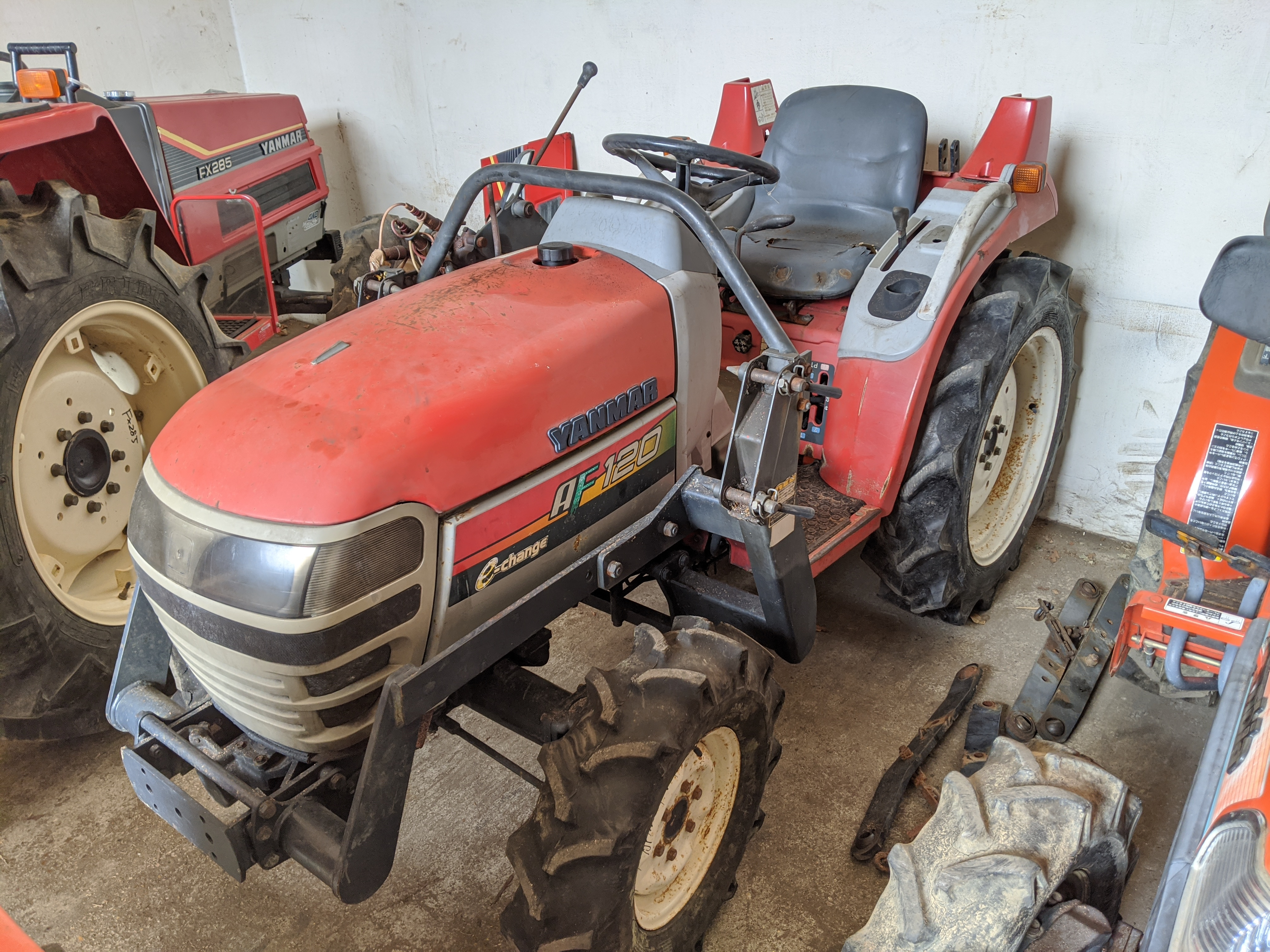

I've been talking with a bunch of helpful forum users in another thread but thought it might be useful to others if I posted a build thread for the work I'm doing on my Yanmar AF120 grey import. It's one of the rice paddy type compact tractors that can be had relatively cheaply here in the UK. I bought mine with a factory FEL and it's been a solid workhorse for the last year.... but..... the R2 ag tyres were causing no end of problems as most of the work is on turf.

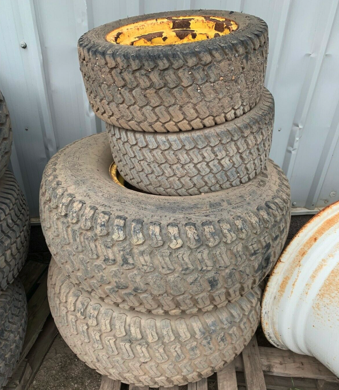

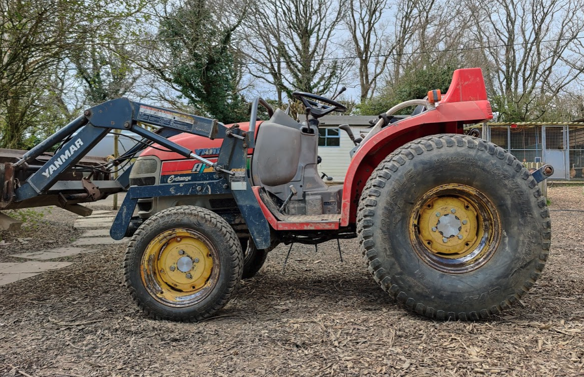

I had a look at turf tyres to fit the factory rims but the sizes were tricky - 8.3 x 22 rears and 6.0 x 12 fronts. Also I wanted to keep the ag tyres useable so that if I did need to use the ag tyres, I would be able to without messing about removing tyres from rims. I looked for suitable rims with the same stud pattern but couldn't find anything.
After a while I found these rims and tyres on eBay- they were from a John Deere 2520:
I calculated the rolling circumference from the diameters of the existing rims, and the front to back ratio. As the machine has permanent 4wd it felt important to keep the ratio as similar as possible. The ratio was 1.50:1 front to back on the standard rims and 1.51:1 on the new ones, which couldn't be much more similar, so I felt I was onto a winner.
I bought the wheels, this is a photo of them next to the tractor but not yet mounted (as the stud pattern and hub diameter are quite different):
The sizes are so similar I think they will work great. So the next challenge is getting them mounted.

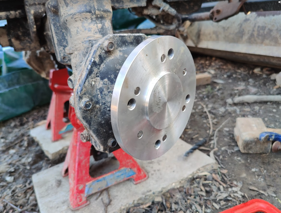

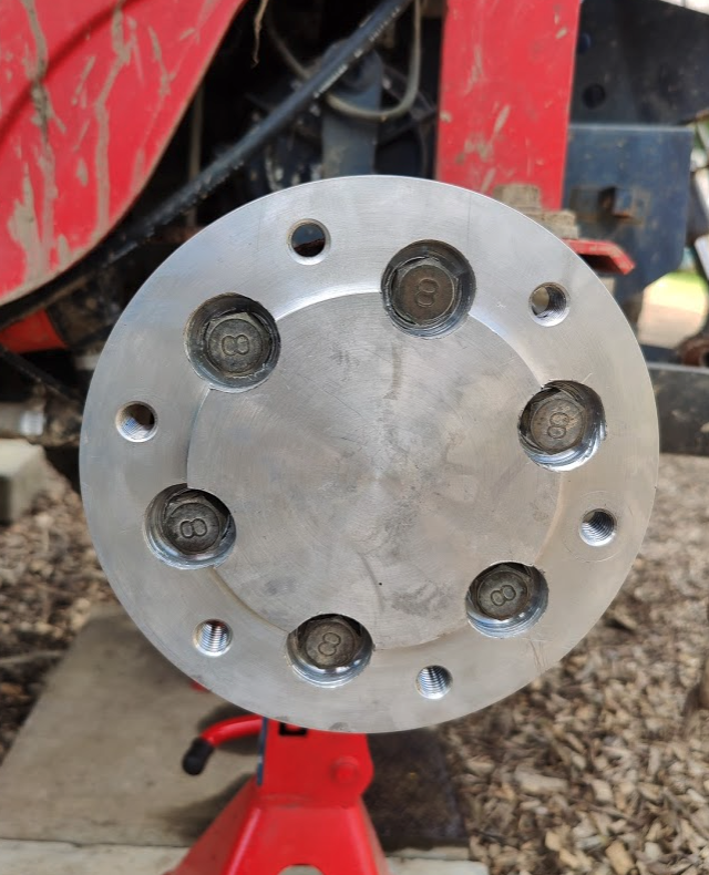

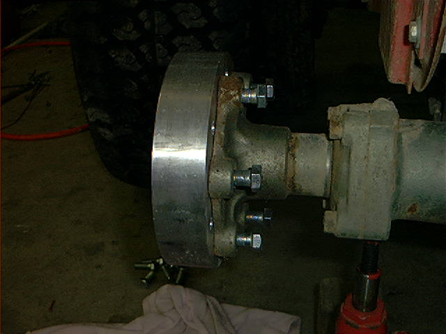

OK so here's a project update, there have been some ups and downs but long story short, the new rims are on the machine and working great :giggle:

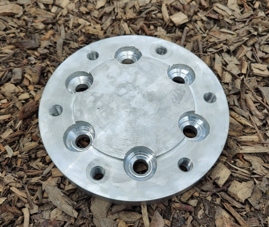

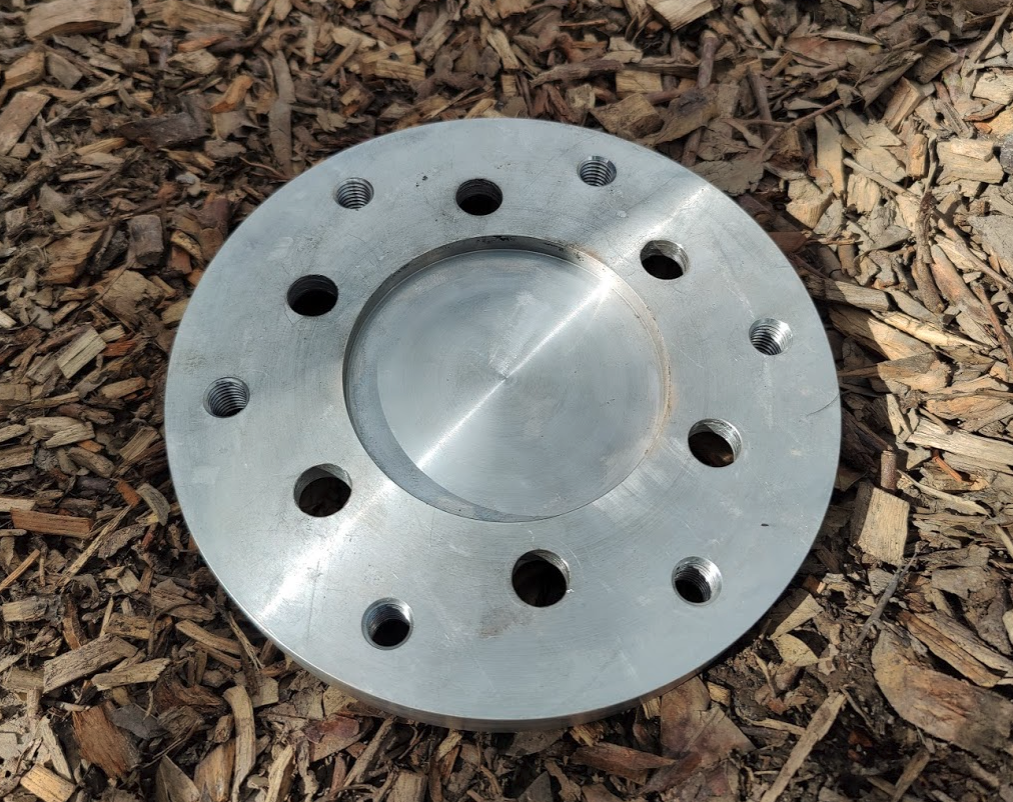

I had the adapters machined, the finish was excellent, if anyone in the UK is interested I can forward the details of the shop as they were super helpful and competitively priced.

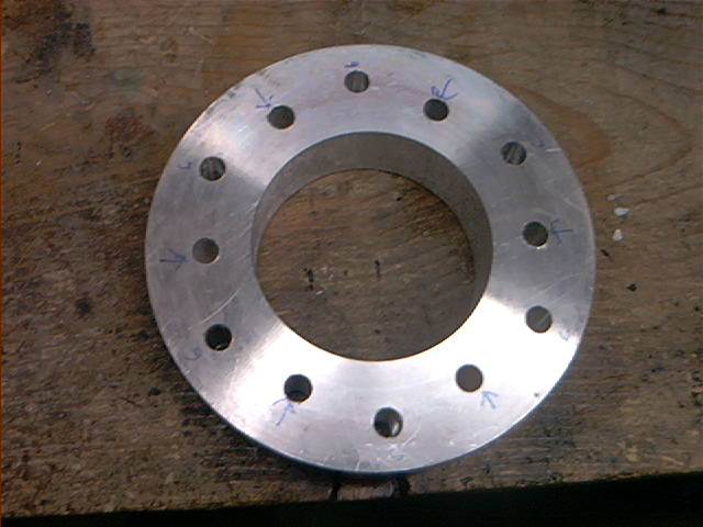

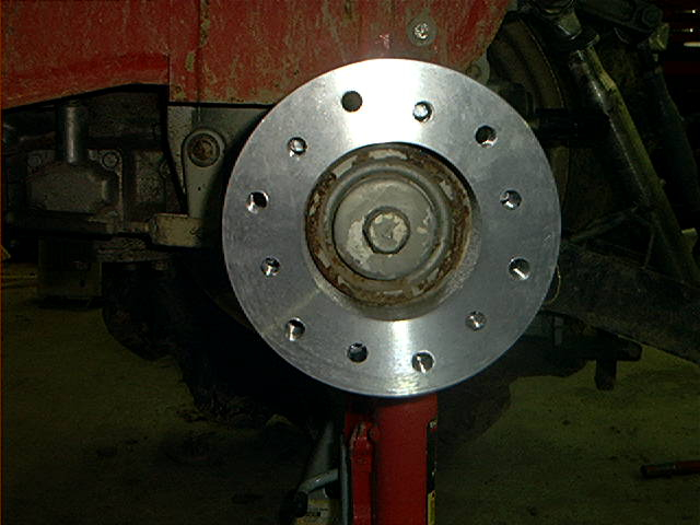

Here are some pics of the adapters:
Rear
Front
(sorry I have no pics of the front adapters before they were on the machine)

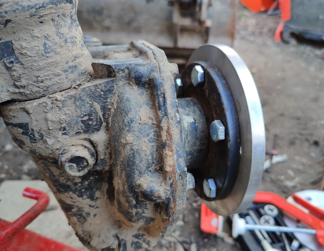

I had a number of problems along the way which I worked around. I originally intended to bolt the rear adapters from the back of the hub, meaning that the bolts would not need to be recessed on the front surface. Unfortunately I didn't have a thread gauge and I managed to get the bolt thread pitch wrong, so the threads on the hub were different than those on the adapter. As a result I decided to drill out the adapter and then drill a 28mm recess for the bolt and socket, which worked fine. Boy was I glad that I specified aluminium rather than mild steel!
On the front, I found it very hard to line up the two sets of threads (coming out of the hub and into the adapter). The bolts didn't go in 100% cleanly but they are holding firm.
I had the machine shop make the adapters with an inner recess that matches the centre of the hub, and with a new protrusion that matches the centre holes in the new rims. That way, the bolts are just holding the two surfaces together, but the load is primarily on the centre recess/protrusion. This wasn't the case with the design I was using as inspiration, I'm pretty sure the way I did it is stronger.
I made the front adapters as thin as possible - we went for 17mm in the end - in order to have the least impact on steering geometry. The rears are thicker as it makes no difference and will aid stability having a slightly wider track.

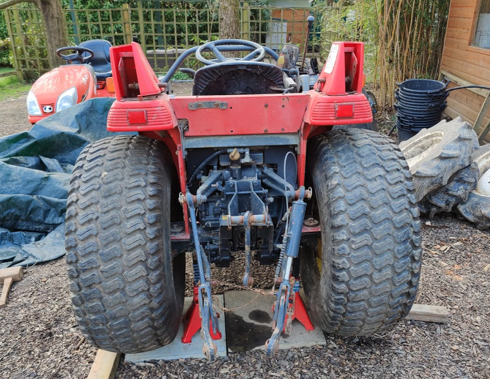

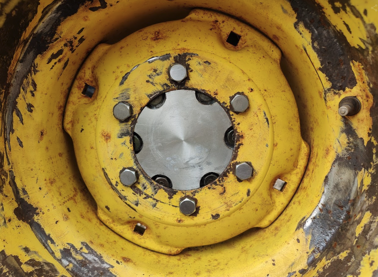

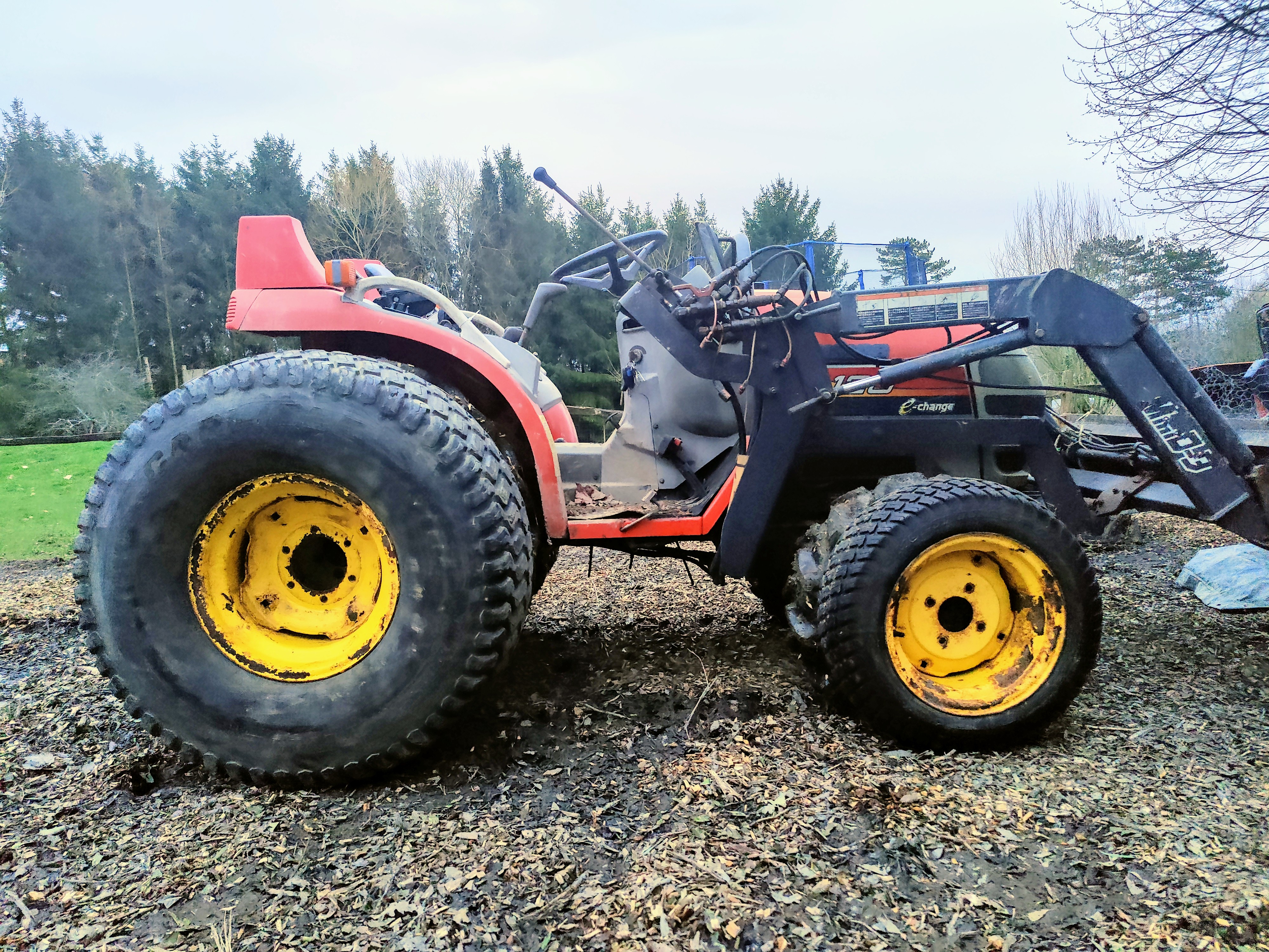

These are the rims on the machine:
In practise I have found that there are no strange noises from the transmission with the new wheels, or at least none that weren't there before 😆 As far as I can tell, steering is unaffected by the increased track at the front (approx 35mm in total). Damage to the ground is drastically less than before, in fact I only see impact at the front on a full-lock turn. There is no wheel fouling anywhere on the machine, including at full lock.
Overall despite the setbacks I am very happy with the mod. I may have to get new adapters made for the front if the threads are badly damaged, but I'll find that out when I take them off. For the time being they are fine and I'm no longer getting in trouble for ruining the lawn!

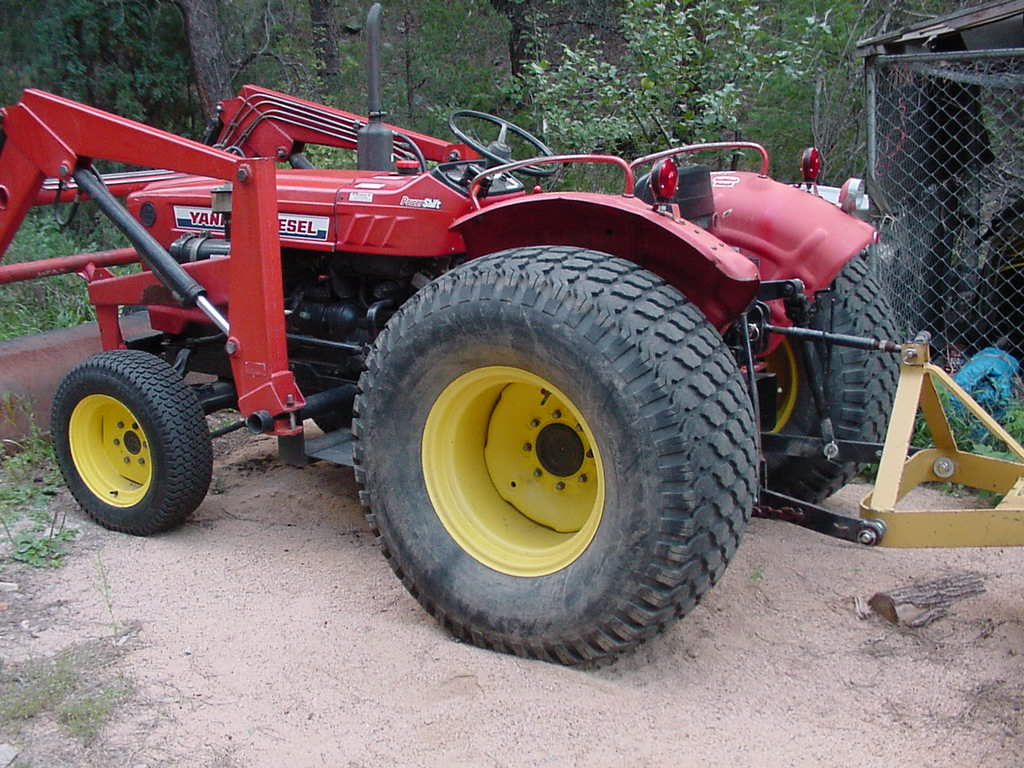

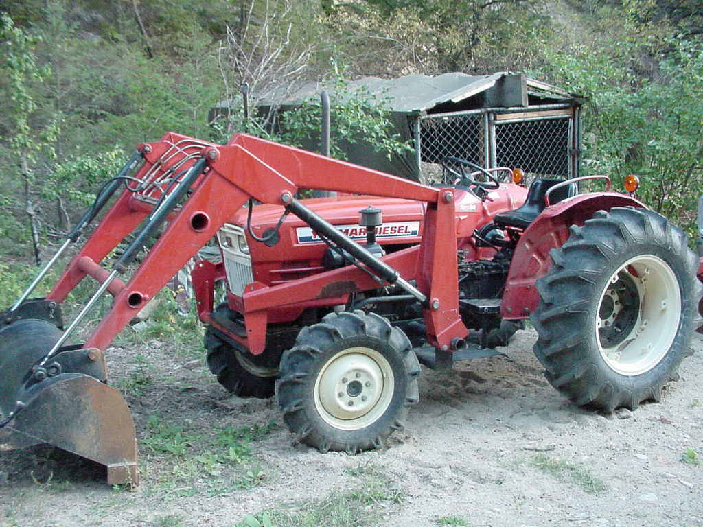

Congratulations on a nice project. It looks very good. I'll bet you will be just as pleased. Here are some pictures of a similar job on a Yanmar we did back about 25 years ago.
It is striking just how much alike they are....even to the yellow wheels.

Amazing how similar the two projects' outcome but your tyres/rims were in much better shape! I will budget for replacements as they become necessary.
Rear
View attachment 693584View attachment 693585View attachment 693588View attachment 693592
Front
View attachment 693586View attachment 693587
View attachment 693589View attachment 693701
In practise I have found that there are no strange noises from the transmission with the new wheels, or at least none that weren't there before As far as I can tell, steering is unaffected by the increased track at the front (approx 35mm in total). Damage to the ground is drastically less than before, in fact I only see impact at the front on a full-lock turn. There is no wheel fouling anywhere on the machine, including at full lock.
One caution for you is that you have dissimilar metals in place. Your spacers are aluminum while your bolts and wheels are steel. This is a recipe for corrosion (quickly if in s humid area). If you did not and for others doing this, use an anti-seize product on any contact from dissimilar metals. It should mot have an effect on maintaining torque although vibration will.
   / Yanmar AF120 turf tyre retrofit
#12
Well said - I had meant to coat all surfaces in copper grease but didn't get around to it in my excitement to get the new wheels on. I will do so, thanks for the reminder.
