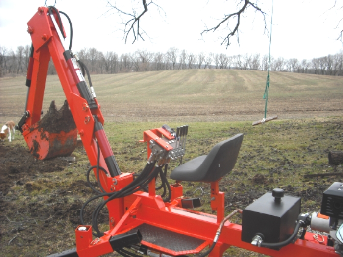

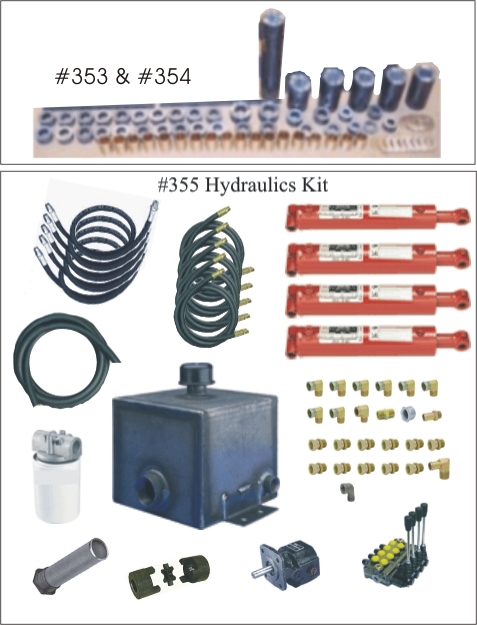

I need to buy the product hydraulic system to backhoer http://m.youtube.com/watch?google_comment_id=z134yzaznnmugp2mp22gj1db5or0cxu1p&v=Vp2FAMsZ990 . 20 hp .
