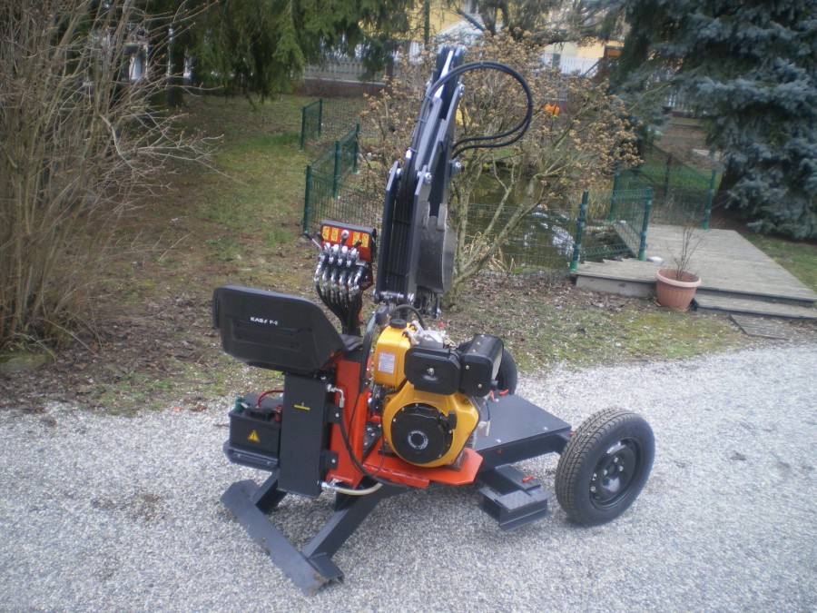

Dear j-j Dear j.j Thank you very much.
You are very knowledgeable in hydraulics.
i have no knowledge of hydraulics.
Thanks to your advice to help me choose the hydraulic system.
For example, I run 12HP engine. Should I choose how many gpm pump, cyl, hand controls and the accompanying accessories like the system to suit.
Thereby I will look to buy spare parts in the country or in china.
Actually I need. Please help me
Here is the model I want to follow: Mini pelle JMEKA. helps you learn me. what I need, its parameters. 900900_0_2828637_80343.jpg
Thank you !
Here is the model I want to follow: Mini pelle JMEKA. helps you learn me. what I need, its parameters.View attachment 367315
Thank you !
Basically, your 12 HP engine can support a 7 GPM pump at 2500 psi.
So you need cyl to fit each operation of the BH.
You need at least a three spool valve, and if you use out riggers, you need two more spools.
   / Yanmar EX450/CL400 problem remains #34
I know if I race the load, you will calculate and let me know,
I need any kind cyl. Problem is I do not calculate. Anyway, thank you .Duy
