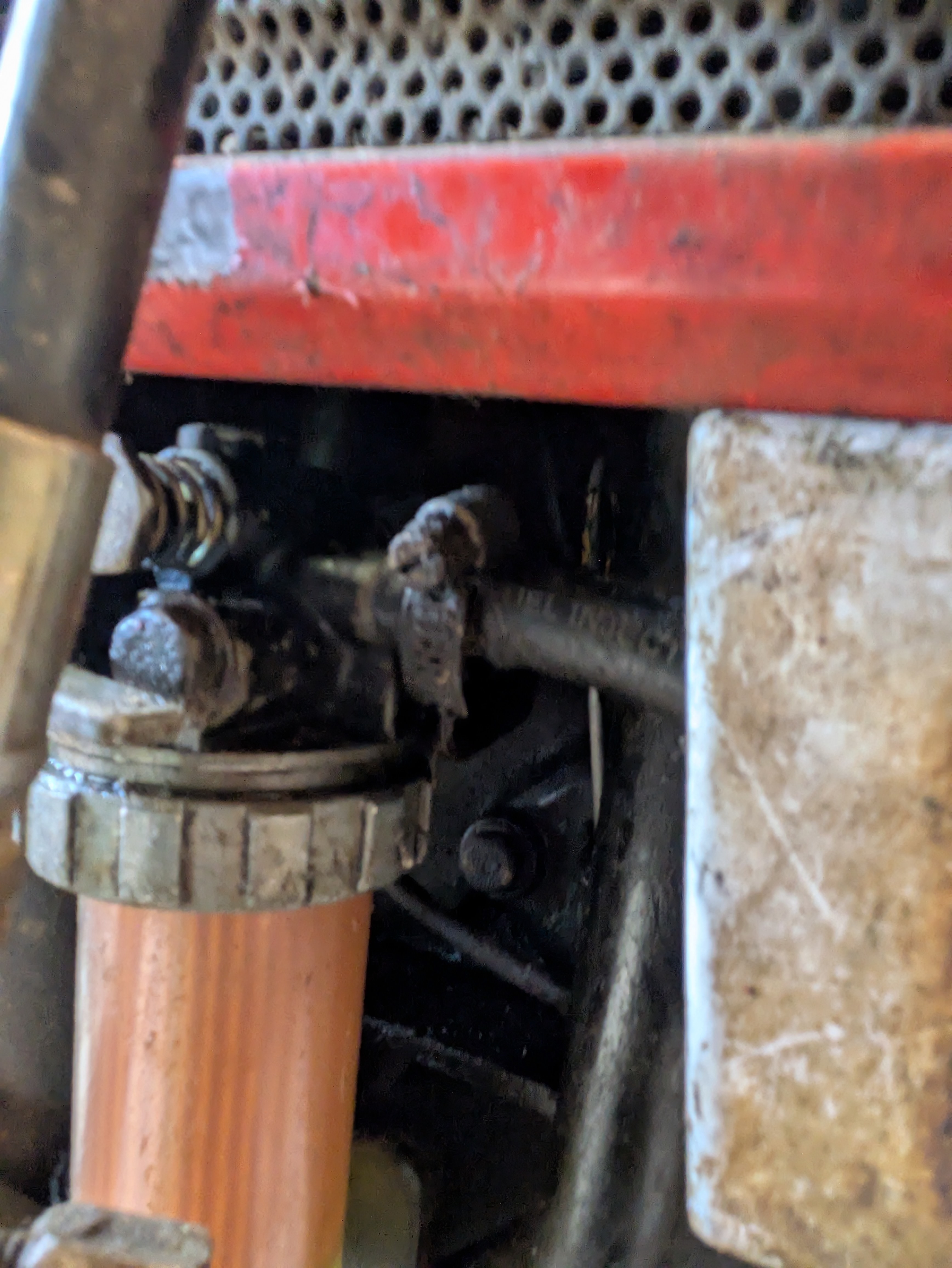

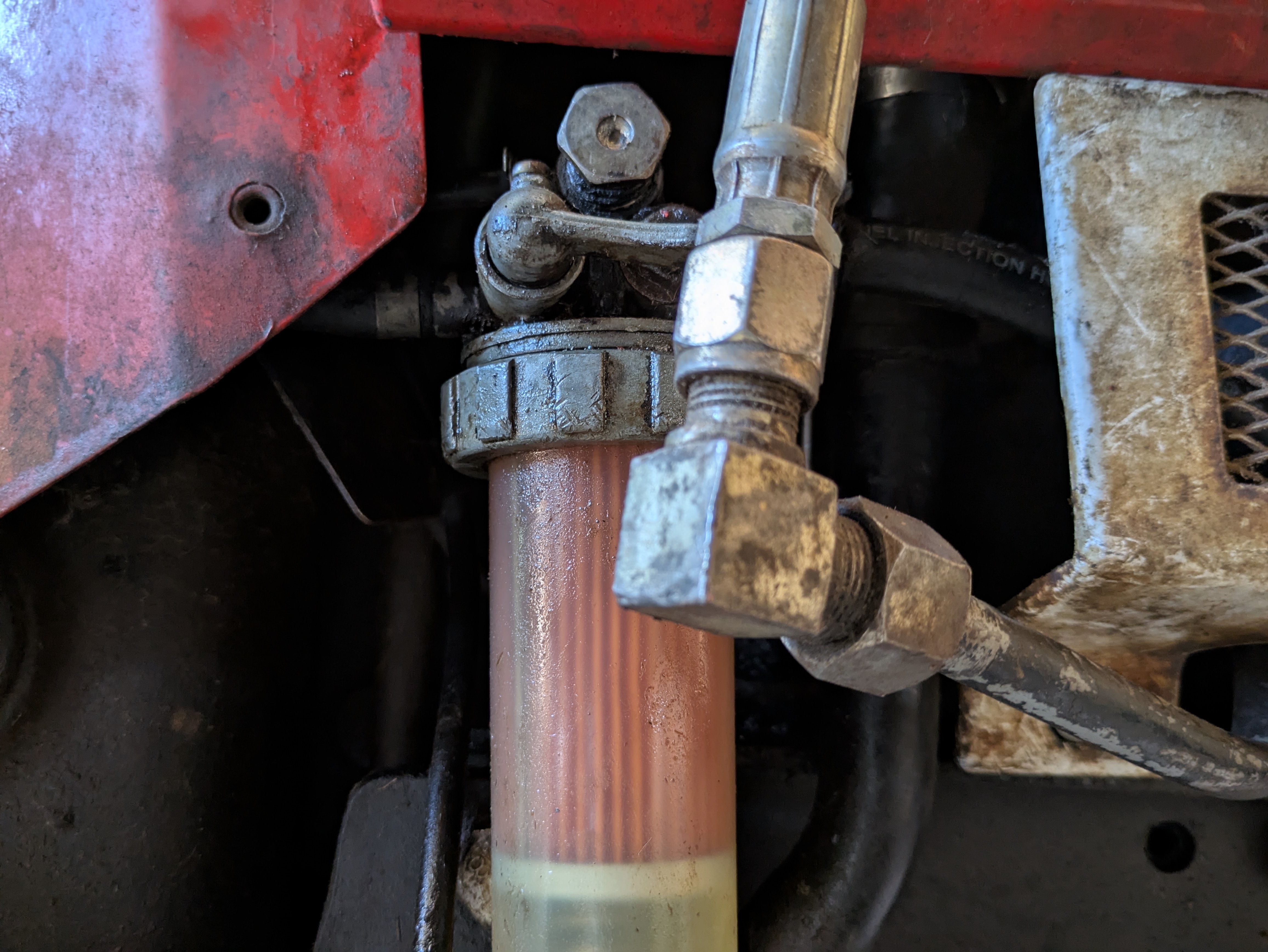

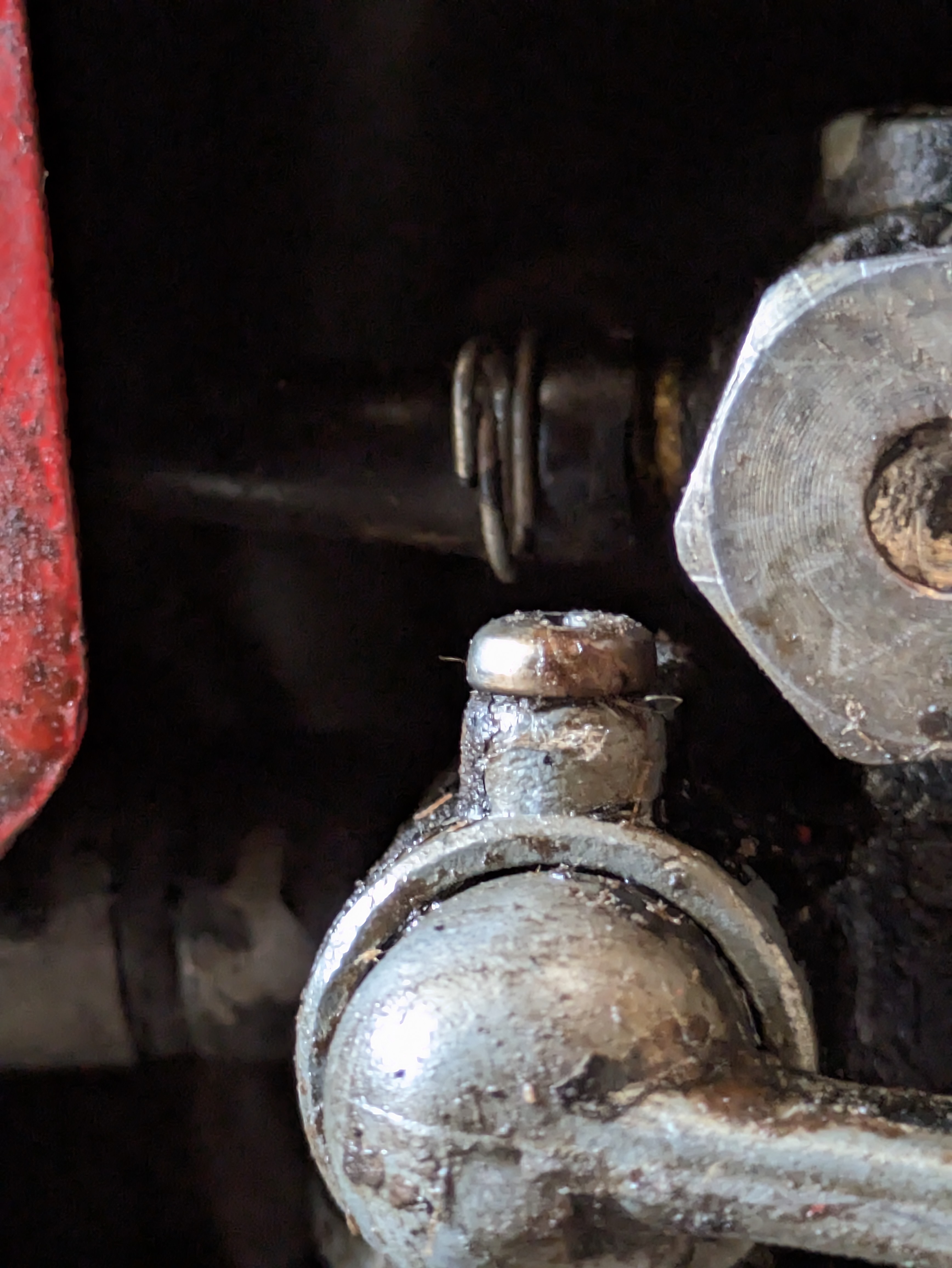

Good evening all,
Long story short, I removed and replaced the right hand engine shroud on my buddy's tractor, and failed to notice what orientation the fuel shut off switch should have been in to allow fuel to flow. I don't know if I moved it during installation...
Can you please let me know if I have it correct? I've included some pictures...thanks in advance!
   / Yanmar F16D fuel shut off switch orientation #2
Like most fluid valves, 90 degree or perpendicular is OFF for our Yanmars.
First photo is Off.
The only time I would turn the fuel inlet to Off like that, is to replace the filter element.
Thank you. Would On be with the handle facing down then?

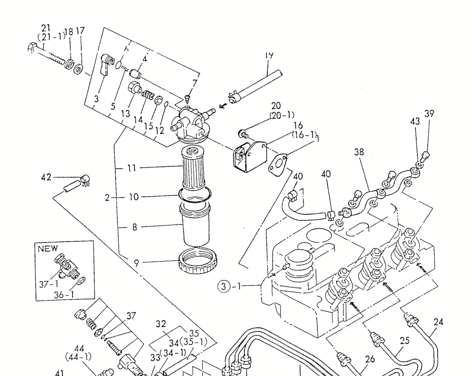

BTW, the YTOG has the manual for your F16 model for free.
YANMAR F16 PARTS MANUAL NPC-1493.pdf
