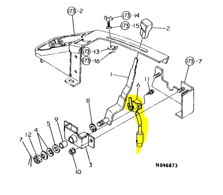

All of a sudden, the 3-point hitch hydraulics on my tractor stopped working, but everything else is fine. Does anyone have a diagram? Any help would be greatly appreciated.
   / Yanmar fx255 Need Help: 3-Point Hitch Hydraulics Stopped Working #2
Do you have a loader or any other hydraulic accessories on the tractor? Does the "UFO" tilt system still work?
The three point hitch on that model is entirely "fly by wire". There is no mechanical connection between the lever and the valve so, if the other stuff is working, the first thing I would check is the fuses and be sure all of the electrical connections are still plugged in. Also be sure the potentiometer on the three point control handle is still connected and moving.
