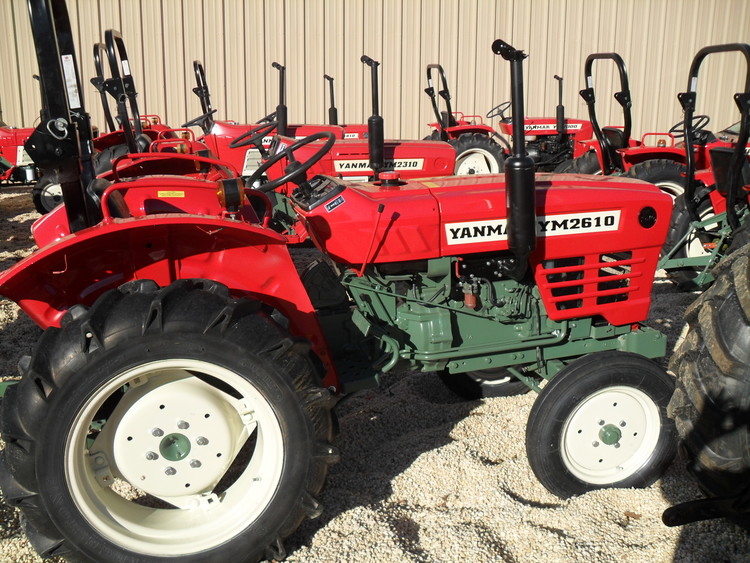

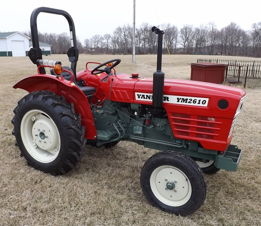

Here's a UTDA YM2610 on the lot.
Here's a UTDA YM2610 in my yard. (Wait, they are both the same machine. :giggle: )

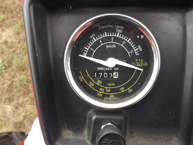

Like the YM2500, the Tach and PTO multi-speed gauge is very much the same.

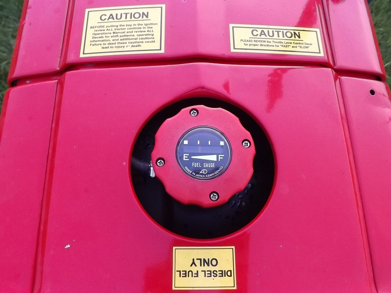

Like a few other YM models, both US import and gray market, the YM2610 can use the fuel gauge with cap arrangement.

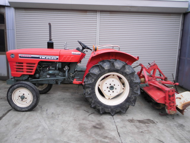

YM2620
It's a tad of an upgrade over the YM2610.
Models ending in -20 were often with a wet brake rear system. Adjusts were a bit easier unless moisture got into the drums and a bit of rust happens.
The YM2620 has one of the popular engine series, the 3T84. The 3T84-NC exactly.
This engine series is seen throughout the YM US & UK domestic machines and in the wonderful Gray Market machines. This offers more parts and options.
Like the YM2610, the YM2620 comes with the PowerShift. Likewise the -10 & -20 share the same engine panels, hood, fenders and other body parts. However, the grill is different, usually a black-charcoal gray and the floor boards are wider and broader in length.

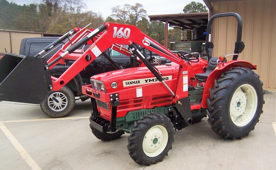

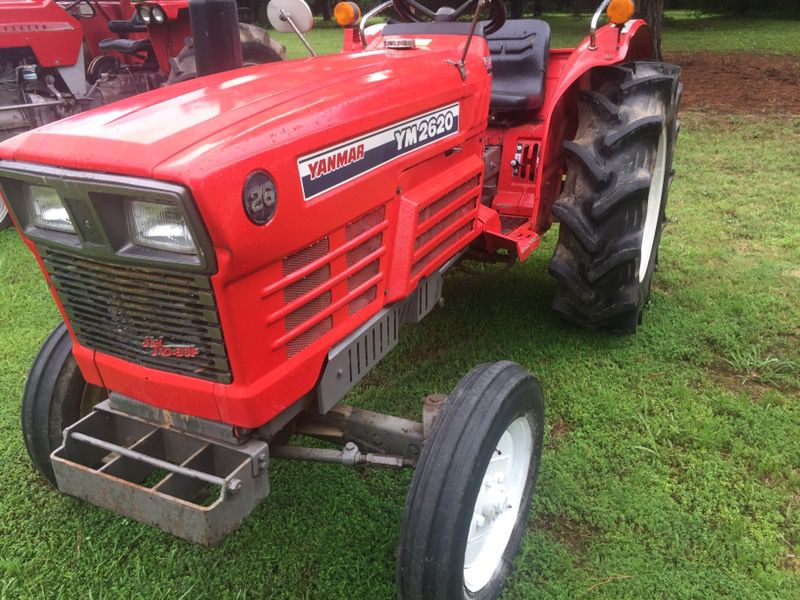

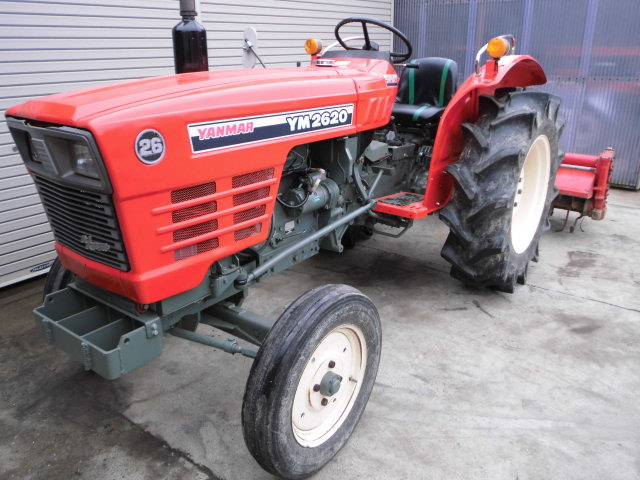

From this stance, it's hard to notice if this is a YM2500, YM2610, YM2620 or a YM2820.
When the engine side panels are on, then it becomes a bit harder as with this UTDA restored model.

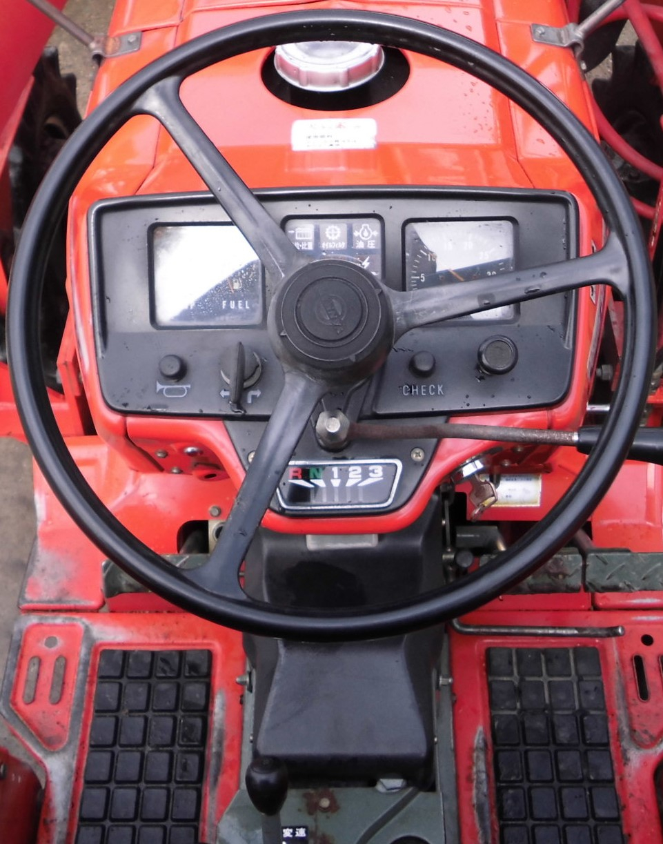

With the -20 models, the dash and gauges are more modern than the -00 and -10 models.
As made by Yanmar with all the panels even around the seating. Likewise, between the two images, it does have the same multi-speed PTO as the YM2610.

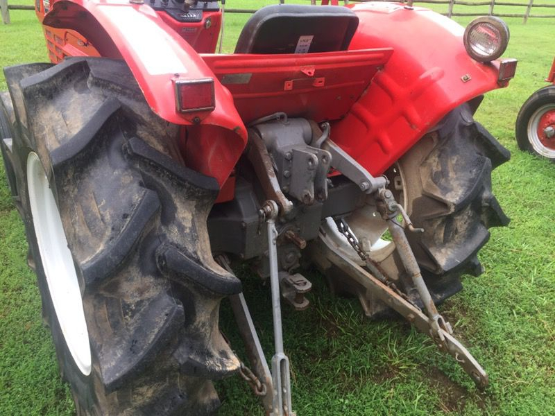

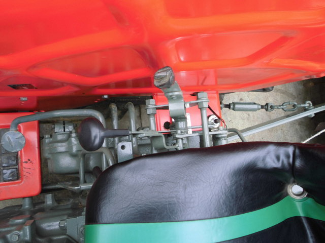

It's hard to if this was a model with 'draft' control for 3PT attachments. I do see the lever next to the 3PT lift lever like the Yanmar made John Deere 50/55-Series.
Behind the seat is a rear wall. Great for a toolbox or ability to have an enclosed cab.

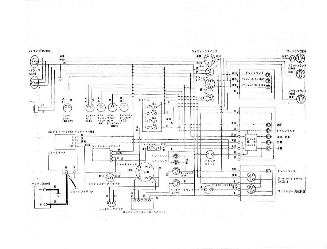

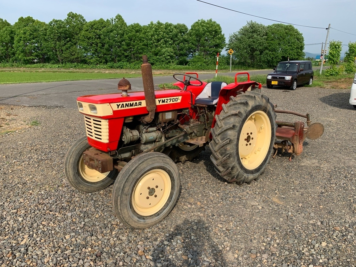

The looks of the two models are nearly identical.

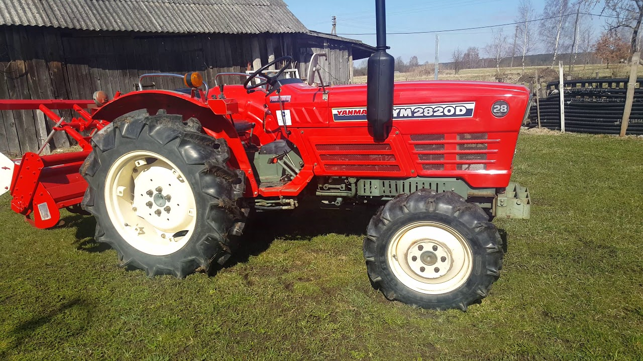

A really nice one from the eastern EU with it's original tiller.

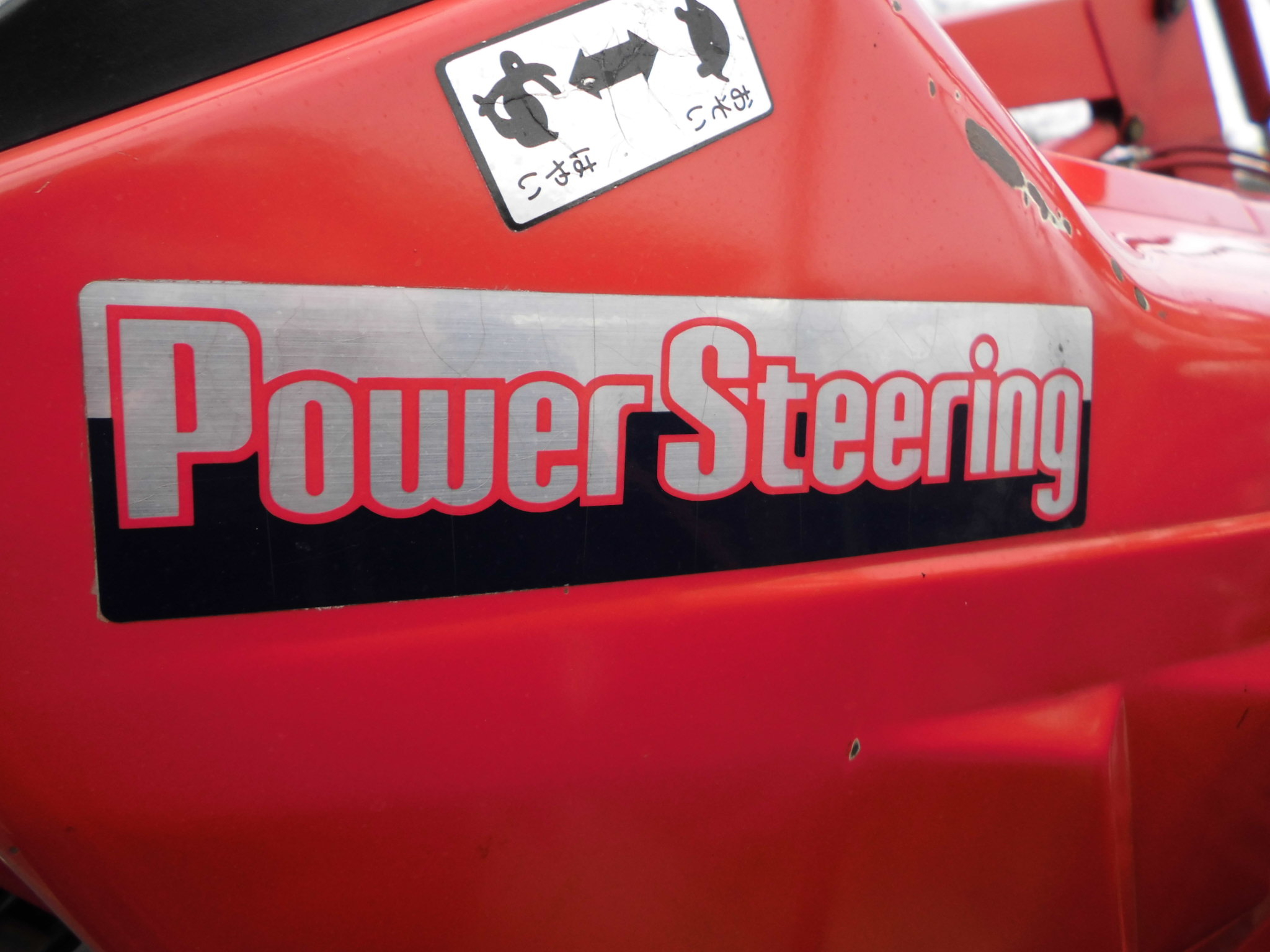

These models typically came with Power Steering.

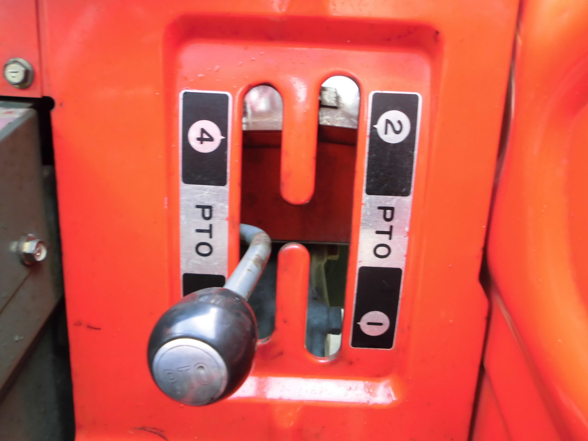

Like many of the YMxx10 & YMxx20 models, the 4 position multi-select PTO controls are standard as well. At a constant RPM, the PTO speeds would increase in value per the machine specification in the Parts Manual, However, if used in combination of various RPM speeds, one can hit the 500/540 RPMs in any of the selections, thus at high engine RPMS or banding down to lower RPMs to save on fuel, reduce engine wear and reduced noise.

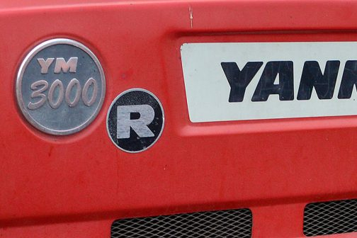

The YM3000 came in an options package as well. The YM3000R. To some, they thought it meant the machine was a tractor-pull event machine or even a tractor racer. We can see Robin with his YM3000R model.
It took several months to understand that the R after any YM model was indeed not a racer machine. Upon research in the Yanmar Tiller manuals, the R simple meant the machine had all the options to work in the rice paddy fields. Thus one could say, they own a Japan Ricer machine. Back in the 1980s, as Japan vehicle imports hit North America, people called those small cars, rice burners. Funny how the pun can be applied here.

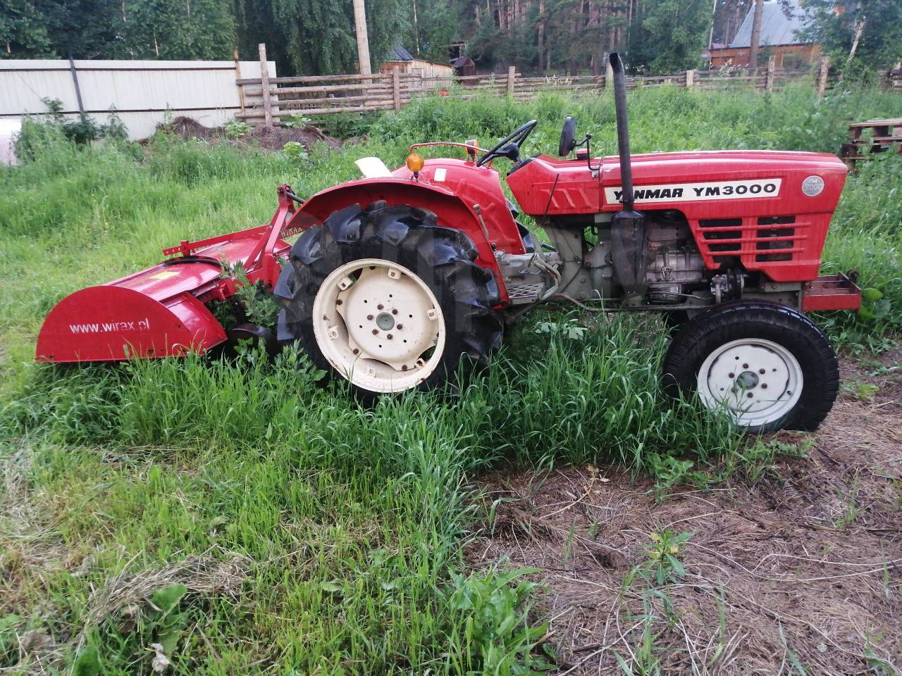

A nice one out of Poland.
