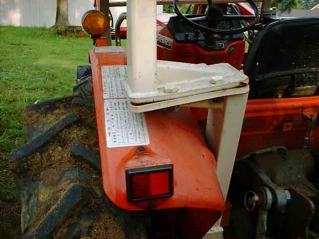

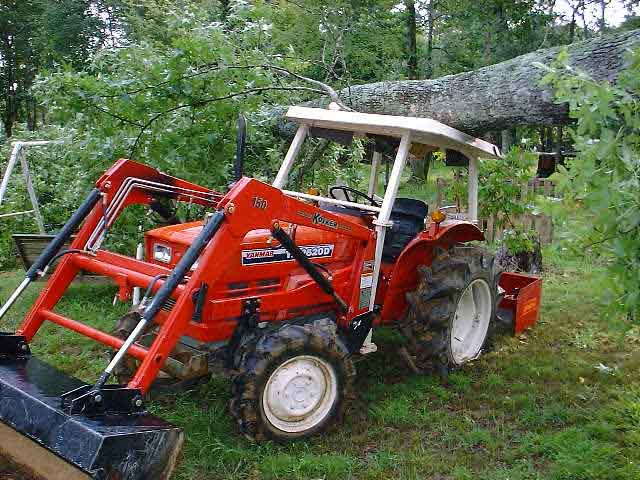

/ Yanmar & ROPS #24
To Reed:
</font><font color="blue" class="small">( From what I can see, the one on Hoye's logo on the top of this page looks awful stout. I would like to see more of it. )</font>
The tractor in Hoyes ad appears to be an FX. Attached is a picture of a YM2620D that I had. I have posted this picture before. It shows how stout that ROPS is.
/ Yanmar & ROPS #25
Other than the fiber glass top shattering this was the only damage.

/ Yanmar & ROPS #29
Aaron, is that the original base (axle to first plate) on the rear of the tractor. Is this strong enough for ROP?
Don

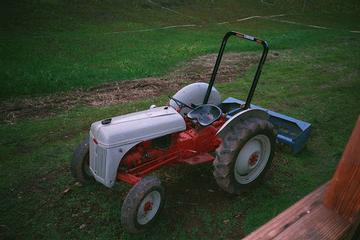

Soundguy....does it look like this? I don't recall where I got this picture but it is an aftermarket ROPS........I have a small collection on my other PC but it is in for repairs and this pix just happened to be on the laptop.
Mark
/ Yanmar & ROPS #35
It very well could be. The pic I say was from a right side view.. slightly canted to see some of the drivers seat.. but it had those distinct swept back features... I guess to stop the rear rollover very early before much weight would be on the rops.. etc.
Soundguy
