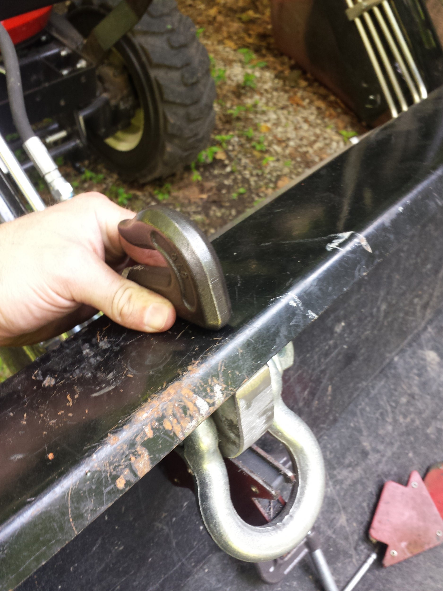

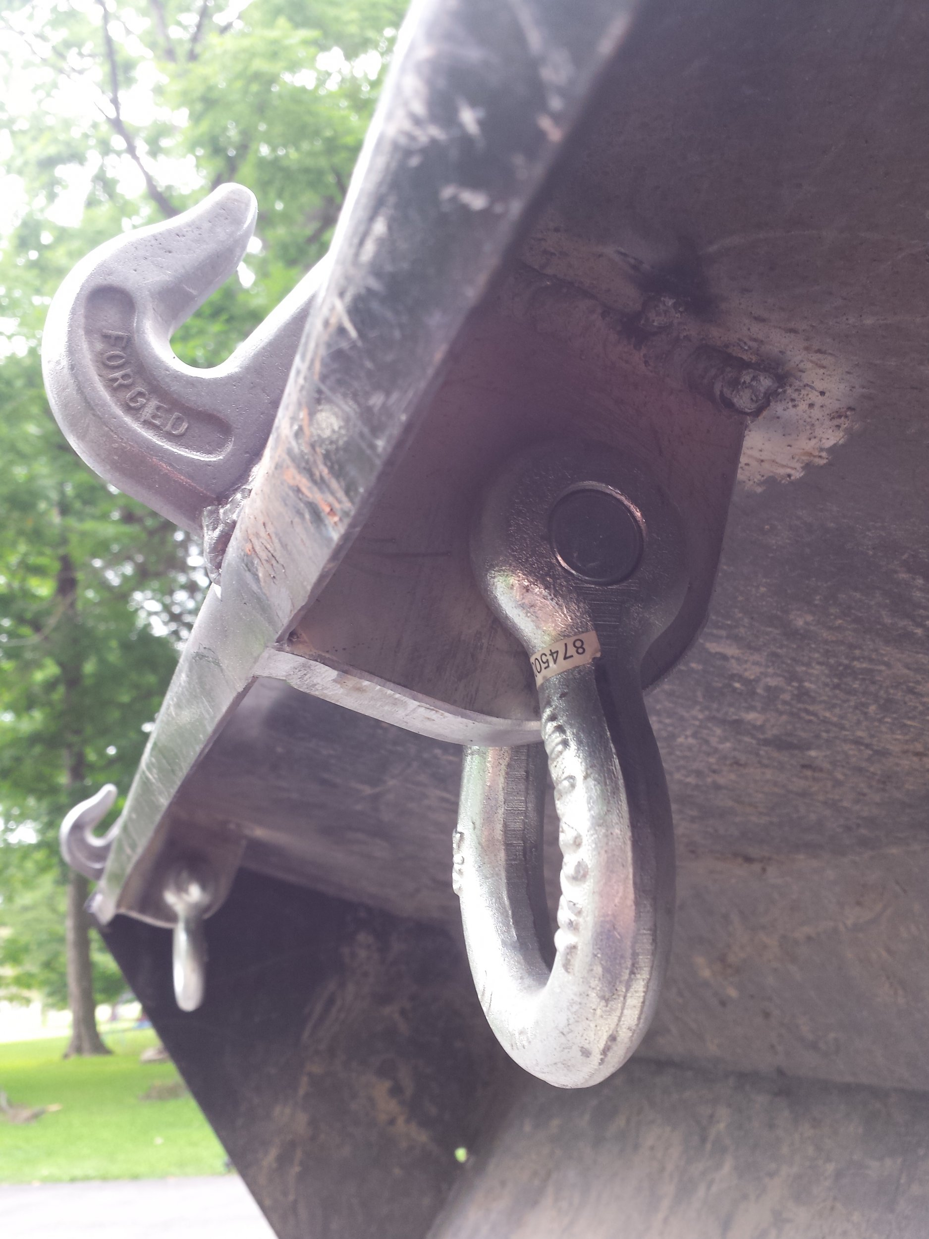

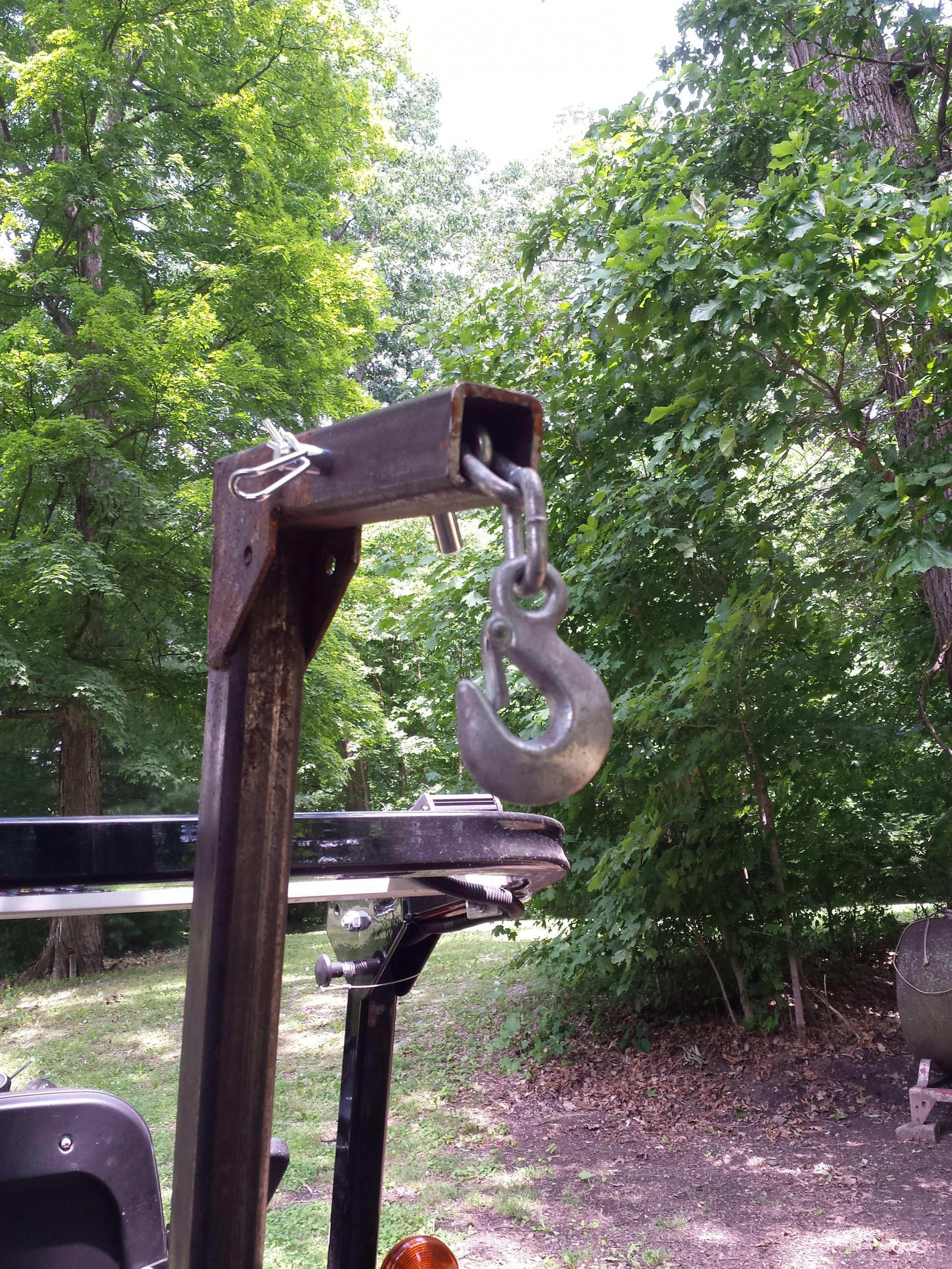

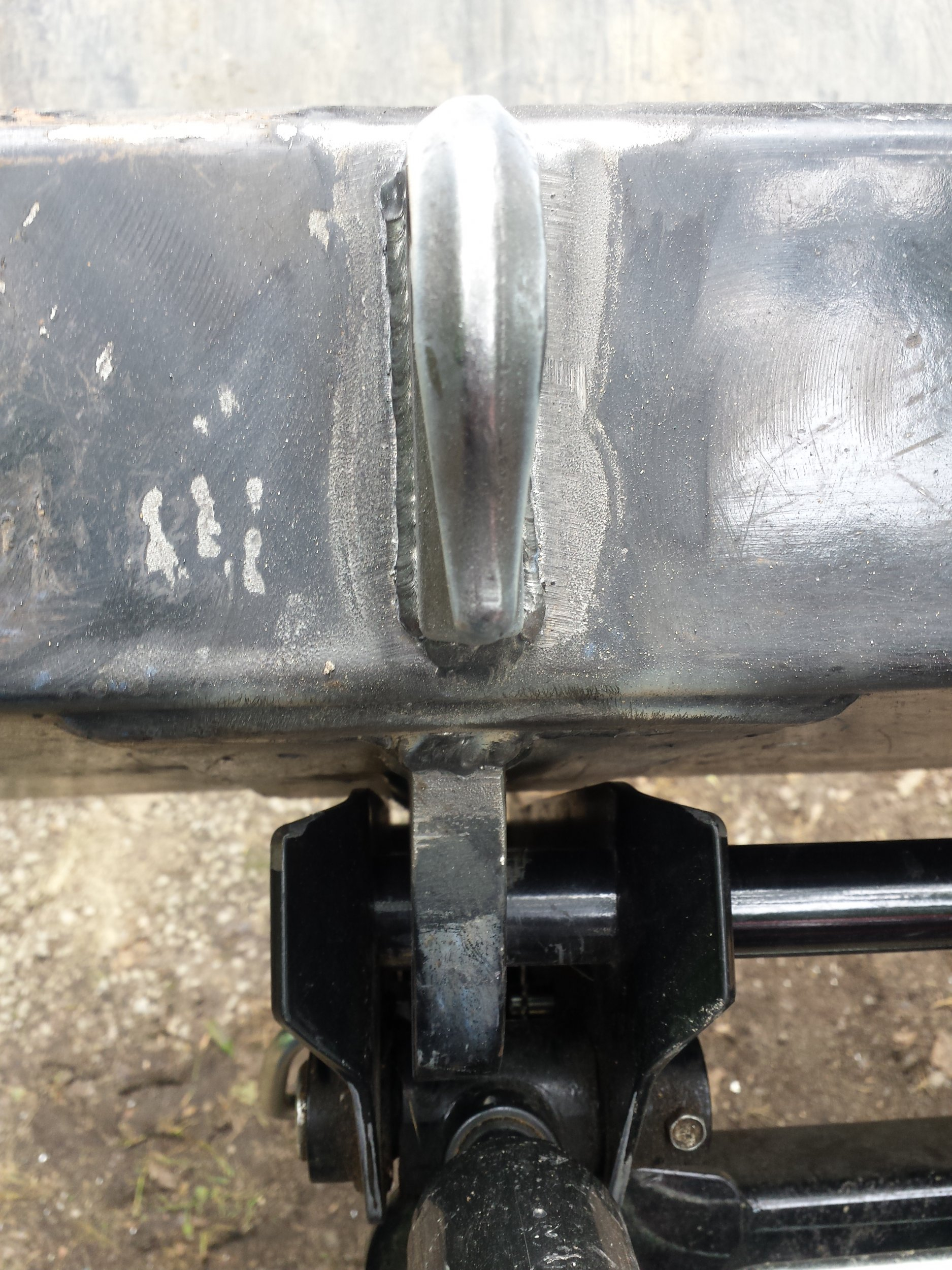

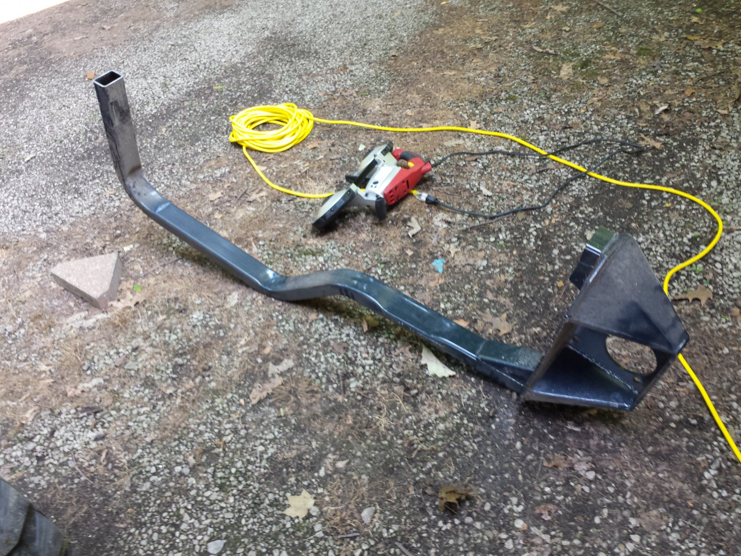

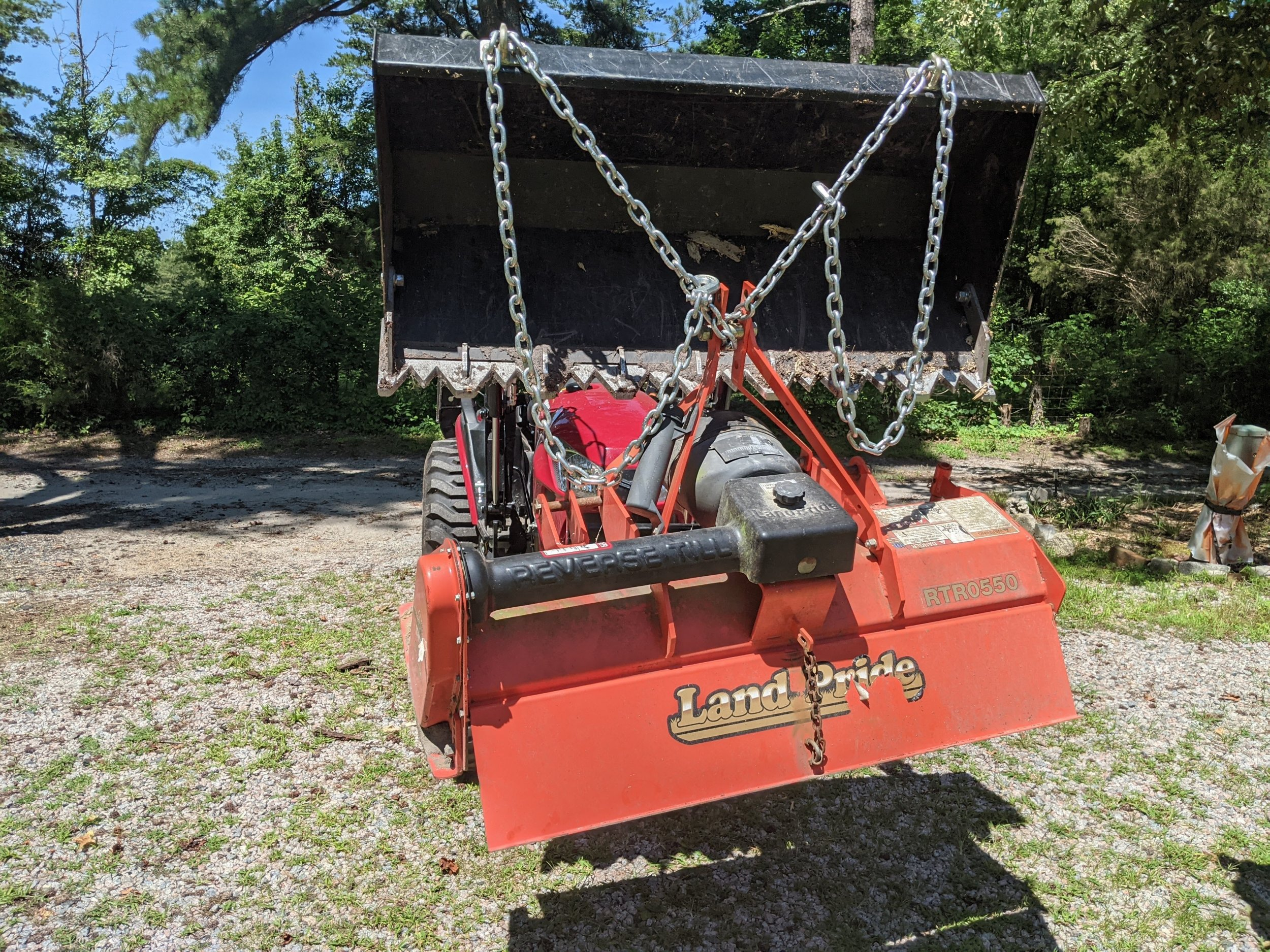

I found some time to finsh getting the bucket grab hooks in place yesterday. I'm not used to welding such thick material. I don't think I'll have anything to worry about as it seems quite solid.

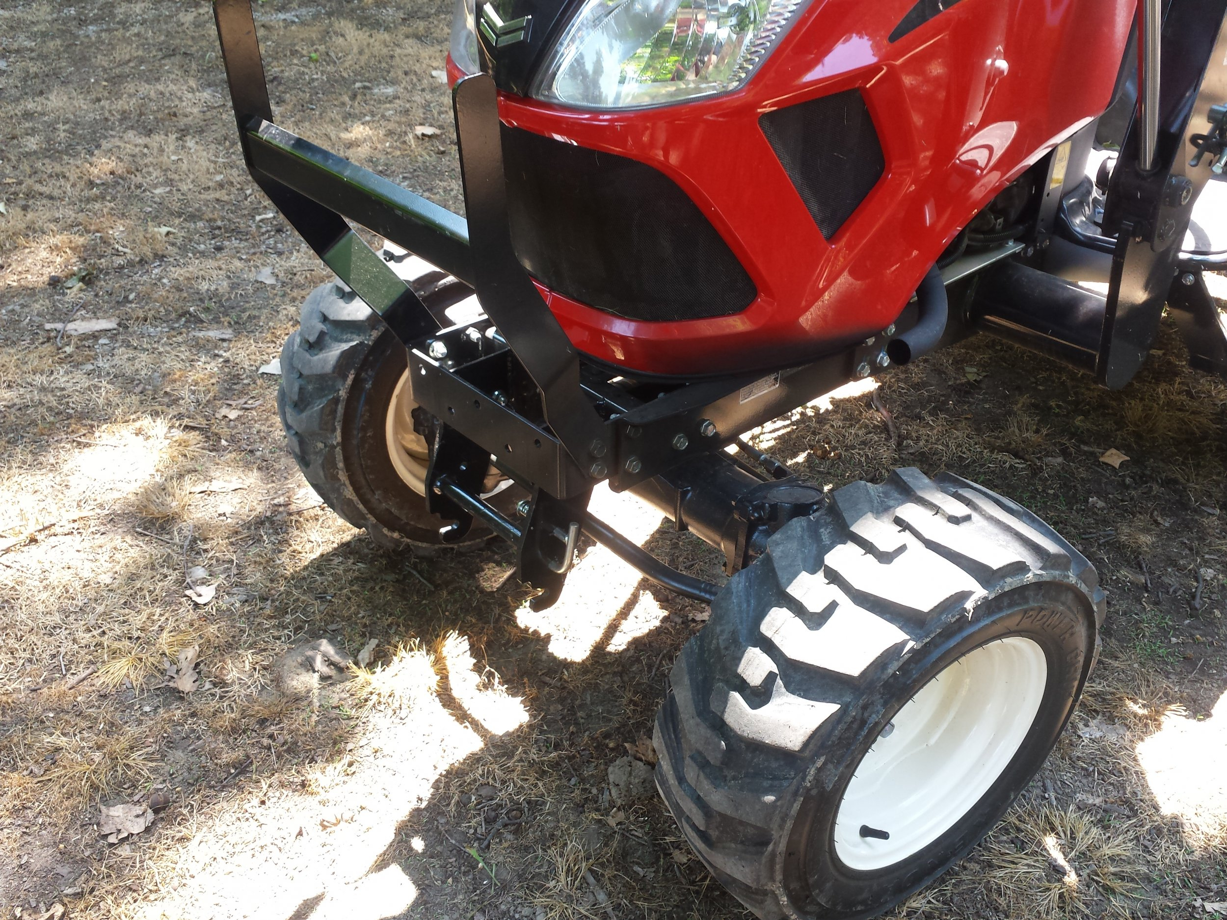

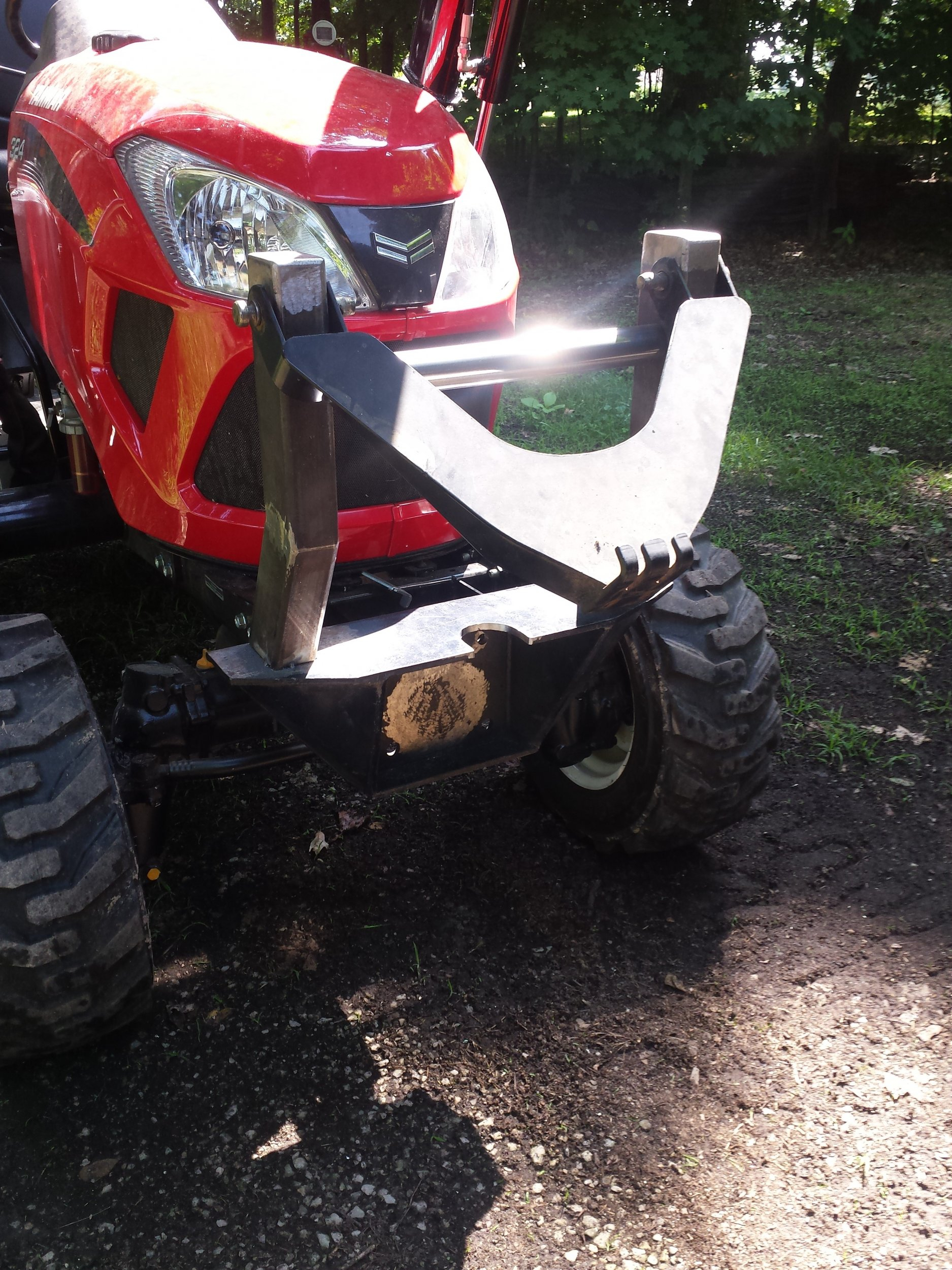

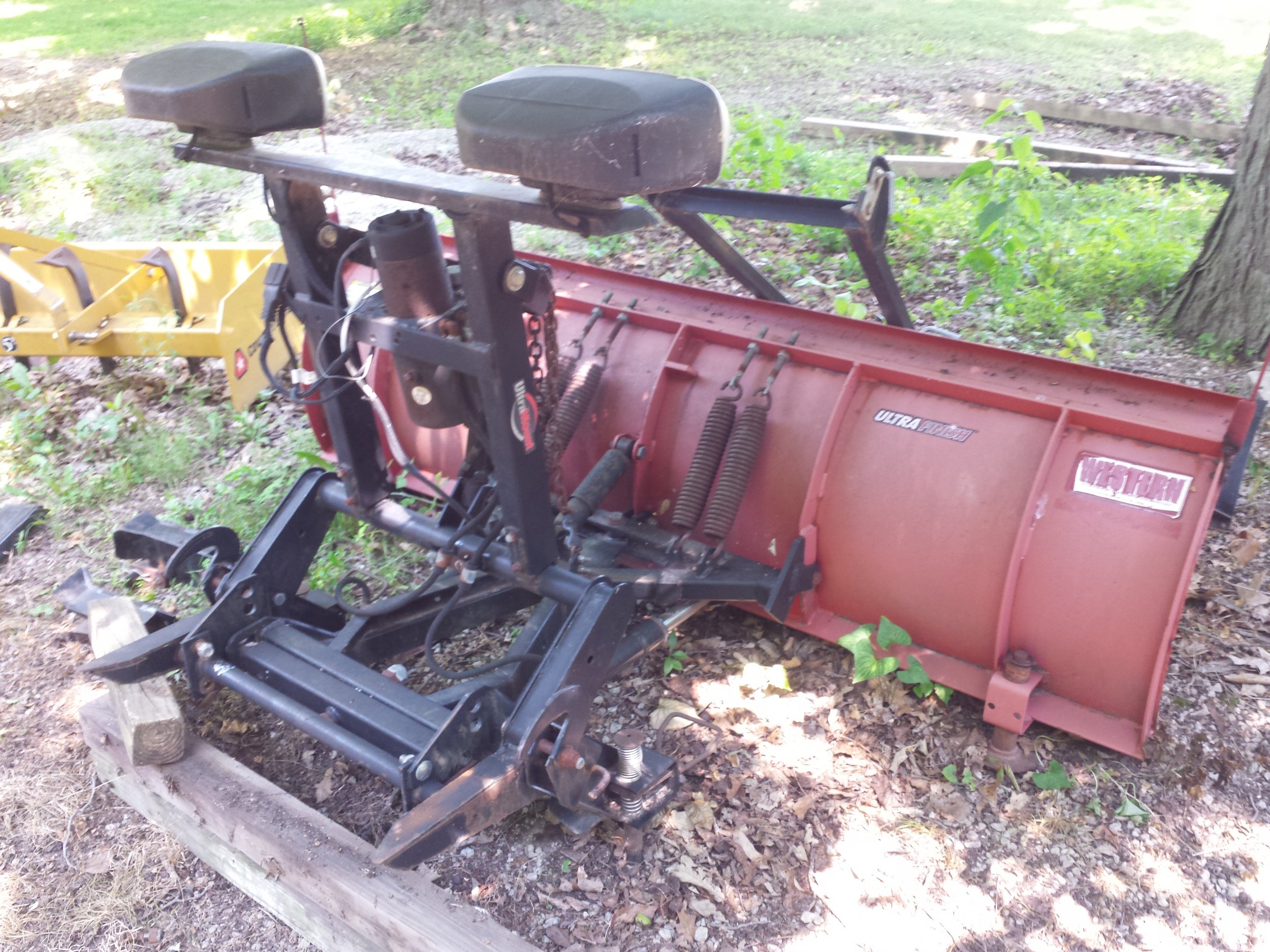

Next major undertaking... attaching a 7'6" Western plow I've had sitting around for years to the front of the SA324.
   / Yanmar SA Mods

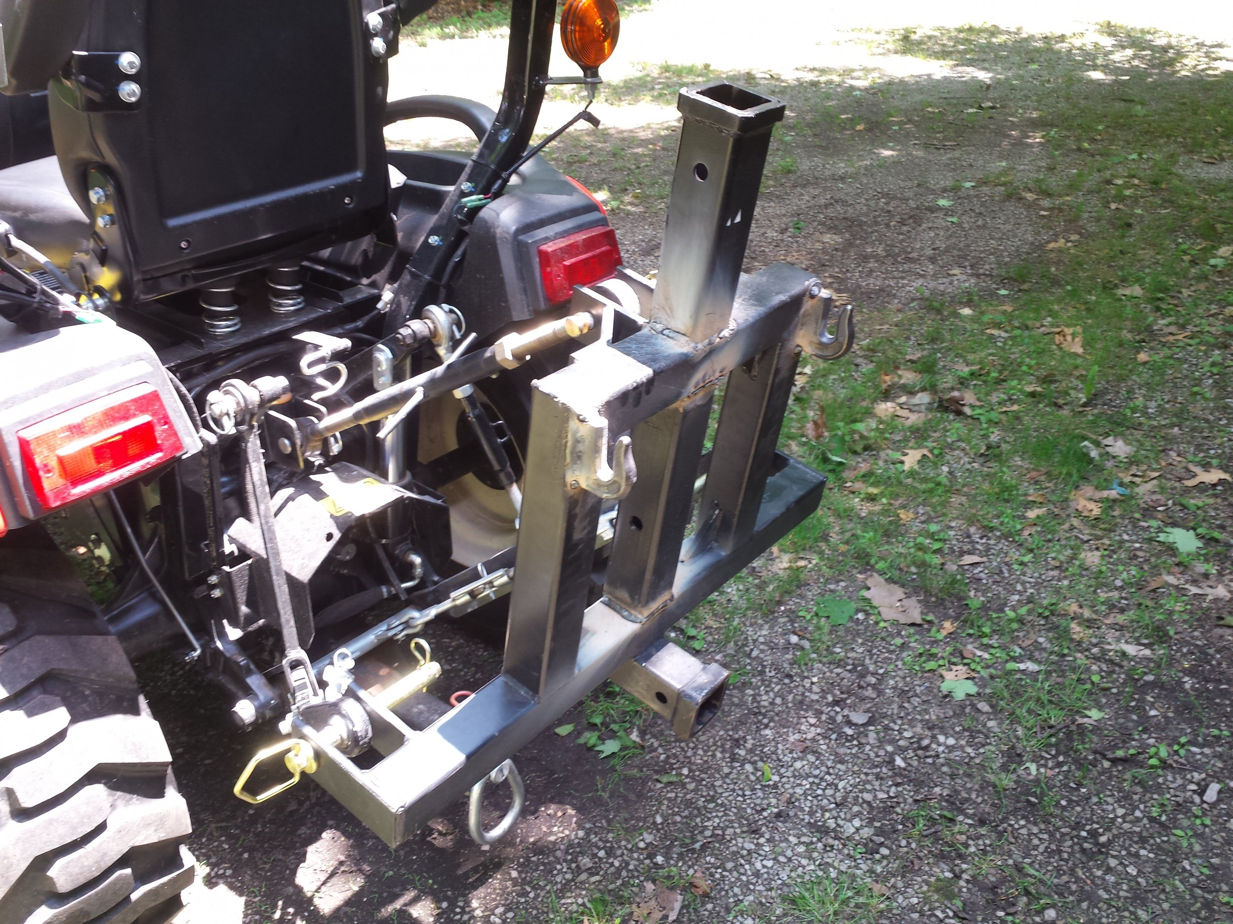

#23

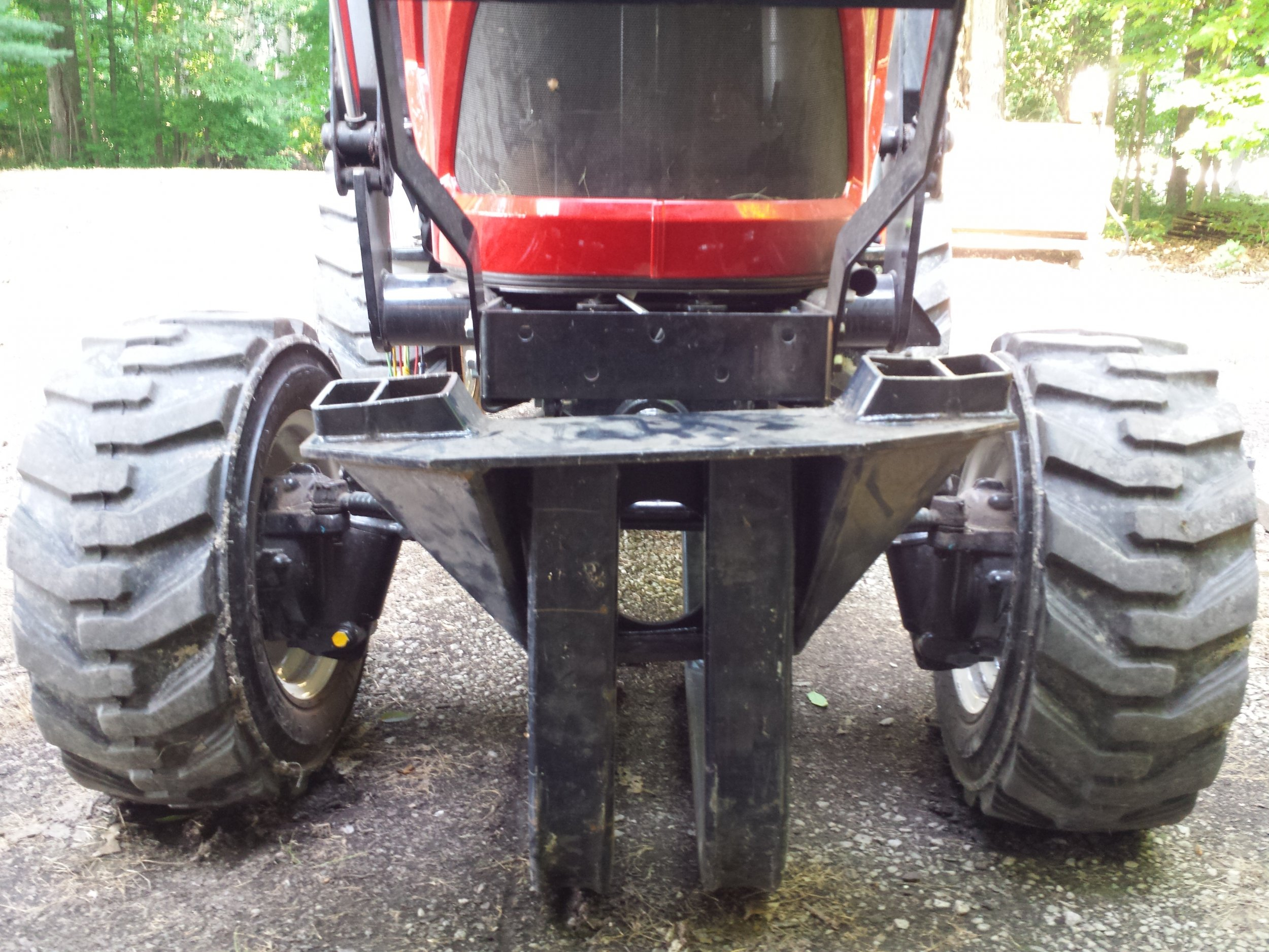

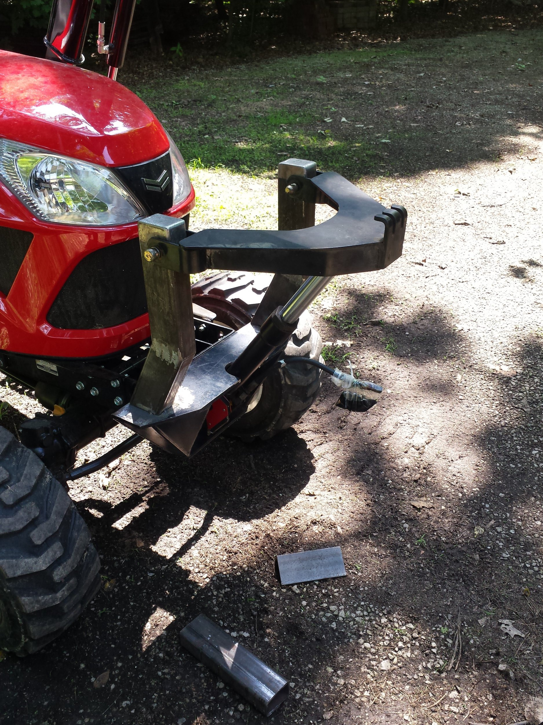

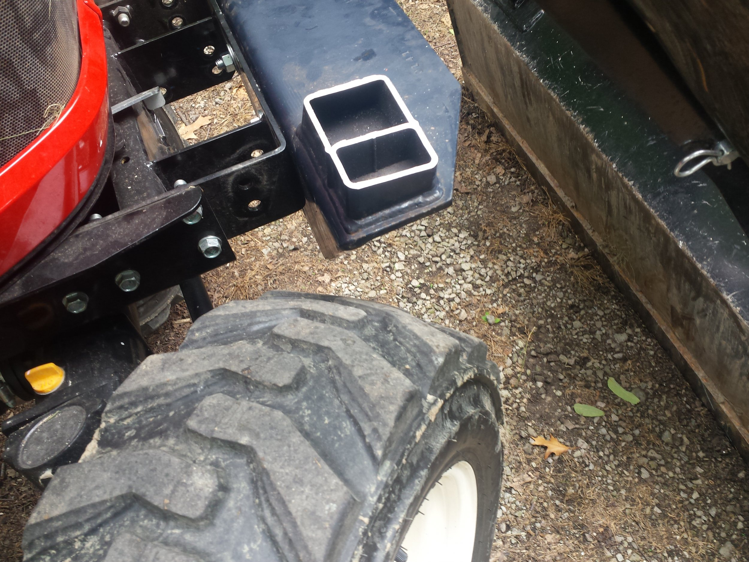

I have stared at the plow and tractor for a total of three evenings and I finally came up with a plan using stuff I had laying around.
Strongly considering the size and weight of the plow, I've decided to build a subframe on the front of the tractor. The previous owners of my property must have had an Allis-Chalmers 5220 or 5230 because they left the brand new ROPS in the barn. Lucky me! The beefy ROPS has become the basis for the subframe. I don't think I could have asked for a more perfect thing to start with.
The subframe will (tentatively) attach at the rear mid-mount mower lift point, the front mid-mount mower lift point (rear of the front-end loader mounts), and the front "bumper". The primary issue that the hacked-up ROPS is going to solve is clearing the front axle with the axle at full articulation and steering at full lock. The mock-ups I've done make it seem VERY promising.

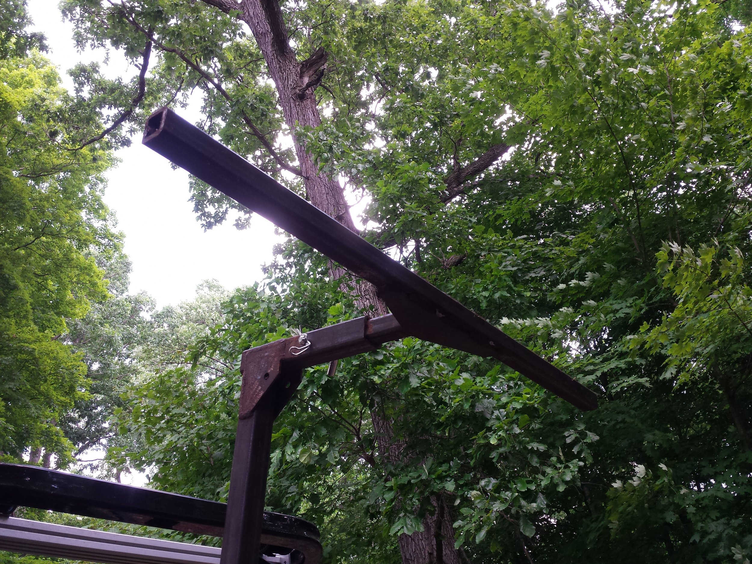

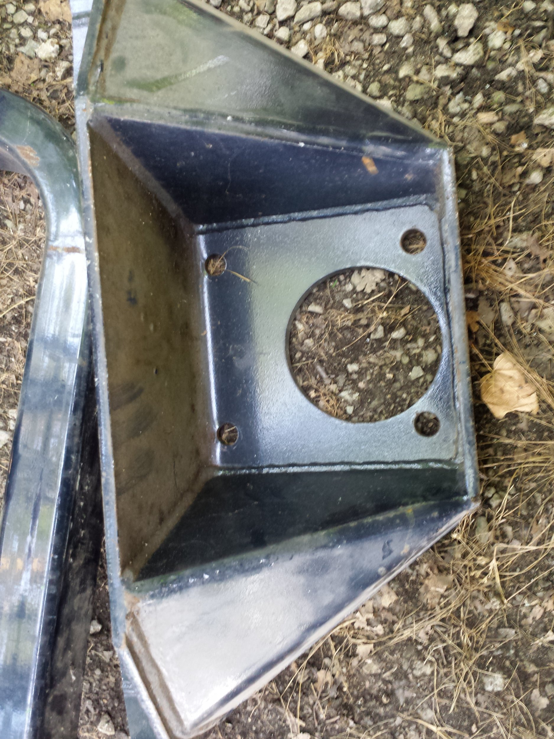

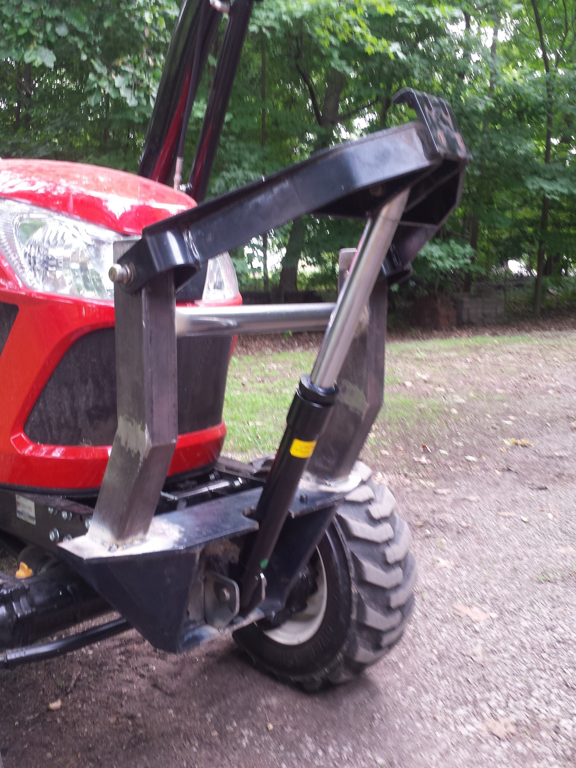

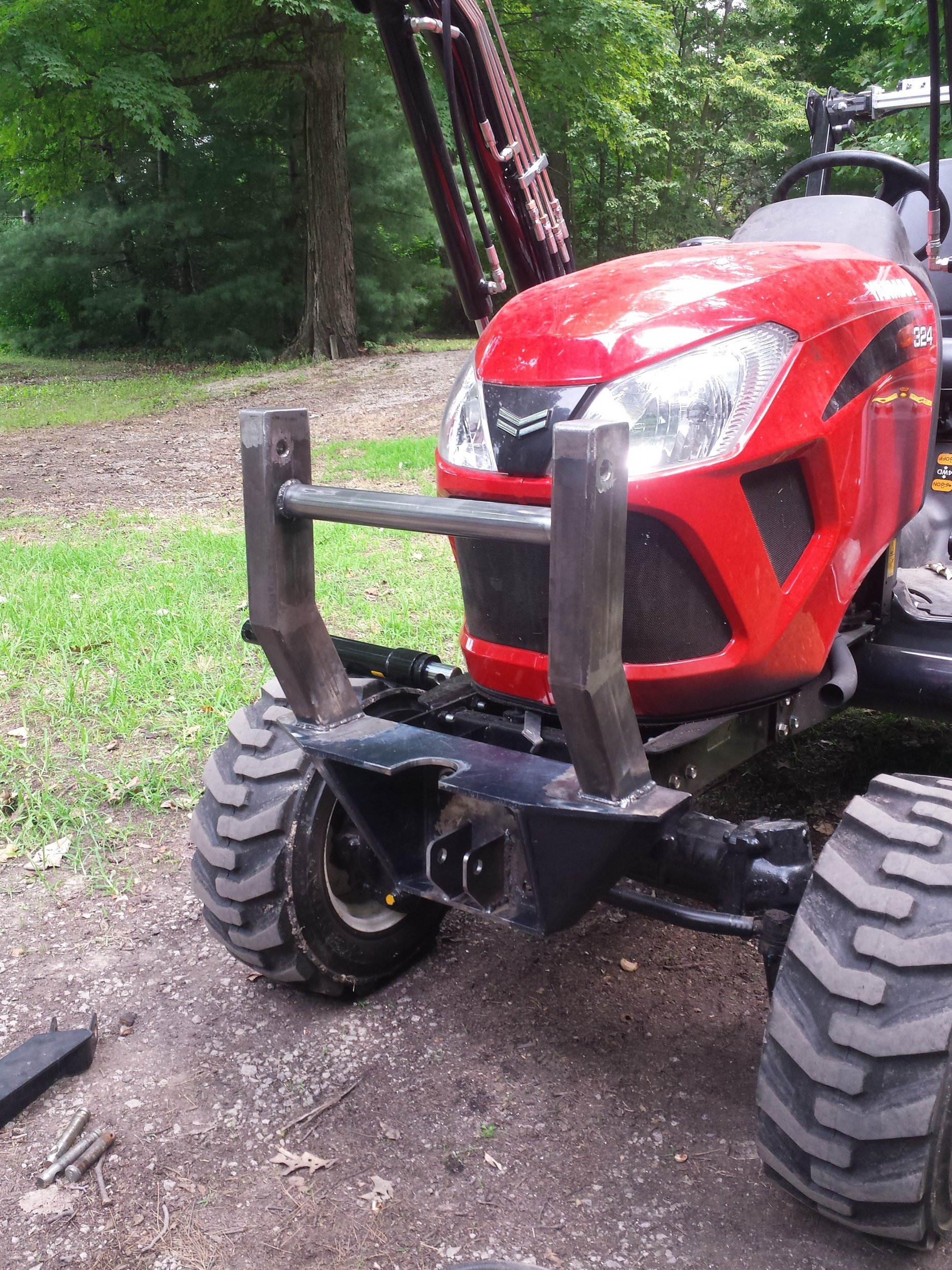

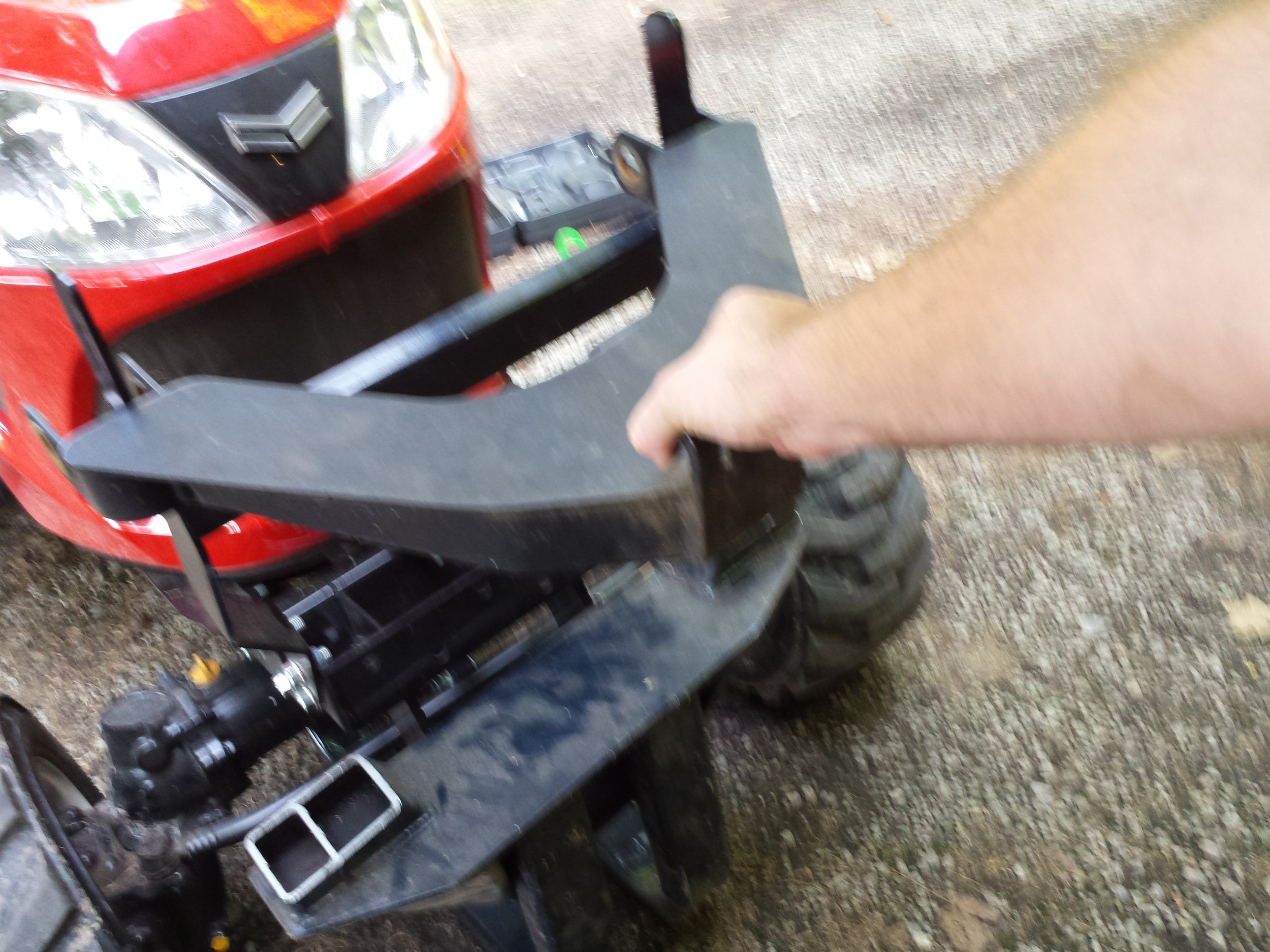

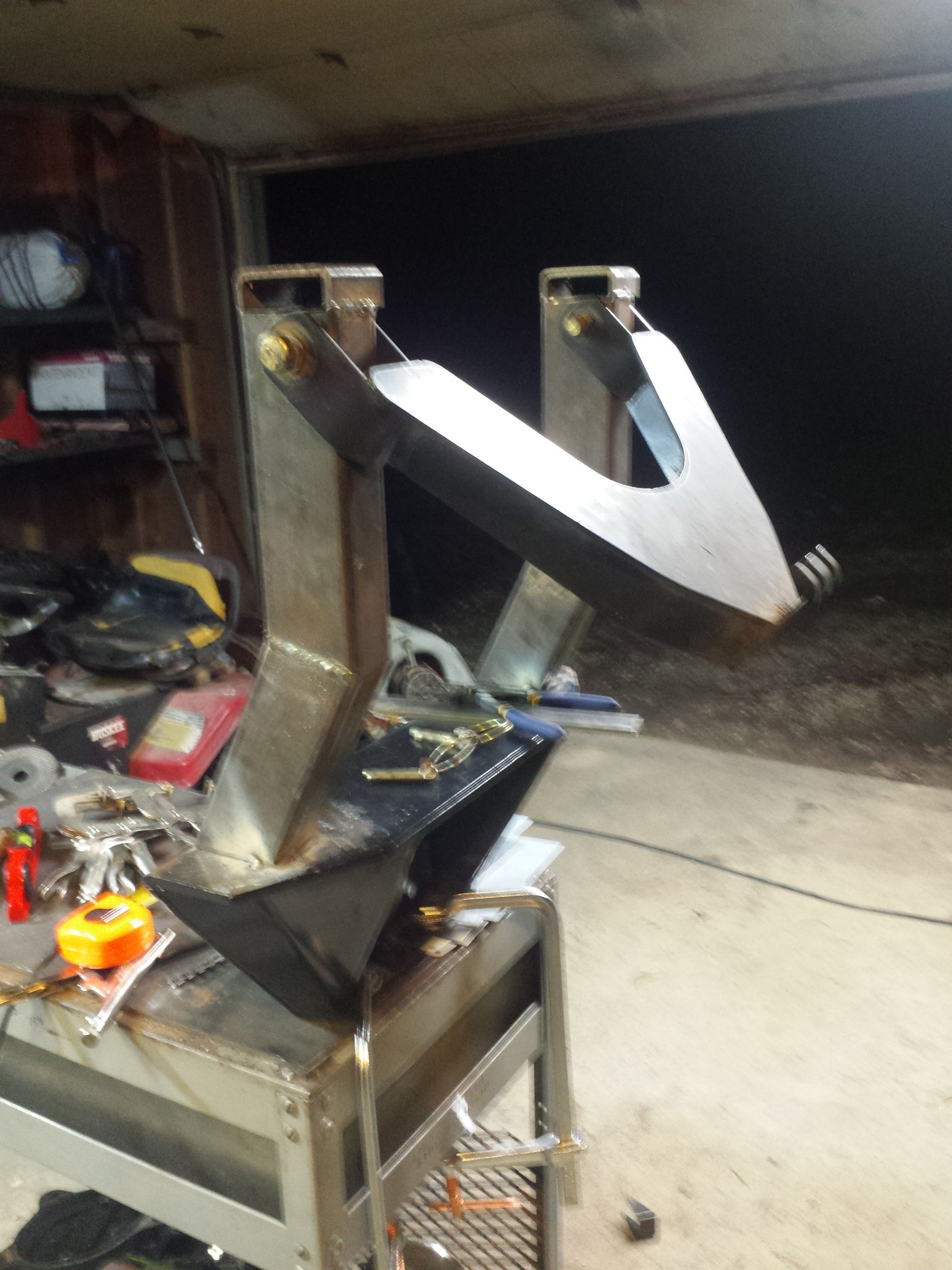

I've also mulled over how to handle the plow lift mechanism on the tractor side. Some more staring lead me to the leftover mount of the repurposed ROPS. It is going to become the new permanent front bumper on the tractor. I drilled some holes and did a quick test fit. I lifted the front of the tractor with the loader and check for clearance between the tires and bumper. Plenty of room and it looks like some monster off-road bumper you'd find on a Jeep!
The "bumper" will be fitted with two upright arms to support the plow's lift arm. It will ultimately look sort of like a brush guard and function as one since the original will have to be removed. The plow lift arm and plow lift cylinder will pin-on so they can be removed when the plow is not attached.

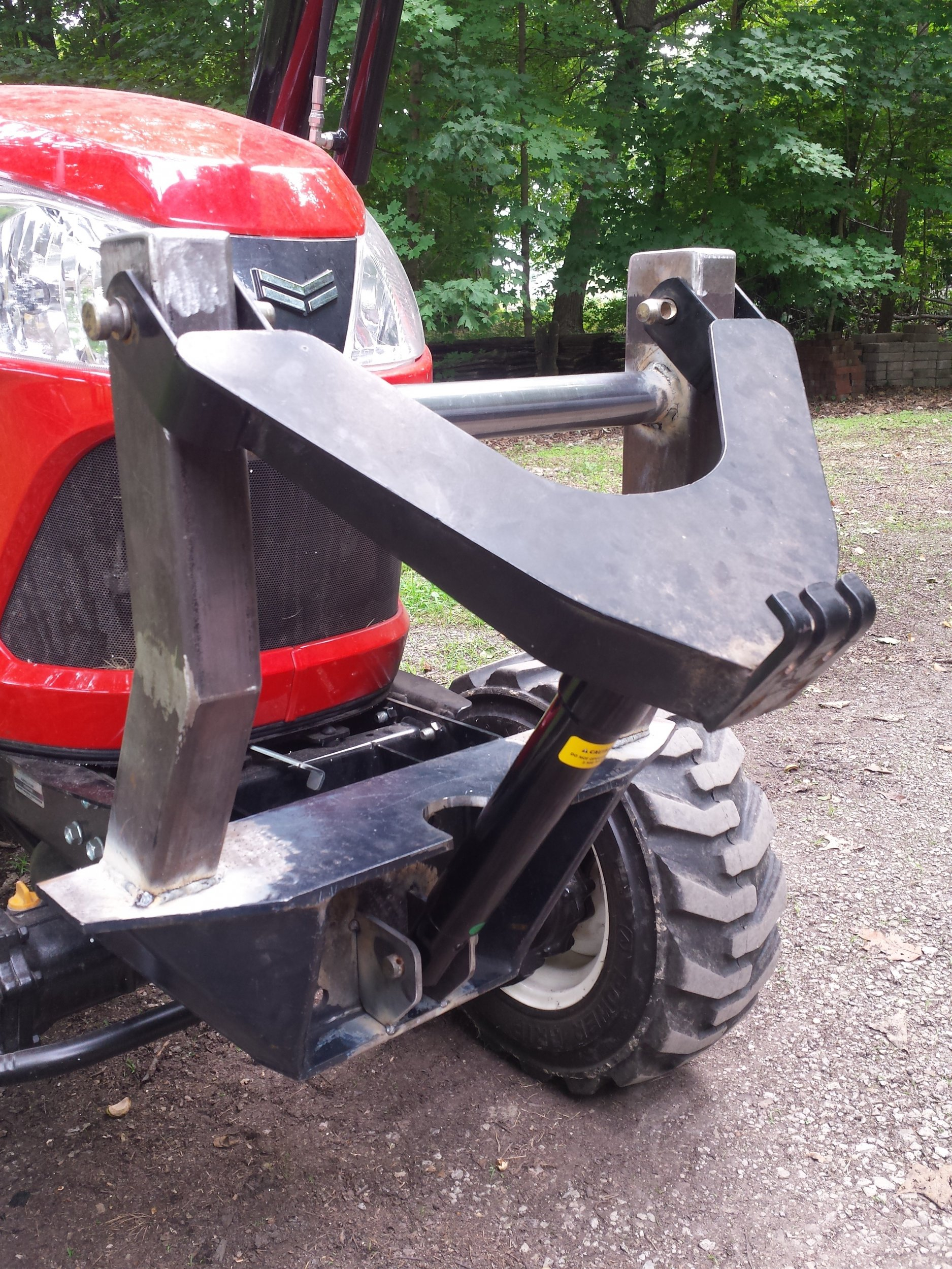

#26

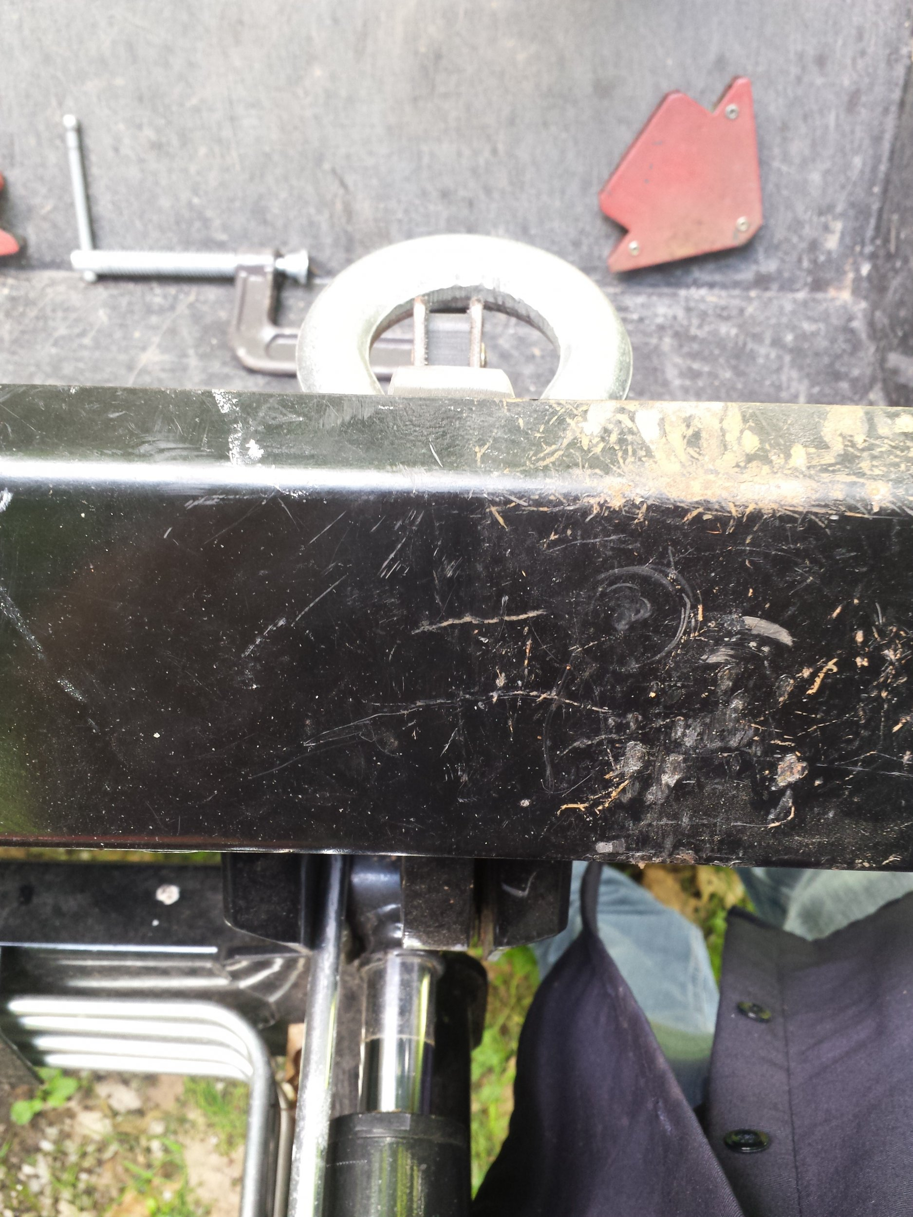

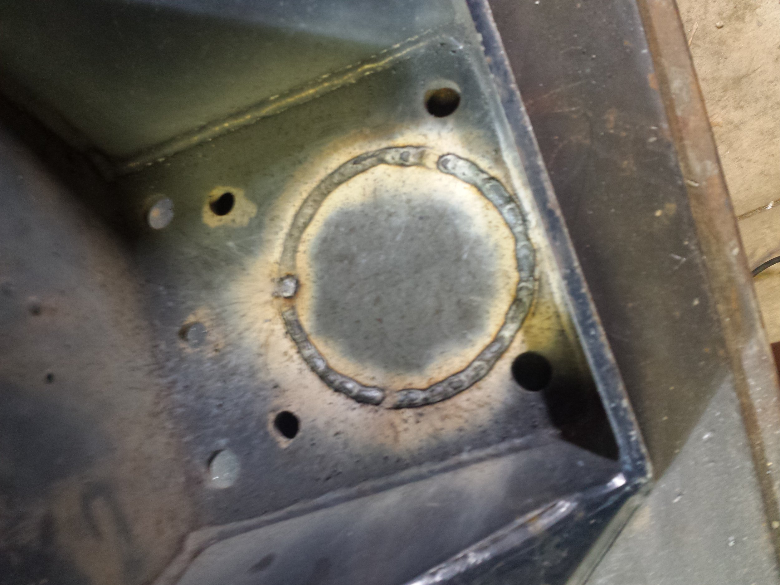

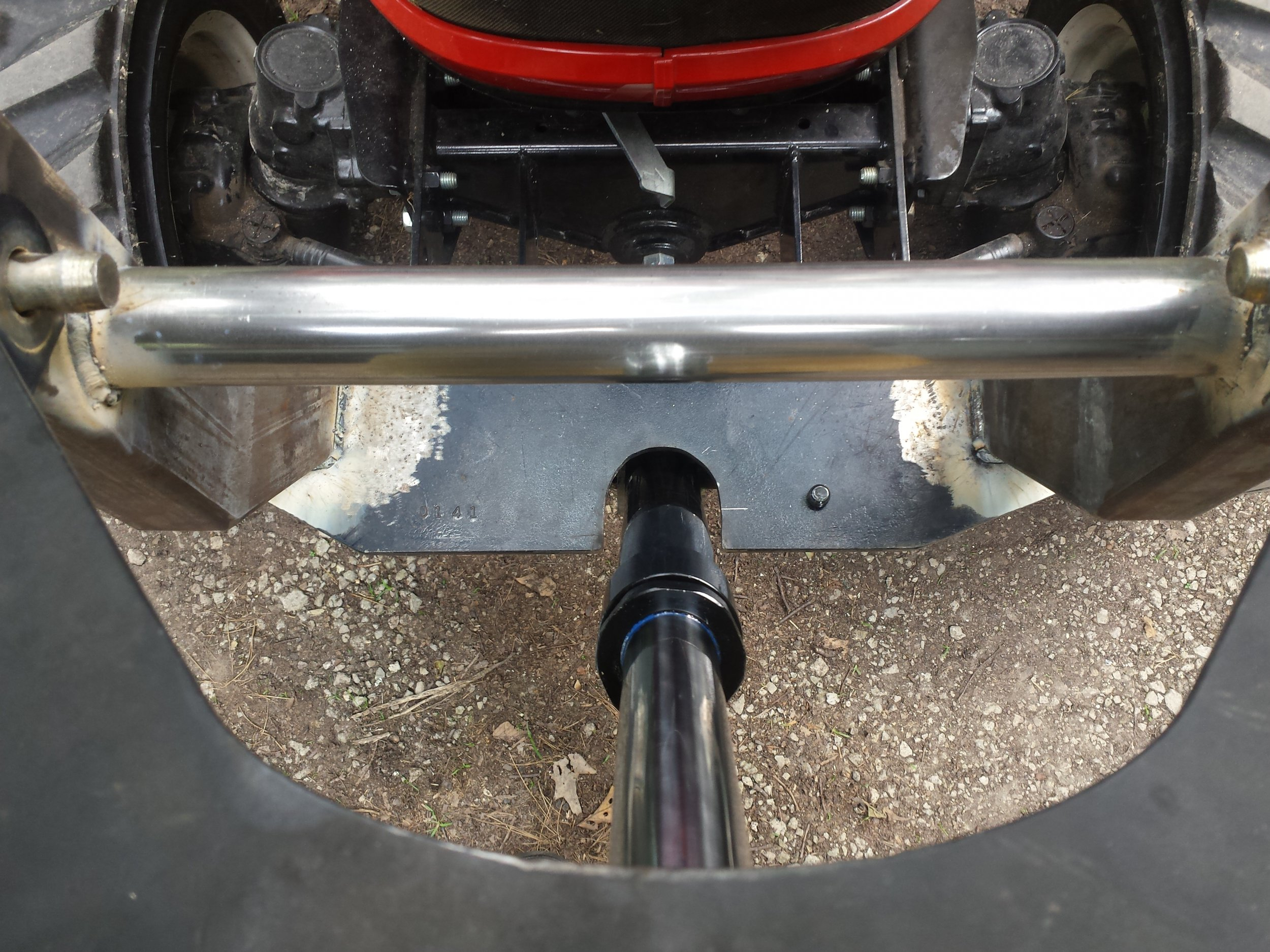

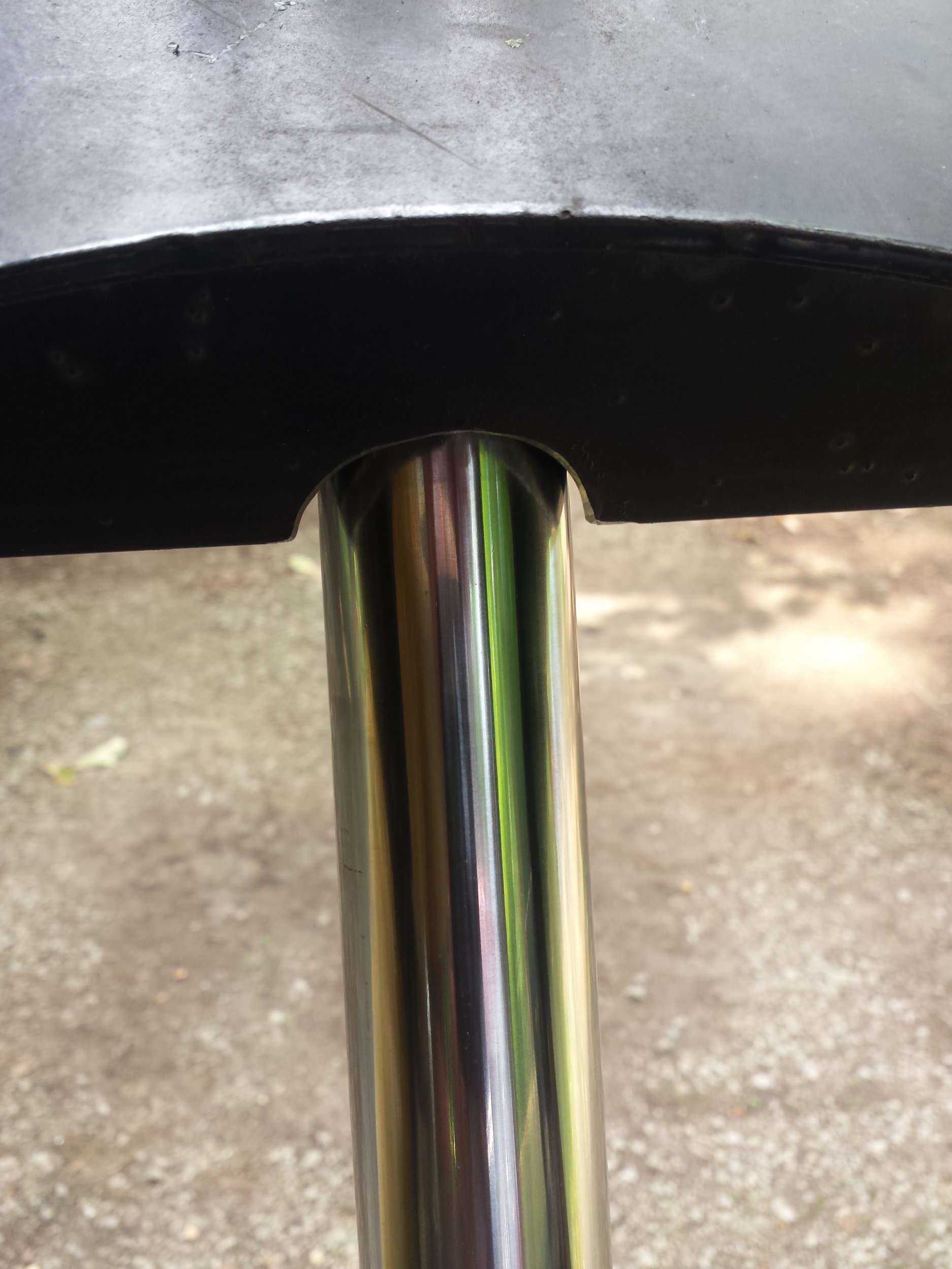

The lift cylinder that was on the plow had some pitting/peeling on the cylinder itself, so I ordered a replacement. I decided to go with a 1.5" x 10" (instead of the stock 8" stroke) so that the lower mount worked out a little better. I don't think I'll actually need the extra lift height unless I'm making some big snow mounds.
I also got the brush guard cross bar installed.
The entire lift mechanism pins on and can be installed/removed in a matter of minutes.
Due to the extended lift height, I had to notch out the back of the lift arm to make room for the cylinder.

Is the plan to remove the bucket and use those hydraulic lines for the plow?
Yes! The overall idea is to make the plow and components as quick-attach as I possibly can. Using the tractors existing hydraulic system helps make that possible. I'm shooting for < 5 minutes on/off.
All the hydraulic hoses on the plow need replaced anyway, so I'll replace them with lines long enough to run to the existing connections on the tractor.

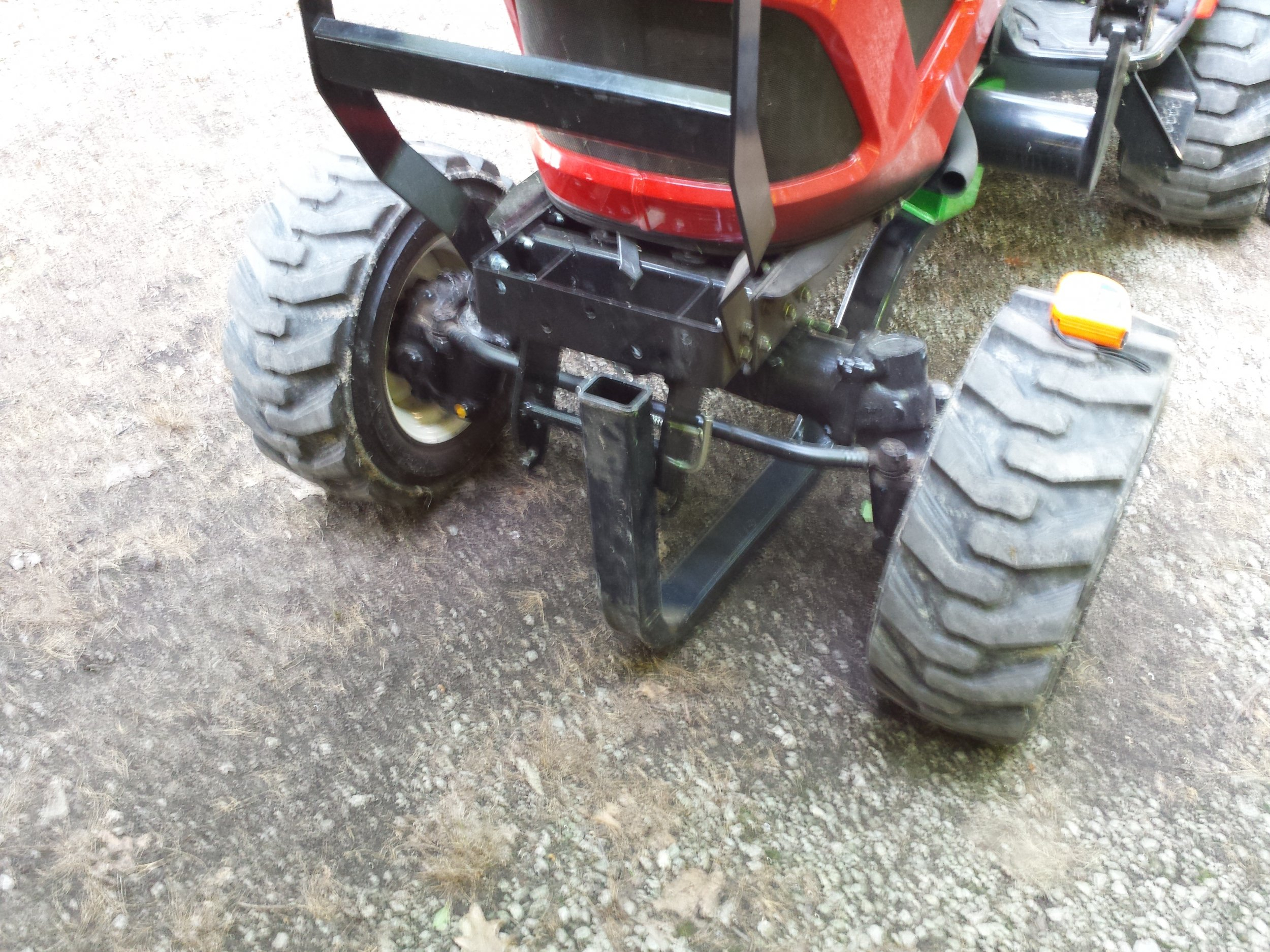

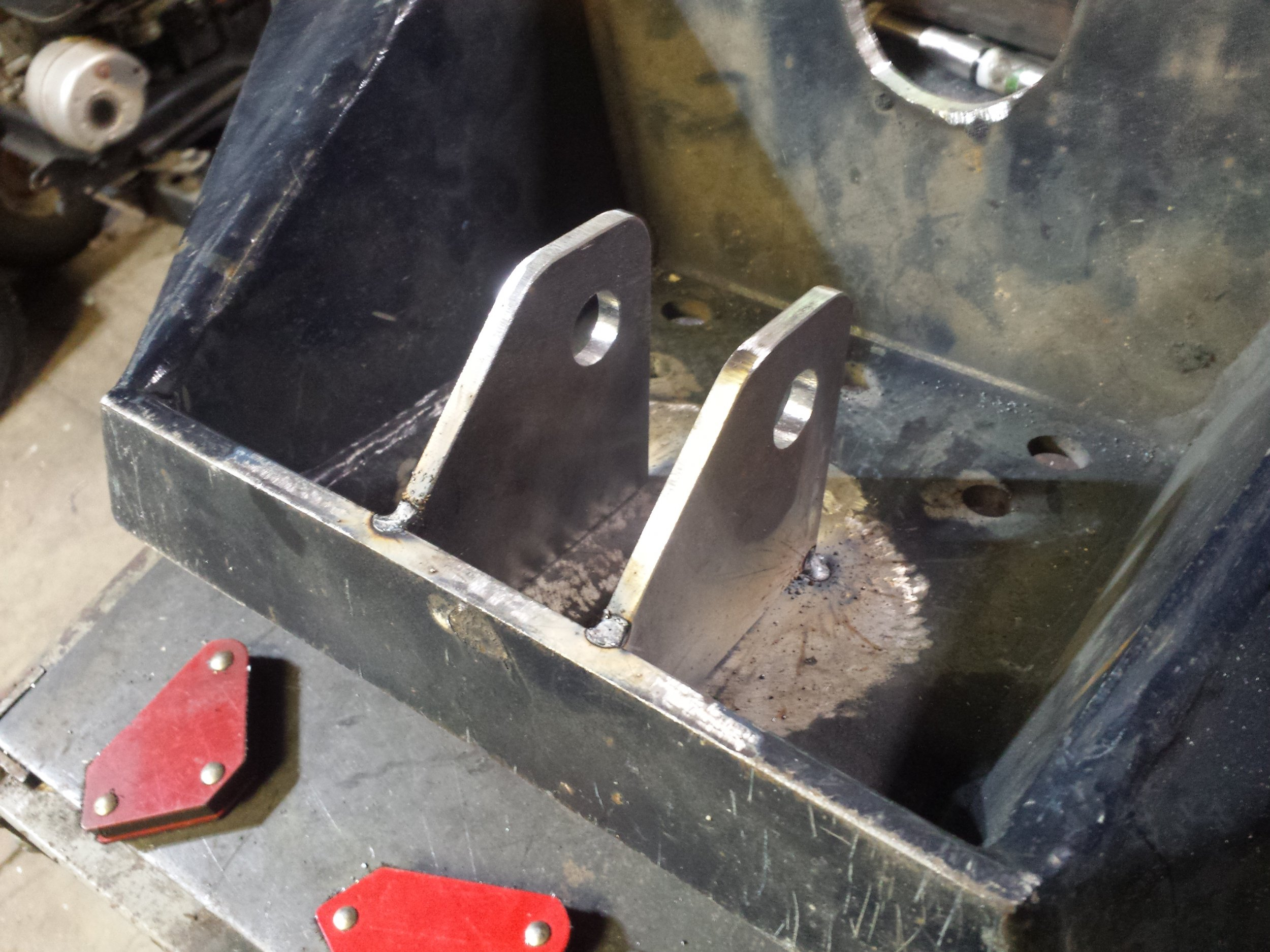

I've been making slow plow progress because I had to divert to reconfigure my leaf collection equipement to prepare for Leaf-ageddon 2021.
I took a few days off work to (hopefully) make some progress.

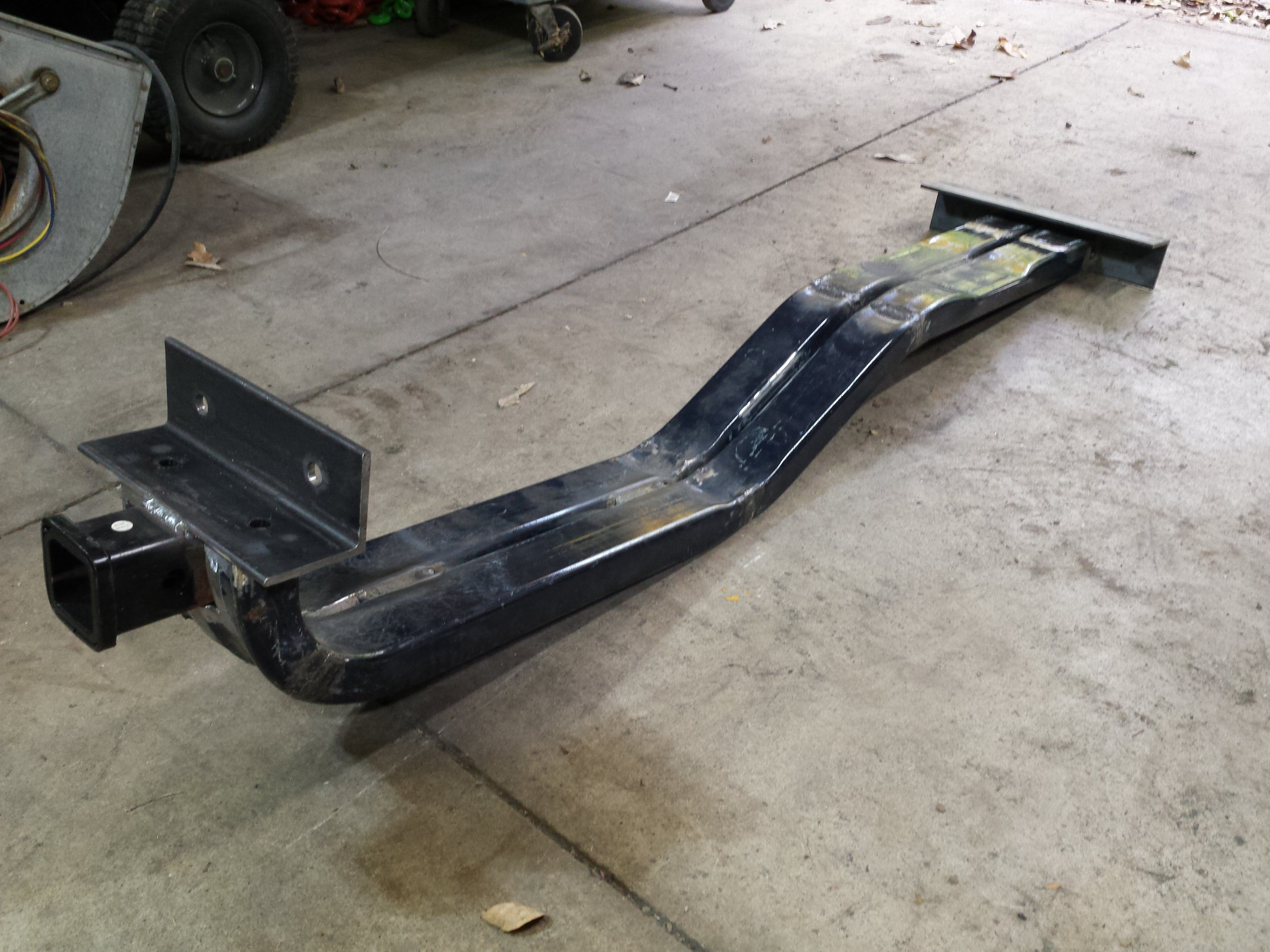

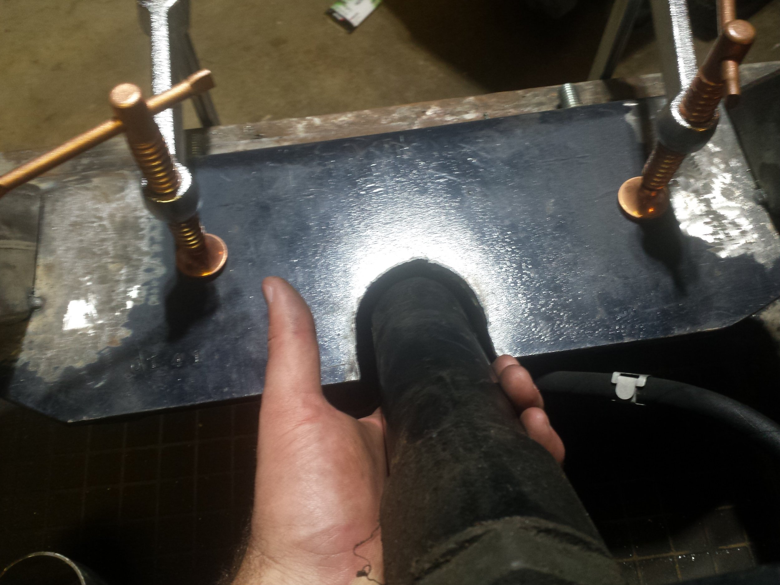

I welded up the main rails of the subframe yesterday. I was able to tack it in place to test clearances. My primary concern was the subframe-to-driveshaft clearance. Nothing hits so far!

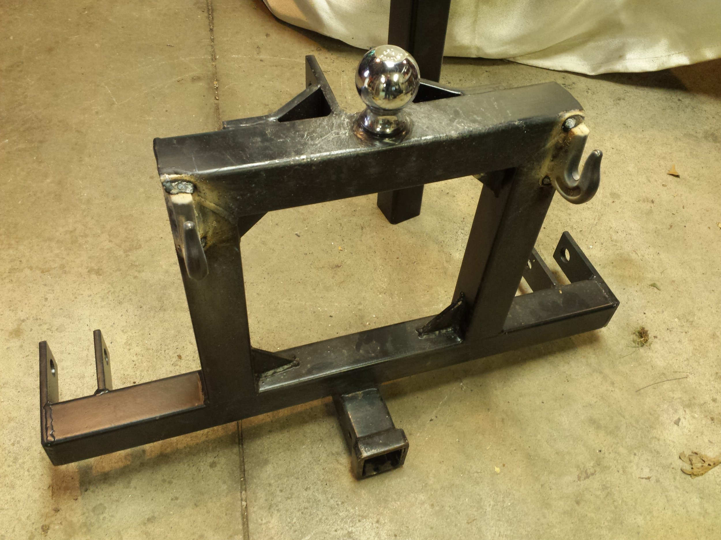

   / Yanmar SA Mods #30

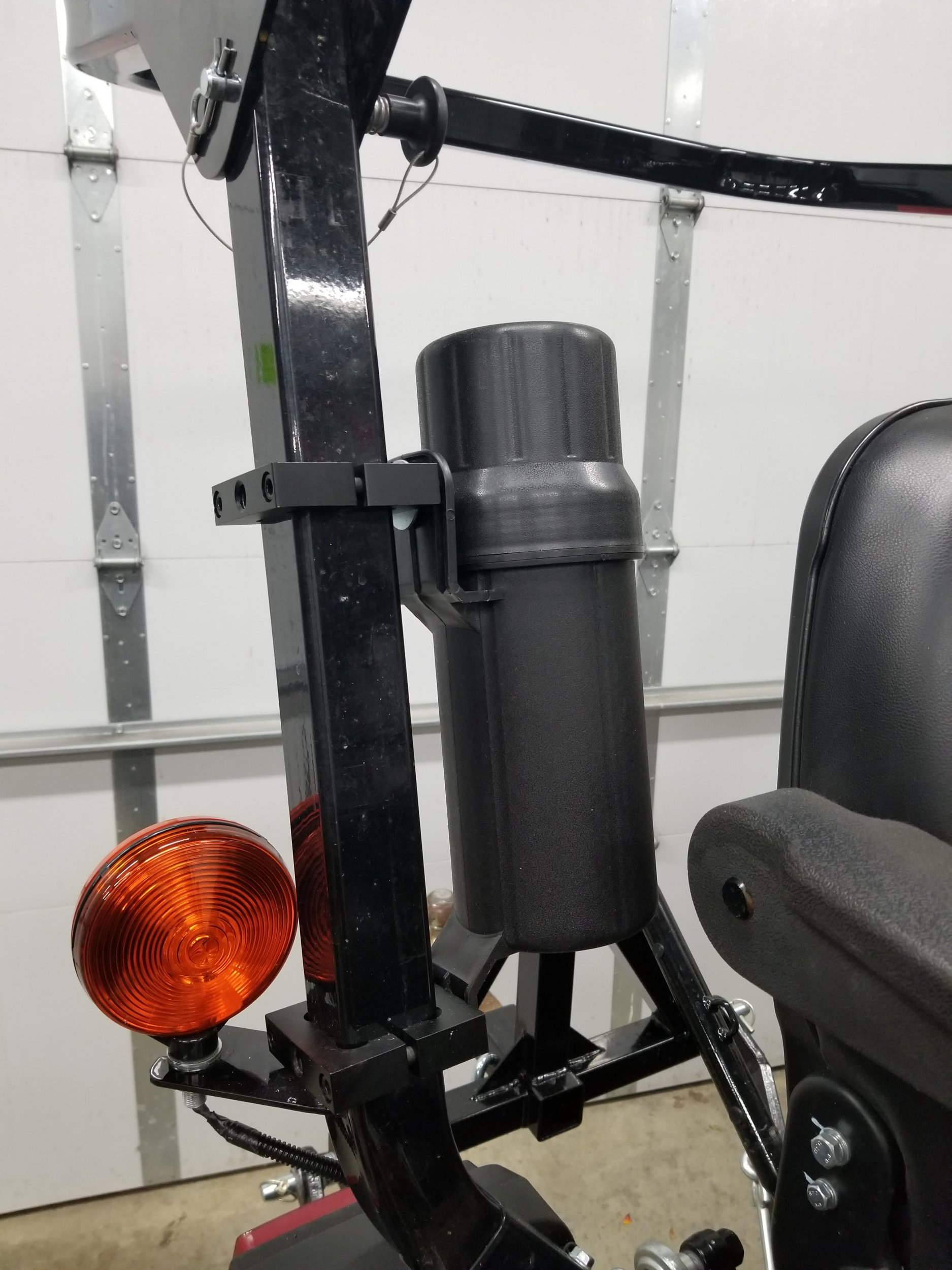

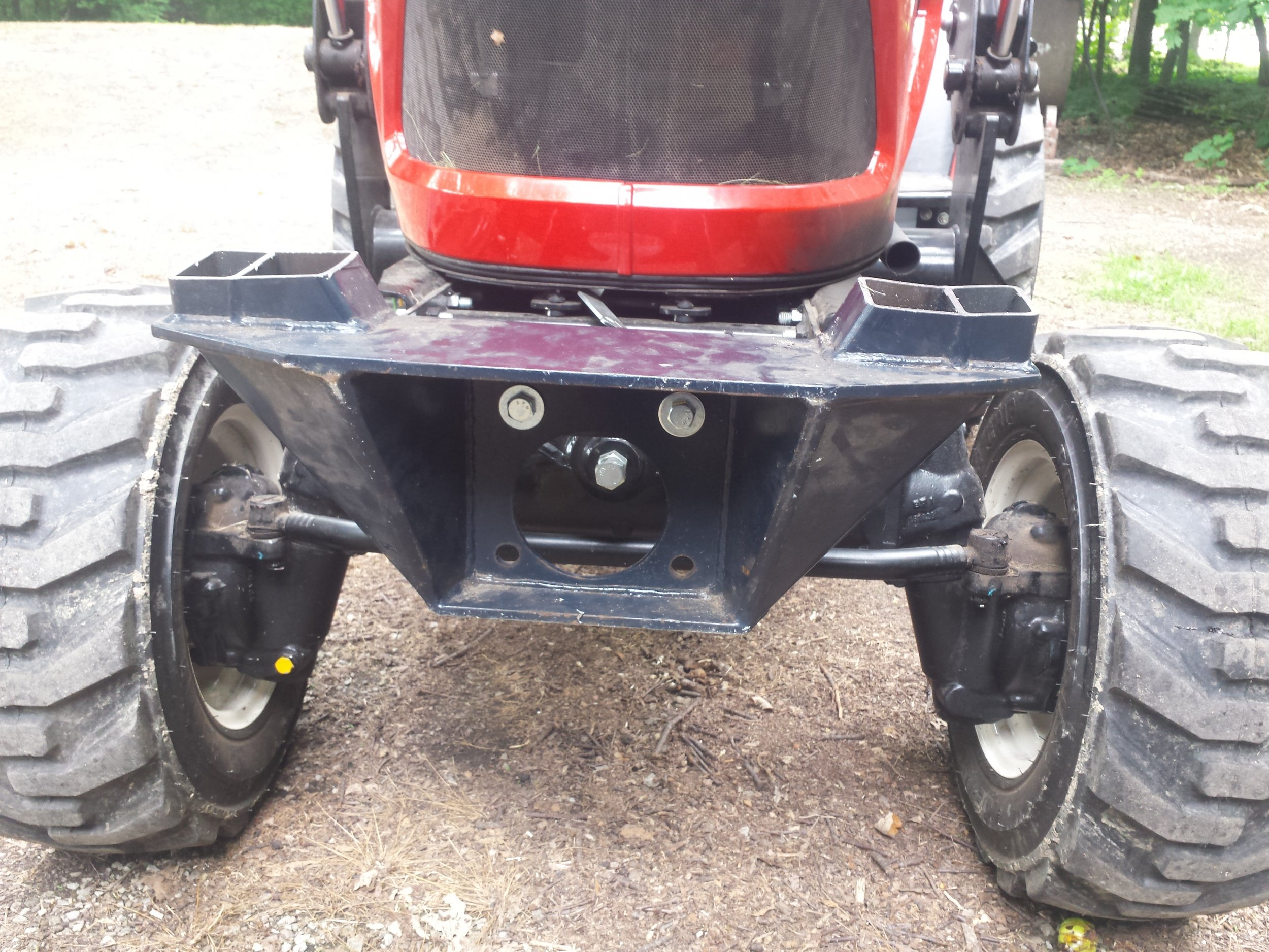

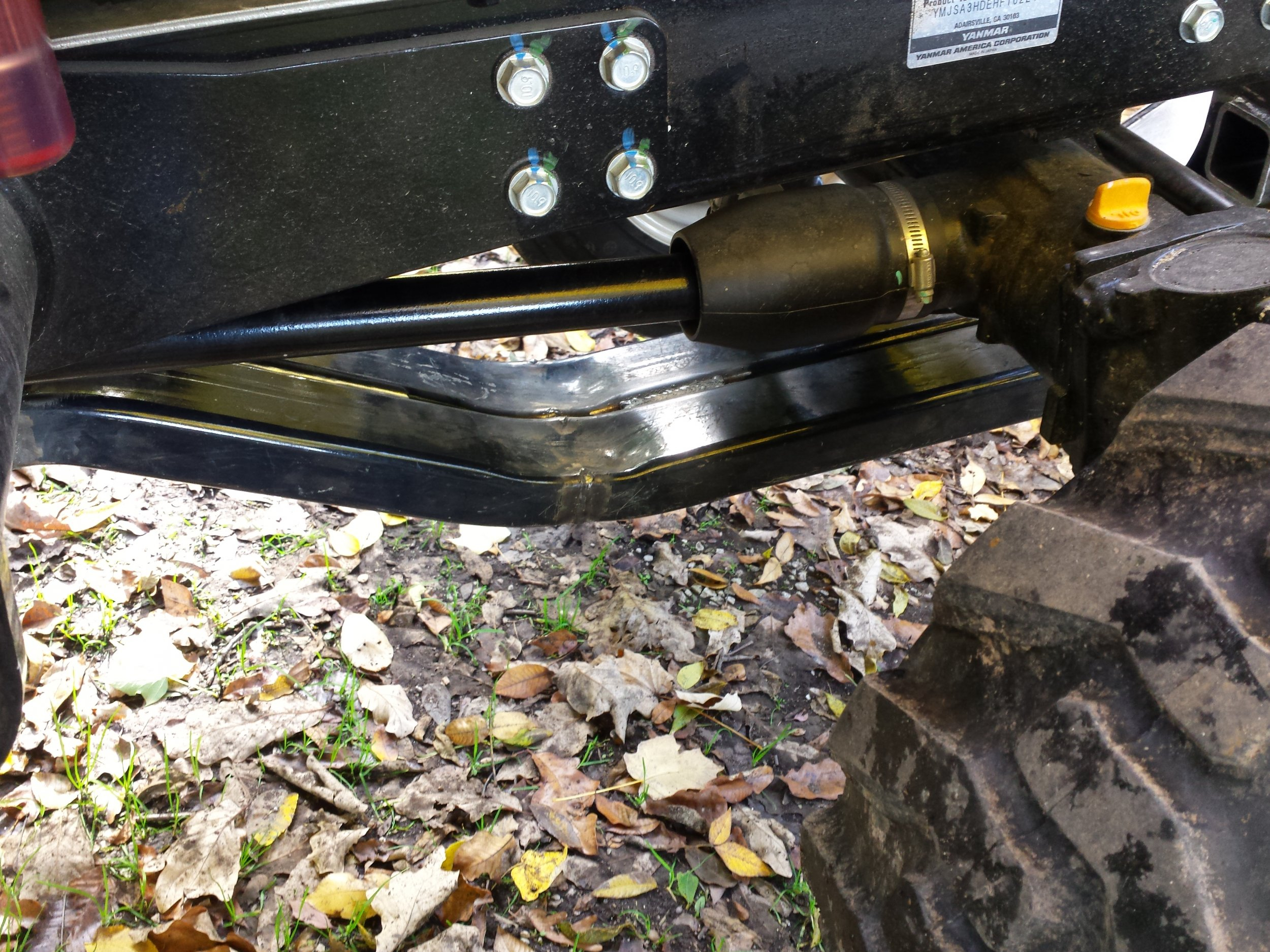

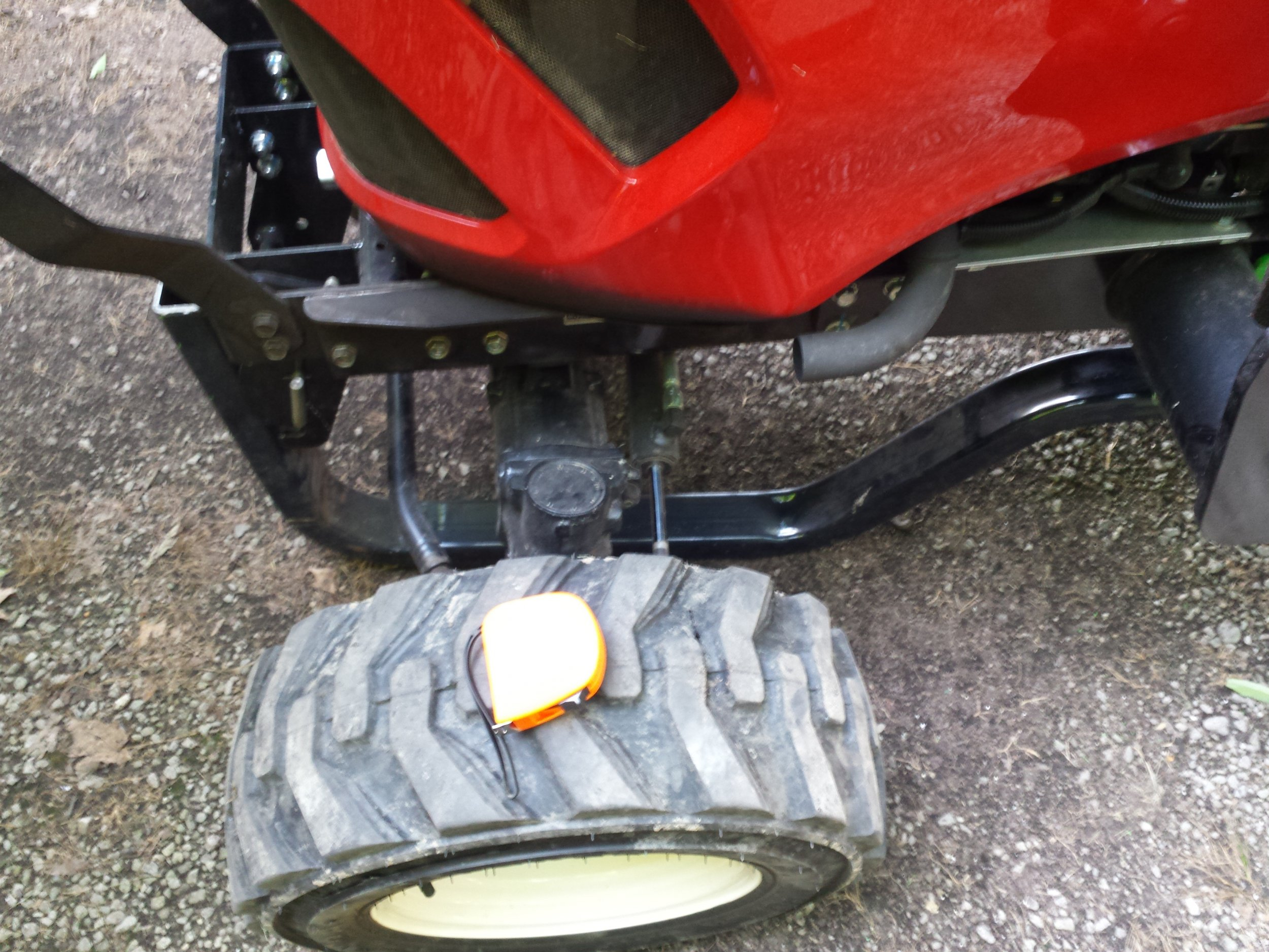

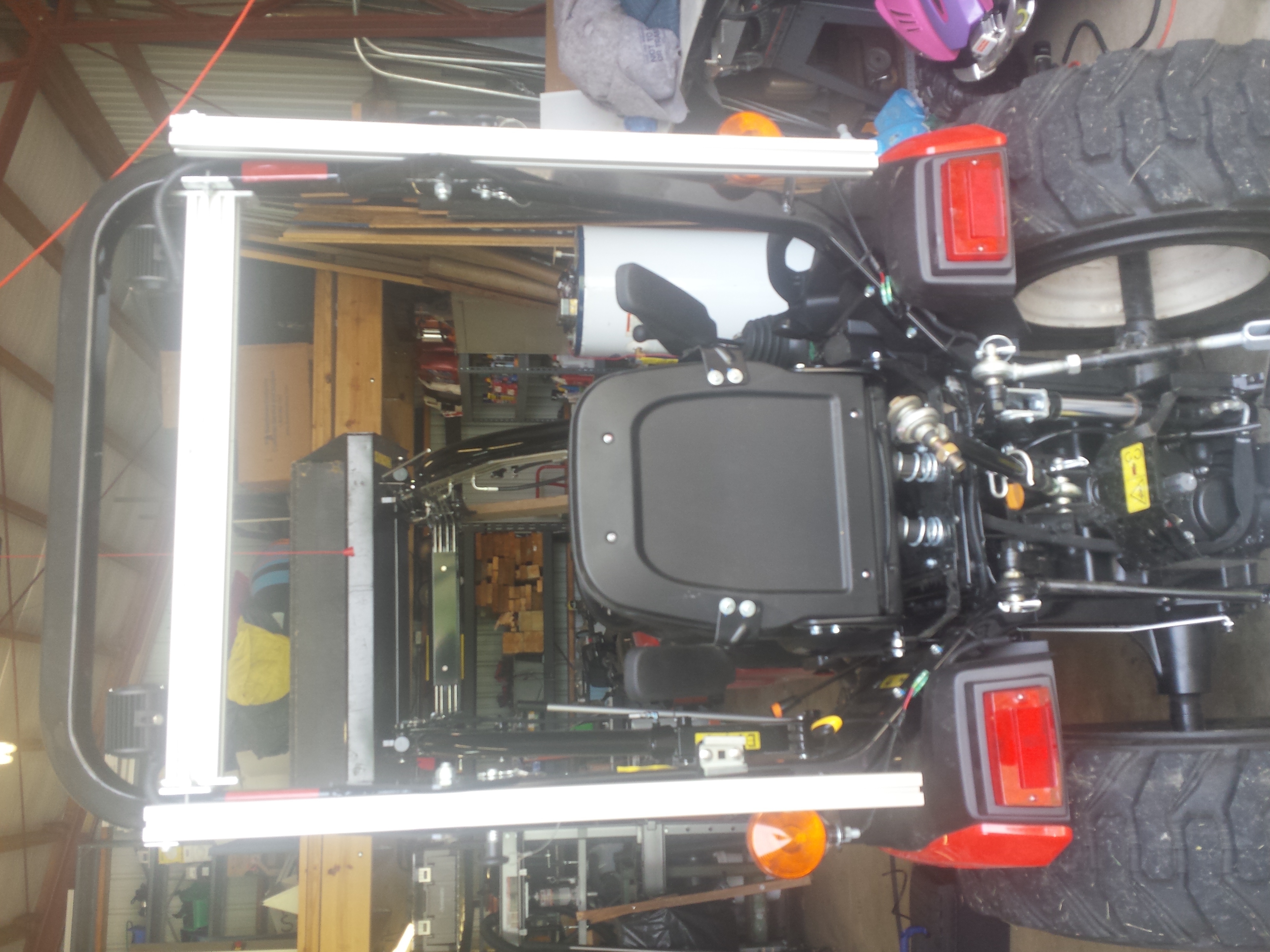

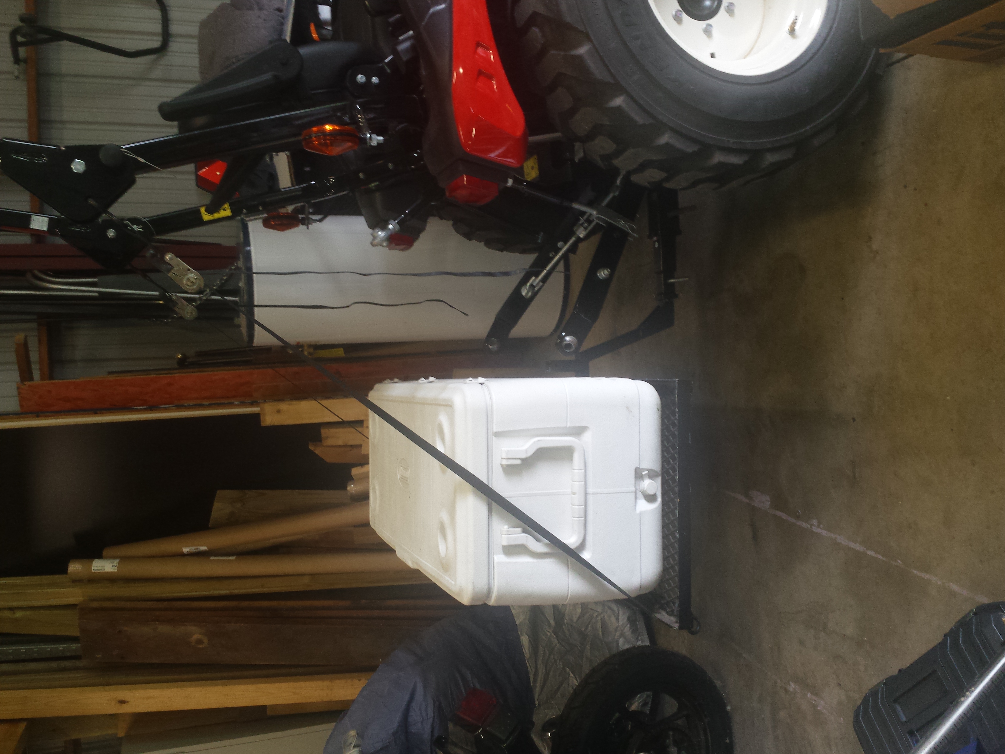

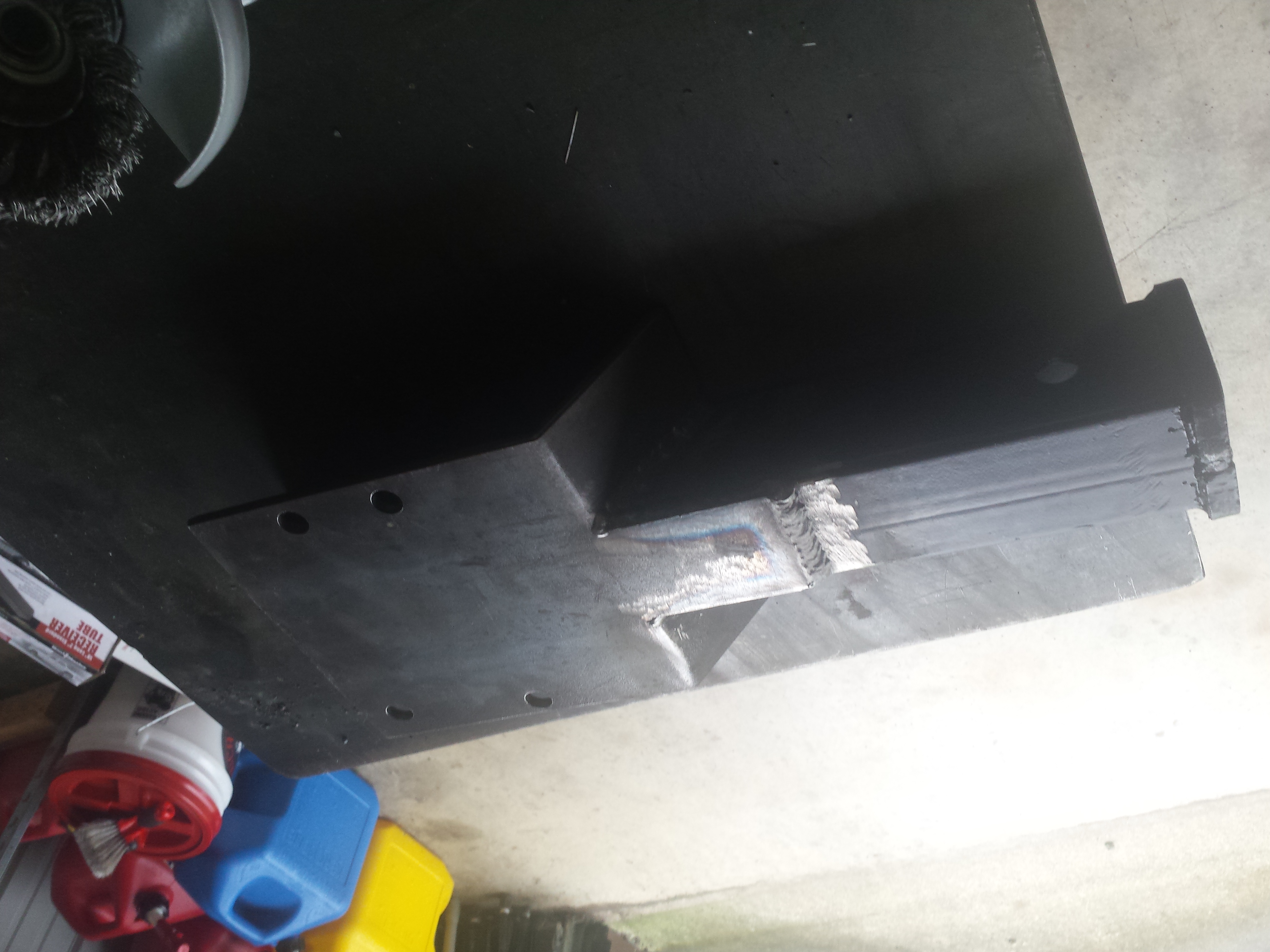

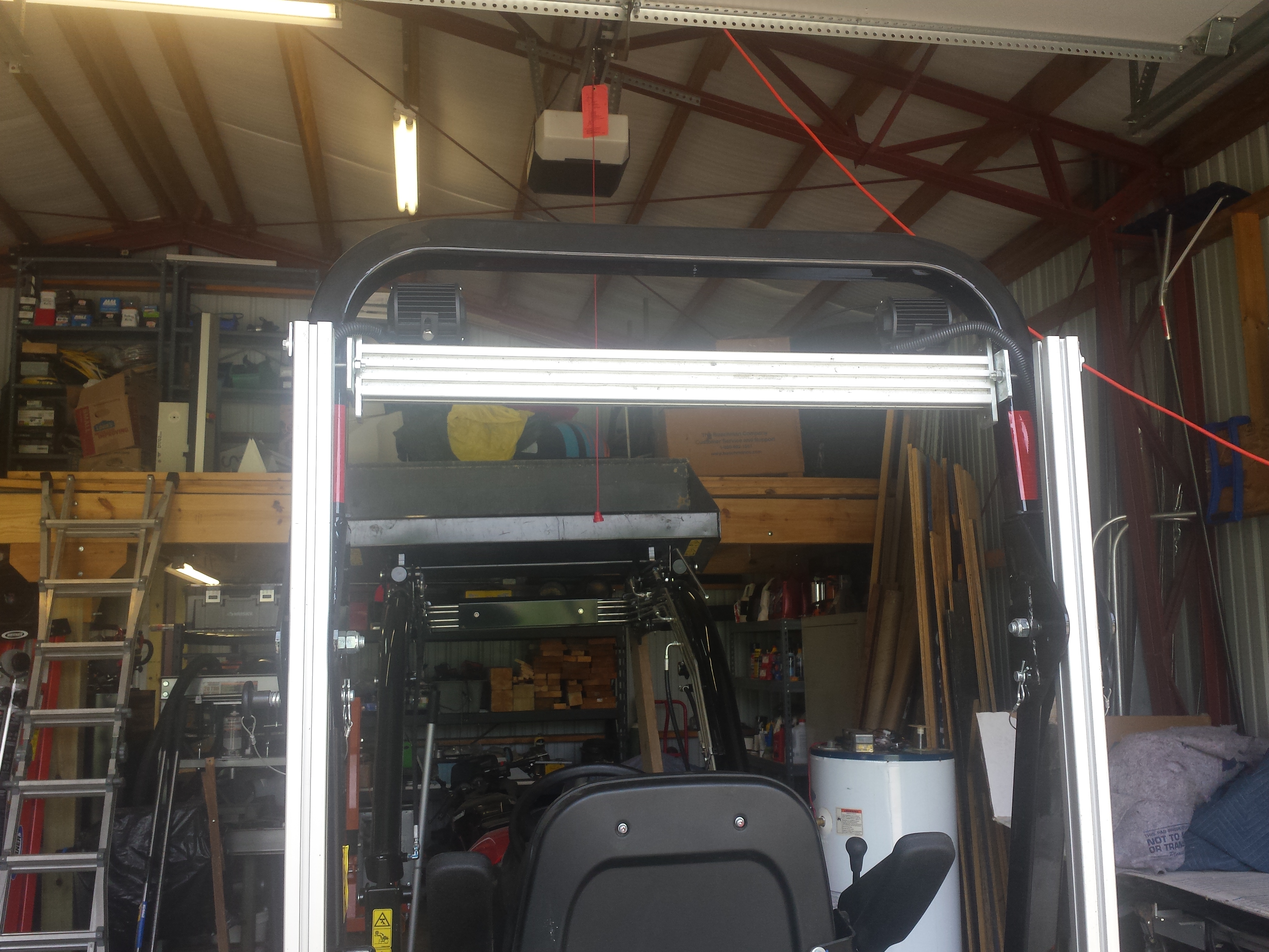

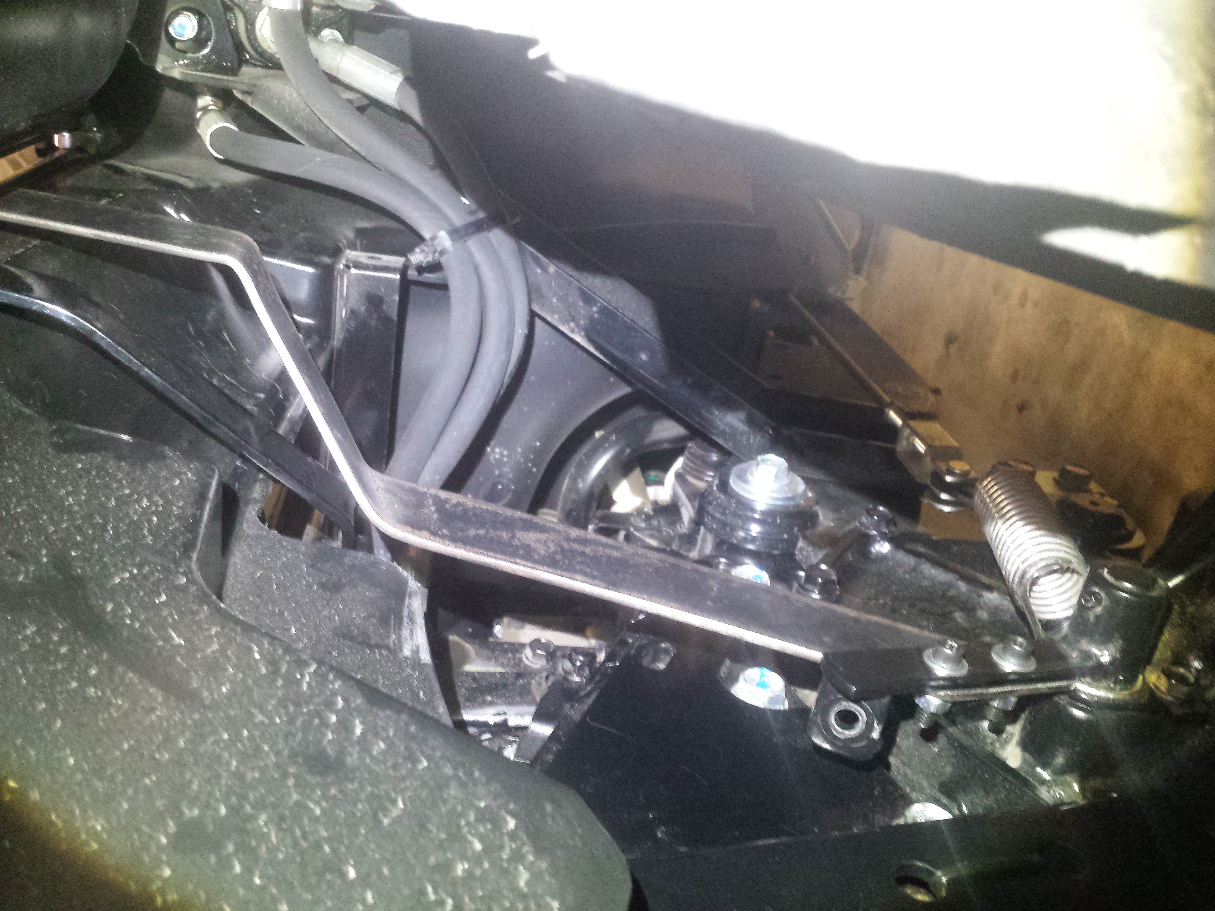

I bought my SA324 back in April and I've been scouring the Internet ever since looking for modifications to make. I wanted to share what I've done so far and I'd like to see what other people have done as well.
View attachment 573119View attachment 573120View attachment 573128

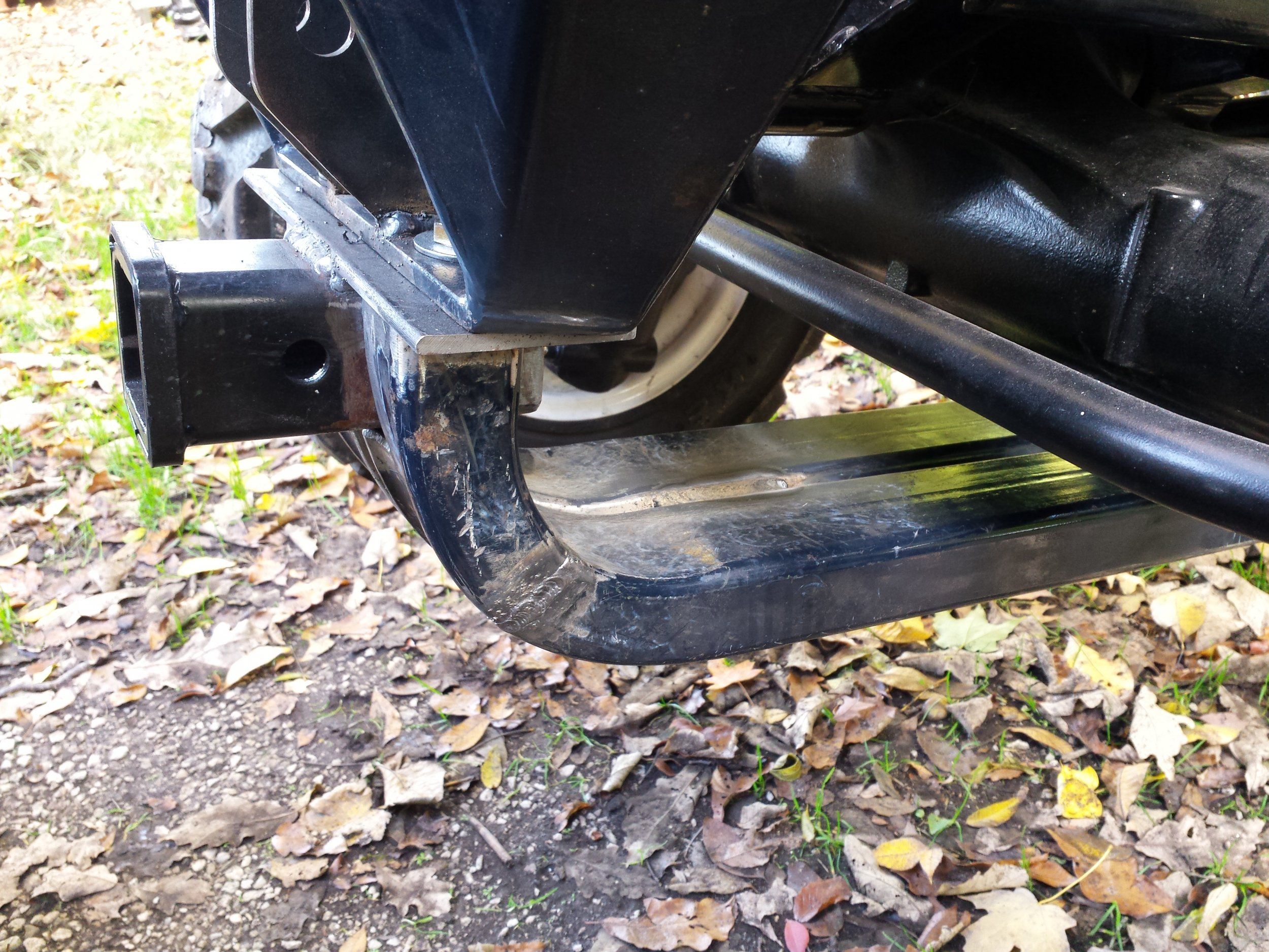

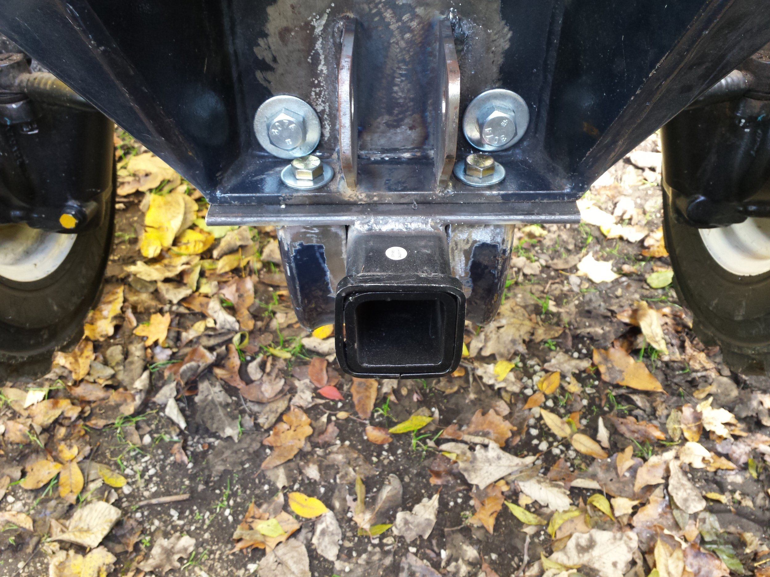

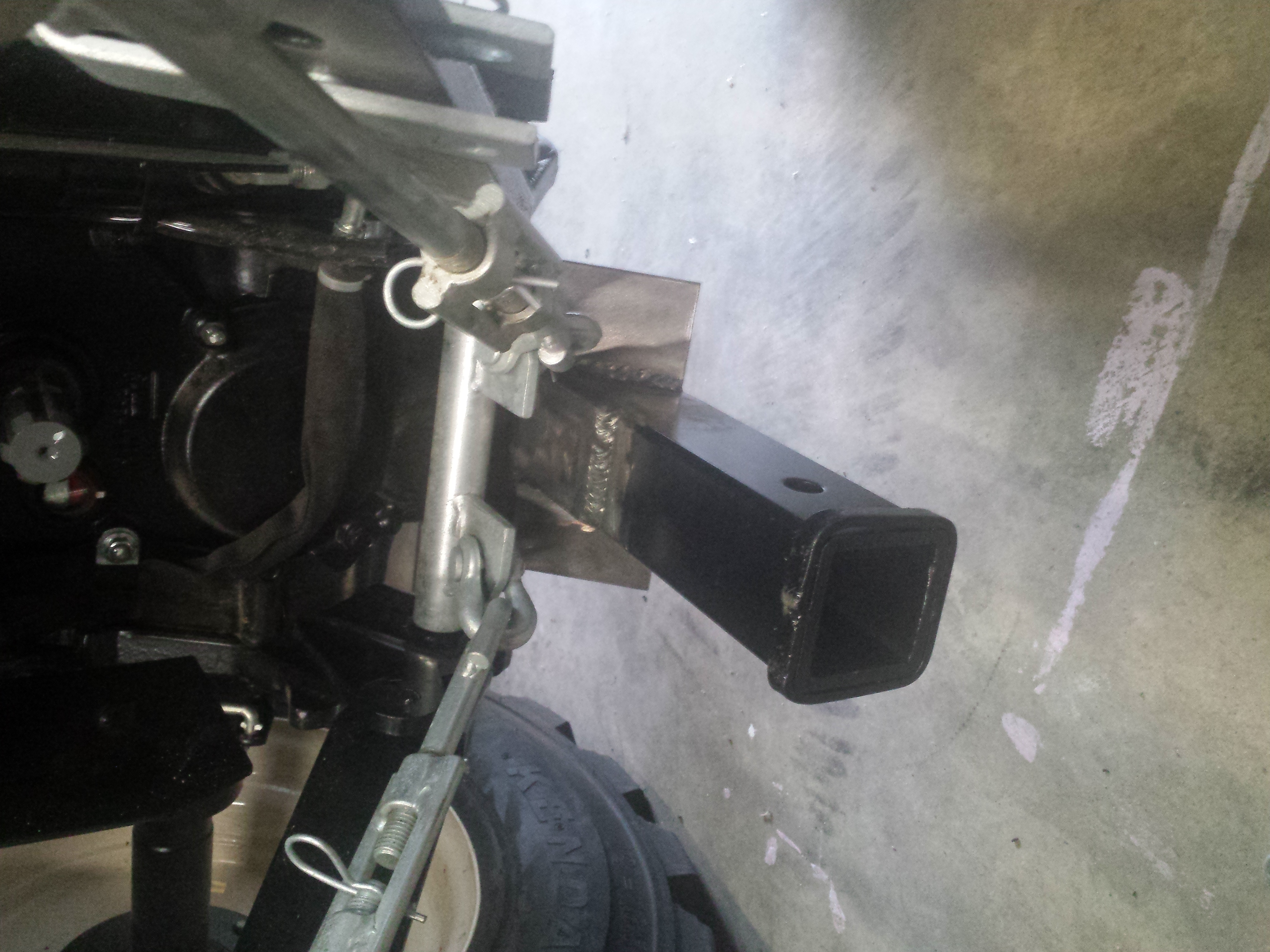

Fabricated 2 Inch receiver in place of original drawbar. Most accessories I already have for my truck fit a 2" receiver so this was far more useful to me. Used a cargo carrier I fabricated for my wife's old car to carry a large cooler. We would fill the cooler full of water for watering plants around the yard.
View attachment 573121View attachment 573122View attachment 573123

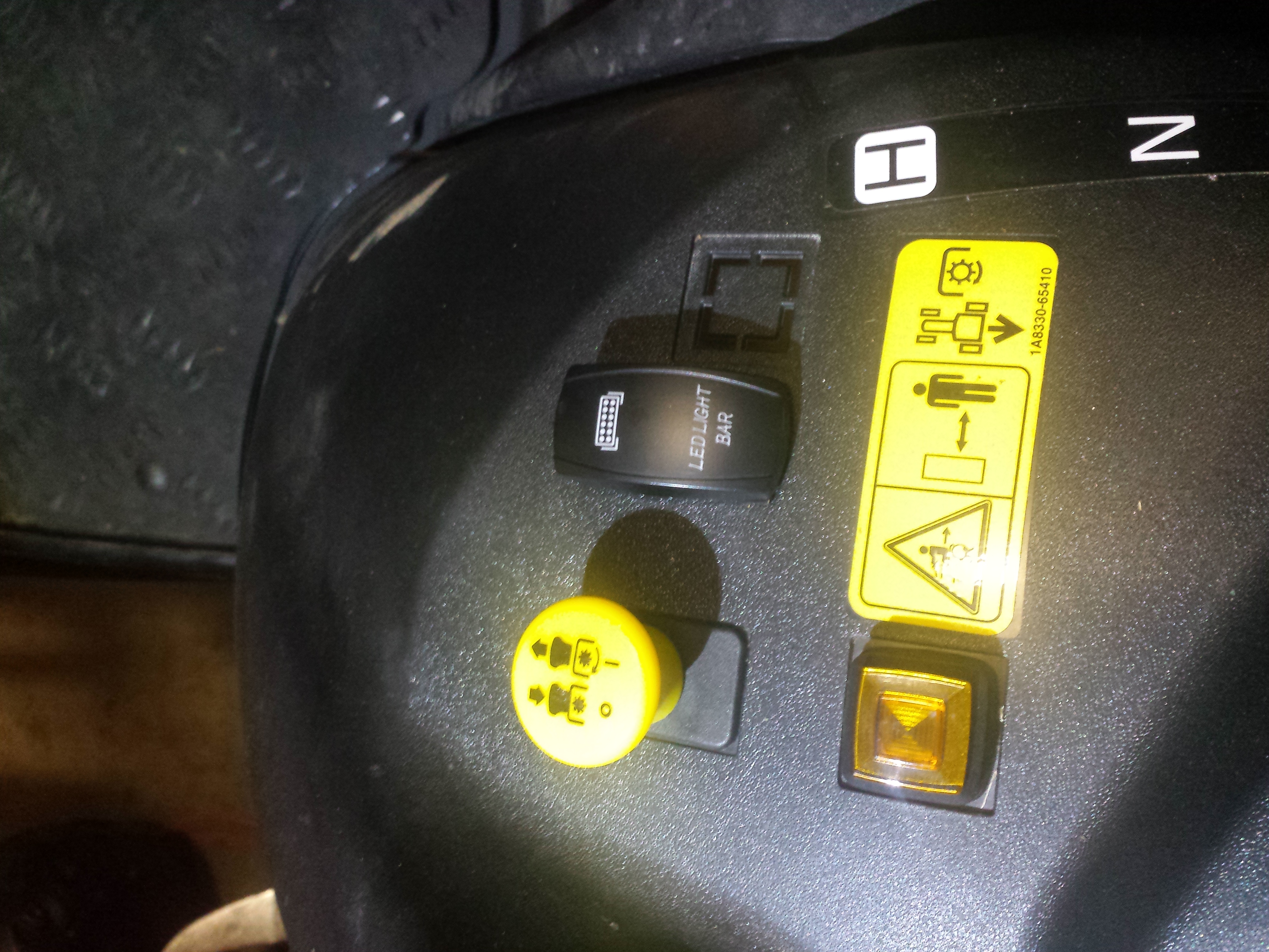

T-slot aluminum for ROPS-mounted lights. T-slot aluminum for versatile mounting for shovels/rakes/gas trimmer, etc. Wiring for lights is fully integrated into the main wiring harness at uses fused accessory circuit. Switch fits perfectly in pre-existing hole.

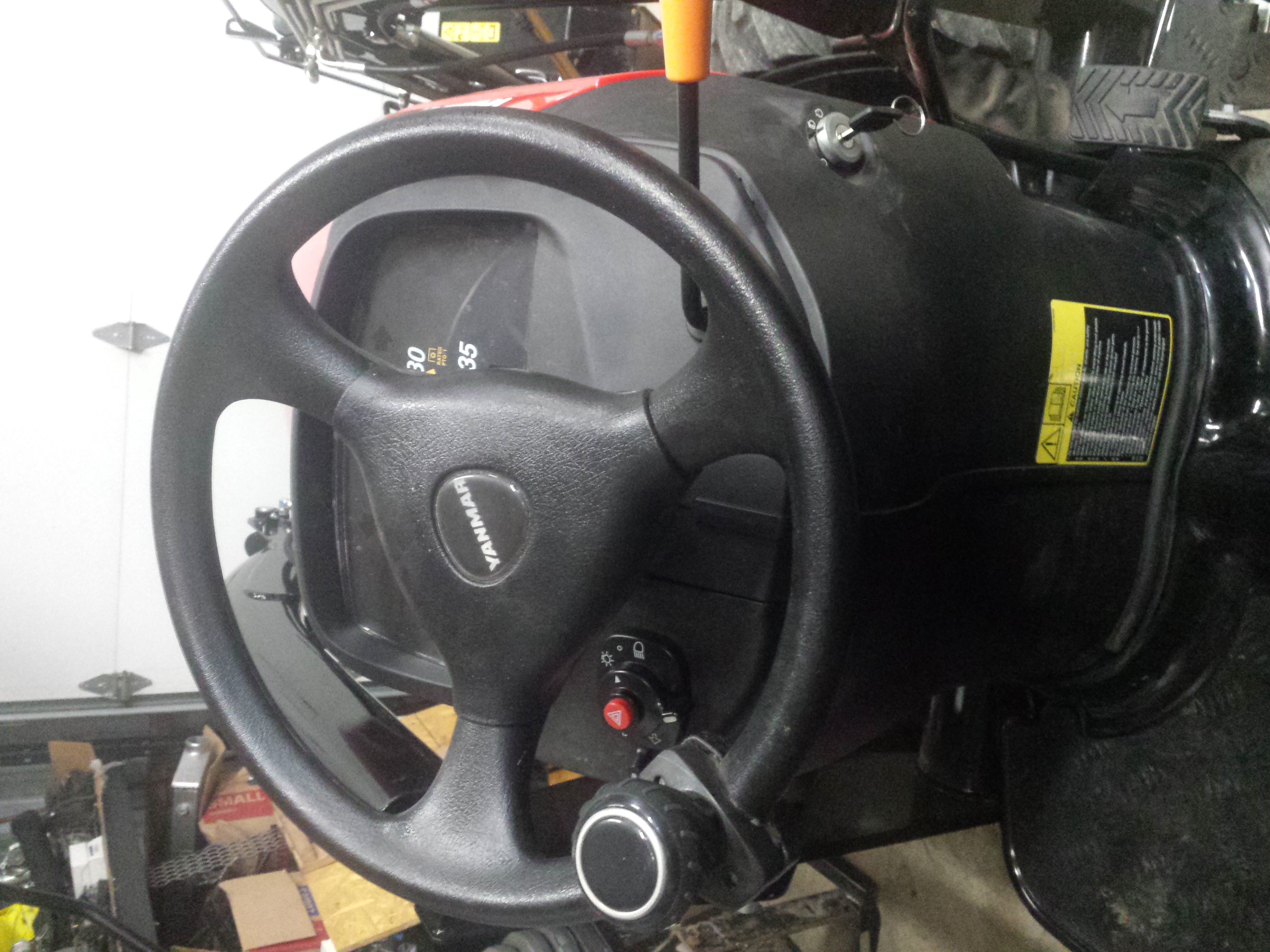

Obligatory steering knob.

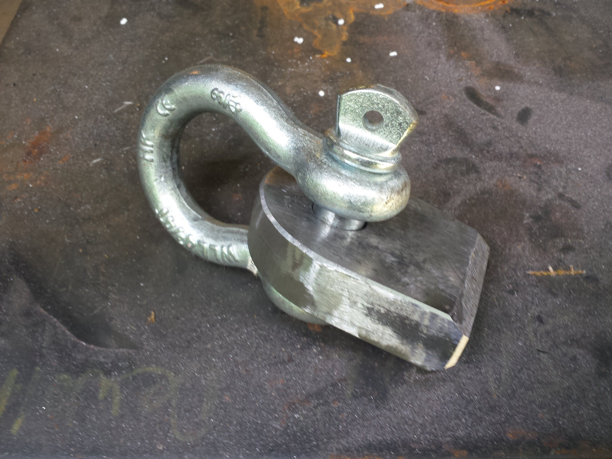

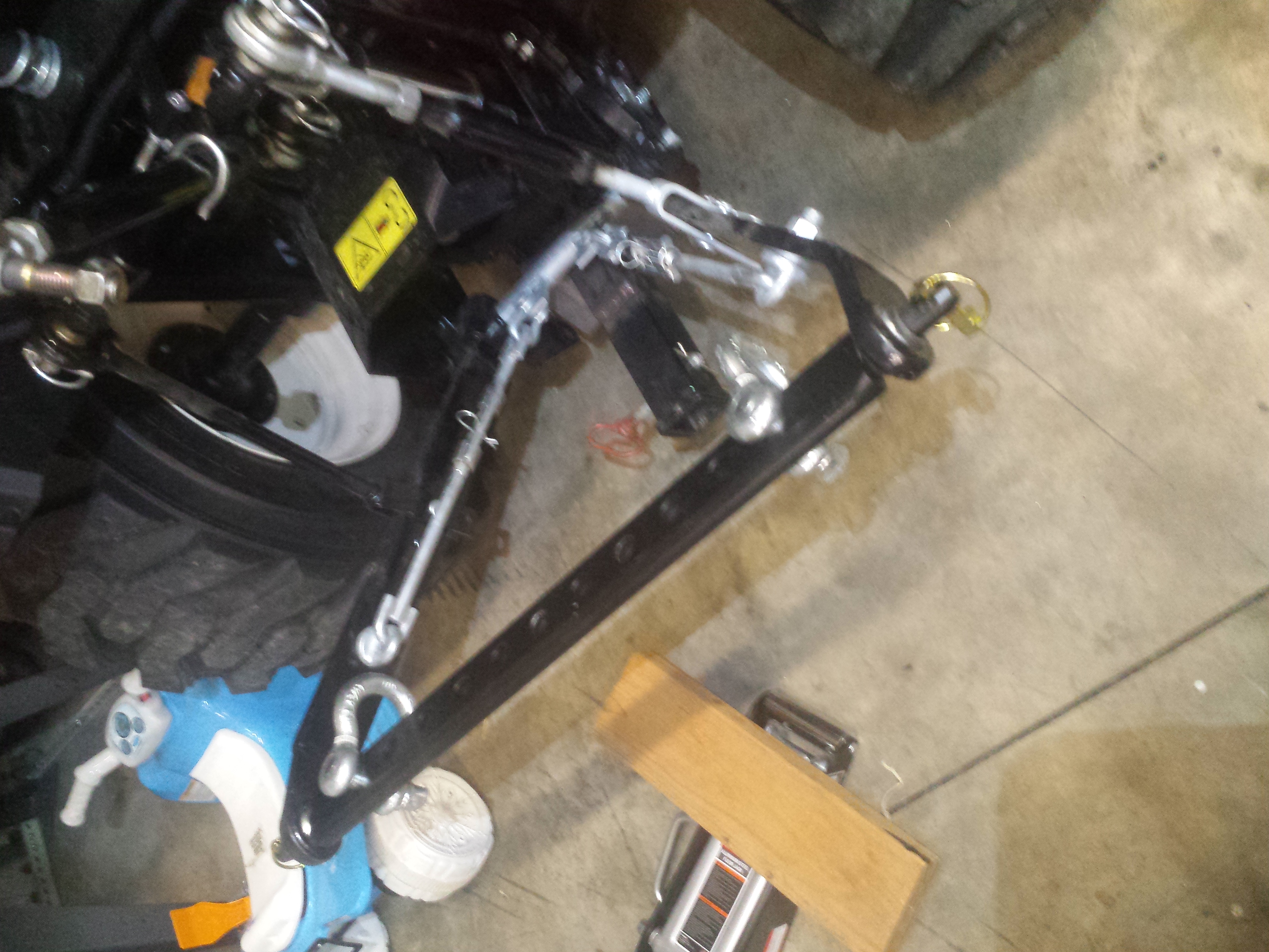

Cross drawbar from TSC. I drilled out the two outer holes to fit some shackles. Seems to work well for general purpose stuff, including pulling small trees with the 3-point.
View attachment 573126View attachment 573127

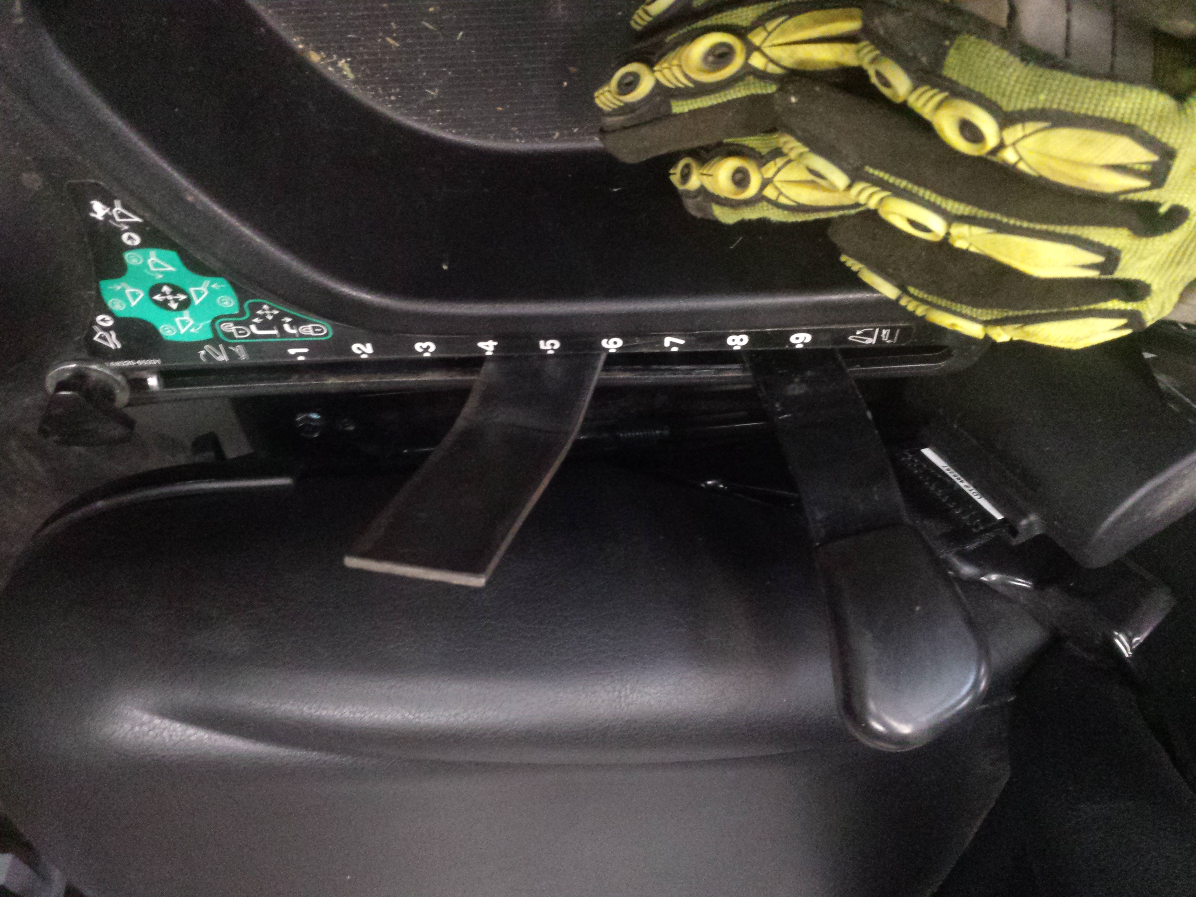

Last, and certainly not least, a lever in place of the brake pedal-actuated differential lock. In my opinion, this (or something like it) is how the tractor should have come equipped originally. The lever gives a MUCH improved positive feedback on whether or not the differential lock is engaged. As an added bonus, the lever will engage the lock if moved forward OR backward. The 3-point sliding lock can also be used to lock the new lever in the locked position if need be. I rebent the 3-point height control lever so the handle grip angles inboard so the two levers do not interfere with one another. The lever is currently unfinished. I will likely 3D print a handle grip similar to what's already on the machine. Since the brake pedal no longer does double-duty, I took all the slack out of the braking mechanism. The brake now operates as you'd hope/expect.

I just bought a SA324. I have a similar cross drawbar that you show above. The problem is that it is 3" too long to fit between 2 bottom links. I want this to lug around my splitter. The drawbar that came with it is very low, for my old back to deal with.
Similar problem on the old box blade I have. The bottom links on the 3pt need to open to 29inchs, which won't happen. So, I'm gonna have to remove 2 big pins to get the box on. Lining up the hole could be a pain, and I don't have a 1 5/16" socket. Is it worth it to look for a quick connect?
So far during the breaking 50 hr period I've not challenged this little tractor at all, but carrying around and using the 450# box might just be that challenge. I'm wondering if I'm going to need weight other than the FEL in the front.

Congratulations on the new tractor! I think you made a solid choice and I sincerely hope it treats you well.
I'm sorry to hear about your drawbar and box blade attachment issues. I'm unsure if a quick connect would help or not considering that your attachments seem like they might be wider than normal. Maybe you could make a dedicated post for that question?
Starting from square 1, are you sure the lower links on the tractor are as wide as they'll go when attaching? There are turnbuckles (likely silver in color) on the inside of each lower link that need to be unpinned and adjusted outward to clear the attachment's pins. After the pins are set and the lynch pins are inserted through the attachment pins, tighten the turnbuckles and insert their hairpin cotters again. It can definitely be a pain to wrestle everything into place on a box blade.
If that isn't the problem, could the pins on the box blade be flipped, for example, inward instead of outward? I believe my box blade's design would allow for the pins to be flipped, but I'm unsure if that is ever something that needs to be done in practice (maybe whne connecting a category 1 implement to a category 0 tractor?).
I've had zero issue lugging around and using my 60" box blade, even with the 5 scarifiers most of the way down. A 60" blade is probably about as big as I'd go with this size/weight tractor, though.
When using the box blade, make sure you have the top link is adjusted such that the box blade isn't pitched digging in too much. You'll also need to be aware how to use the 4x4 and, possibly, the differential lock.

Thanks W. Your suggestions helped. I was in the process of flipping the pins on the box, but they were frozen solid, to the point that I was thinking about cutting them off. But it turned out the problem was not the box blade pins. The problem was operator malfunction. The lower 3 point links were extremely stiff almost frozen in place. Applied some penetrating oil and a couple of good kicks and they opened up just fine. Duh! Do I feel stupid. (you don't have to agree).
So, the box blade is installed and leveled and as soon as things dry up a little I'll be out on the driveway with it. Also, it's is a nice 400# ballast. So, for the time being the quick connect is on back burner.

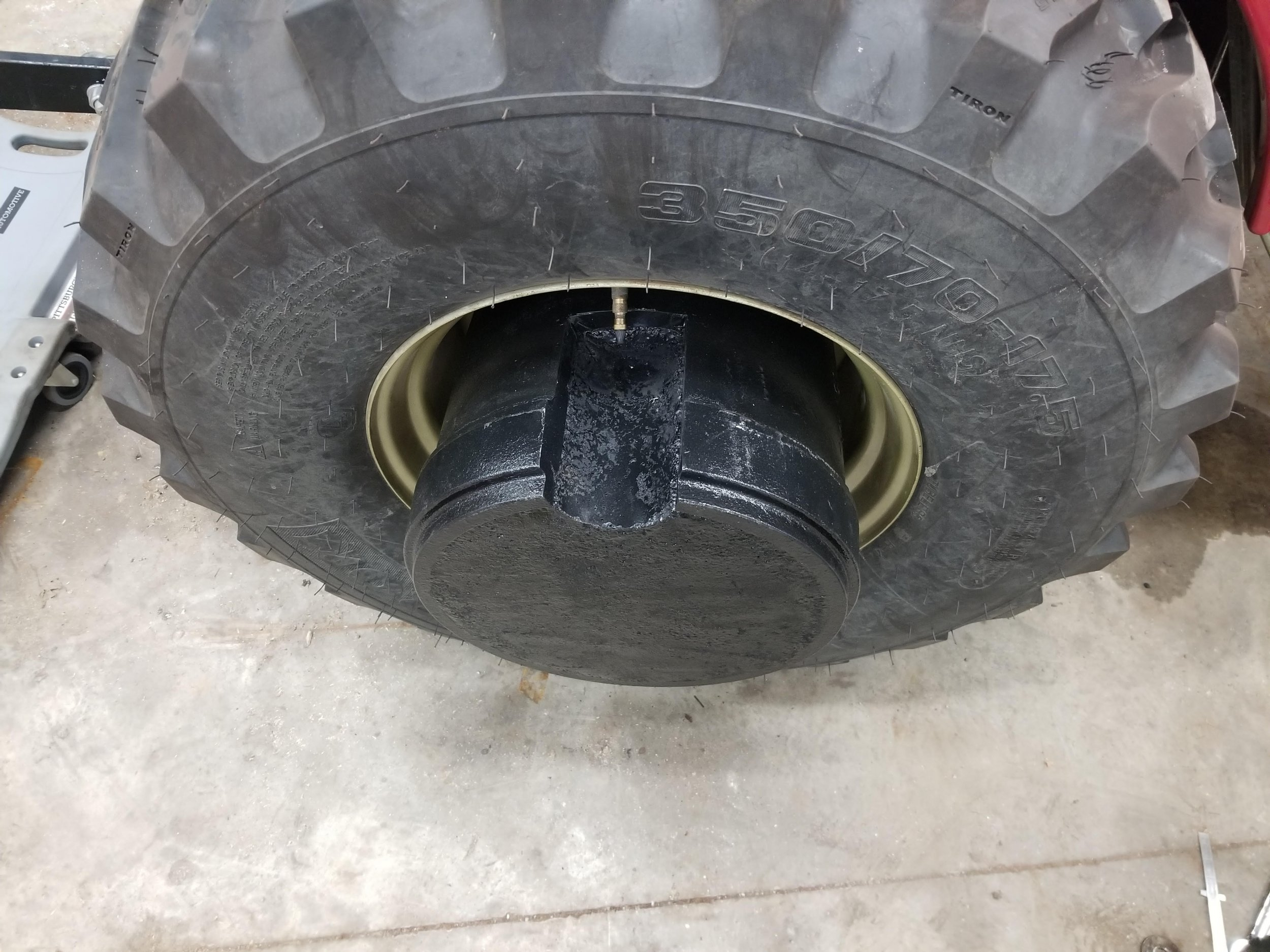

I had my rear tires filled by the dealer prior to delivery. It was less than $100 and seemed quite cost effective.
The caveat of the liquid ballast is that it does not add the 551 pounds of ballast the owner's manual states is needed. Wheel weights could be added to offset the difference, but there is no Yanmar wheel weight kit for the SA324 (only the SA424). I've considered casting removable concrete wheel weights using the wheels themselves as a form.
