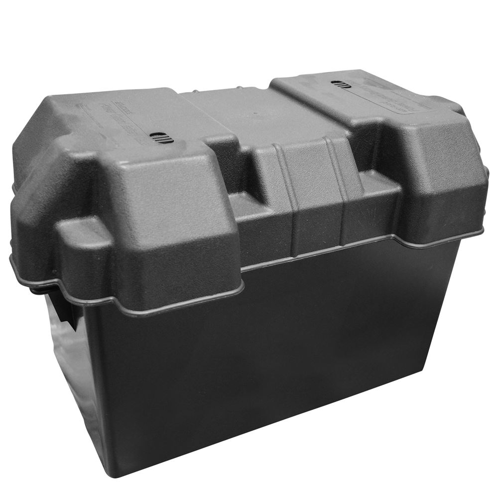

I really like your idea of some sort of modular ballast (old, sand-filled lead-acid batteries).
Use battery boxes instead of hacking into the batteries and having a mess. Plus, the covers snap on really well. You could also fill them with concrete too.
I've picked up 5 in the past year on close outs for a mere $5 each. These are Group-27 size too.

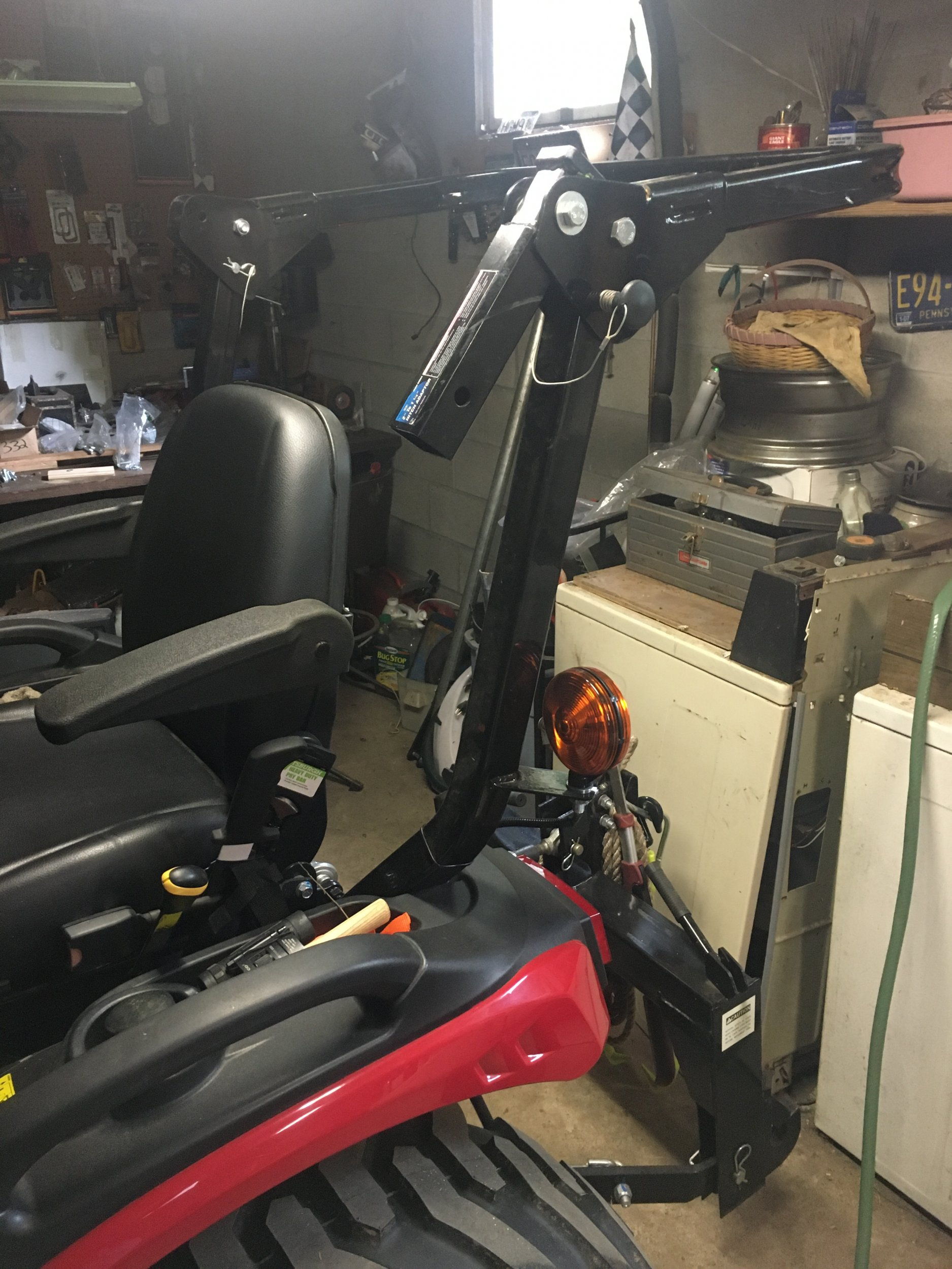

Well this thread seems to have died out but Ill give it a try... Just got a 324 and looking for Ideas for a grab handle to get off the tractor Im either pushing myself up with the arm rest or pulling myself up with the steering wheel... anyone make something up yet?

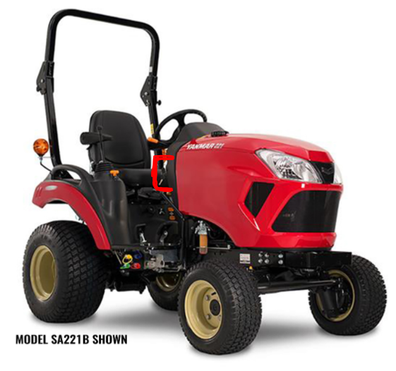

A ROPS grab handle is typical on SCUT and zeroturn mowers.
The Polaris has this one.
Now, I don't at all drill holes in ROPS because if the tractor is ever sold, there is liability risk as it's a federal law.
BUT, you can use ROPS brackets to mount the handle. :)
On the older YM, F, FX, KE, RS Yanmars, we have fender handles to grab and hop into the seat.
Oh my, the SA221 has a very low grab handle if you want to call it one.
What about mounting something to the side below the dash? Is there structure for a grab handle there?

I feel that entry/exit on the SA324/424 isn't particularly great. I tend to use the fender-mounted grab handle and the loader upright together for entry/exit. I also sometimes use the steering wheel (which I feel uncomfortable doing).

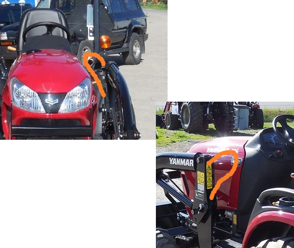

@Wheelz: If your SA324 has a loader, I might recommend something similar to what @bmaverick proposed, but attached to the loader support arm(s) instead. I don't recall there being any pre-drilled hole in the uprights, though.
What I think might work well is a handle that attaches to the back side of the loader upright that curves in toward the hood/dash area so as not to obstruct entry/exit, but would provide a better alternative to grabbing the steering wheel. I shamelessly snagged some images from the Internet and modified them to illustrate what I'm thinking.

You could slide a mount w/ a ball in there and have even a better "grab ball". Might actually work well !
