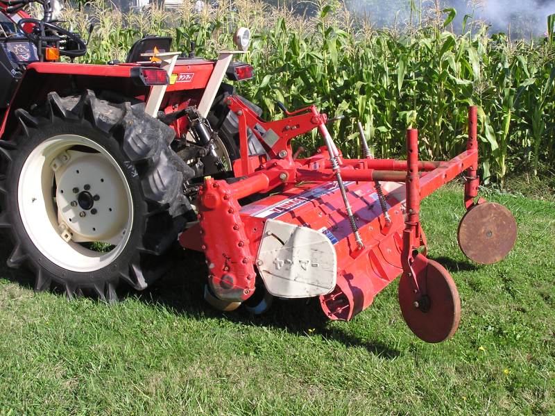

Hi, I'm not sure how much help I can be. I have a Yanmar RS1202 tiller that sounds a little different than yours. See the attached photos. The hinged steel section is one piece, not a separate center section. My tiller is complete except for the springs/rods that attach to the hinged flap and keep it down during tilling, and I guess help compact the soil a little. Mine seems to work fine without tho. You might try asking about this tiller on the Yanmar tractor forum below.

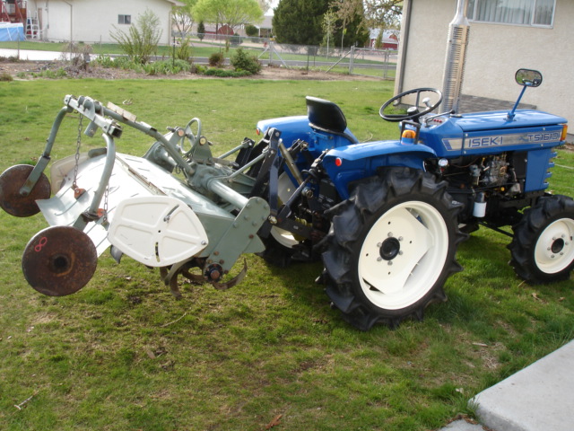

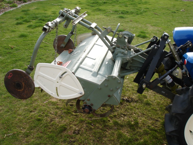

Here are a couple pics of my tiller before I added the auto controls. There is a release lever near the top link that frees the guage wheels from the tiller and they just float. If you model has this feature you should be able to release the wheels and be able to get on to the treailer. The other thing is where the wheels and their mount attached to the tiller I just use pins so I can remove or install the wheels very quickly.
The release lever shows up nicely in the second pic.
