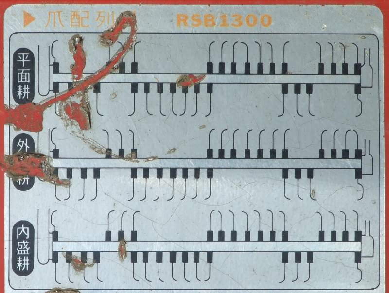

Something just occurred to me.
The tillers have a decal showing various ways to arrange the tines. One tine angled left then the next angled right, etc.
Since the description for each arrangement is in Kanji (Japanese text), I don't think anyone here has deciphered the decals.
I wonder if one of the alternate tine arrangements is to make that ridge.
/ Yanmar tiller question. #9
Looking at the tine decal, I suspect the lower arrangement would be what you want for moving the dirt towards the center.
I've not done this but my model has the removable center section for making hills.

My tines are not set up any special way - one side is right and one side is left facing. I think what is important is the removable board. The side flaps keep the dirt in and it has no where to go but out the opening in the back.

I have a model 1202. Looking at the picture of the decal, the bottom diagram is correct to throw dirt in. The center one will throw dirt out, and the top diagram will till flat. I have been tilling my garden like this for about 3 or 4 years. This is a rice paddy tiller and is designed to do this. Very easy to set up. Just install all the tine tips pointing toward the center, they throw dirt in. Install all except the outer 2 pointing away from center, they throw dirt outward. The random pattern tills flat. Adjust your flap to flatten the top to the desired heigth. No pictures now my garden won't be tillable for a couple of weeks. I am supprised that someone else is not taking advantage of this adjustment of tine location.
