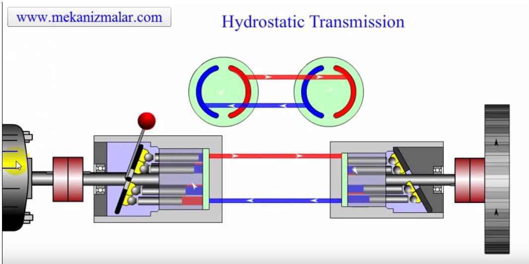

Let's start with a bit about a standard hydrostatic transmission. Take a look at this diagram taken from Mekanizmalar's video on YouTube. This shows a single wheel load and an electric motor, but it illustrates the concept well. You might want to open this and the second picture in separate windows to refer to while reading.
This transmission uses an axial piston pump, to the left side with the red handle on its swash plate and an axial piston motor to the right with a fixed plate, powering the wheel to the far right. The connection between the two is purely hydraulic. Instead of an electric motor shown to the far left, the power source would be the compact tractor's diesel engine. This would power the axial piston pump, which sends pressurized fluid along the red line to the axial piston motor, powering the load.
With the swash plate tilted as shown and when the diesel engine turns the pump, each of the pistons rotates around the central shaft, compressing and elongating (due to the swash-plate angle), drawing in fluid from the return side (blue) and pumping it out on the high-pressure side (red). The more the swash-plate is tilted using the red ball handle, the faster the pump moves fluid and the faster the wheel turns. The swash-plate gives infinite speed adjustability. If the swash-plate is tilted perfectly vertically, no compression or elongation happens and no pumping occurs. Also, the tractor can't move, as the hydraulic motor is hydrostatically locked. If the swash plate is tilted in the opposite direction, the pump pumps backwards and drives the wheel in reverse.
The highest efficiency of a standard hydrostatic drive is when it is pumping very little fluid, as low hydraulic flow-rates produce low friction energy loss. This corresponds to the tractor moving, but at a virtual stand-still. The faster you go, the more the transmission pumps. Pumping fluid generates heat, wasted heat, which only makes things worse because you have to get rid of that heat. It also lessens the life of the fluid. Ideally, you want to pump as little as possible.
Now suppose we could get the zero-pumping state of the transmission to correspond with some non-zero speed? If we set this speed at the typical working speed of the tractor for each gear, then when working at this speed we have optimal efficiency (no pumping). This appears to be what Yanmar aimed for with the IHMT. Also, when working slightly away from this optimal speed, we still would minimize the amount of pumping, because only the amount of pumping needed to create the speed offset would be required.

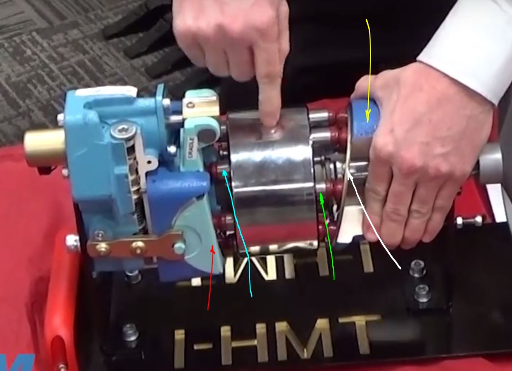

With the workings of a normal HST transmission in mind, it will be easier to explain how the IHMT works. Here is a screenshot from the IHMT YouTube video; Daniel is the guy's name. This is the actual unit used in the YT359/YT347.
We can first make correspondences to similar pieces of the normal hydrostatic transmission. The hydraulic motor output of the transmission, connected to the wheels would be where Daniel's left hand is (our right, yellow arrow). There's a lighter blue flange hidden by his hand you can see elsewhere in the video that looks like it bolts to a gear. That gear would be connected to the wheels through the three-speed range gearbox. The white arrow shows the fixed plate of the motor side. This is a complement to the light blue pump side variable swash plate that is shown by the red arrow to the left. The silver round body he is pointing to is connected directly to the diesel motor output. It actually houses the pistons for both the pump side (light blue arrow) and the motor side (light green arrow). The pump and one side of the motor always spin together at the same rate as the diesel motor.
Now suppose you set the swash plate to vertical. No fluid would be pumped, so the motor and pump would be hydrostatically locked together, just like in the case with the standard hydrostatic transmission at zero speed. However, here the tractor is moving, as the output is spinning exactly at the motor's speed. With no pumping, the efficiency should be essentially the same as a gear tractor. Changing the swash plate angle from vertical in either direction will start the pump pumping to either add or subtract from the ideal "no-pumping" speed. I assume that Yanmar designed the system so that this no-pumping speed is in the middle of the speed range for that gear, but I'm not sure if there is a good reason to bias that toward the slow or fast side of the range. Yanmar, if you are reading, you might want to consider a dash light indicating hydrostatic lock or some kind of efficiency metric that could be aimed for while working. It would allow us to maximize fuel efficiency.
... it was explained to me that the transmission can be much more easily pulled and serviced if required, through the bolted plate in the rear housing

It still has an hydrostatic drive but it doesn't actually drive the tractor directly.
This is where I get lost understanding the concept of this.
This transmission retains the mechanical power transfer instead of relying on a fluid power transfer like on a common HST, hence it has a lot less losses.
Well said, it seems like this design would be superior to straight hydrostat but if so why is Yanmar is the only manufacturer using it?

Search about Vario transmissions and you'll get some nice animations and explanations of it working, mostly from Fendt. Haven't found any good explanations from Yanmar yet.
As far as why it's not used more on smaller tractors is mainly because this transmission is crazy expensive, super complex and again, crazy expensive to repair as well. Compare the cost of an Yanmar with the iMHT to one with either a shuttle transmission or the HST.
However, I suspect in the future we might see more of these style of transmission on smaller tractors.
