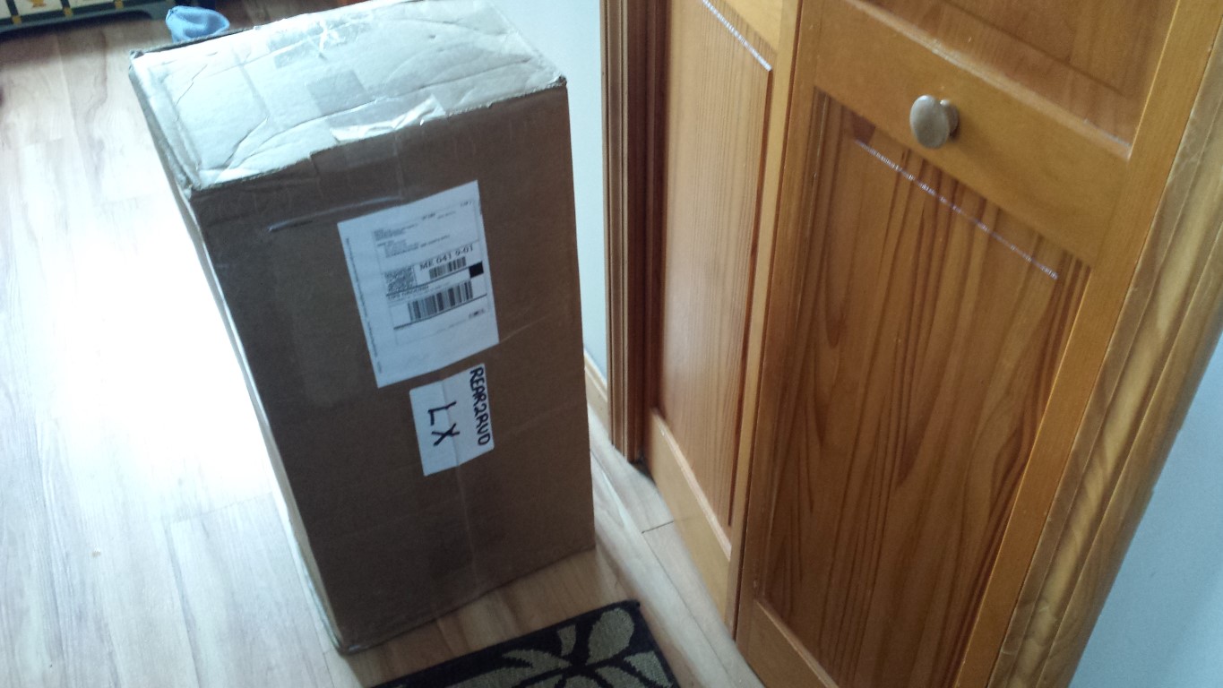

The Rear Remotes Kit is here!
Here's what $1200 buys you after you take off all the bubble wrap.
I feel like a kid again at Christmas!
For those who wish to follow along, here's a PDF file created from the printed instructions. Remember, we're going to try this without removing the operator seat, fenders, or fuel tank:
Yanmar_LX_remote_kit.pdf 5.5MB
