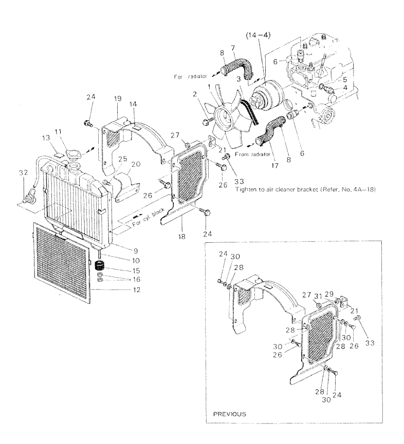

If these tractors used a "standard" style of alternator, I would have certainly converted over to a "Denso" (mini GM or 70's model Japanese car) like the person with the 336D did. However, the alternator in the YM135/YM155 (and YM1500?) has the cooling fan mounted to the front of it. There's really no good way (that I could see) to add a "standard" alternator to it while maintaining a factory appearance and keeping the fan shrouds in place (bear in mind that this is a thermosiphon tractor, as well - so it's important to not compromise the cooling system).

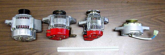

UGH. Your machine has that awful dyno setup. OK, you're right. Basically you would loose the OE look.

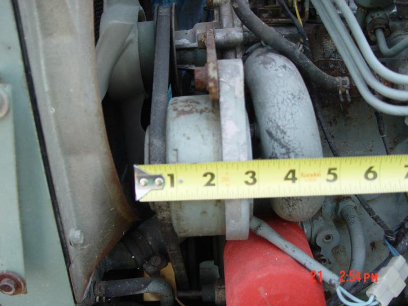

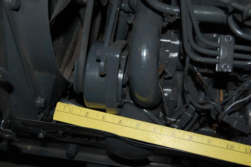

Is there a cooling hose right behind it? The YM1610 and the YM2310 has that U-hose right behind it. The only way to mount a more modern alternator is to have it mounted higher under the hood on a sure bracket setup and a different belt length possibly.
YM1610
YM2310

No. The YM135/YM155 (and YM1500?) alternators mount to a plate that is bolted directly to the front of the engine. There is no cooling hose behind it. There is also no water pump (thermosiphon).
I think that trying to adapt a different style of alternator to these tractor models just isn't worth it. You still have to maintain the factory alternator (or at least a shell of it) in order to have a place to mount the fan. The factory alternator was 8.5A. This was designed to drive 25W headlights and 20W tail lights (and the occasional use of a 20W work light). With modern LED bulbs, it's easy to work within the confines of the original alternator while still creating sufficient light. However, the aftermarket alternator I spec'd above is rated at 15A (or 20A - depending upon the seller). It's quite a bit larger in diameter than the original (in fact, I had to file a flat spot on the aluminum housing, in order to get a socket between it and the injector lines to tighten one mounting bolt). In other words, one can nearly double his charging capacity on these tractors for less than $90 (add $30, if you also upgrade the regulator). That really should be good enough - and it doesn't require (drastic) cosmetic changes or compromising the already "iffy" cooling system.

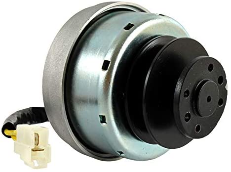

400-58018 Permanent Magnet Alternator for Yanmar PMA 12 Volt, 20 Amp 124660-77990
BRAND PART NUMBER
ARROWHEAD APM0014
YANMAR 124660-77990, 124660-77991
LESTER 10941, 10941N

124660-77990 is the alternator that has the rectifier built into it (uses 3-wire regulator).
124660-77991 is the alternator that has the external rectifier (the rectifier is built into the 4-wire regulator).
Even though many of these Internet vendors seem to advertise these two numbers as the same part, they are most certainly not. From what I can tell, the only place that truly sells the 124660-77990 aftermarket alternator is Hoye Tractor. Every other source I've found does not seem to offer a rectifier. The aftermarket unit is mainly advertised as a replacement for the YM1500 (which used a "4-wire" setup) - so it makes sense that it doesn't come with a rectifier.
