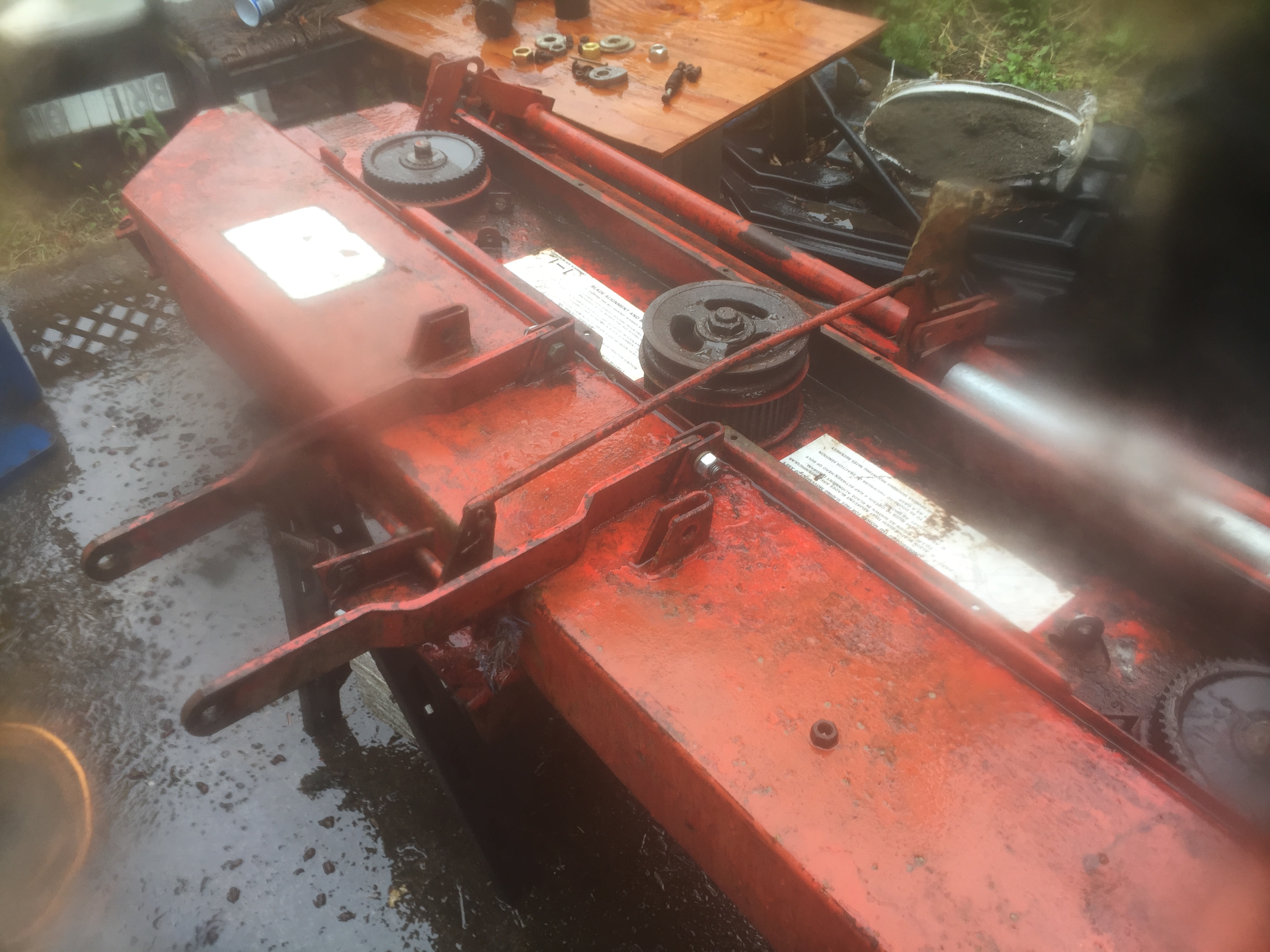

Finally got the deck back together today....replaced bearing both sides and had to replace the center spindle....was the old aluminum type and it had broken....Gary helped me out on the center spindle....ended up replacing all the pulleys ...previous owner had replaced them with incorrect size pulleys and the center spindle was over heating.....bought used pulleys that were the correct size and she is purring.....matter of fact I was mowing today....flipped the switch to start the pto and had to look down to make sure the deck was working...it was so quiet.....can not believe how much better it is working.....

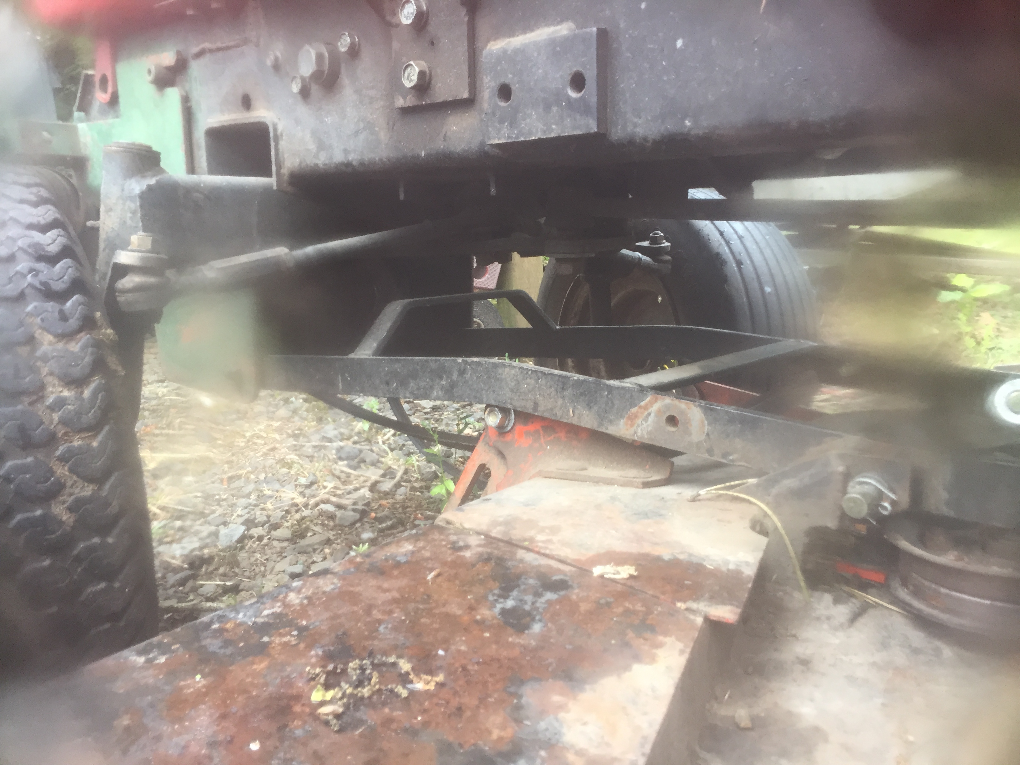

Well, you just made me aware of something I didn't pay attention to till now! The BM48 mower had the tube type front bar on them with the tensioner underneath and slightly to the right, while the YCM decks had the sheetmetal box under the "bumper" (see pics) with the tensioner on the left (facing) side of the box. Totally different, but they do the same thing. I always thought it was the same, just the sheetmetal box was missing from the BM tractor.
It looks liek maybe your factory tensioner snapped off? Hard to tell from the pic.
BTW, looking at the new pics, I believe you have the YCM 60" deck judging by how far it sticks out of the machine. You better measure that thing!
If you could take pics of the way your YCM 60 deck is mounted to your tractor it would be appreciated. Mine looks slightly different. IMG_1963.JPG
