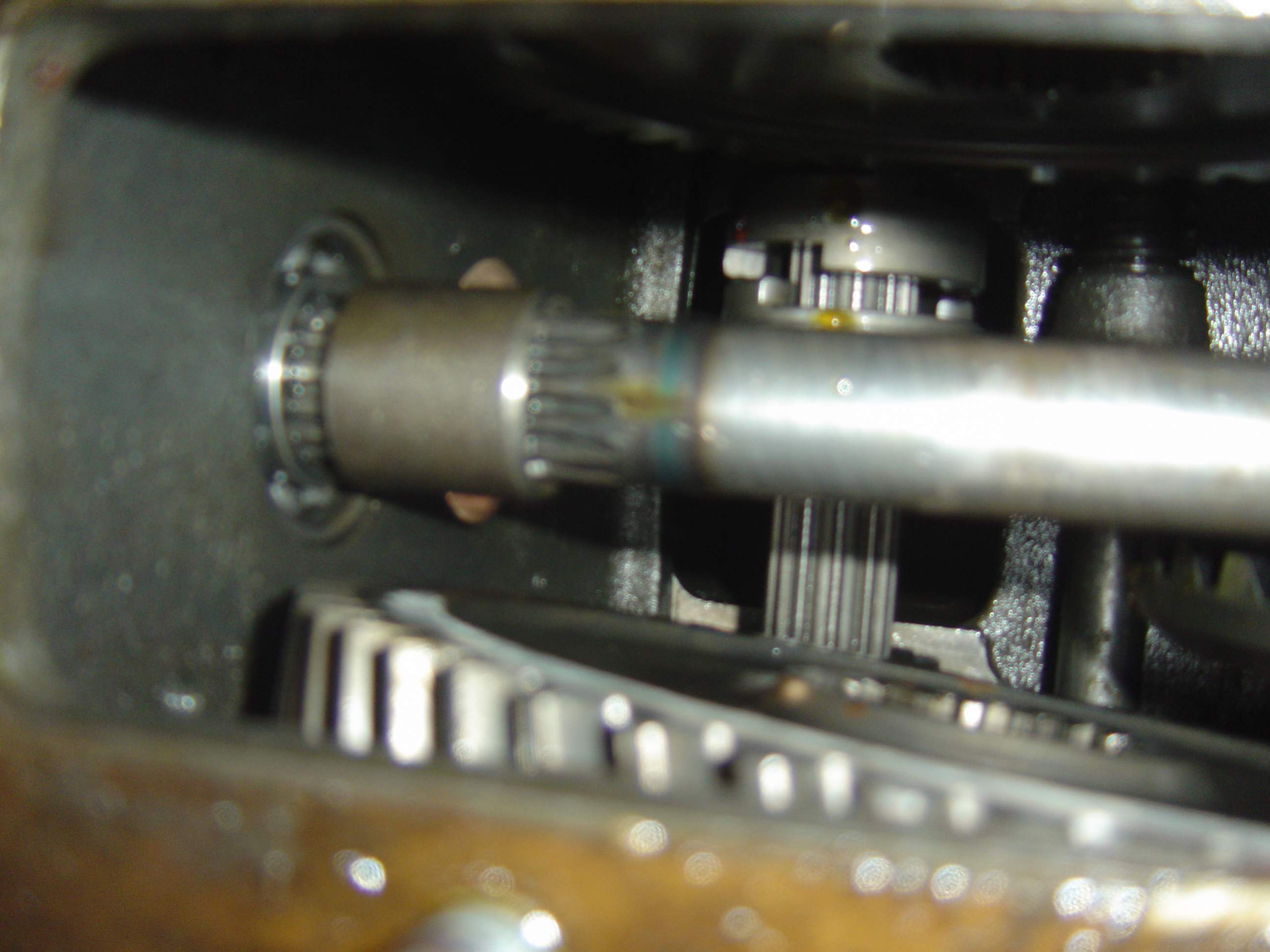

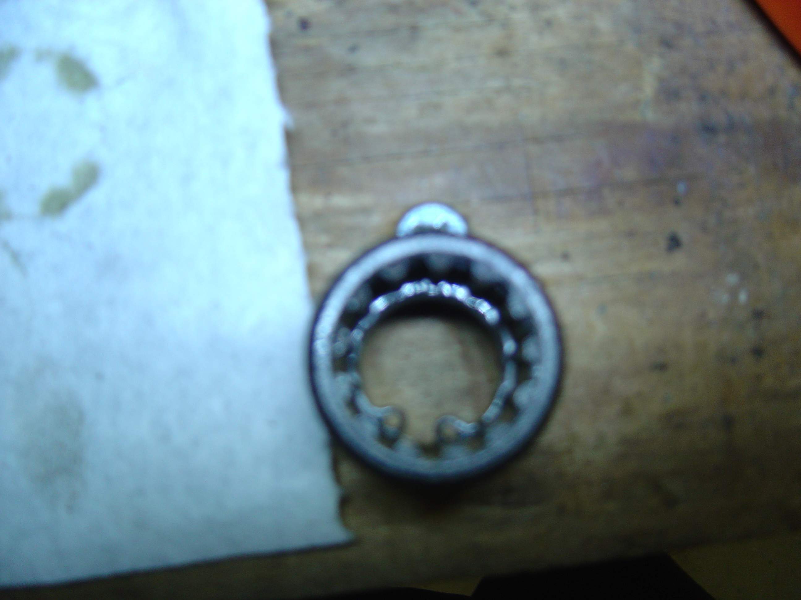

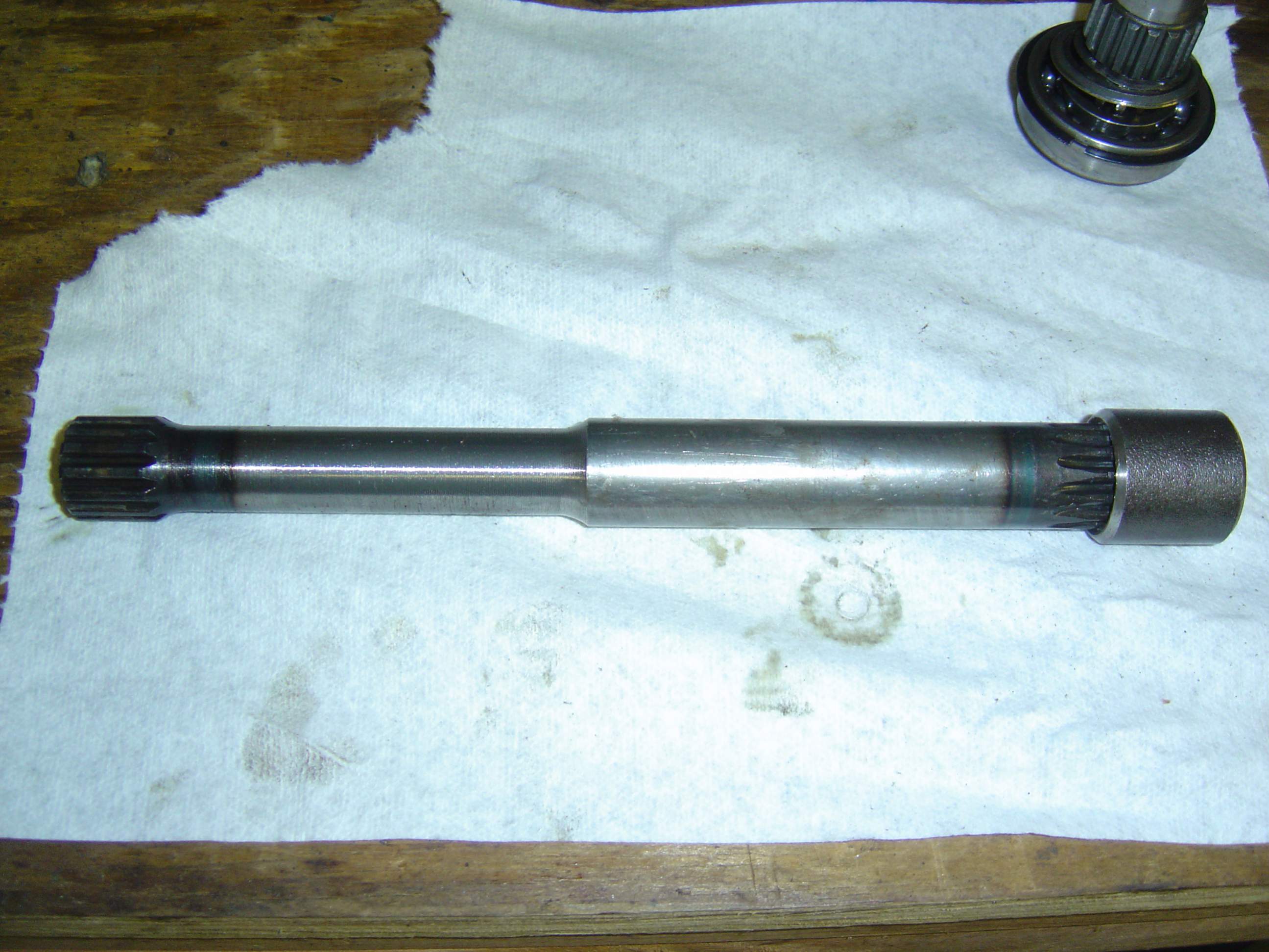

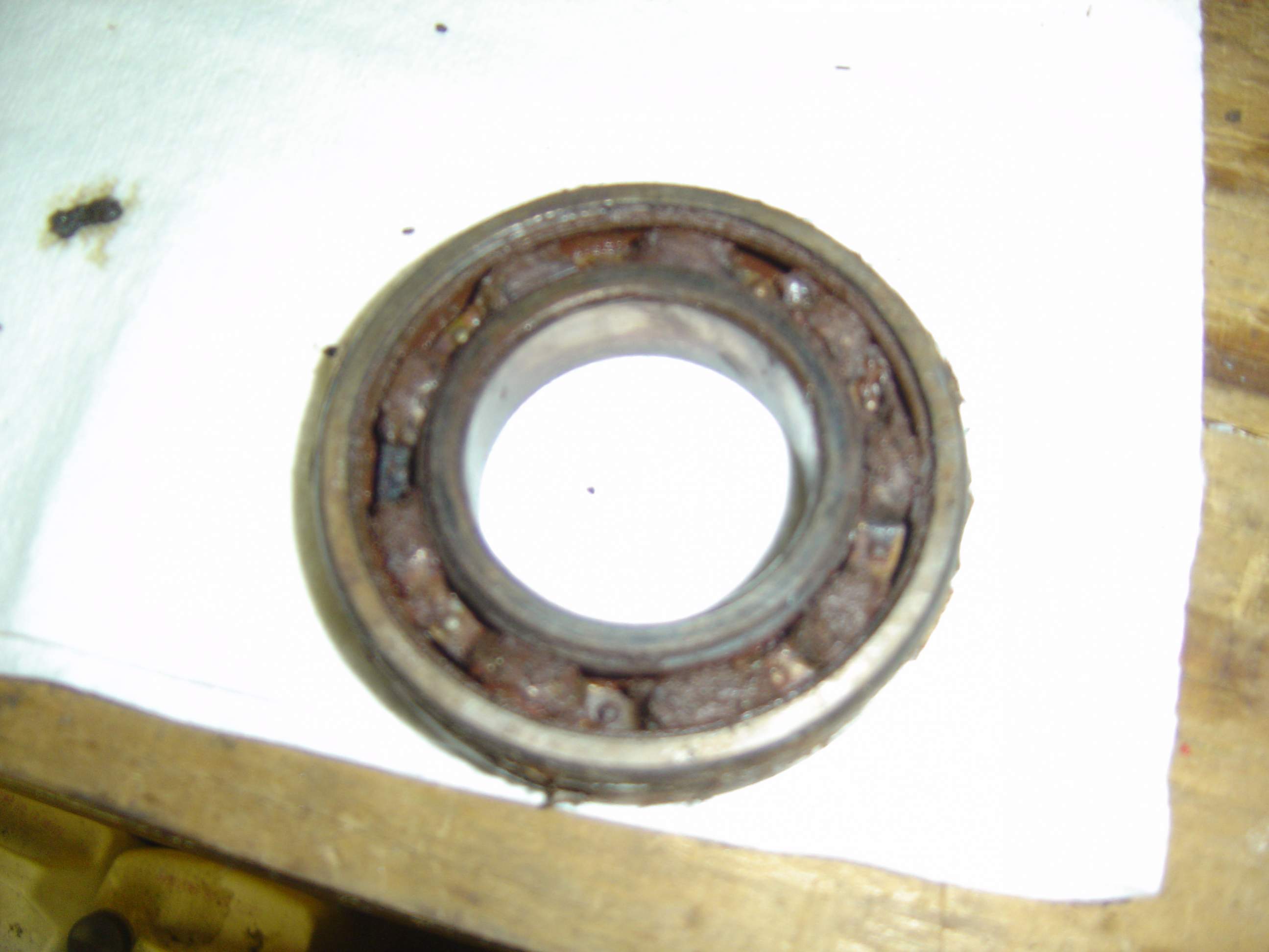

Here is the internals for the green 1500 axle.
Yanmar Tractor Parts: REAR AXLE INT (G)
The photos below show the PTO shaft that is inside the rear axle housing. The sleeve that connects it. The original outer bearing from my tractor that had not yet completely failed.

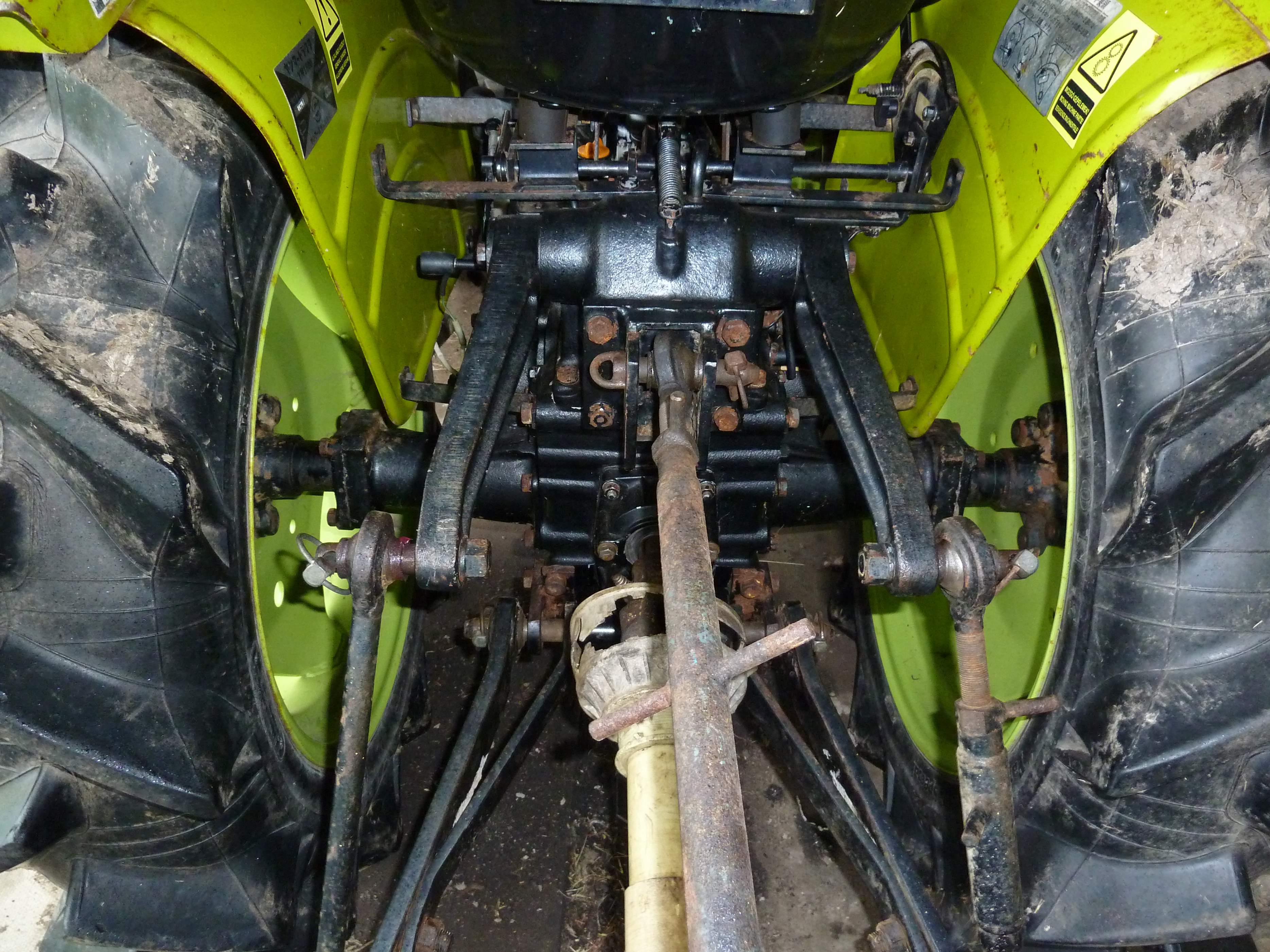

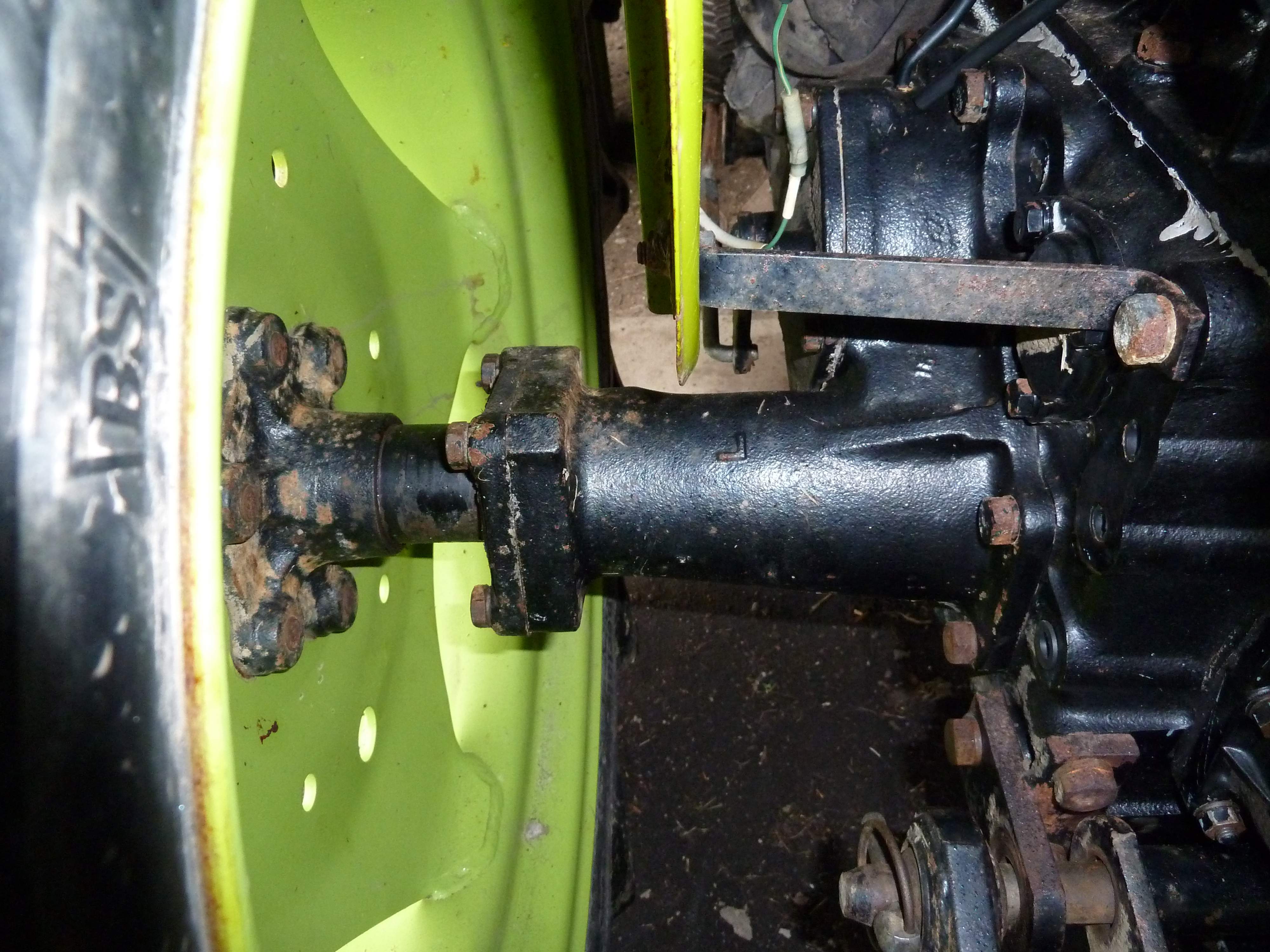

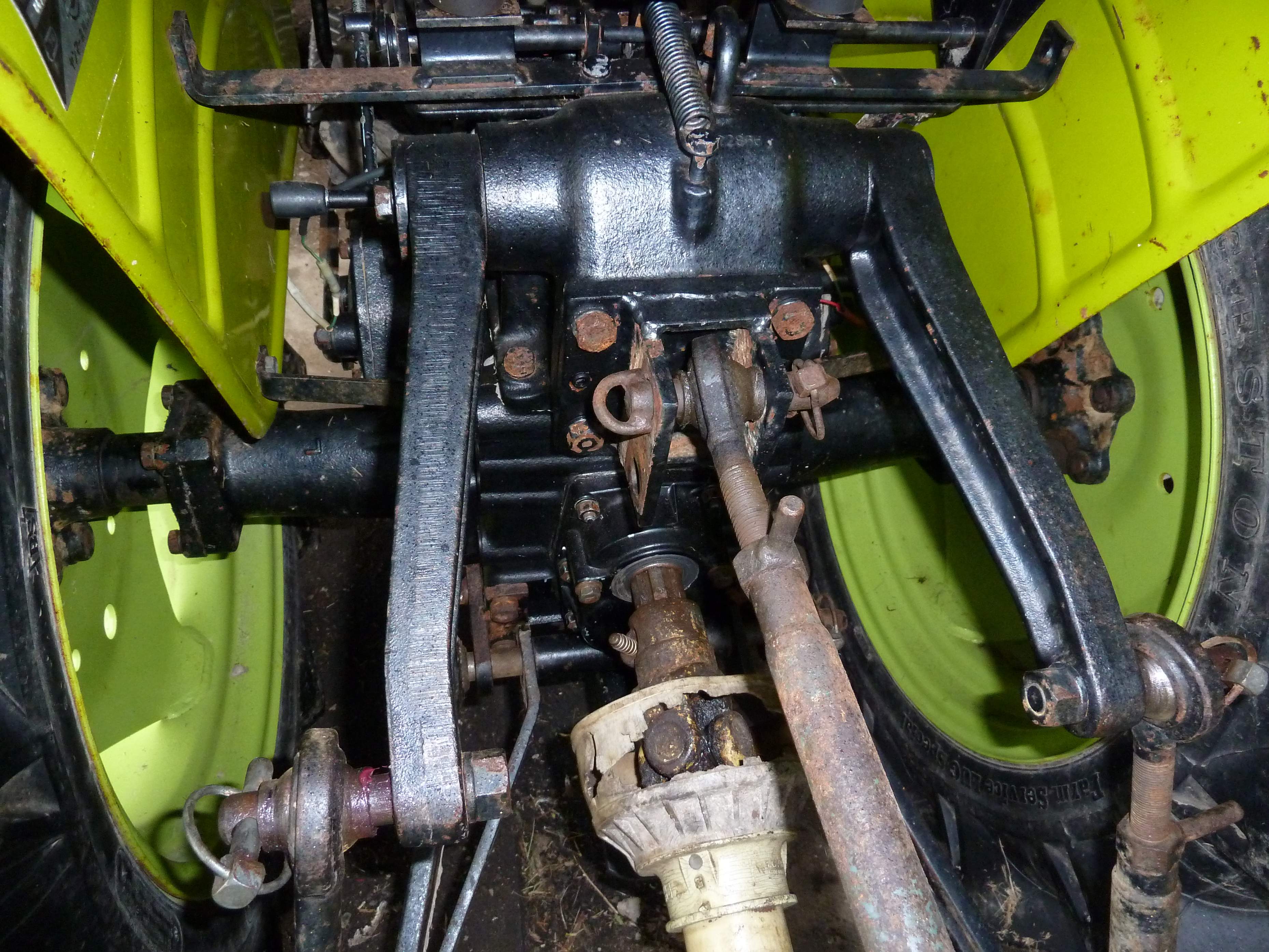

ok guys this is the pics of the backend of my ym 1500P1010270 (2).jpgP1010272 (2).jpgP1010271 (2).jpg
   / yanmar ym1500 update #85
Thanks for the pictures. Looking at them I'd say you have a red axle setup. I know the tractor is green but if you look at the parts drawing, the green axles have a solid cover over the brakes. The red ones have a removable cover and the housing is longer where the axles come through. Also only the red ones seem to have the square housing behind the wheel where the bearing is located. Yours looks identical to my red one. This maybe something to double check with Aaron at Hoye.

yes im just trying to figure out what is the quickest way to strip and repair someone said you can take the plate of in bellow and get at the nit that holds the shaft in without taking the pto shaft out. do you think that if i can get the bolt out from in bellow that i can then withdraw the shaft with just taking of the rear axle hub and slide it out to repair. i was thinking of sealed bearings to replace?
   / yanmar ym1500 update #87
You can try to get the bolt out of the axle without removing the shaft. It will work I think if you have someone remove the housing with the shaft in it while you back out the bolt. The PTO is easy to remove if you need to. A sealed bearing is fine for the outer. Not for the inner bearing, it is lubed by the fluid in the axle. You still need a seal there.

so i definitely need to remover the housing and and brake cover that is one piece? is it a two man job for sure i thought if i could get the bolt out at the bottom then i could pull the whole lot off ?

If I remember correctly there's not enough room to back the bolt out all the way due to the PTO shaft. You can try it first. The bolts that hold the shaft in were very tight on mine. Don't use an open end wrench. The PTO shaft comes out easily once you remove the 6 bolts from the cover. You'll se the collar inside where it separates. One person can do the job. Having a press is the key to doing it. .

do you think its easier just to take the top of or less work removing the bottom plate and just move it bit bu bit till i can get the bolt out? is there a bit of weight in the case when i take it of? o the localgarage has a press im hoping it will be able to put the new seal in and bearing or did you replace both bearings and seals ? well i need to cut a bit more grass before i do it will it be ok still ok use ? thanks
