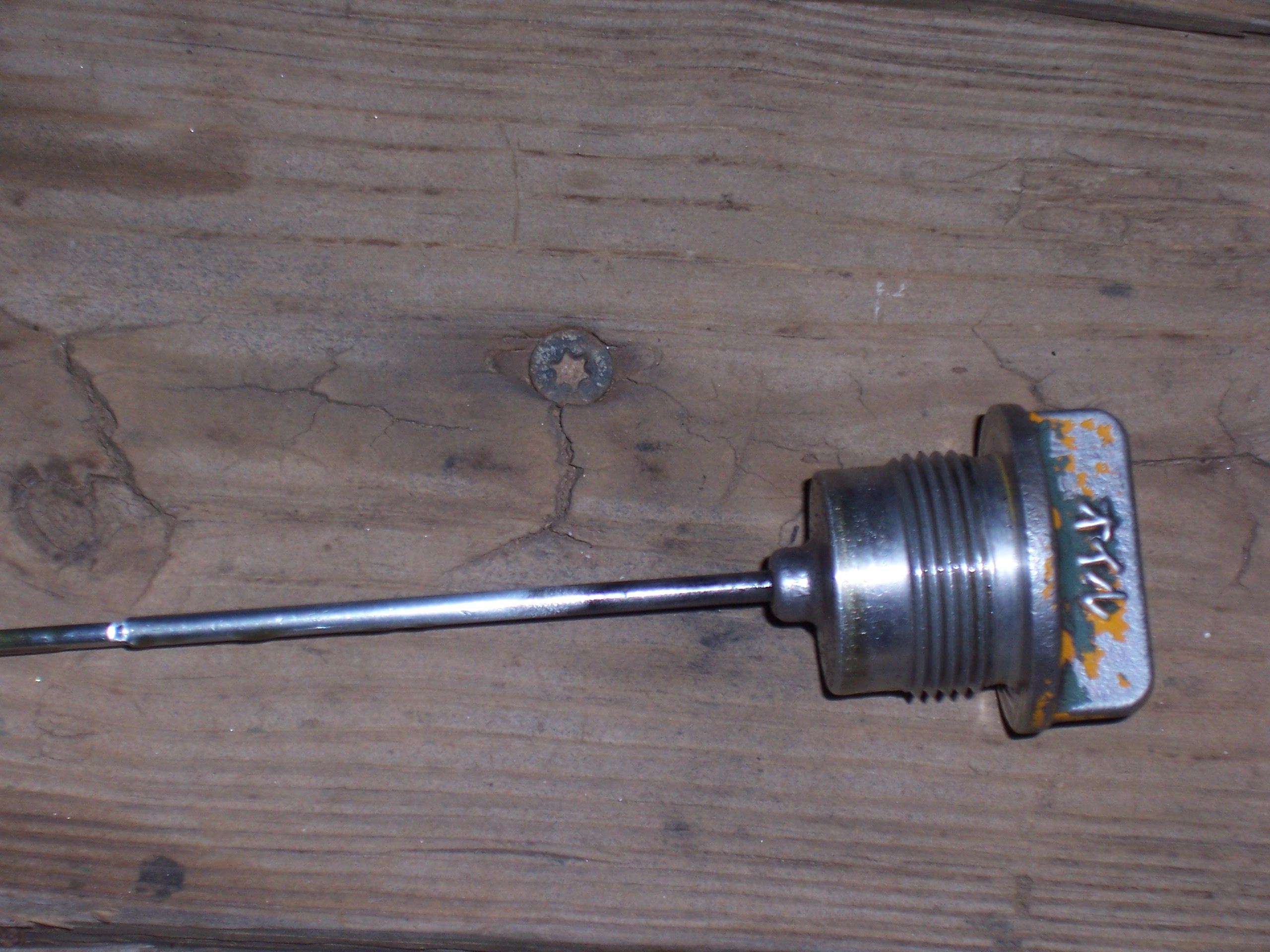

It had began to smoke a little but as his son was mowing a week or so ago it blew the dipstick out and had bad blowby.
Here's a pic. of my 2000 DS. :eek: My parts book # DS-1250 for the 195,240,1700,2000,2210, 3000,3110,3810,4300. Must of been one heck of a blast to blow the DS.out.:laughing:
mine is the same.. except painted yellow!
I'd expect a detonation inthe crankcase to blow that sucker out!

But I think the early ones - Revision Level - (blank) or Level 1, had a slip-in dipstick on the right side.
Or maybe this is a FrankensteinMar.
/ Yanmar YM1700 (Green)? #12
rubber plug in base of block? :)

I have no idea but this is what Hoye shows for the 1700. Yanmar Tractor Parts: DIPSTICK LUB. --- EMAIL FOR AVAILABILITY ---
I did a little more research and I have a pdf parts manual for the 240. It shows an "old type" with the rubber plugged dipstick and the new type with the screw in dipstick. So I guess it depends on which one you have.
A little more evidence. http://www.stevenstractor.com/parts/compacts/yanmar/engine-parts/oil-dipstick-1.html and http://www.stevenstractor.com/parts/compacts/yanmar/engine-parts/oil-dipstick.html

To have built up enough back pressure to blow the dipstick wouldn't the vent have to be clogged/plugged? and it seems to me that the engine would have had difficulties cranking over, unless of course it was being started in decompression mode.
Incidentally: my old Kubota had this type of Dipstick, These type eliminates the confusion as to whether it needs to be screwed all the way in or not? when checking the oil level;)

My Parts Manual. When I change my Oil I insert it to the Threads and it shows up on the Hatch Marks Full at 5qts.
